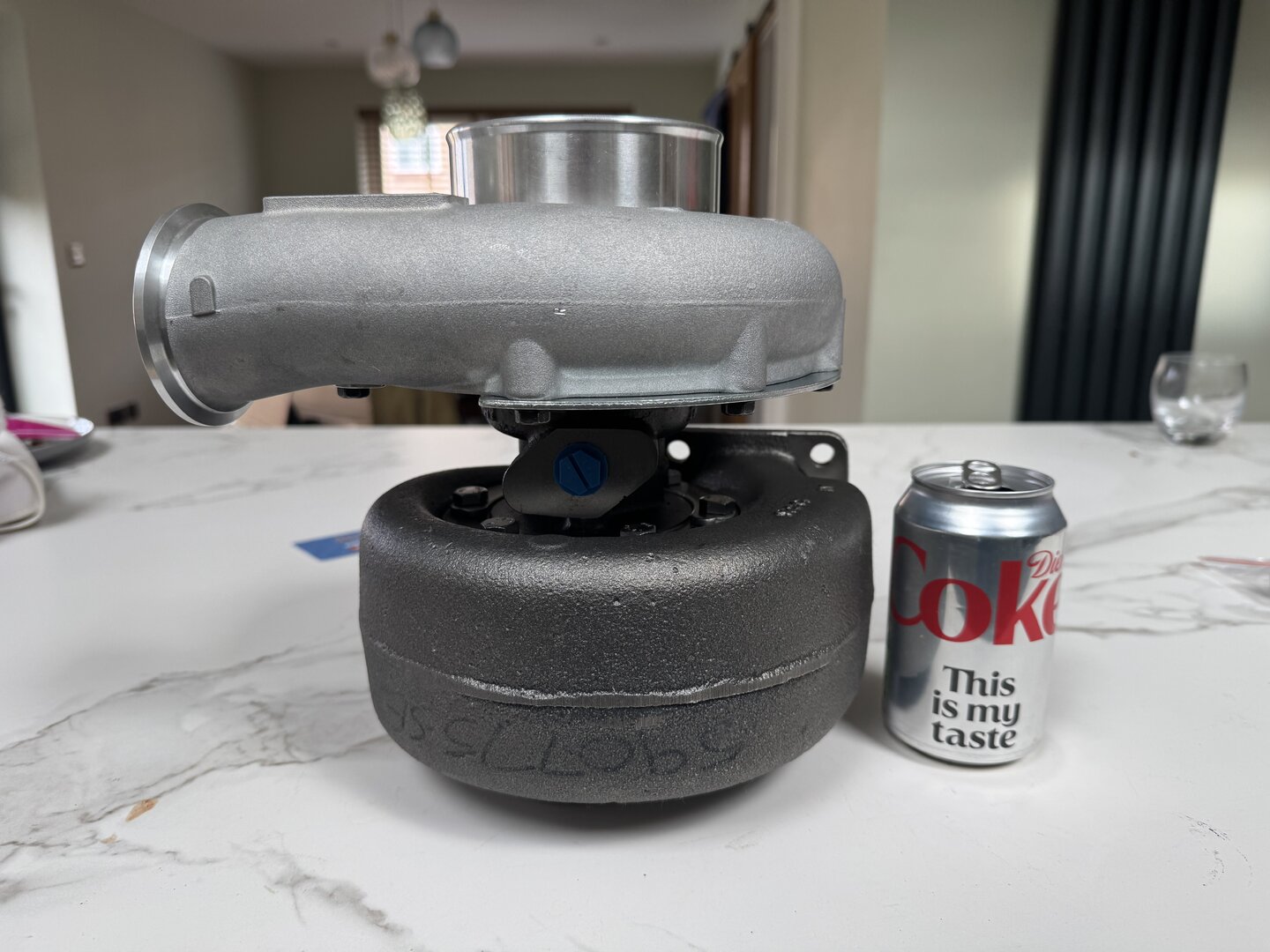

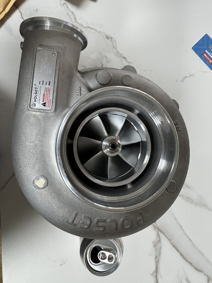

In other news I bought a spare Holset HX50 with a bigger turbine wheel and larger rear housing. Not sure if I’ll use this one yet but I’m leaning towards doing a back to back when I book dyno. I’m thinking this one with the large turbine wheel and rear housing will be better suited to a semi PP revving to 10k whilst giving up the larger 75mm compressor wheel on current turbo.
The new 70/86 with 28cm housing (1.3 - 1.4 AR approx). Cheap too at only £500.
It’s currently having the rear housing drilled and tapped for back pressure sensor, I collect it Monday and then ship it off to Thermomet for their treatment.

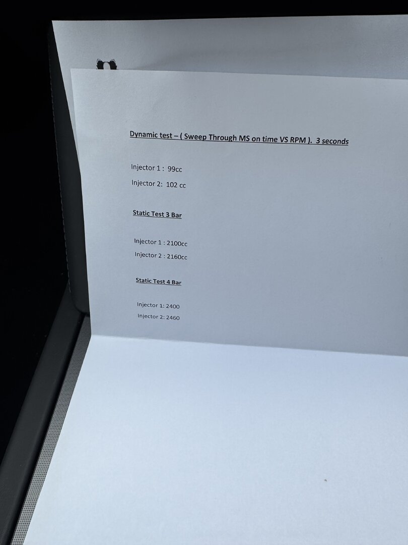

Here are my 2200s being tested, as CNG injectors these do make me nervous and I am contemplated moving to Injector Dynamics 1750s and 2600s, it just deciding if I should stomach the £1300 bill for a set.

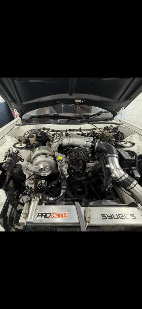

Current state of play top left with lambda working.

Also I've been running those 2200cc cng injectors on mine and they work. I've done close to 20 100-200 pulls and fueling remains reliable and consistent with them. I've also done around 8x 24psi hits with them from 60-90/100mph in 3rd and the injectors do the same thing consistently and reliably. The variance you're seeing less than 3% is a good enough match for an injector this size. I would bag the 1.3k and give these a go.

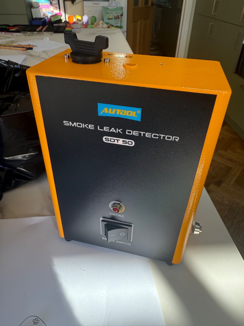

To further prove my point as to not waste money ripping off the beautiful Thermomet I invested in a smoke tester which has proven the down pipe and manifold itself were leaking.

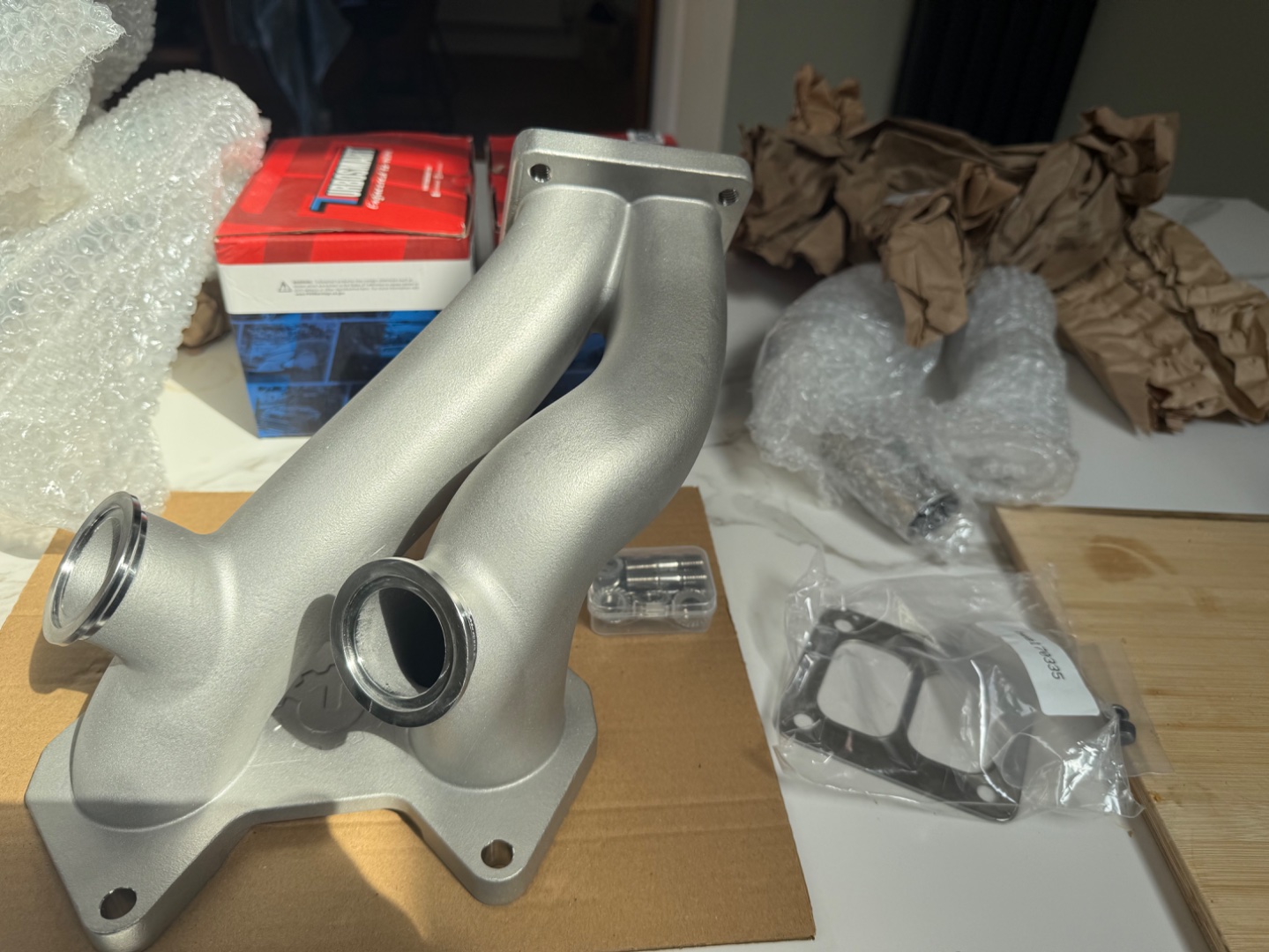

In order to resolve the manifold issue I’ve purchased this weekend the Turblown exhaust manifold along with twin Turbosmart wastegates moving away from my big single 60mm gate. I’m told this set up offers superior flow and boost control.
I will of course need to amend my down pipe, oil feed and return as well as the TIP/TEP sensor locations and intercooler piping, all in all more investment that I wanted to avoid but with hindsight I probably should have investing in a better exhaust manifold set up at the inception of this project.

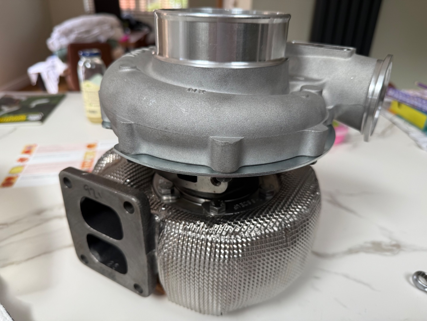

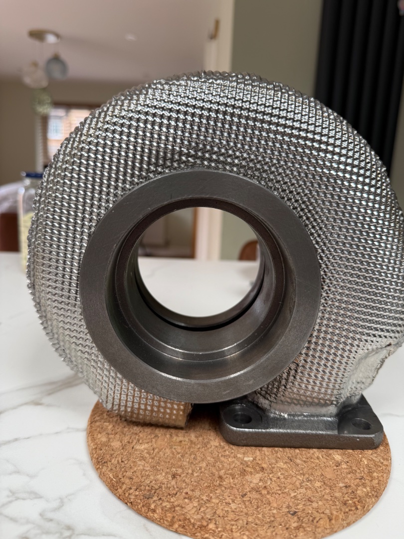

I’ve since had the new HX50 treated to the Thermomet goodness.

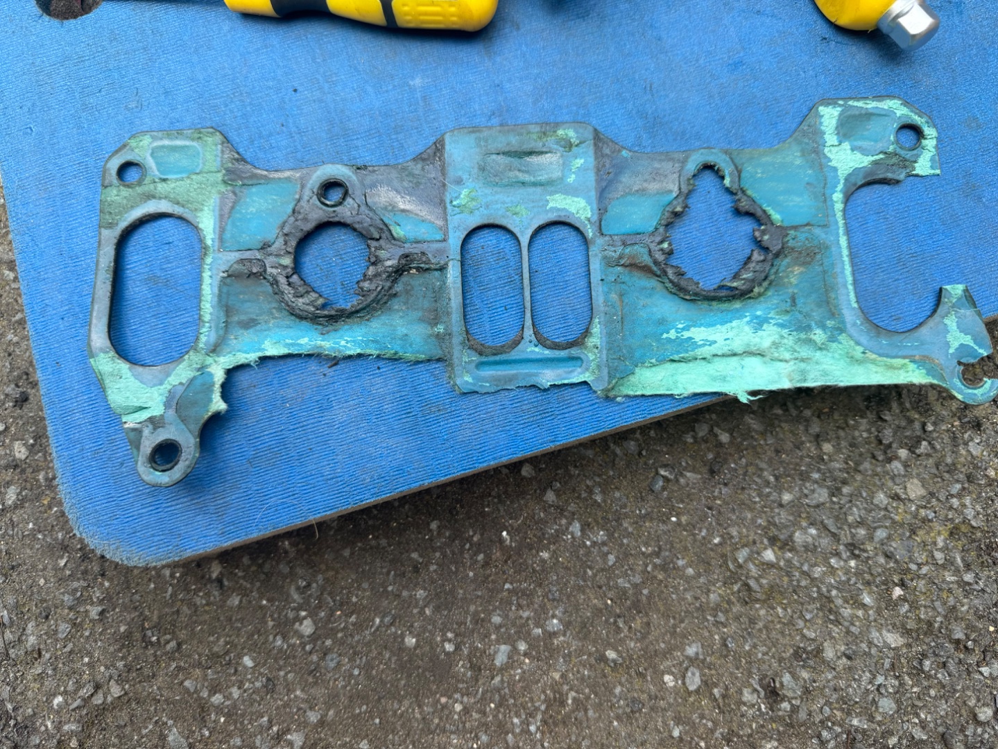

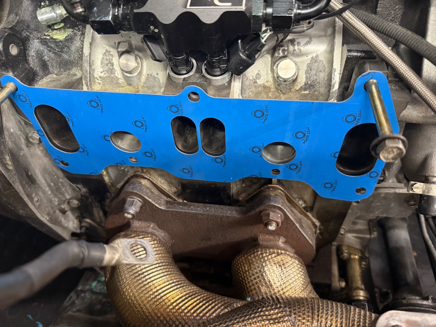

During troubleshooting of exhaust leaks I decided to strip the lower intake to take a look at the EGR ports to see if they were the culprit and due to the amount of reversion with the semi PP the exhaust gasket was fucked, it looked burnt in place as seen in pic.
To remedy this I did buy a new gasket from Billet Rotary in AUS but my expectation is this new paper based gasket will likely be ruined in a few months so I’ve commissioned Dobson Gaskets to custom make a gasket made with higher tensile strength, better clamping force, better chemical resistance and of course better heat resistance too. I should have the new gasket in a few weeks.

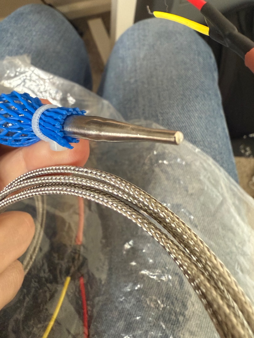

Whilst I was pulling the exhaust manifold apart I noticed that one of my EGT probes was bent, again likely due to the heat. It just so happens my tuner now offer a much thicker type of probe which I’ve purchased.
If anyone is interested here is the smoke tester I purchased, it was £40 and for the money is bloody brilliant.

You're probe may have bent if it is stainless steel? At the temperatures of rotary you need inconel really.
The rotary exhaust temperatures is very high and pushing close to the limit of any temperature probe. You say 900 but I've read online it reaching 1200.
I have seen over 1000c on mine at cruise which I don’t think is healthy long term, I think cruise should be 550-700c region personally.

I have nothing but good things to say about Turbosource/Turblown. A real pleasure to deal with, very quick response to questions, I purchased from USA on Sunday and arrived with me via DHL by the following Friday.
They even said that I could send back for a refund covering postage if it didn’t fit with my turbo set up.
Good news is it fits perfectly for my smaller HX50, I say “smaller” in reality it’s a 75/76 1.35 AR turbo but I cannot be sure about my slightly larger HX50 which I would prefer to run, the turbine housing is a little bit thicker being a 28cm instead of a 25cm.
Before I can properly test the larger one however I need to open up the bolt holes on the turbo as they are for T4i configuration vs T4, it’s only a few MM on each hole.
Either way it doing to be very close.

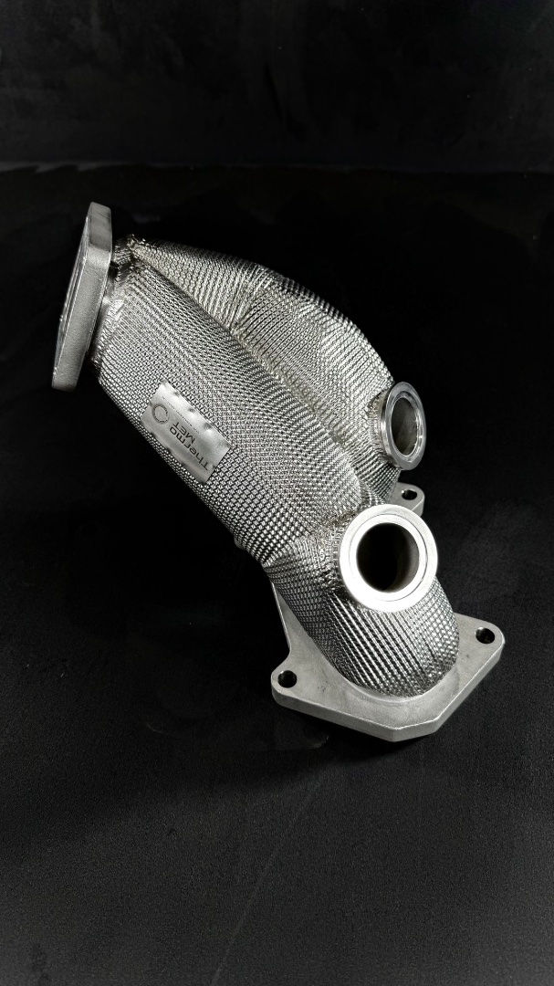

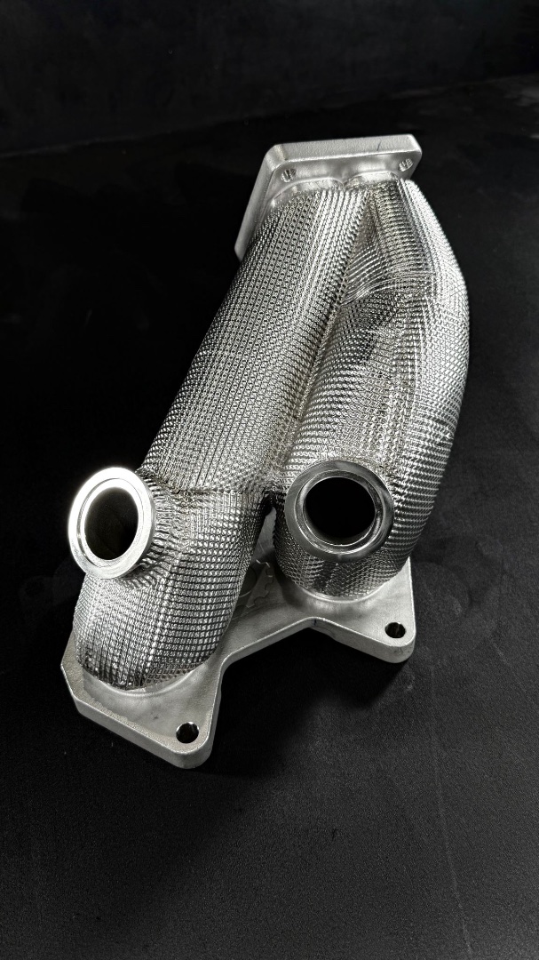

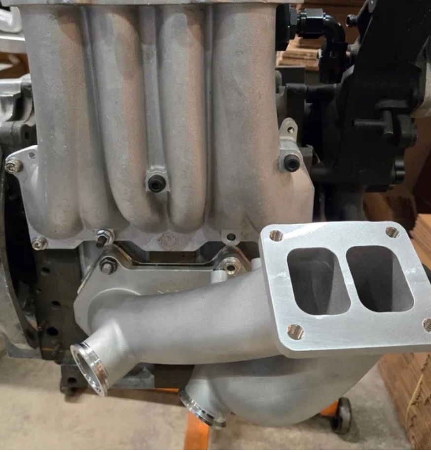

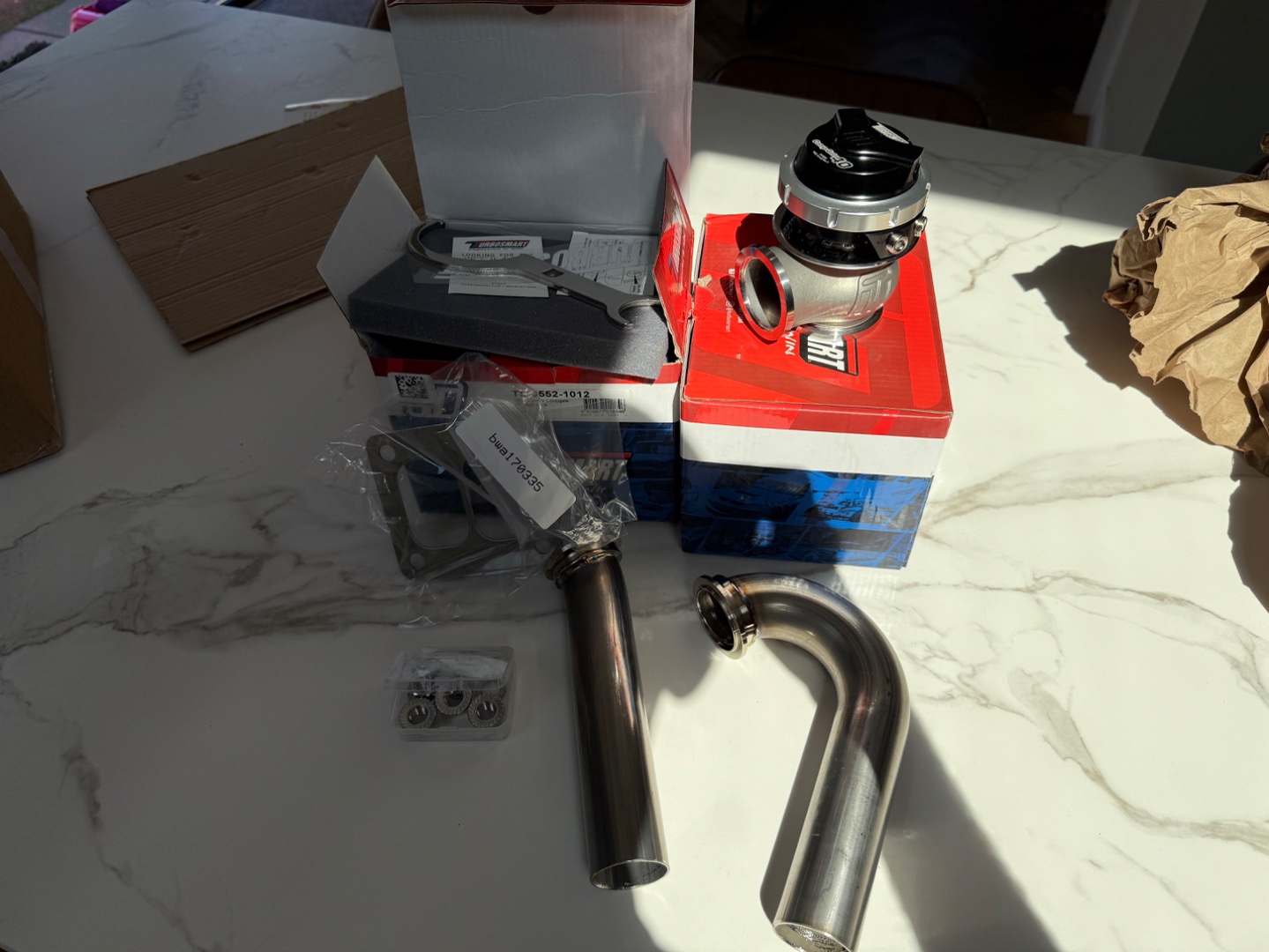

I went with the T4 twinscroll EWG option, 2 x ports for EGT probes with dual wastegates. I also picked up 2 x 40mm Turbosmart wastegates along with dump pipes.

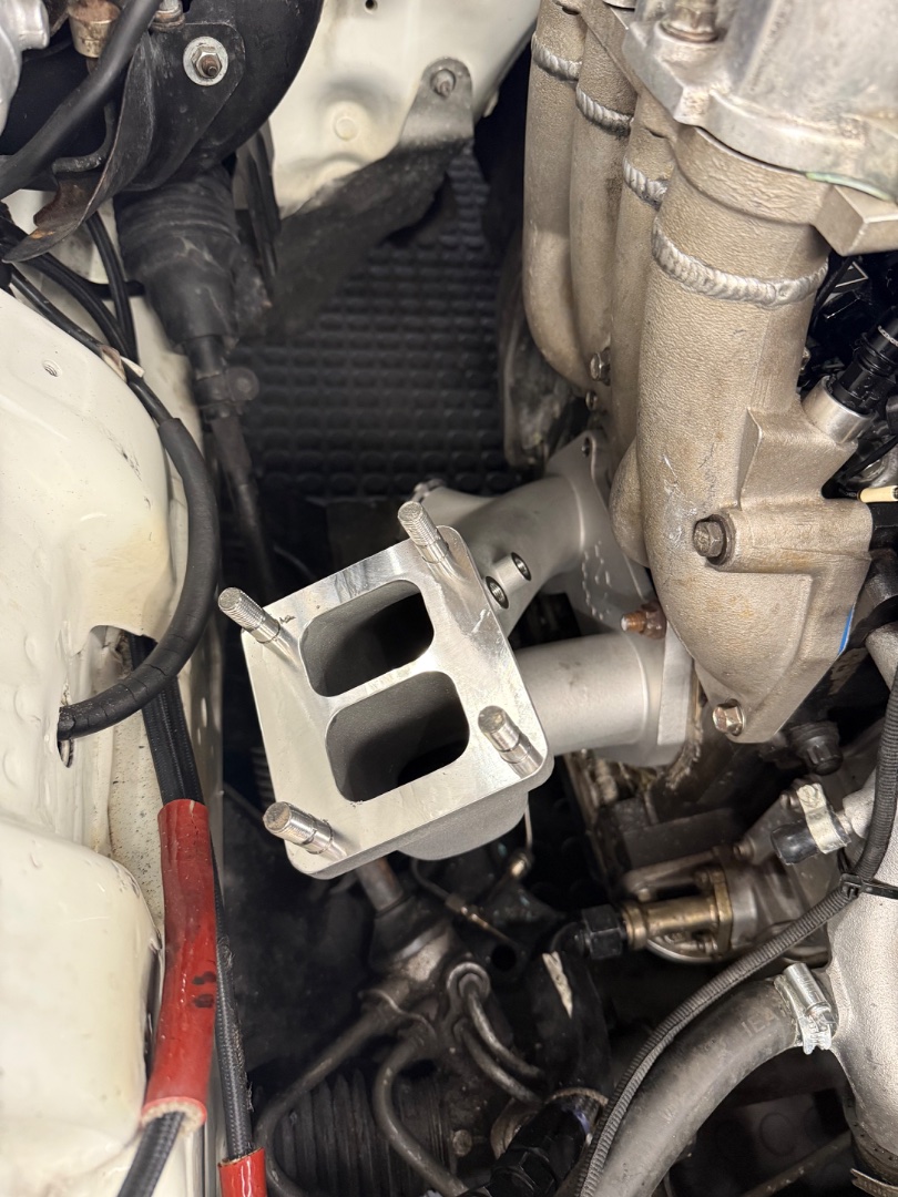

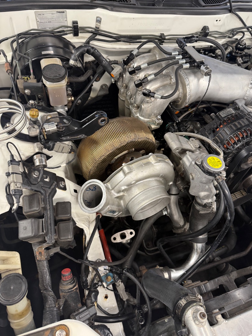

A few fitment shots below.
The turbo oil feed will fit fine but will need to lengthen the oil return. The down pipe will need amending as will the intercooler to compressor alloy pipe. (To be fair I need nice new intercooler piping fabricated - it’s on the to do list). I’ll likely have to fuck about with the TIP/TEP sensor locations too.

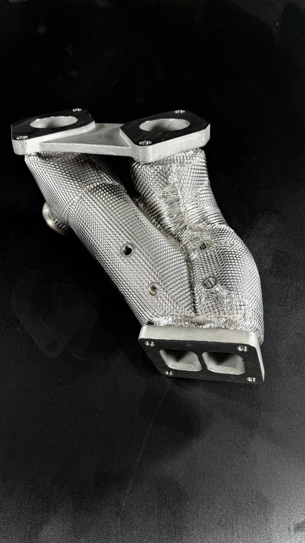

As it fits I’ve sent the manifold straight back out for the Thermo Met treatment.
Next job is to find a local TIG welder/fabricator to amend down pipe and boost hose.
Also waiting on feedback from Thermo Met as to the state of play with the old Greddy manifold. Keen to see what the damage looks like under the wrap.

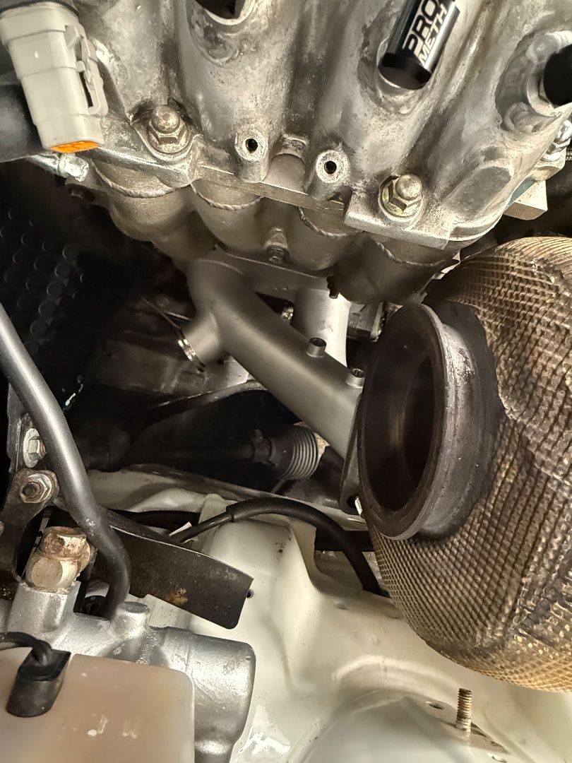

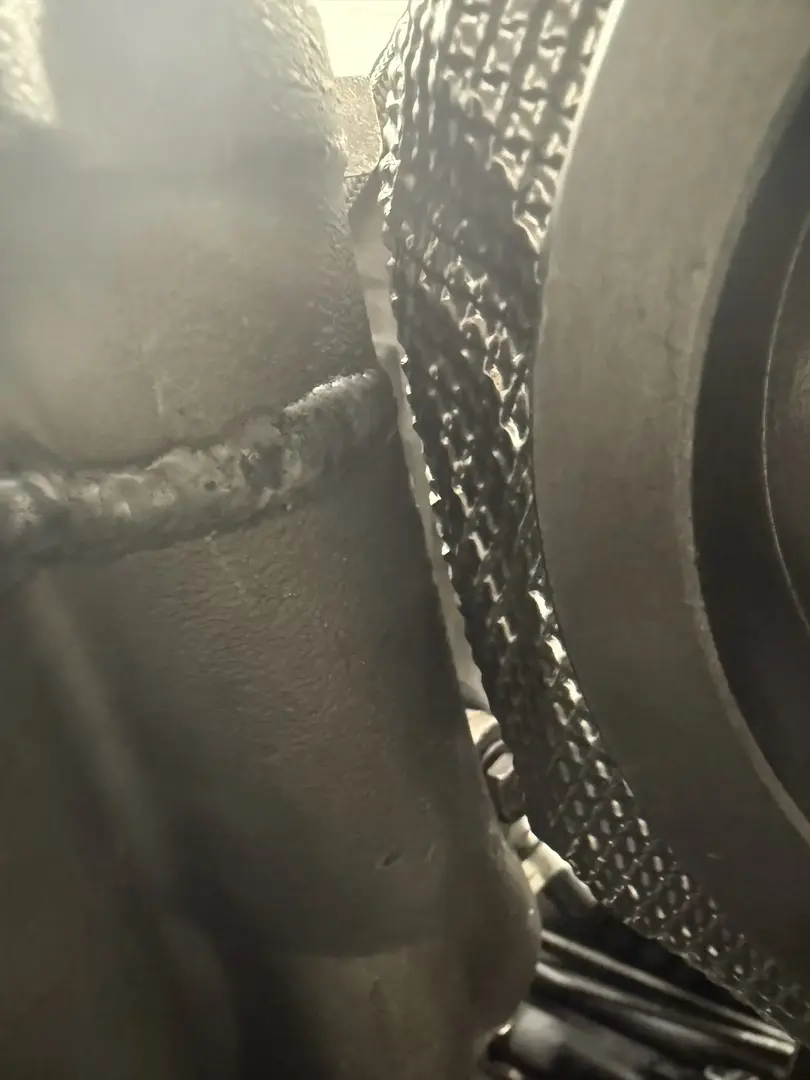

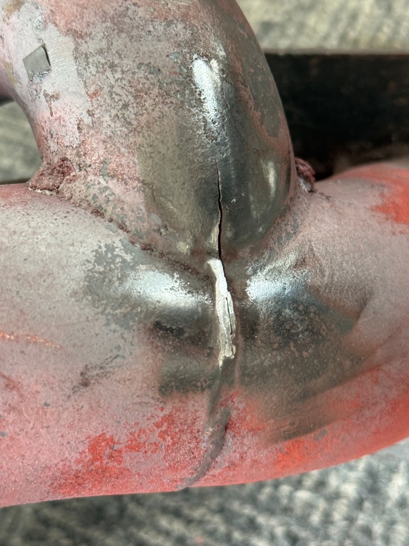

Okay, Thermo Met wrap removed to show a nice crack on old Greddy. @Joeybratten also suggests some bracing is missing.
There is also a crack at the turbo flange too. Buying a new manifold was the right call.

Custom inlet gasket on.

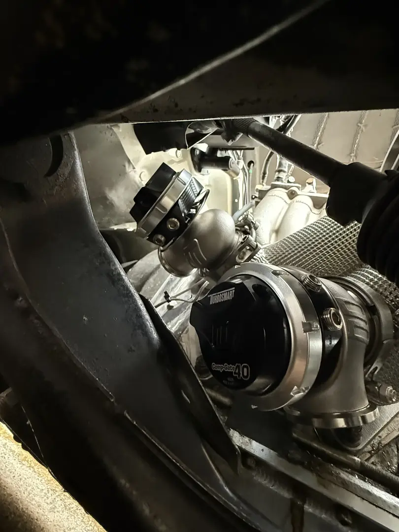

Tonight I tackled the dual wastegates and screamers.
