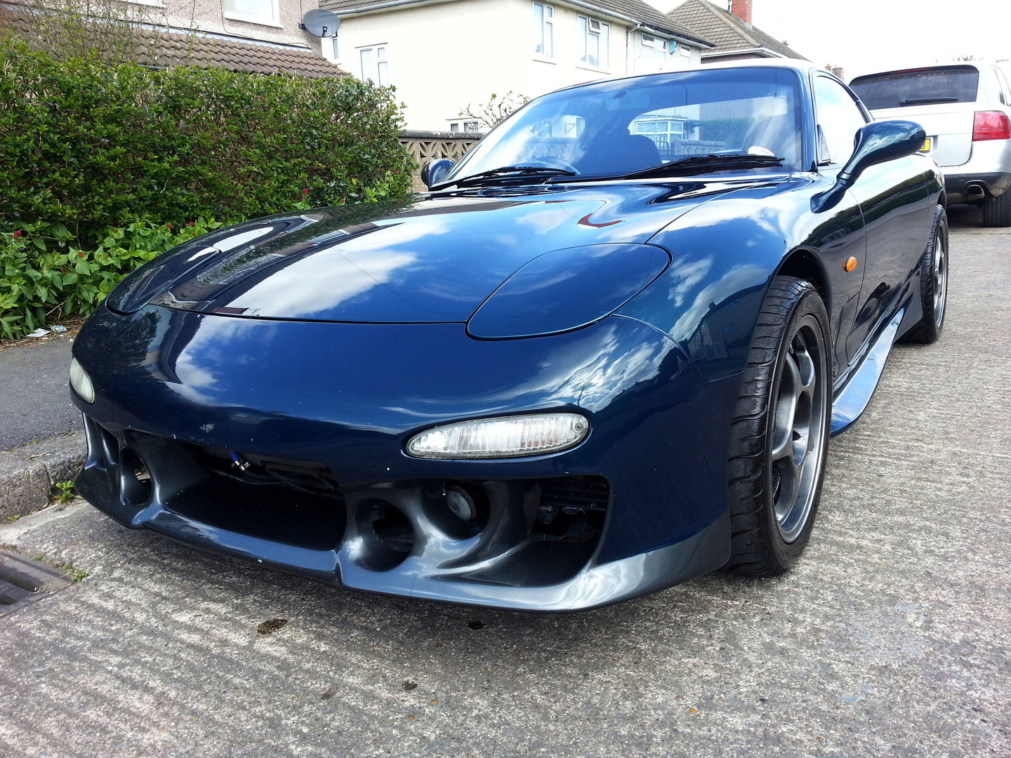

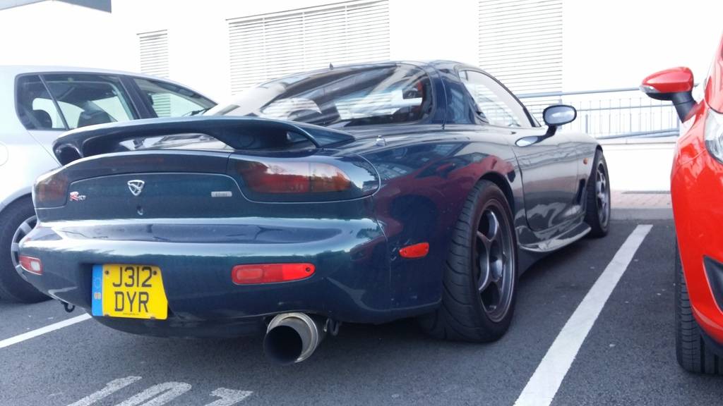

Ive had my FD for 5 years now and finally transferring the build from FDUK to FDOC.
Brief Intro to the car when I first got it and the spec then.
RX7 FD3S 1992 R1 in OEM Montego Blue
Engine
Stockport
HKS TO4S Single Turbo Kit
Radtech Vmount
Bosch 550cc Primary injectors
Bosch 1650cc secondaries Injectors
KG Parts Fuel Rail
Aeromotive FPR
Exterior
Knightsports front bumper
Veilside Sideskirts and rear spats
Stock rear spoiler
Emkei RPO1 17x9 et22 all round
255 40 17 595 RSR Wheels
Suspension
Stock shocks and springs
Stock bushes
Stock Arbs

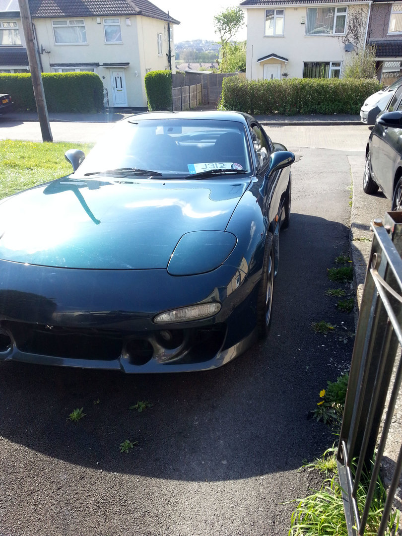

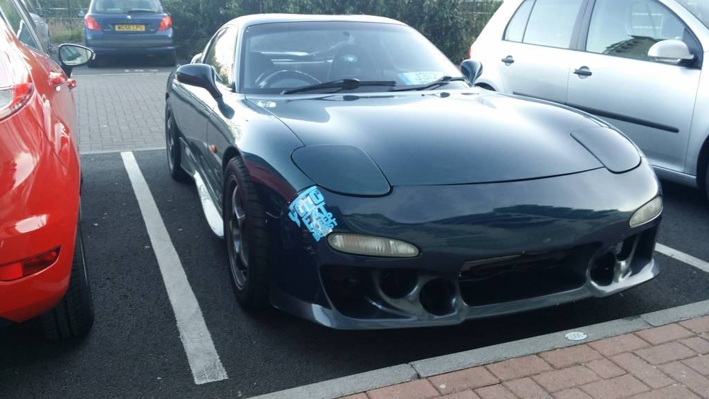

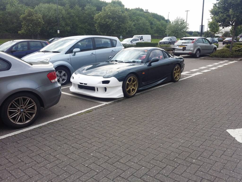

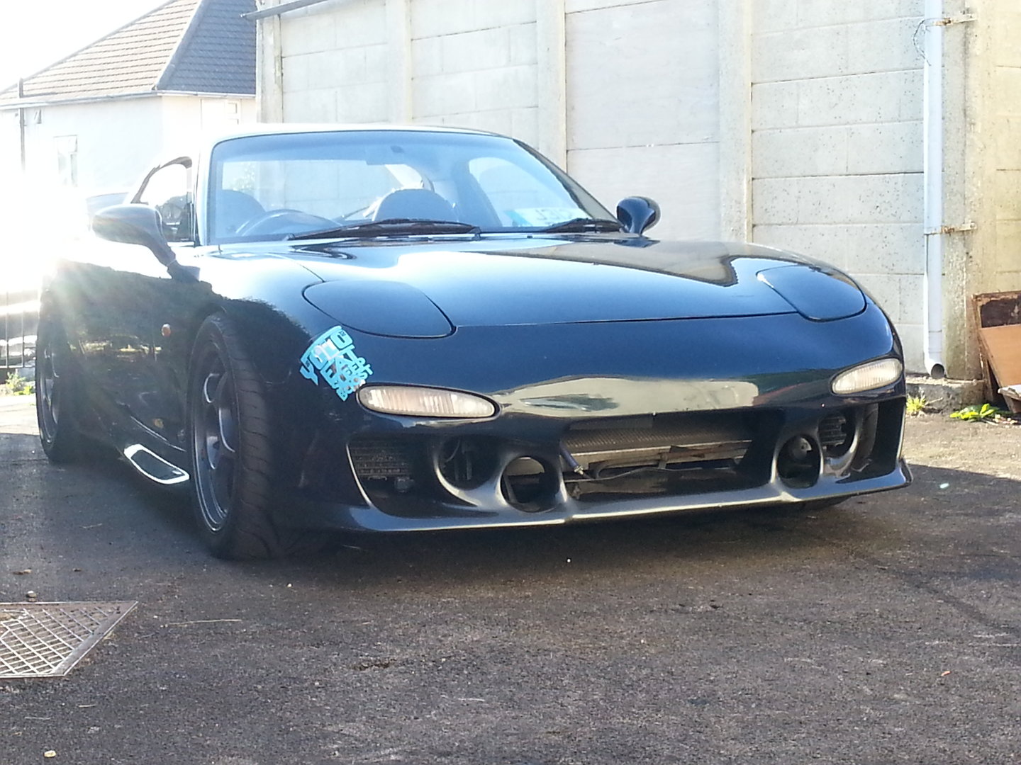

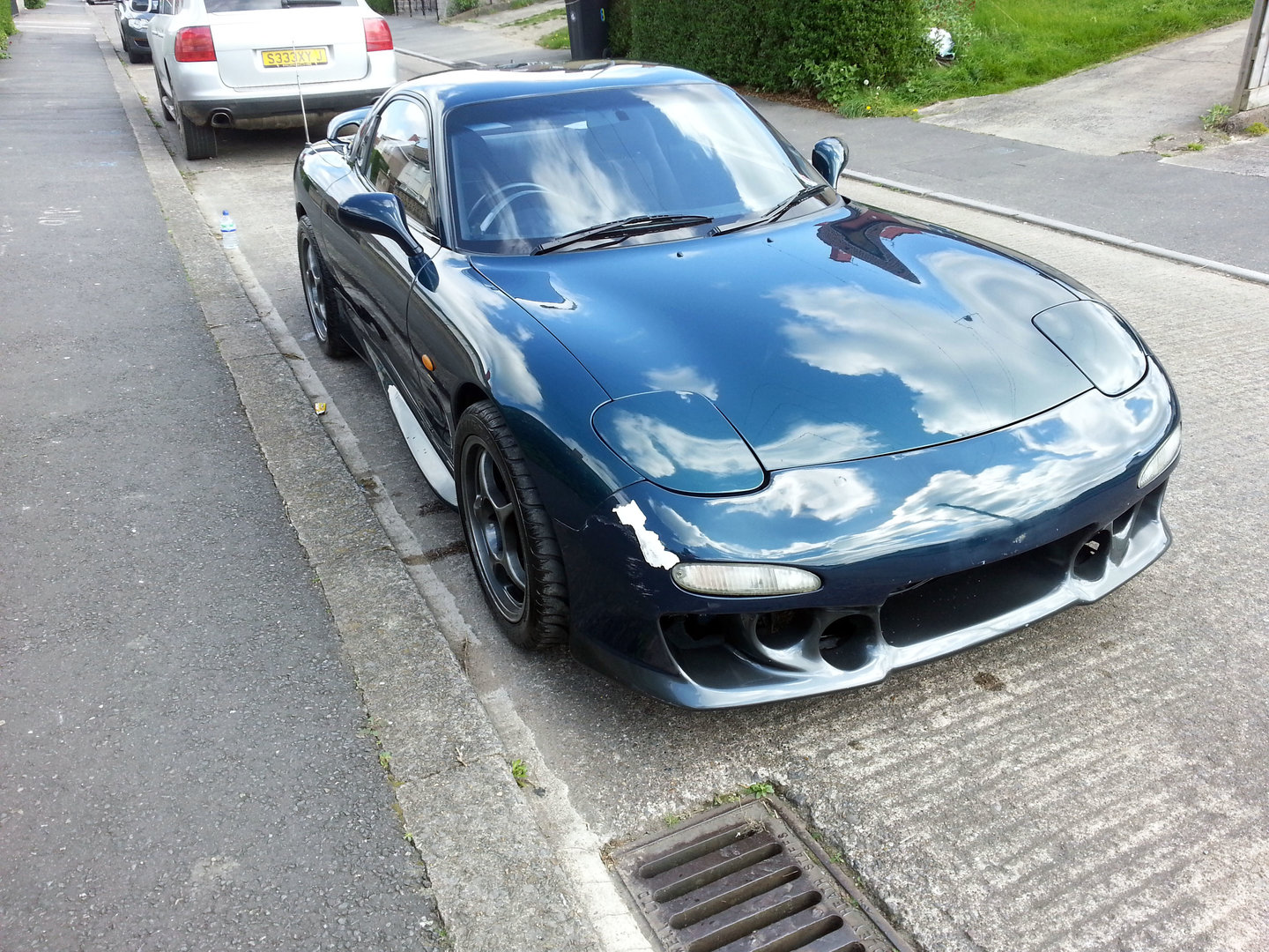

some pics when i got this car 5 years ago.

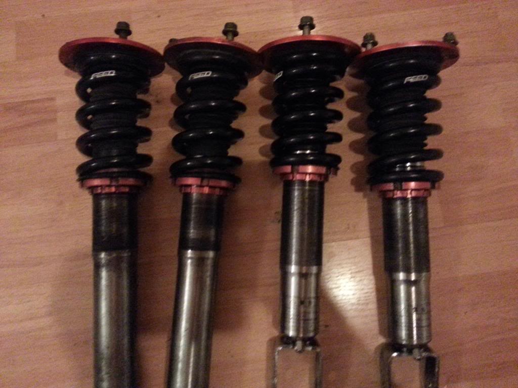

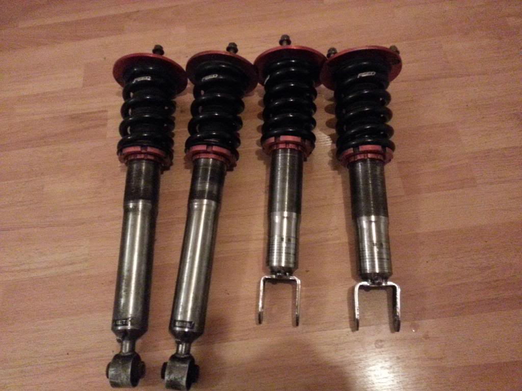

Feed Pro F09 Coilovers 16kgs Front 18kgs Rear
These were too harsh for daily driving. However they transformed the fd when driven on smooth slick roads. That woolly feeling of the car being a wet noodle in the corners was gone. However they were not suited for UK roads. Ideal for track use.

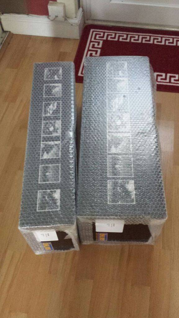

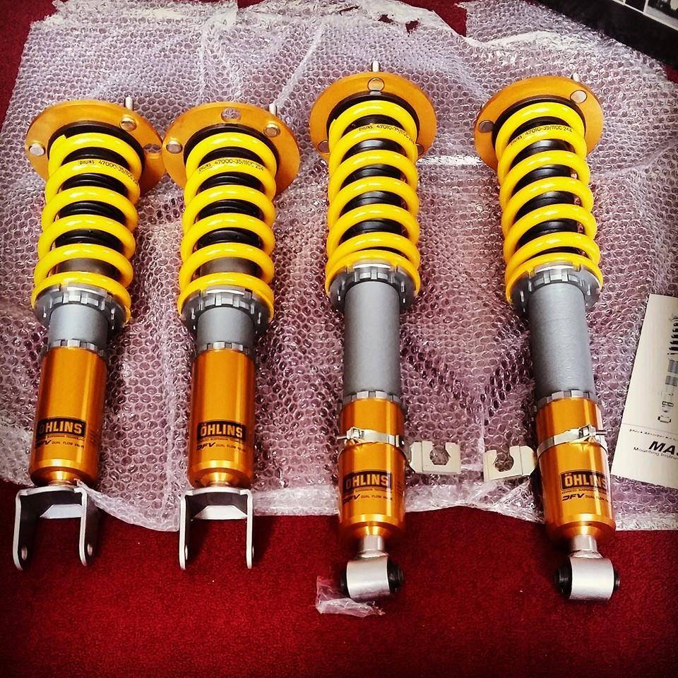

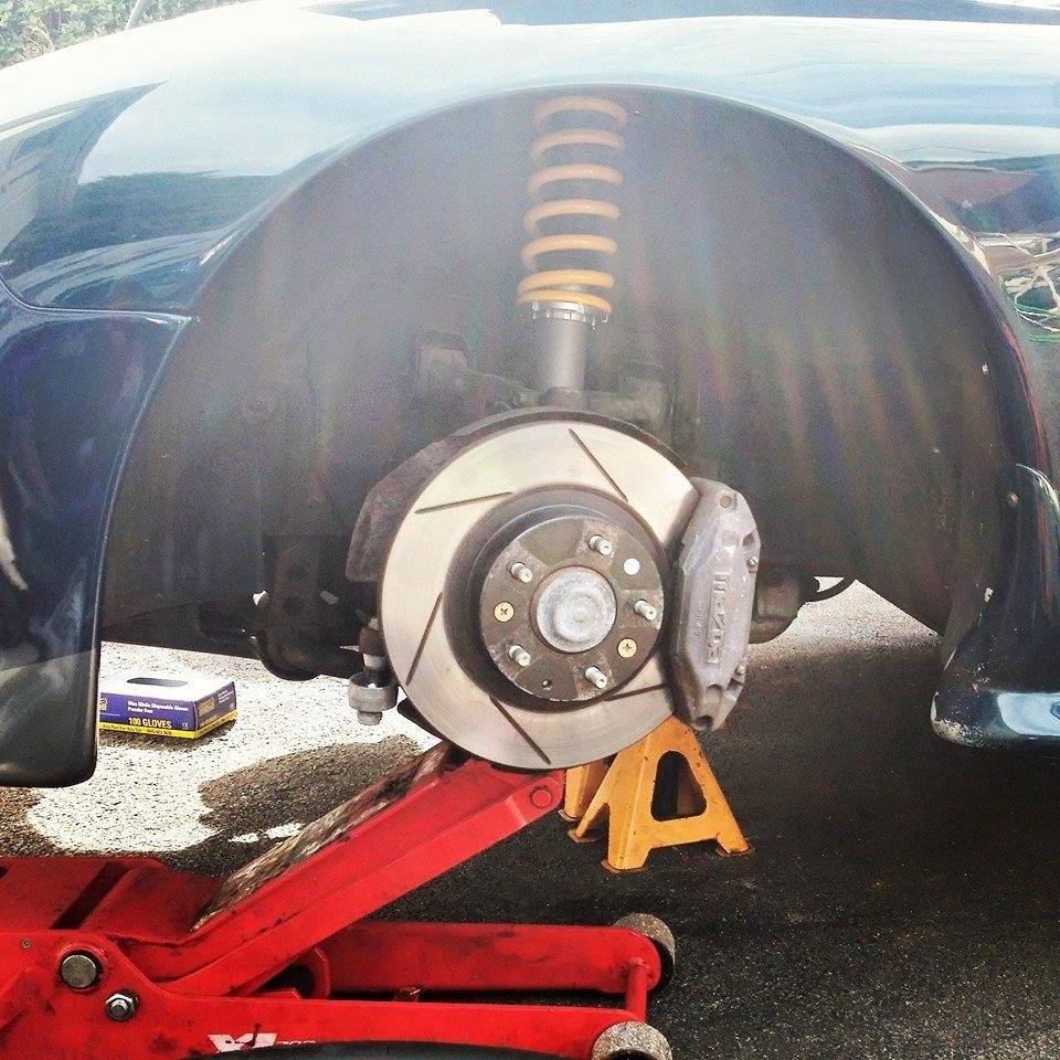

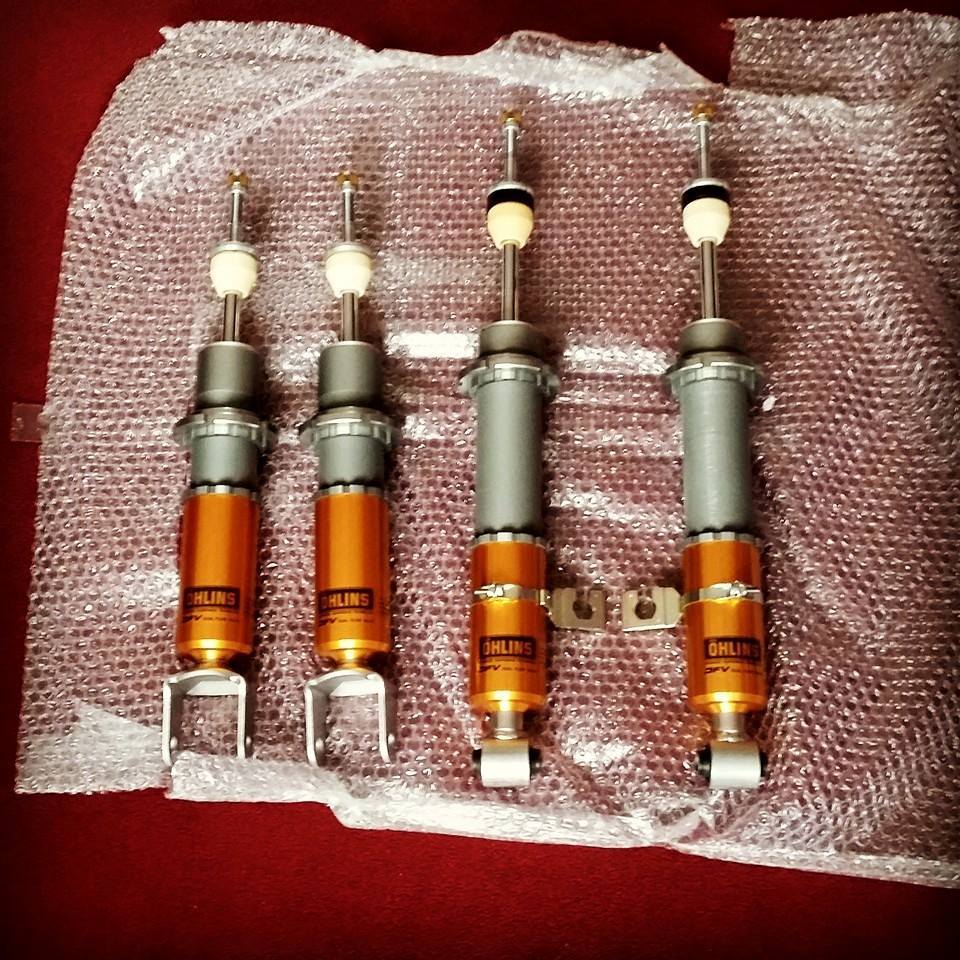

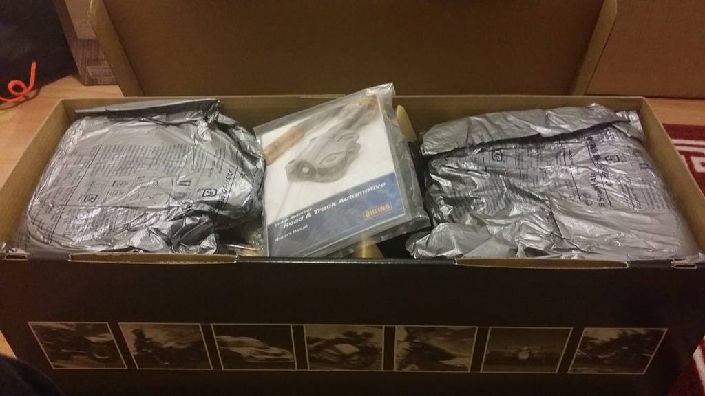

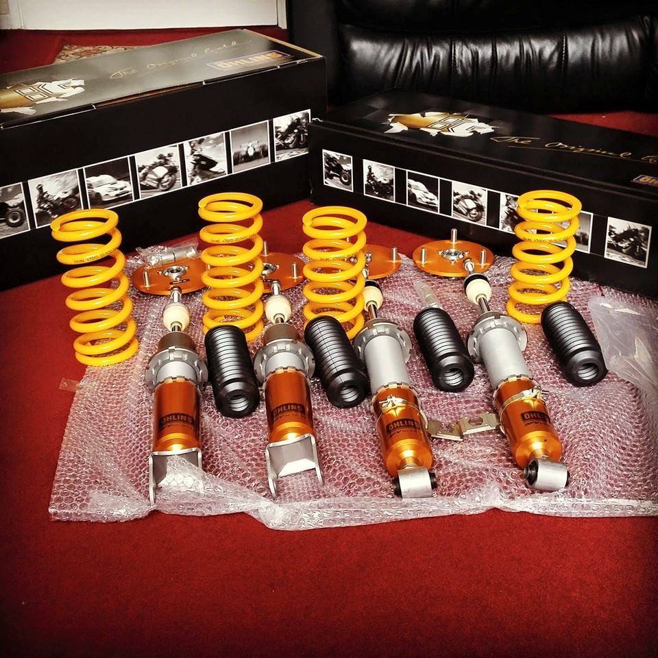

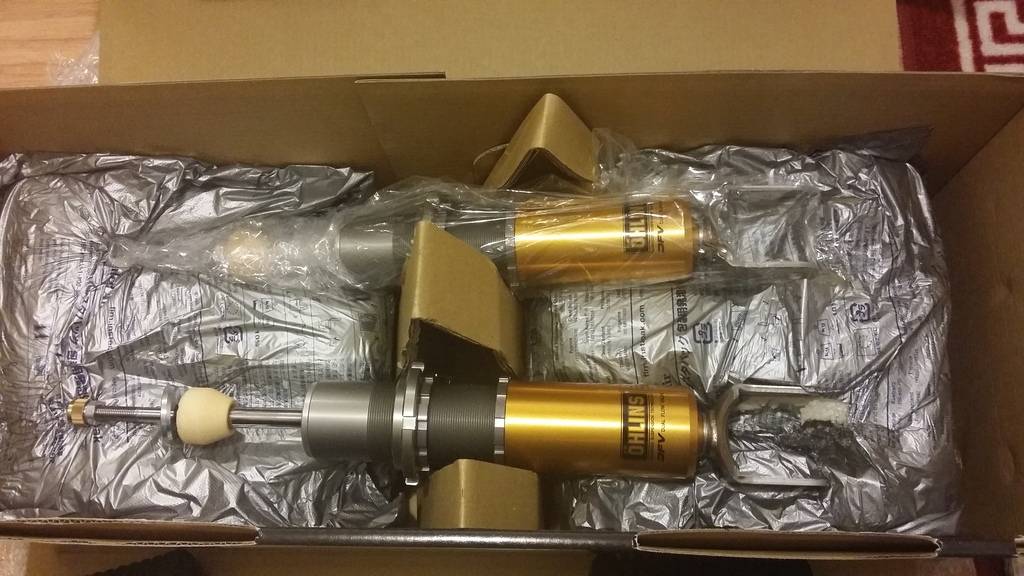

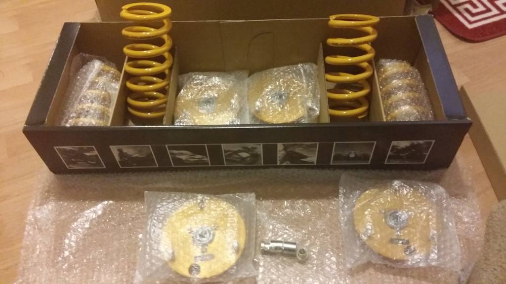

The Feeds were too harsh for street and track so after lots of contemplation I went for the Ohlins DFVs.
These are ideal for what I will use my FD for which is 80% Street and 20% Track.

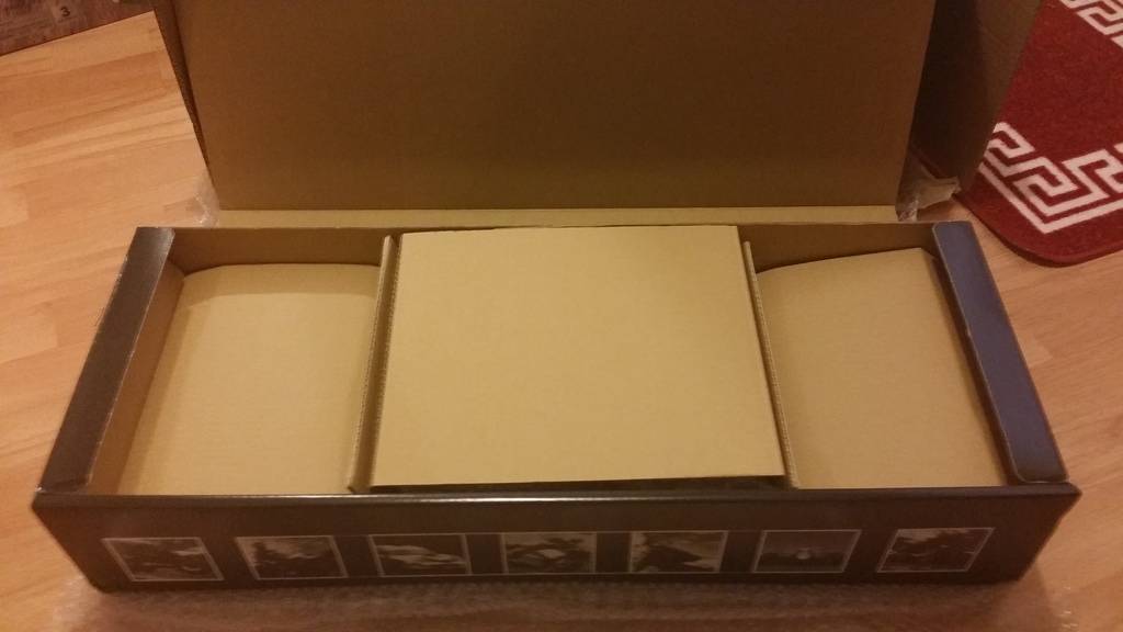

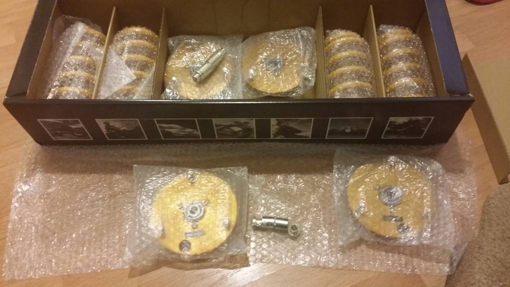

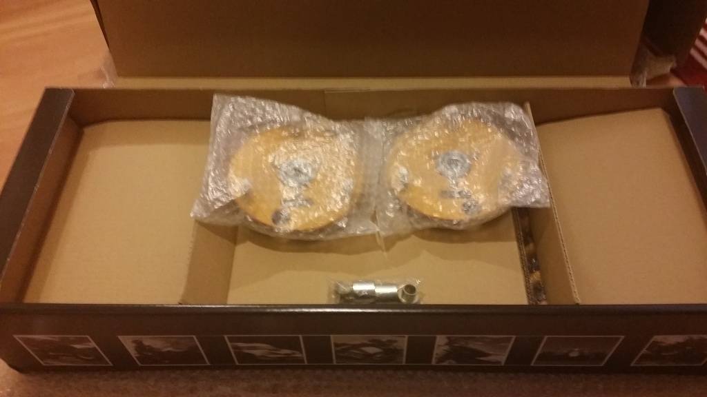

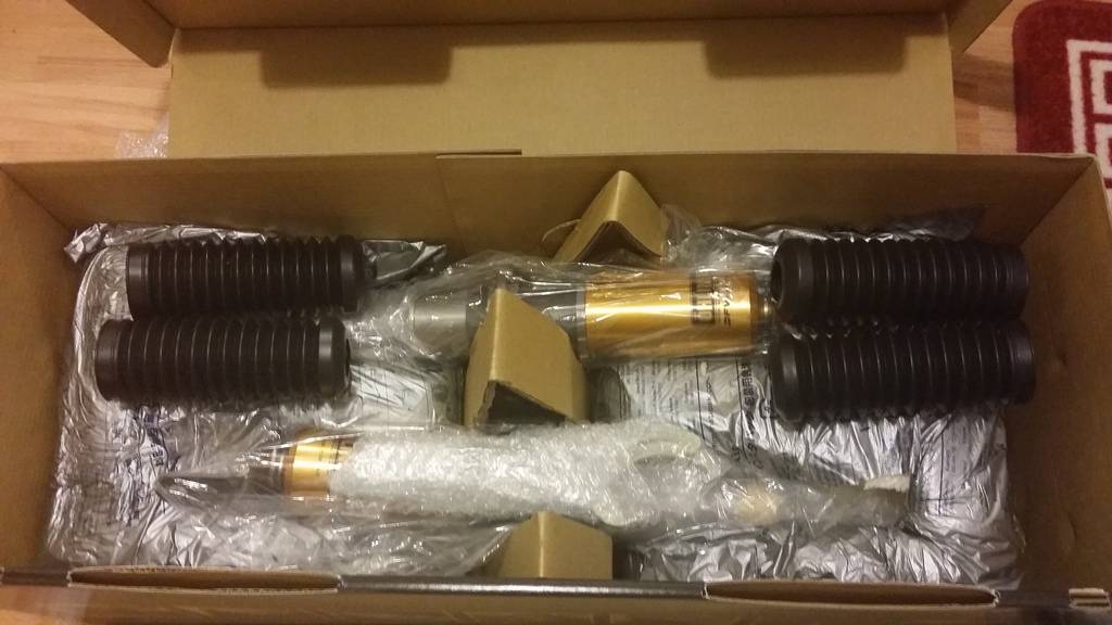

Pics of the unboxing process through to assembly. Best Coilovers Ive ever had the pleasure of owning and they completely transformed the car.

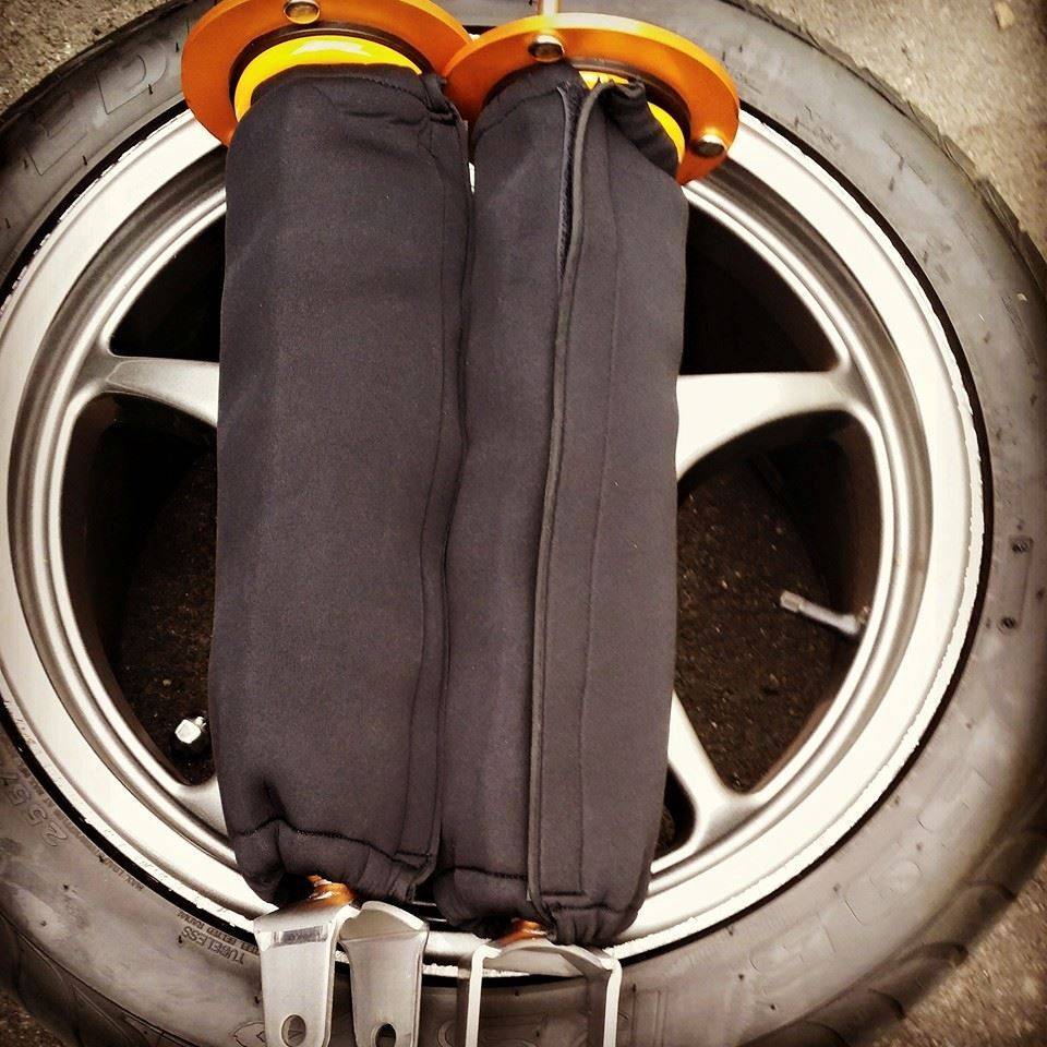

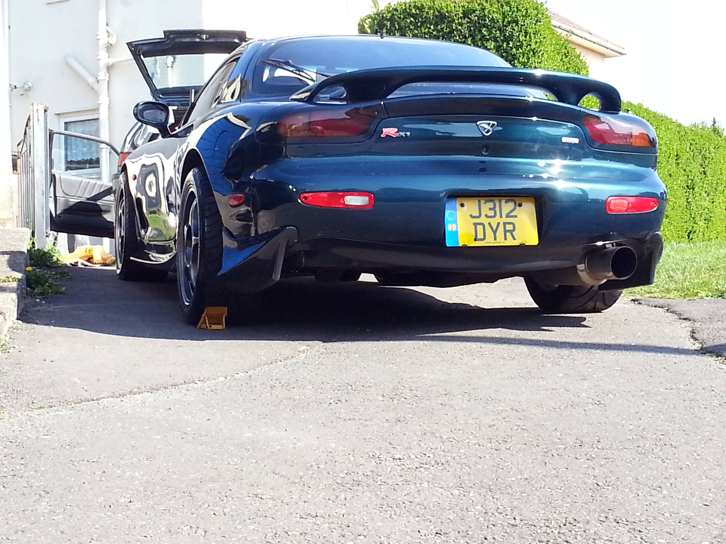

Installation, protection and ride height as per Ohlins recommended setup in the Manual. I believe the ride height is 20mm lower compared to stock

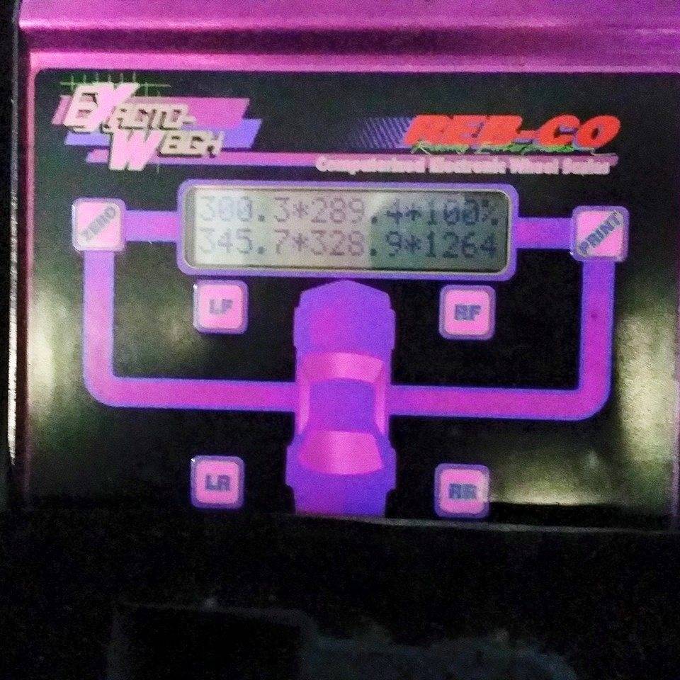

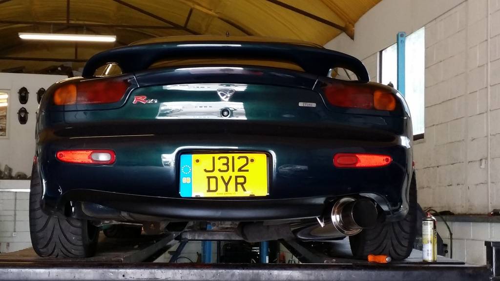

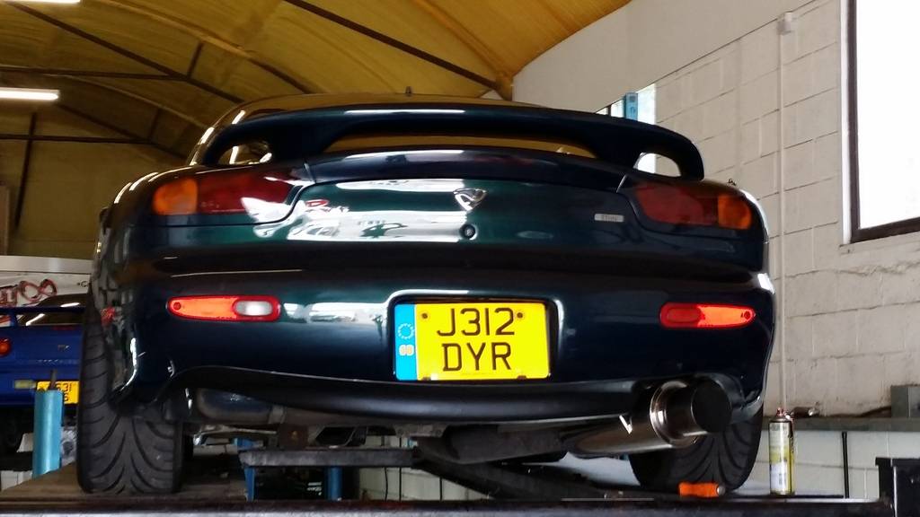

No coilover setup is complete without corner weights and full geometry setup to maximise its potential
At Avia autos to get this sorted
Weighed in at 1264kgs with all fluids at MAX. As you can see the right side is lighter compared to the left. The FD is almost perfectly balanced with me in the drivers seat. It would seem the Ohlins setup up data is accurate as long as your FD is close to stock weight.
All Tweaks and final suspension tuning dialed in....How the FD sits now.
Final Setup
Front Camber -1 Degrees
Rear Camber -2 Degrees
0.5mm Toe in front and rear.
Caster 7 Degrees
Its a neutral setup and feels very agile and nimble. Also confidence inspiring in a straight line.

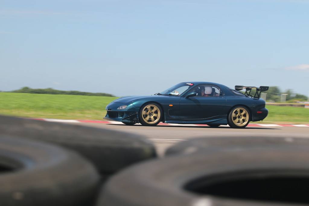

Able to hold its own against a CBR600cc. Head to head runs which was a bit unexpected.

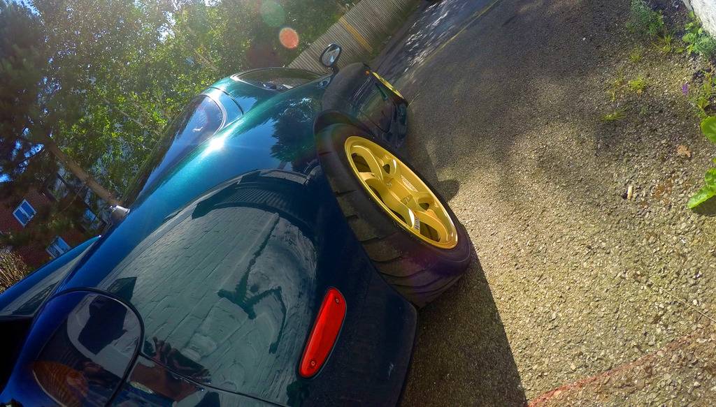

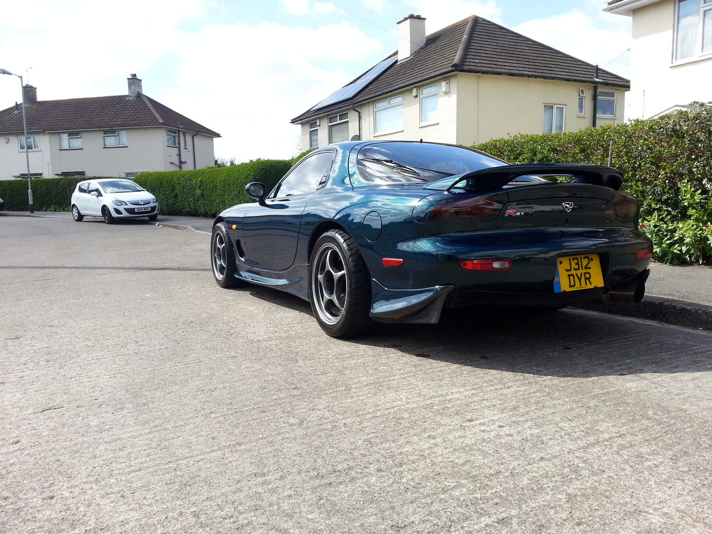

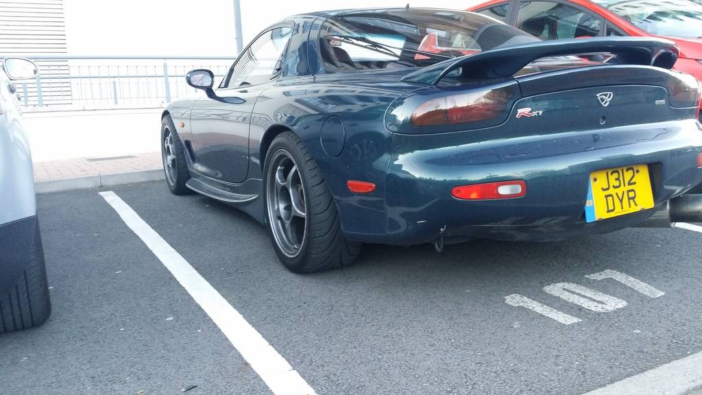

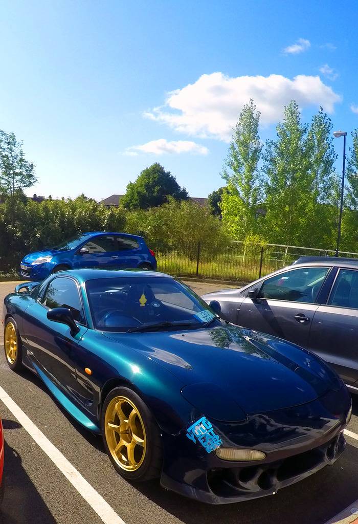

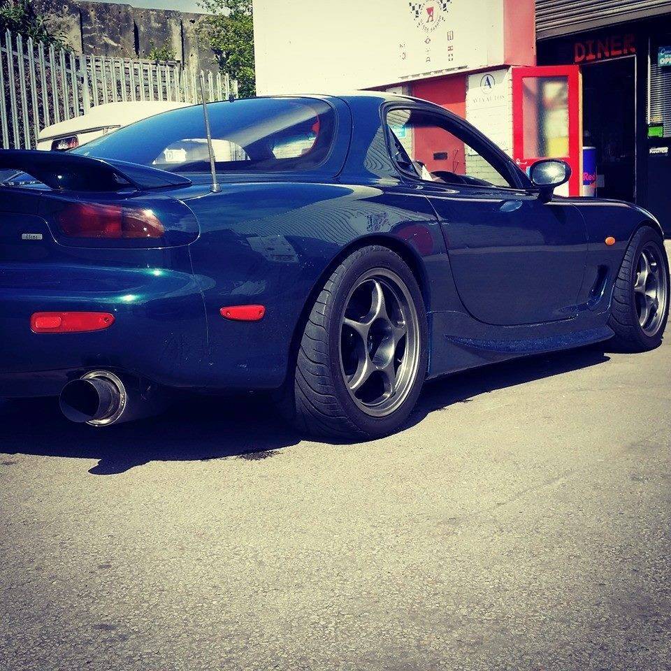

Got new wheels and tyres
Advan RG2 GOLD 17x9 et35 with Toyo r888 255 all round; 5mm spacer rear.

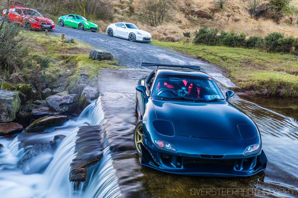

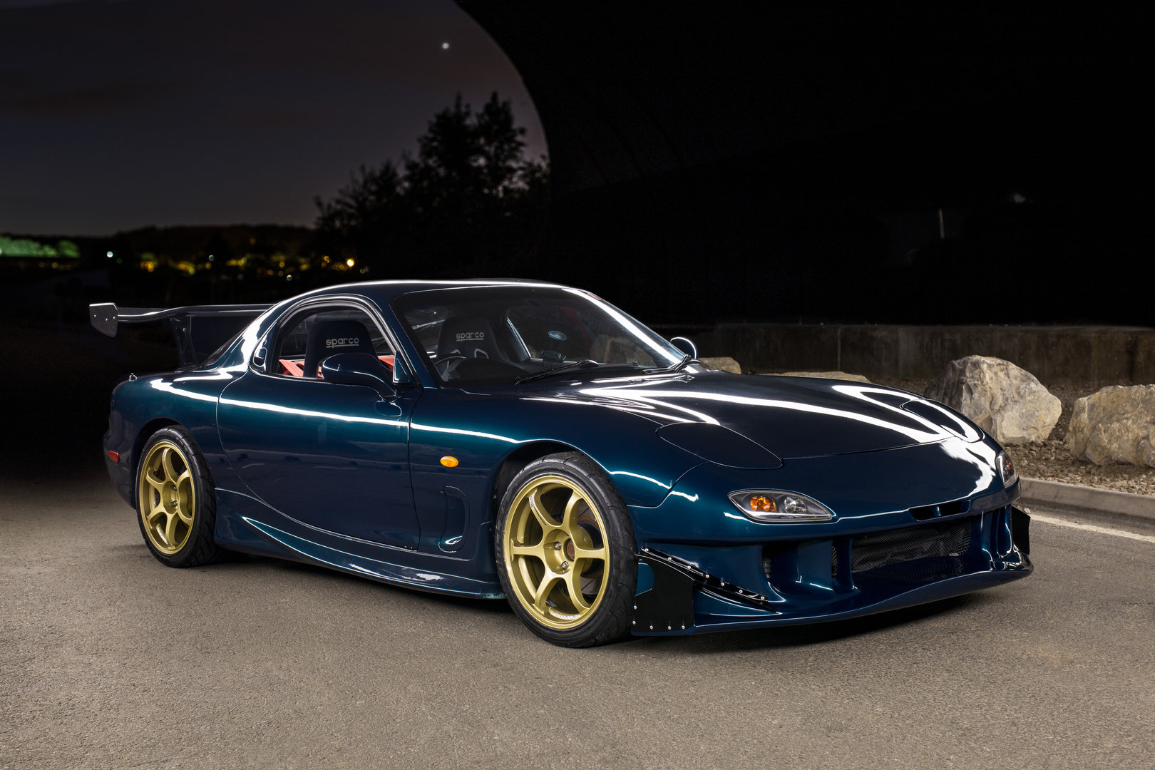

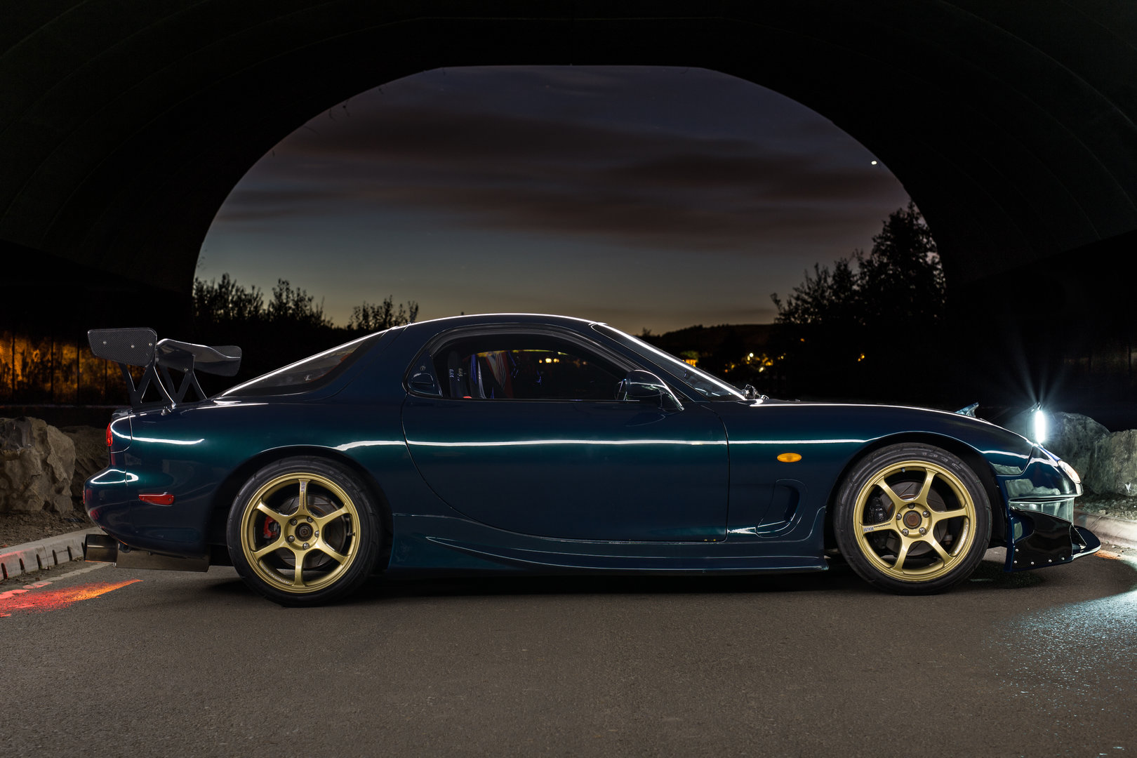

Got the FD detailed and this has been the cleanest its ever been in my ownership so got the Go Pro out and took some pics while the sun was still shinin
More Pics of the small aesthetic changes I made

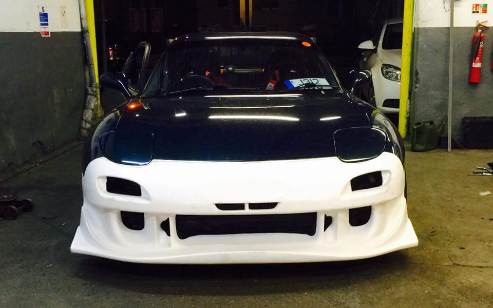

Before
Oem 92 wingVeilside rear spats
After

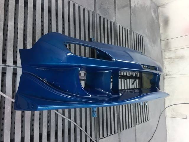

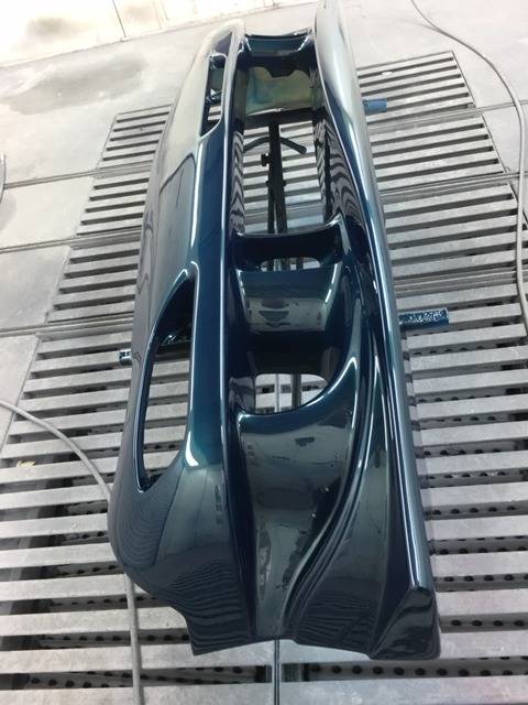

Reamemiya Front Bumper ADGT
Sard 1500mm GT PRO Rear Wing
Removed the ugly veilside rear spats
kept the side skirts as it flows well with the re front bumper

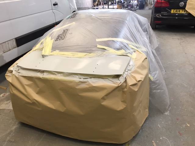

Its the dreaded rebuild time.
Car has been with Frank @ FB Rotary since Feb2018 to current.
This means I've missed a lot this year in terms of building and developing this FD. Missed pretty much everything from track days to car meets to sunday breakfast drives to driving the car itself in general.
Im hoping to have it back over the next few weeks so watch this space.
Ive got a ring trip booked and planned for October. Im hoping the FD will be ready for battle once again.

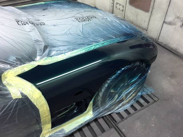

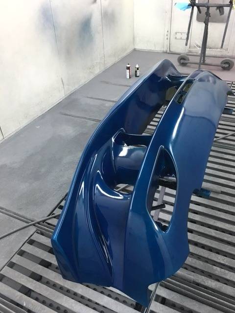

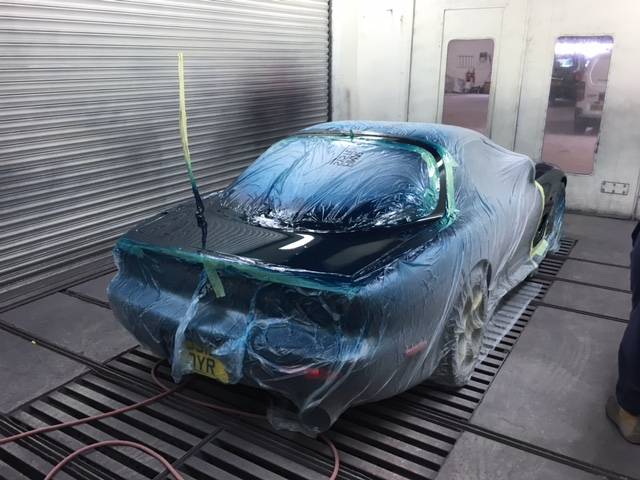

So whats is Frank been doing to my fd since feb this year?
Large Street port rebuild

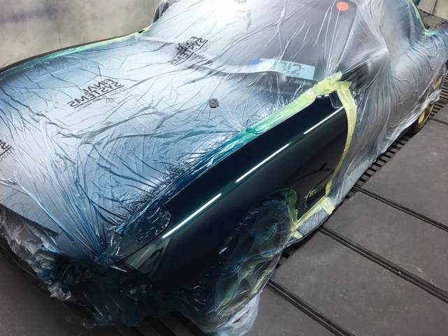

Engine bay respray with a complete wire tuck
Final drive has been changed from oem 4.1 to 4.44
Bosch 044 Fuel Pump
Line lock and tilton flow valve

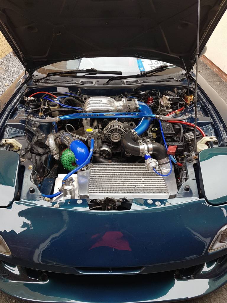

Ive missed a few things for sure but the biggest change will be how the current engine bay looks
Franks run into a lot of teething issues post rebuild and hes been working very hard to get it all sorted. so hopefully there will be some updates, more details to follow, Watch this space.

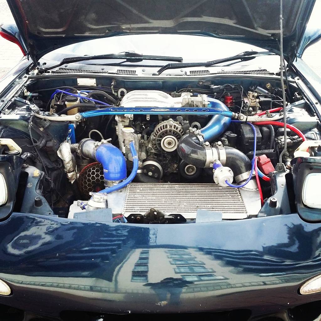

For now this is how the engine bay looked when it was dropped off in Feb
