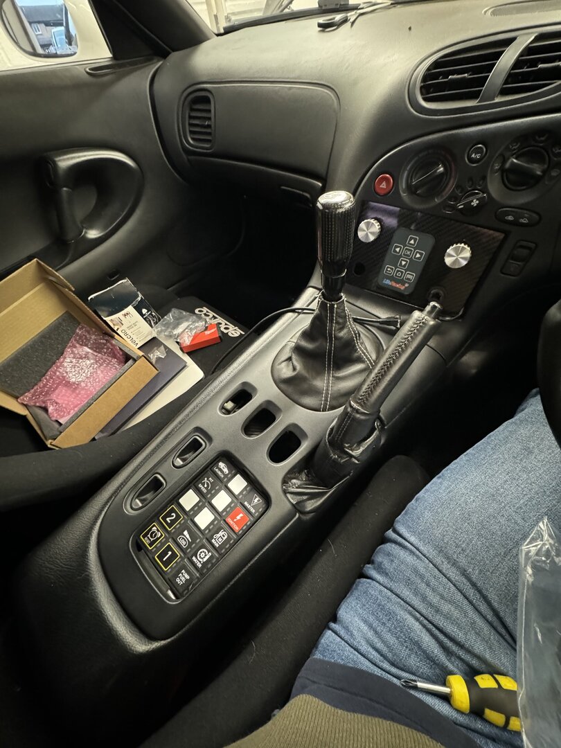

I’ve had to lose the 2 buttons on the centre console (1 was a blank) but one buttons was front fogs which I don’t have and the other rear heated screen which I don’t need and well #racecar so no big deal.

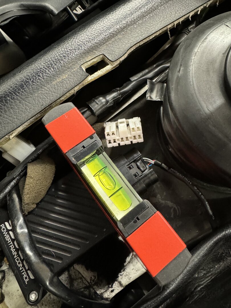

Black alternator looks a bit neater I think.

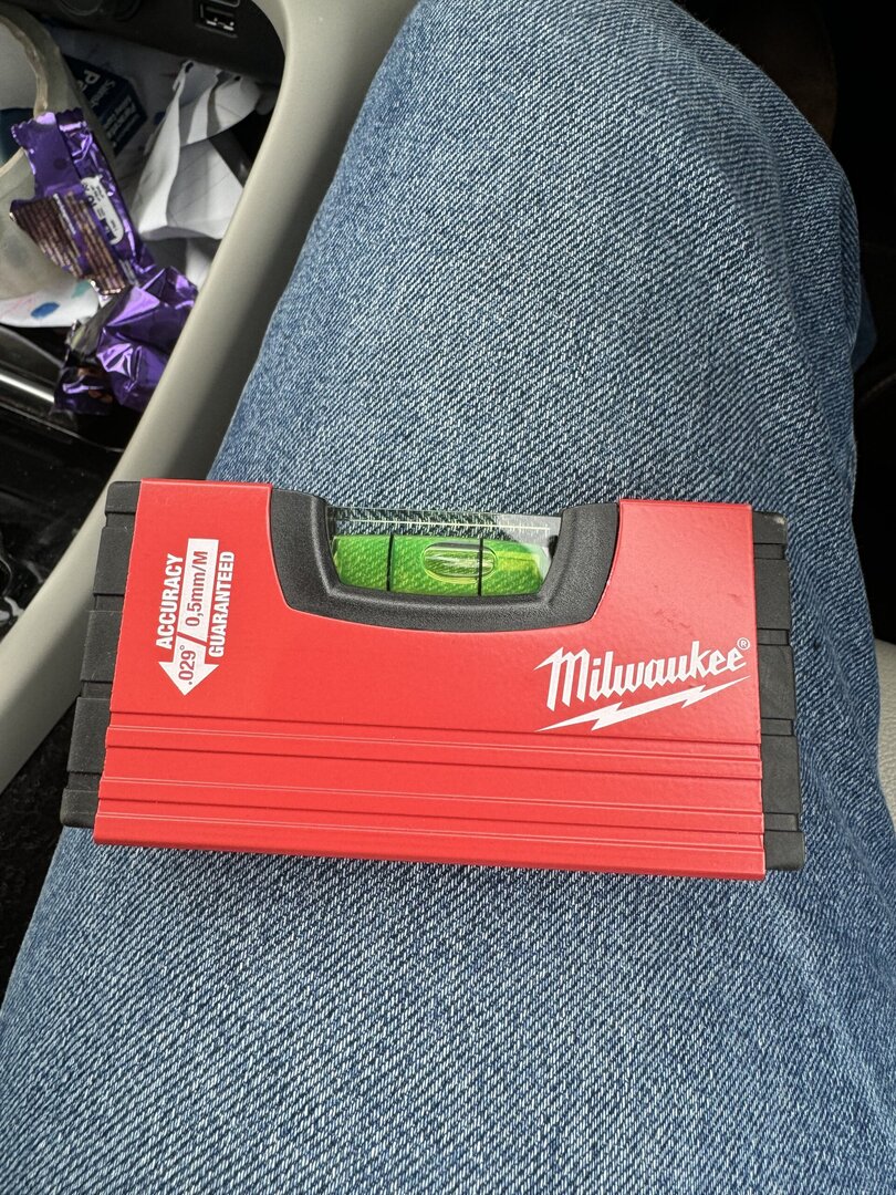

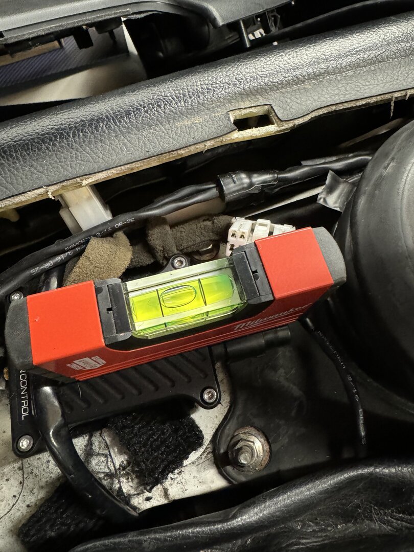

Also quite proud of my little Milwaukee spirit level. 😂

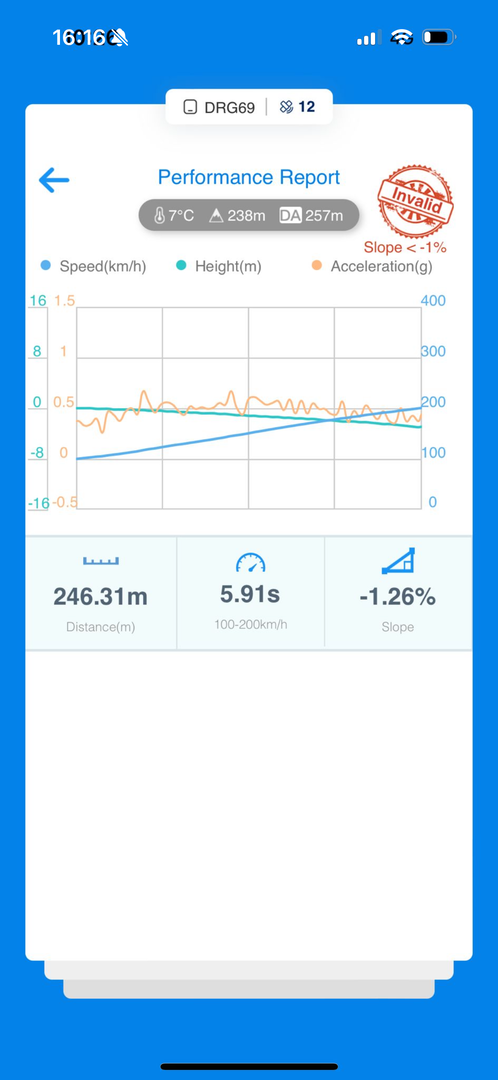

This is a 14 psi pull dropping to 9psi and throttle closing to 30% passed 9000rm. That has been removed for next set of testing.

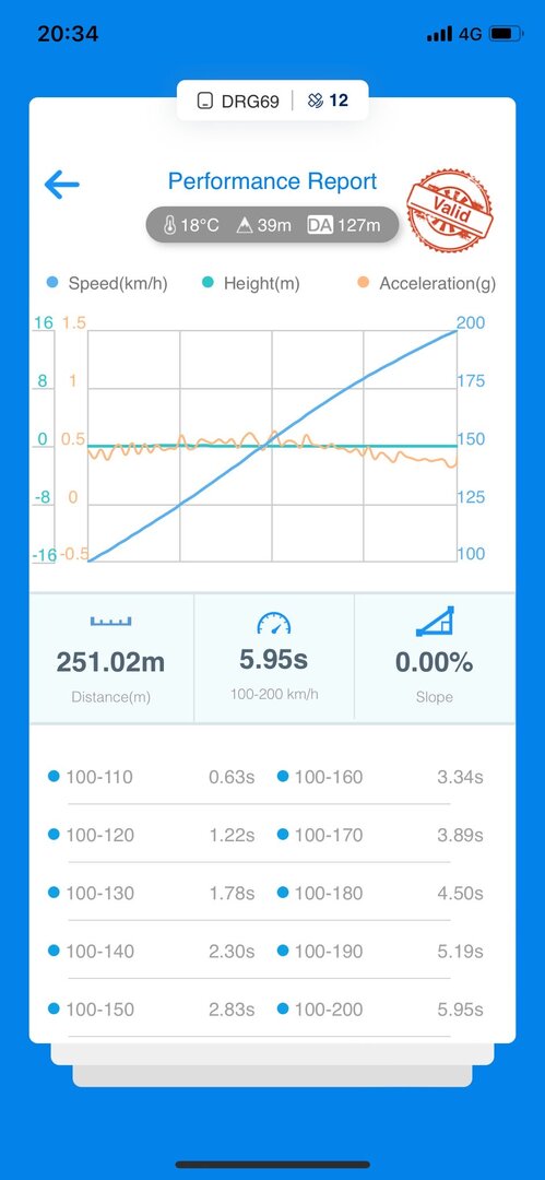

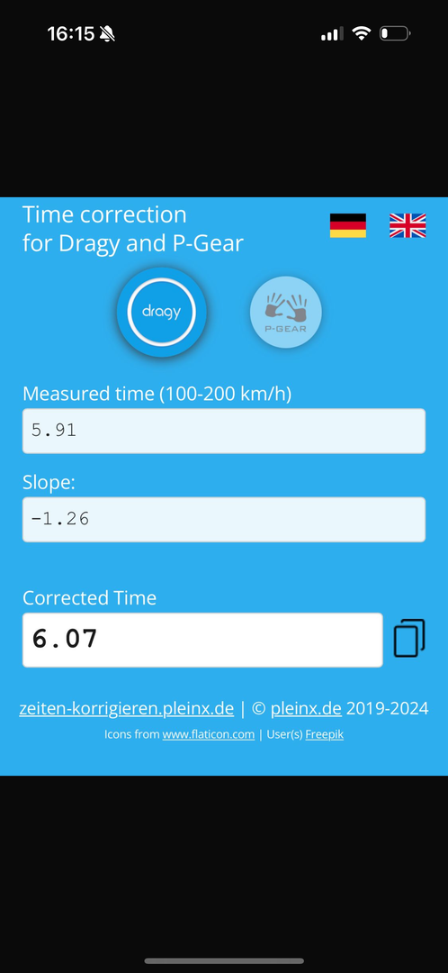

Technically the run was invalid due to the slope but corrected we get a 6s 100-200kph.

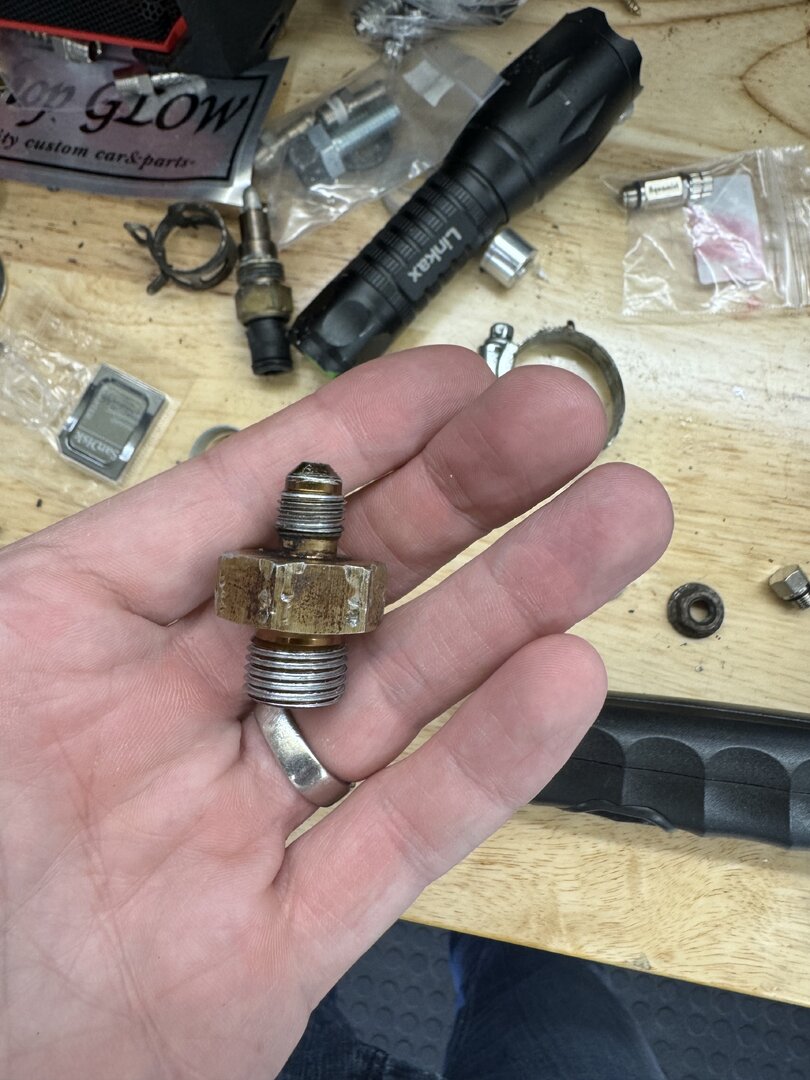

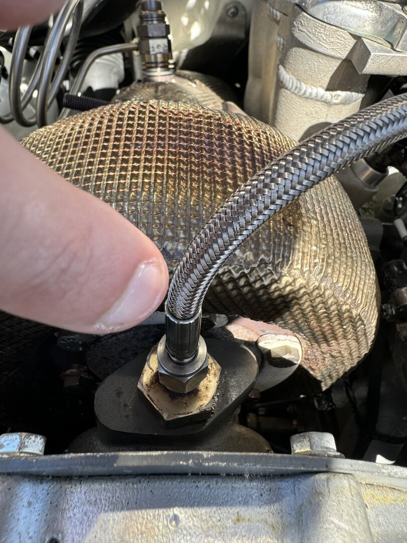

I was literally about to drive away when we spotted that the brand new less than 50 miles old turbo oil feed pipe has failed at the turbo end, good job we caught it before I drove the 50 miles home, no doubt the car would of gone up in a blaze of glory.
The annoying part is that it’s brand new from Hosetecnik which as far as I can tell is part of Forge Motorsport, im sure they will sort it but it has meant the car has to stay in Wales whilst I go and get this resolved on Tuesday as they are now closed. To make matters worse it’s absolutely glorious today, 17c and sunny. 😢

I had a new turbo oil line made up but added a 90 degree bend to reduce the chances of another stressed/broken line. Also sorted an annoying leak at the turbo oil adaptor fitting. No more oil leaks.

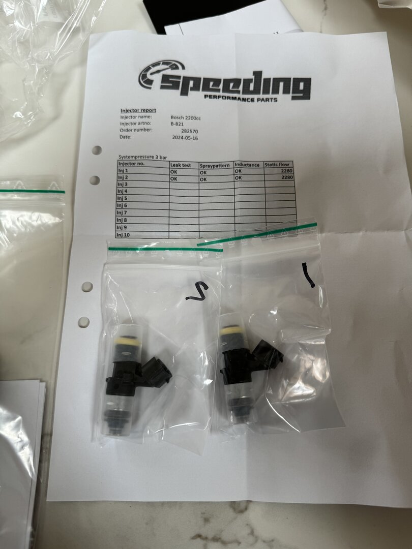

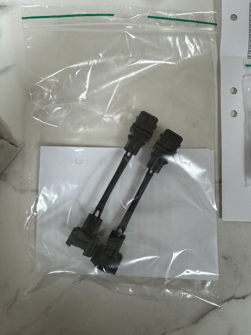

We’ve had a long term issue with 3 to 3.5k area of the map on cruise where rotor 1 would be a lot cooler than rotor 2, a change from the 1650s to the Bosch 2200s has solved that issue. To make the swap easy I just bought the little adapter looms too.

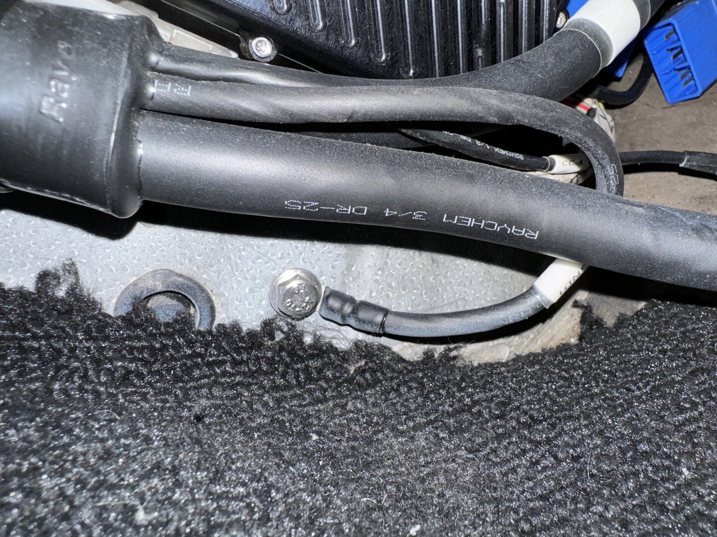

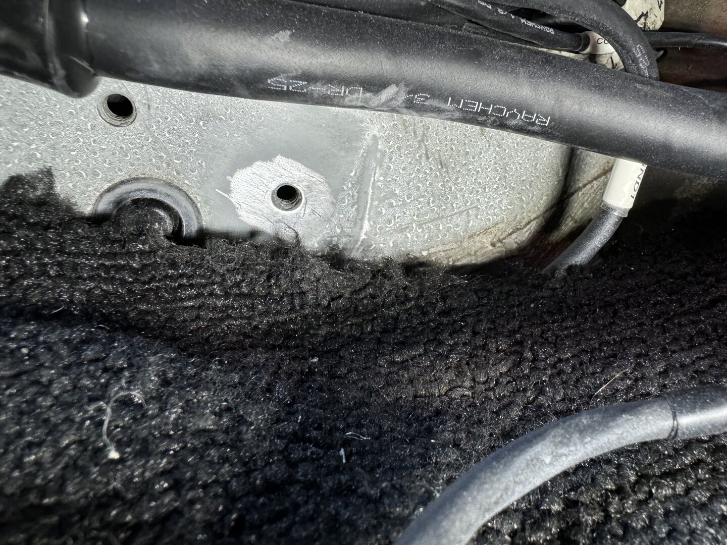

Ive also had an intermittent issue with the dash losing power, it’s been few and far between but In order to stop it happening again I’ve been checking all of the earth points of new loom, the very nature of the car is that it vibrates a lot so just trying to get a solid reliable base.
Cleaned up the main ECU earth point.

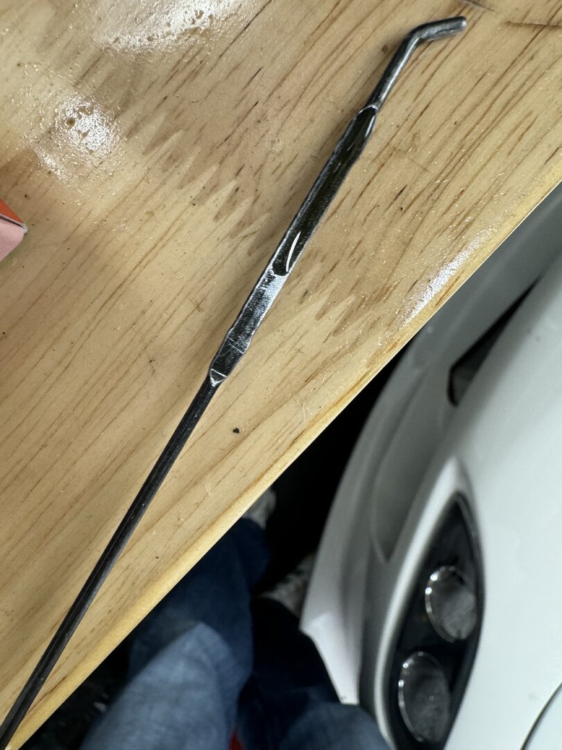

Colum schooled me on needing to run 3/4 on the dipstick as the sump has a bit more capacity and as such can result in filling the catch can more regularly, that’s exactly what has happened so will fill a little less this time round.

In more positive news, at 1bar (lowest possible boost setting) the car did a sub 6 second verified 100-200kph. This is using third gear only, with a 2nd to 3rd shift I think a few tenths can be shaved off.

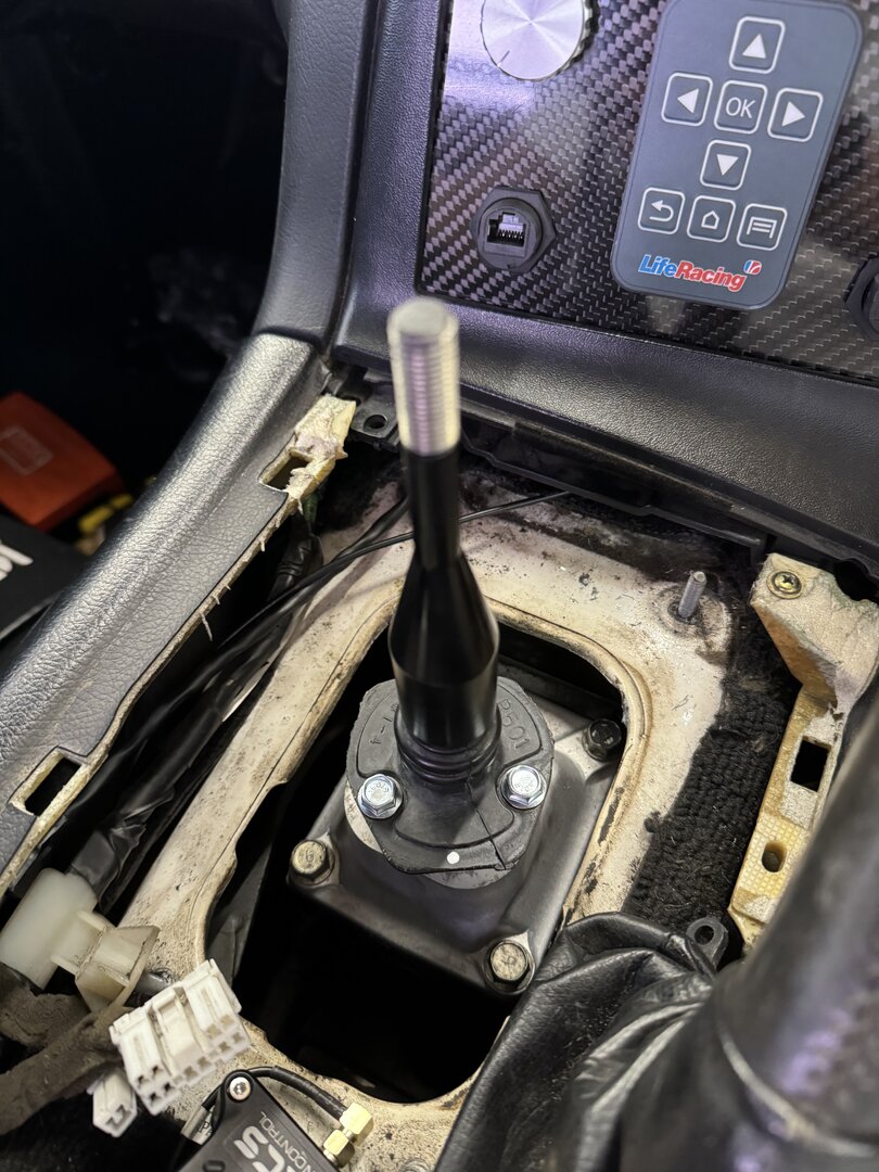

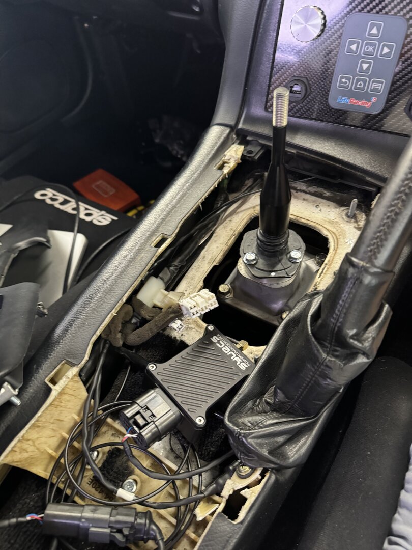

I’ve swapped out the GRacing short shifter for the JP3 short shift kit from USA.
It’s based on the Mazdaspeed/ C’s short shift kit and hoping that this one will help with the accuracy of the 2nd to 3rd shift.

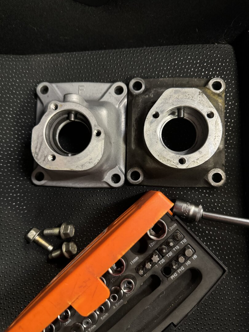

Swapped out from the MX5 to RX7 gearbox top mount.
Fitted the new shifter with spacer and gasket. Also topped up with a little gear oil.

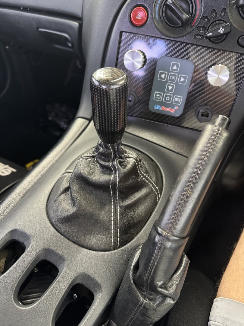

Fitted the rest of the gear surround and carbon gear knob.
Next mission is get as close to 5.5s 100-200 at 1bar. Wish me luck.
Pleased to say the shifter is spot on. Very pleased with the general feel and its ability to shift smoothly and accurately.
I’ve not practiced too much yet as not had the time and quiet roads to do so but early indications show 2nd to 3rd shift is around 0.6s in terms of shifting and being back in the power band so we’ve enabled flat shift.

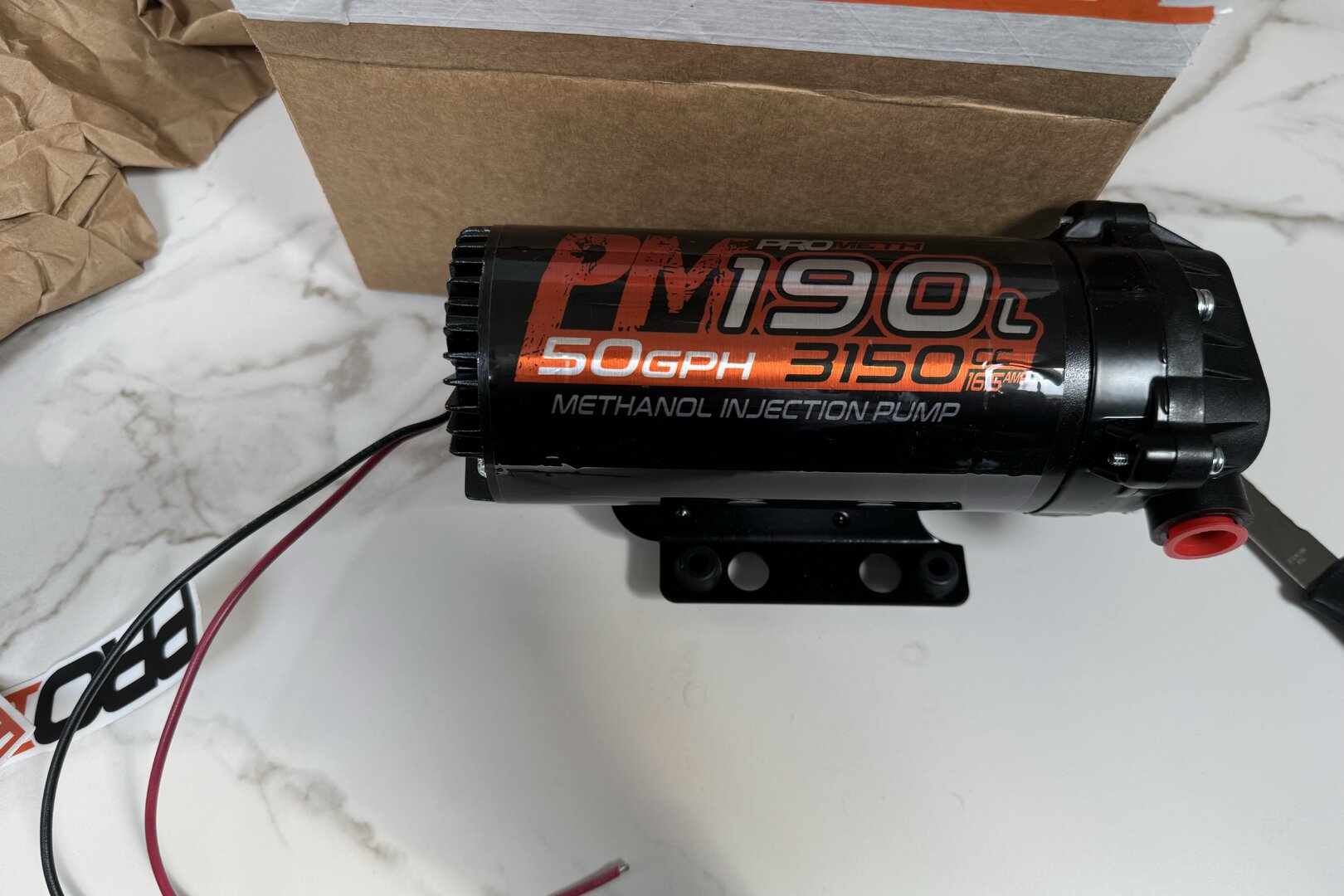

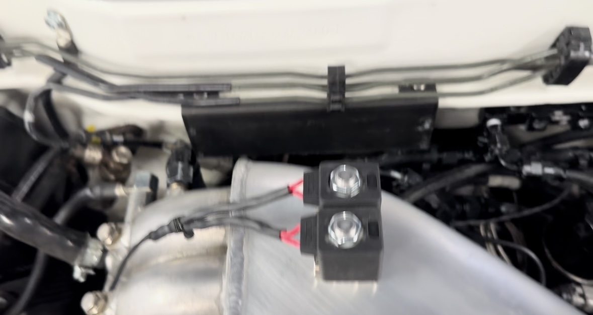

The Aquamist water meth set up has just not worked for me so decided to rip up and start again replacing with Pro Meth products which is what I should have done from the start, just at the time Prometh didn’t have the jets I needed, turns out they do now.
I’m aware that Aqua tec manufacture the pumps and the likes of Devils Own, Pro Meth and Aquamist put their branding on but I decided to go up in pump size to help get the flow. Pump is currently with Matt at LMW having the correct loom plug added.

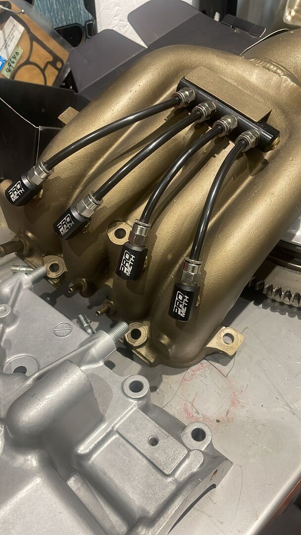

Next up I’ve placed an order with Pro Meth for a very similar set up to this but with braided PTFE lines to deal with the methanol. Colum is going to help with some basic bracketry.
It turns out the 1600cc Aquamist solenoids are basic £15 welder solenoids that they sell for over £100 each. These will be the only elements I keep as they are proven to do the job.
Next up I pulled all the lines off the water meth system as kept getting build up in the jets reducing flow - still not entirely sure where the debris has come from but upon inspecting the tank you can see it’s full of debris, next step is to clean all lines and tank so before refitting.
Waiting game now to get the new Prometh jets, lines and fittings. Will likely need a new feed line too and a slight amendment to wiring loom to extend water meth pressure sensor.

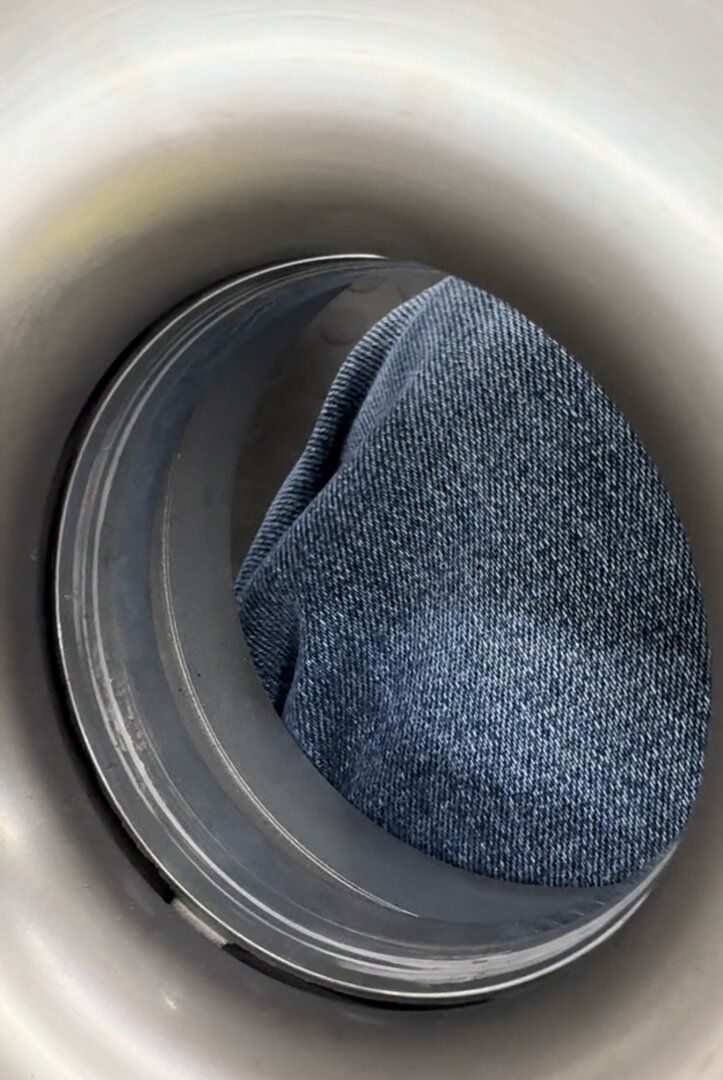

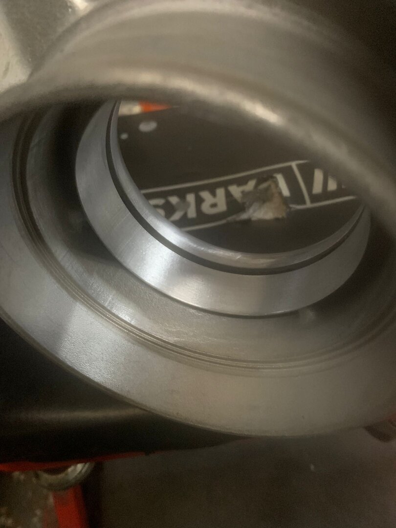

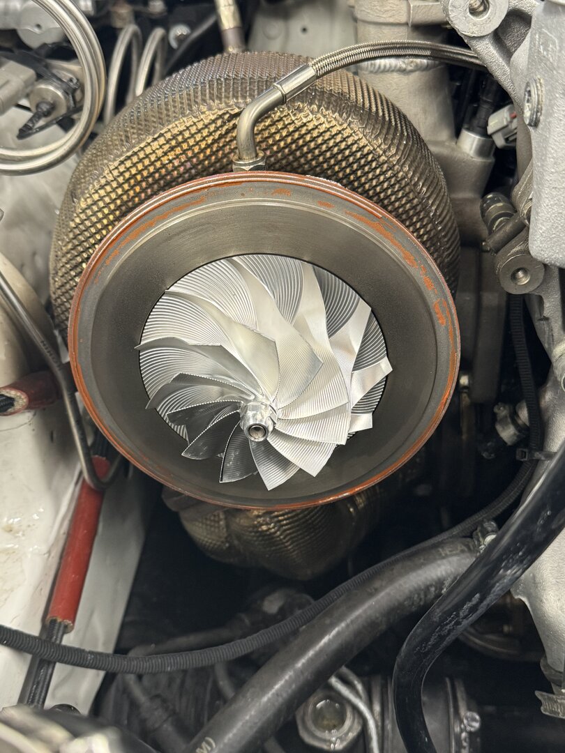

In other news my snazzy 75mm billet compressor wheel was ever so slightly fouling the inside of the compressor housing, I think it just needed a few thou taking out for clearance.
Before
After
Due to have a Winchester sump I was over filling engine oil so removed a decent chunk yesterday as suggested by Colum to run just over the half way point on the dipstick. I was filling catch can too regularly for my liking, this should solve it.
