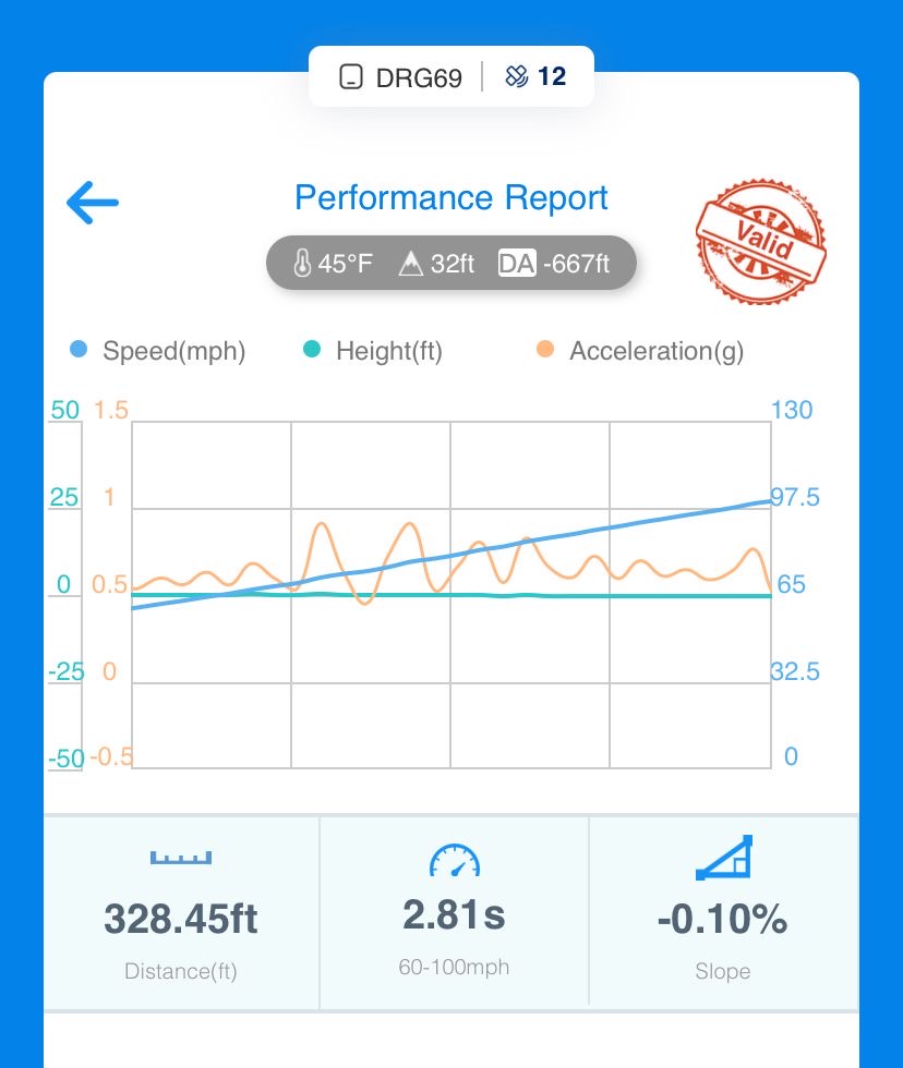

It would seem that for some reason certain sections of the RX7 community won’t accept the 4.65 100-200 Dragy run was just 19psi.
For that section of retards here is a log file clearly showing the cal setting of 2300mb (absolute) equating to 19.35 psi gauge pressure as shown under BOOST column.
It shows rpm, vehicle speed in KPH and more importantly at the top section in the middle of the log you can see the Syvecs GPS recorded time of 4.65s covering a distance of 197metres which just so happens to match the distance covered in the Dragy run. (Bottom pic)

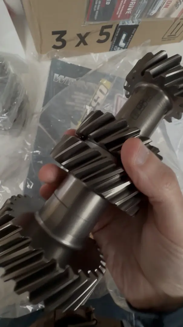

Good news, OSG kit has arrived.

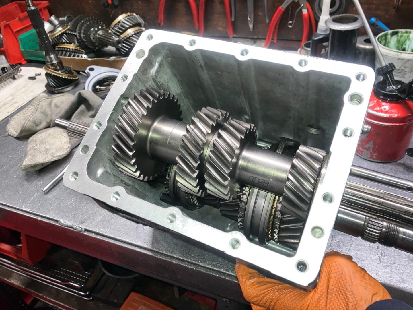

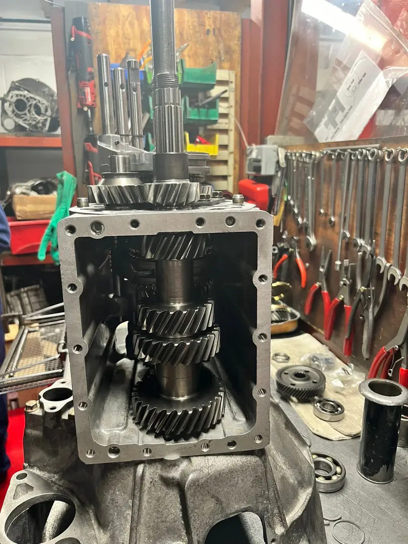

It was collected by Geartech yesterday along with the gearbox, synchros and seals. Hoping to have it back late next week. With any luck it’ll be fitted by end of Feb.

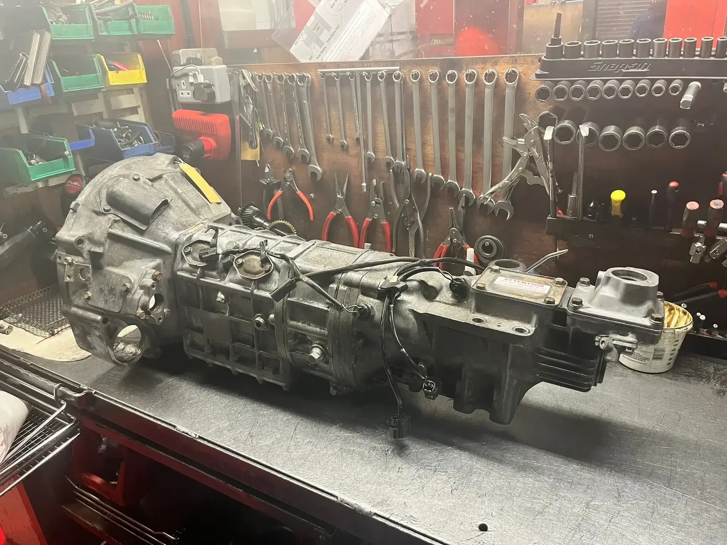

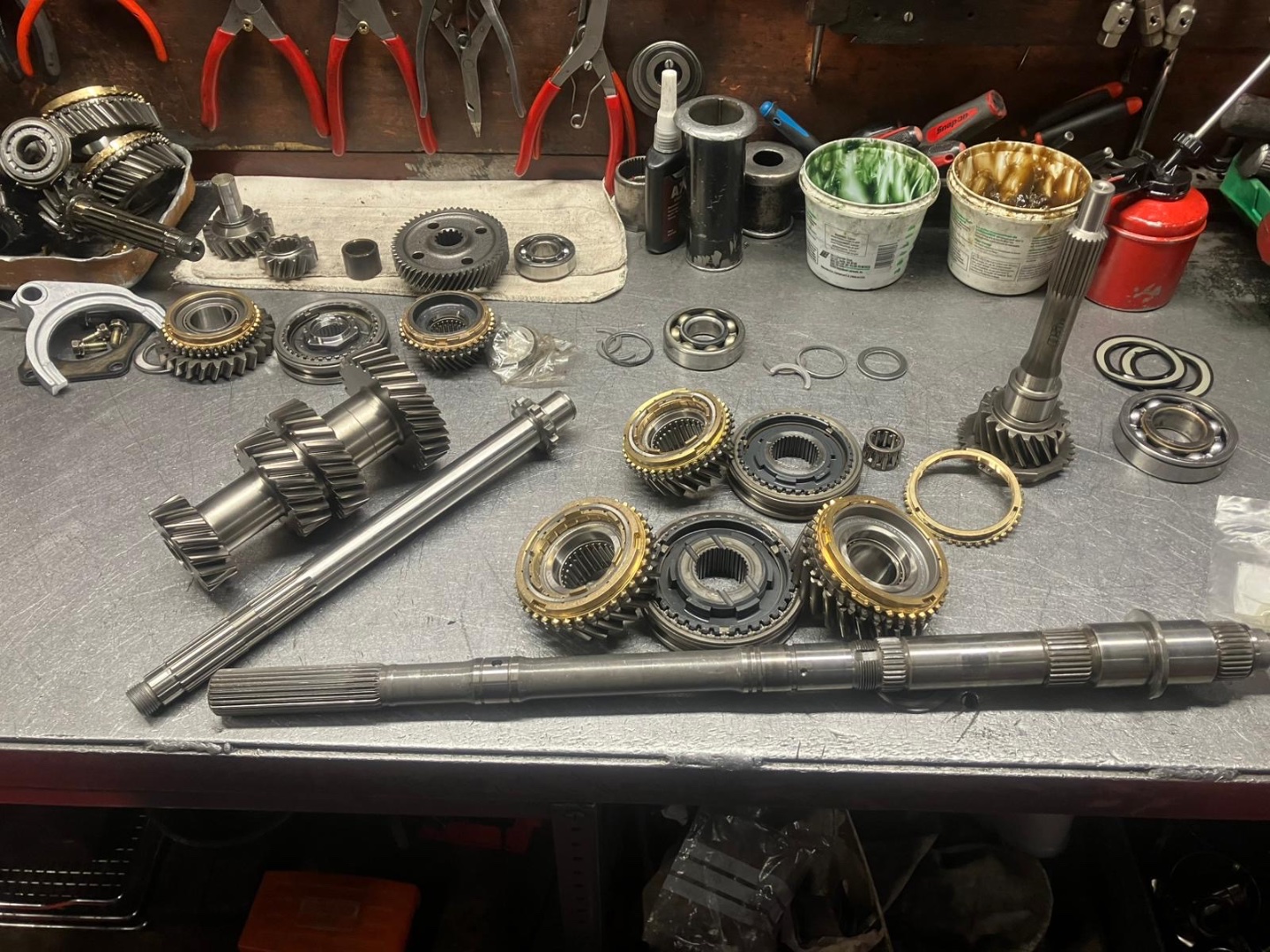

Box all completed by Geartech.

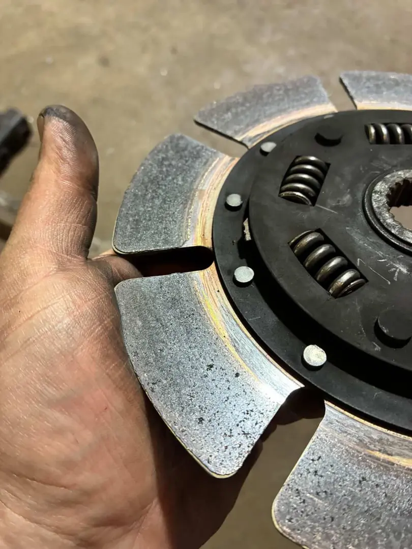

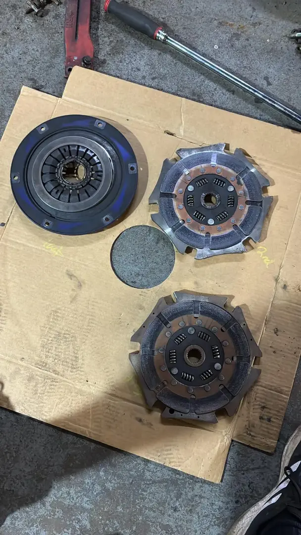

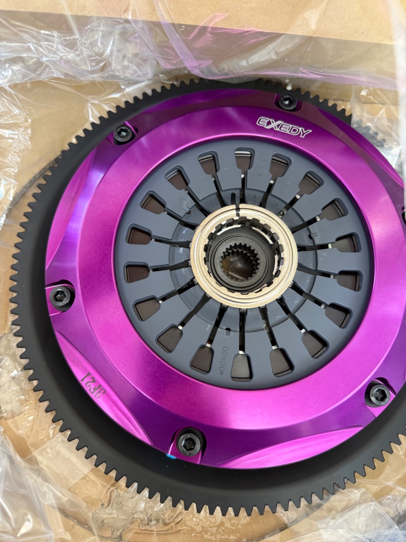

Car was booked in this week to have the box swapped but upon removal pilot bearing was fucked so new one sorted and upon checking clutch it was clear that was in need of a refresh too.
So £1800 later i have an Exedy Twin plate due tomorrow/Monday.
Hoping to have the car back this time next week.
Worn clutch.

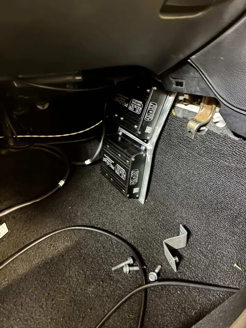

Also had a little bracket knocked up to properly mount the CDI boxes.
Car is now back, I went with the Exedy Twin plate clutch, replaced the clutch release bearing, Input shaft seal and pilot bearing too so all fresh.

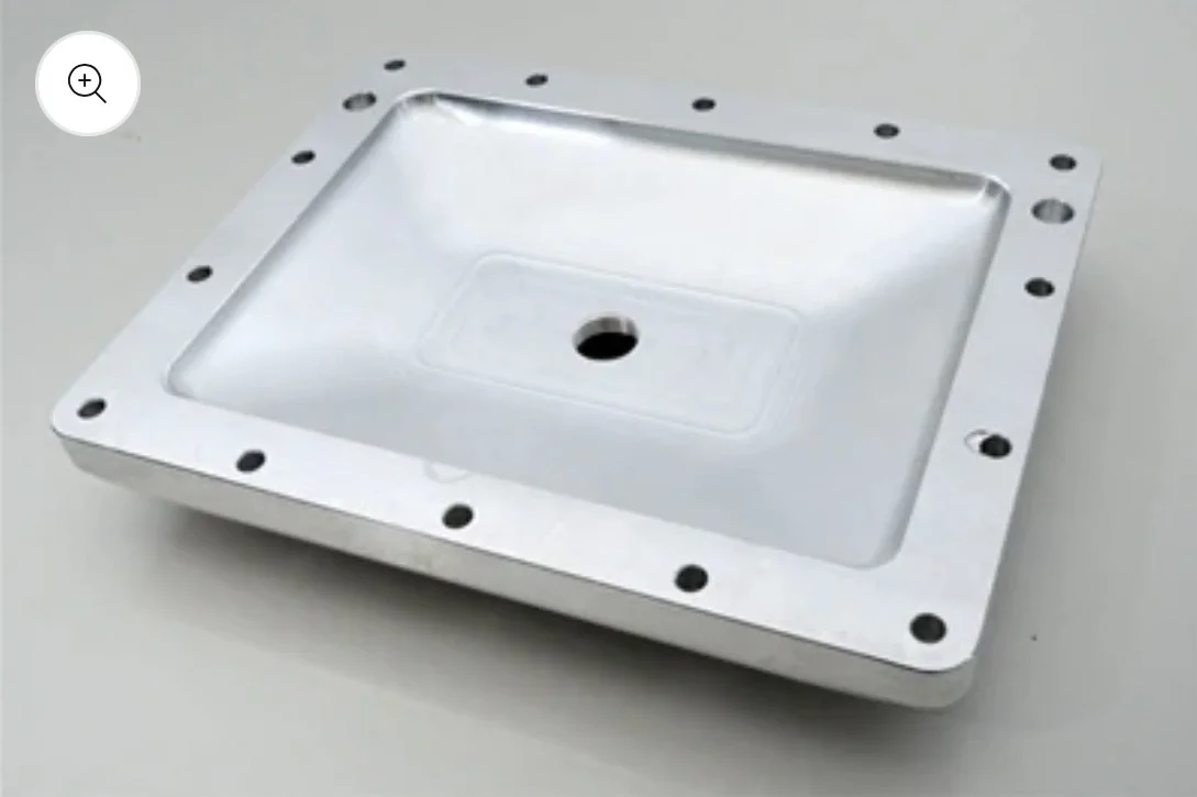

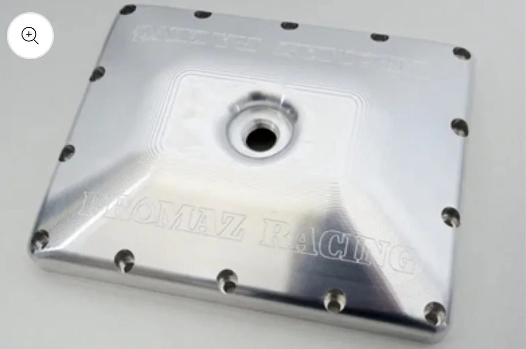

I have spoken to Geartech many times over the last few days, they’ve been very helpful and more than open to inspecting the box if needed but before I go down that route OS Giken who make the gearset wrote back to me today explaining how they’ve had other customers who’ve had the same issue which turned out to be caused by the lack of strength in the OEM gearbox casing. The torque twists it enough to cause flexing and in turn pops out of gear, they claim 3rd is the most troublesome gear. Hindsight and all that but I wish I knew this before buying it.
So in order to try and solve this issue a company in Aus called Promaz sell this gearbox brace for this very purpose. I’ve ordered one today.
The other shortfall of my current set up is no additional gearbox bracing and rear differential bracing so lots of movement.
Luckily I already paid Colum
for a custom diff brace set up last year but never had it fitted, he also has a gearbox brace kit too.
So before I pull the box again for inspection I’m going to fit the above as well as extra gearbox and different brace to see if that solves the issue.

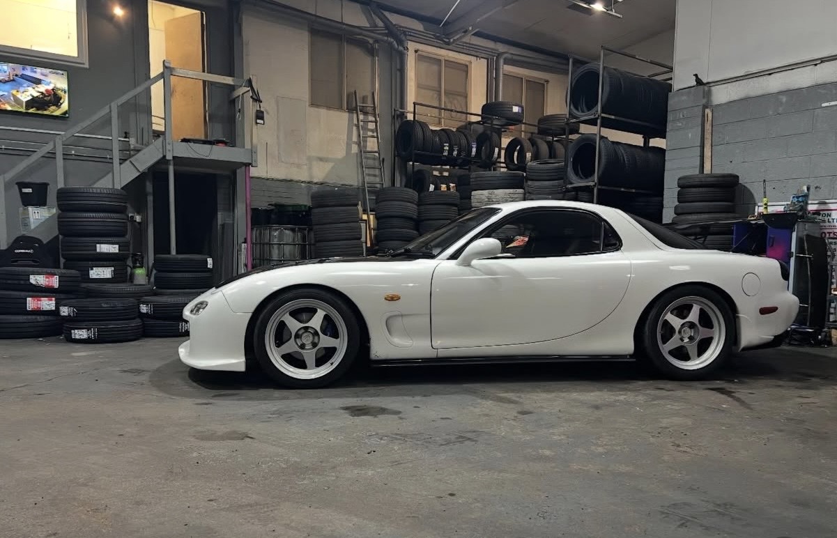

In the meantime, a few stills from Sunday AM. Also, the picture where I’m pointing, I don’t remember doing this at all, I swear it’s AI added by the photographer. 😂
As I head into year 6 of ownership, this car is the gift that keeps on giving. ❤️
It will be better with the bracing and that sump pan will also help.
