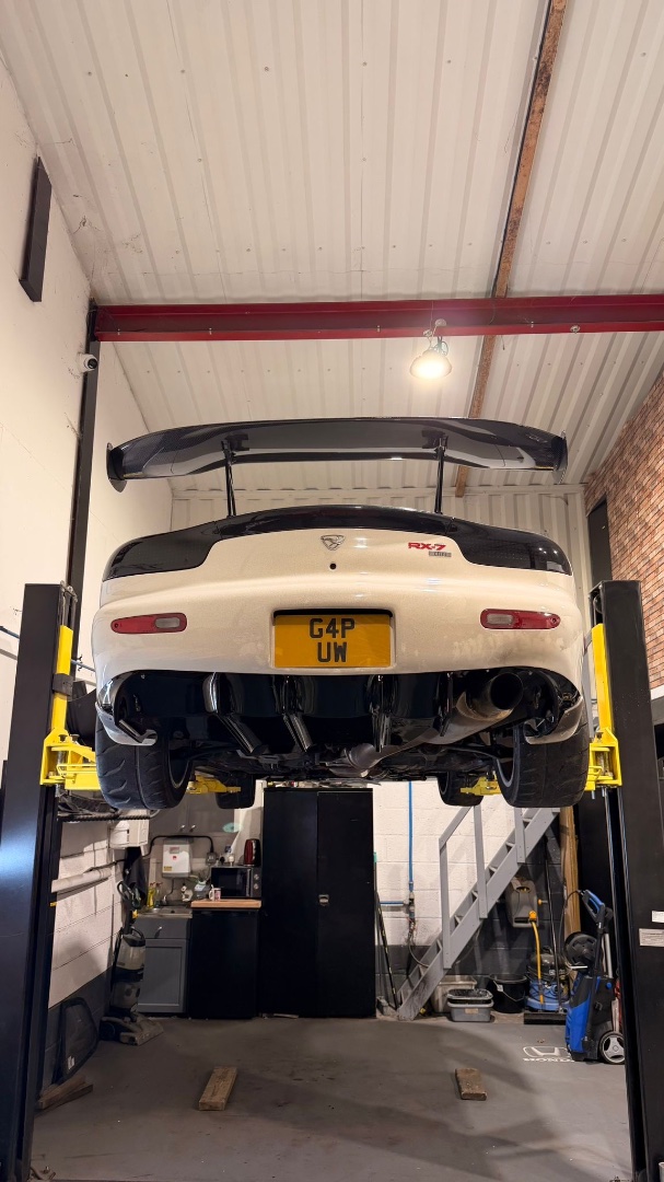

Goodbye old girl, it’s been emotional.
Joke of course, this thing comes a very close second to my daughter in order of importance and cost

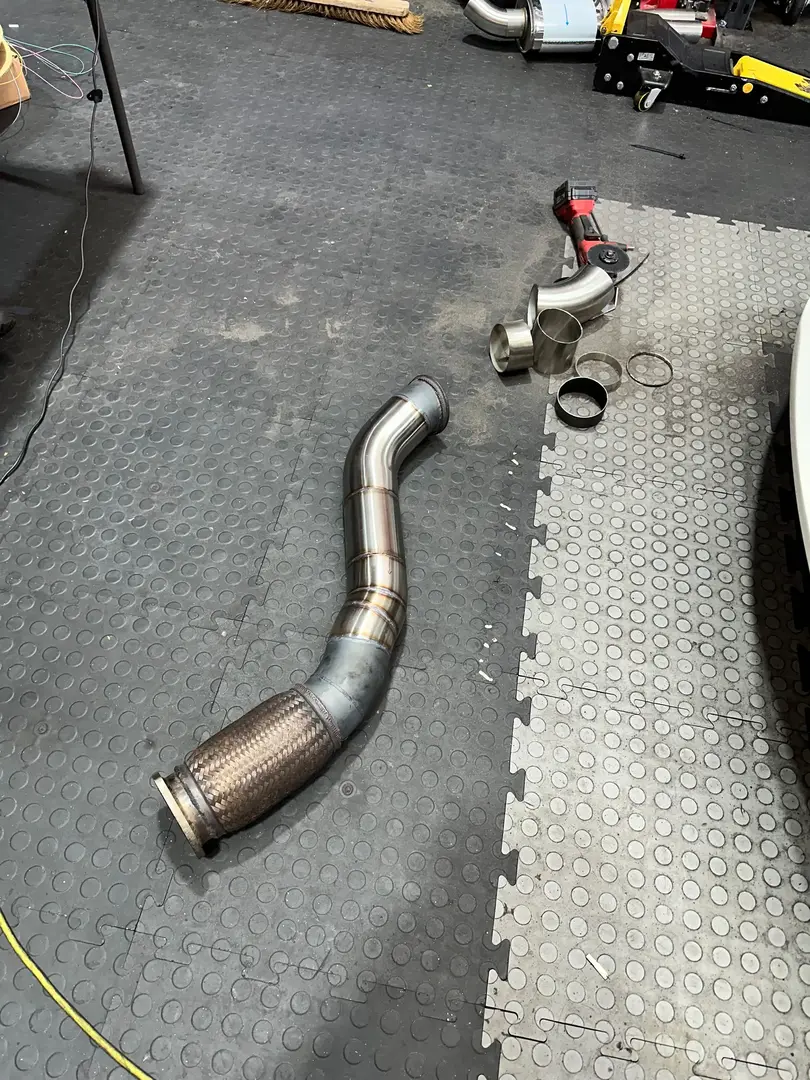

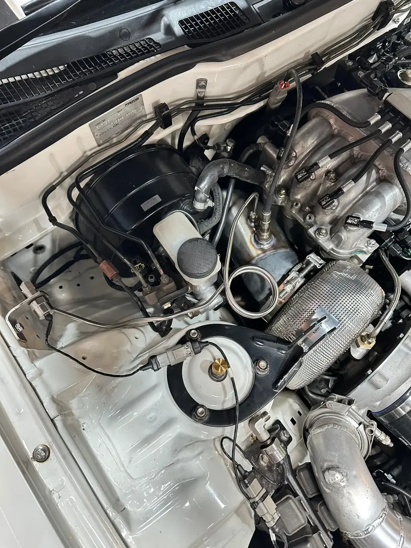

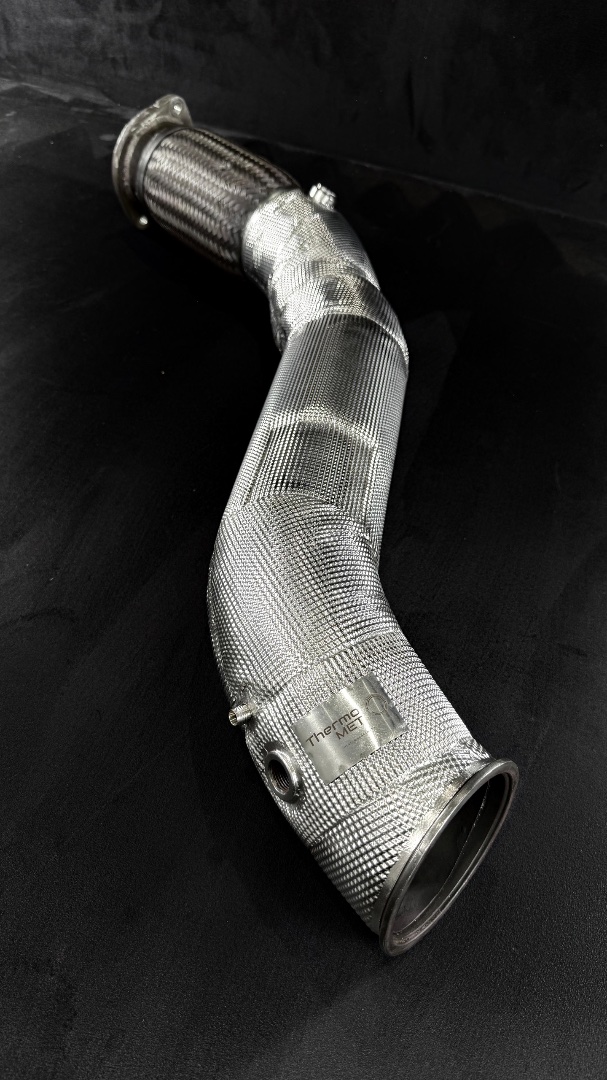

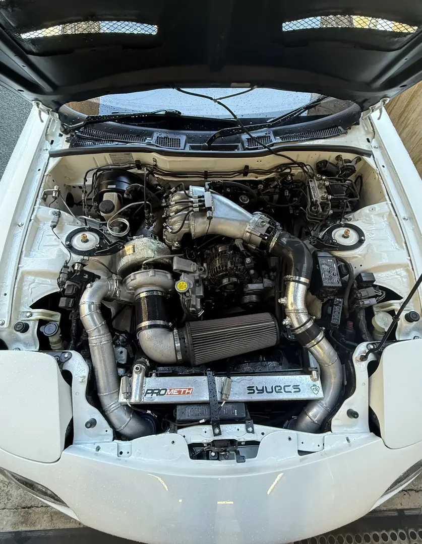

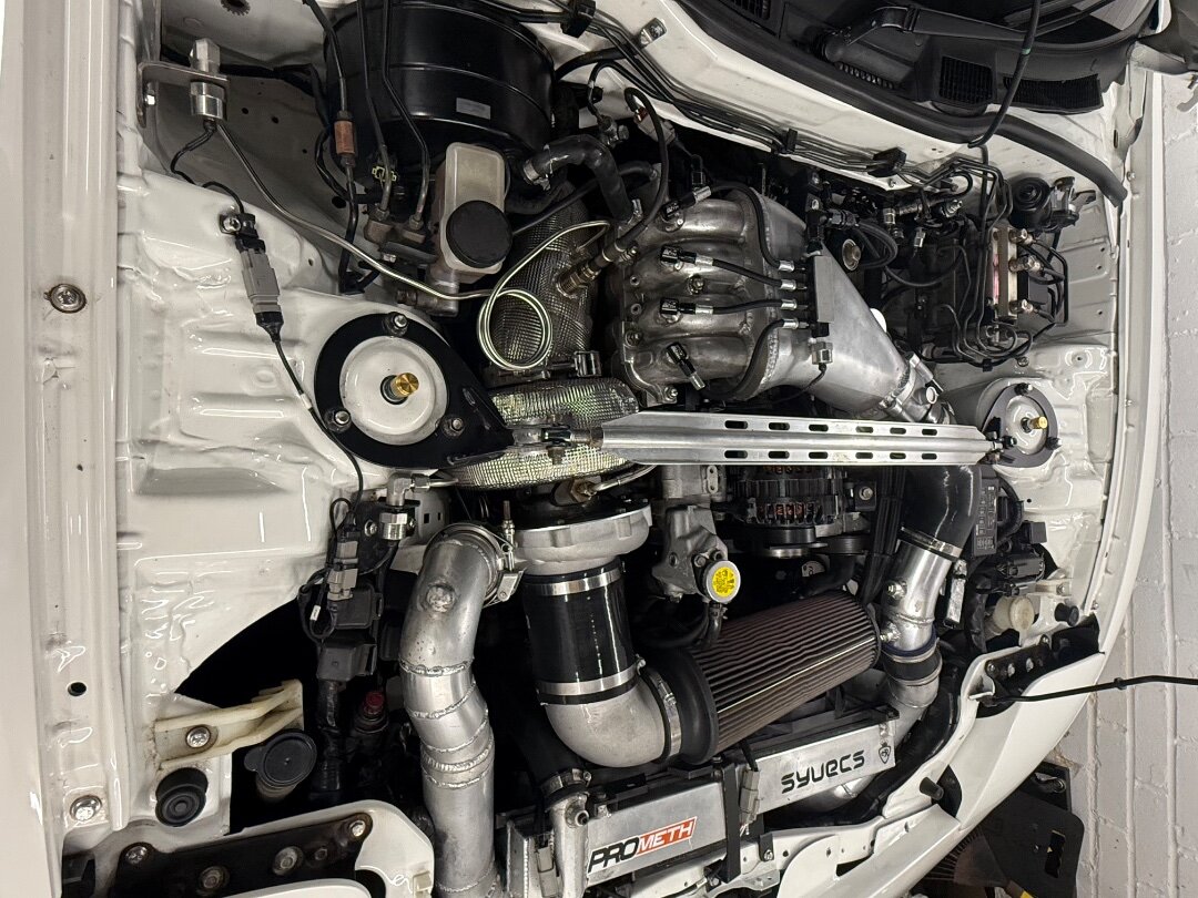

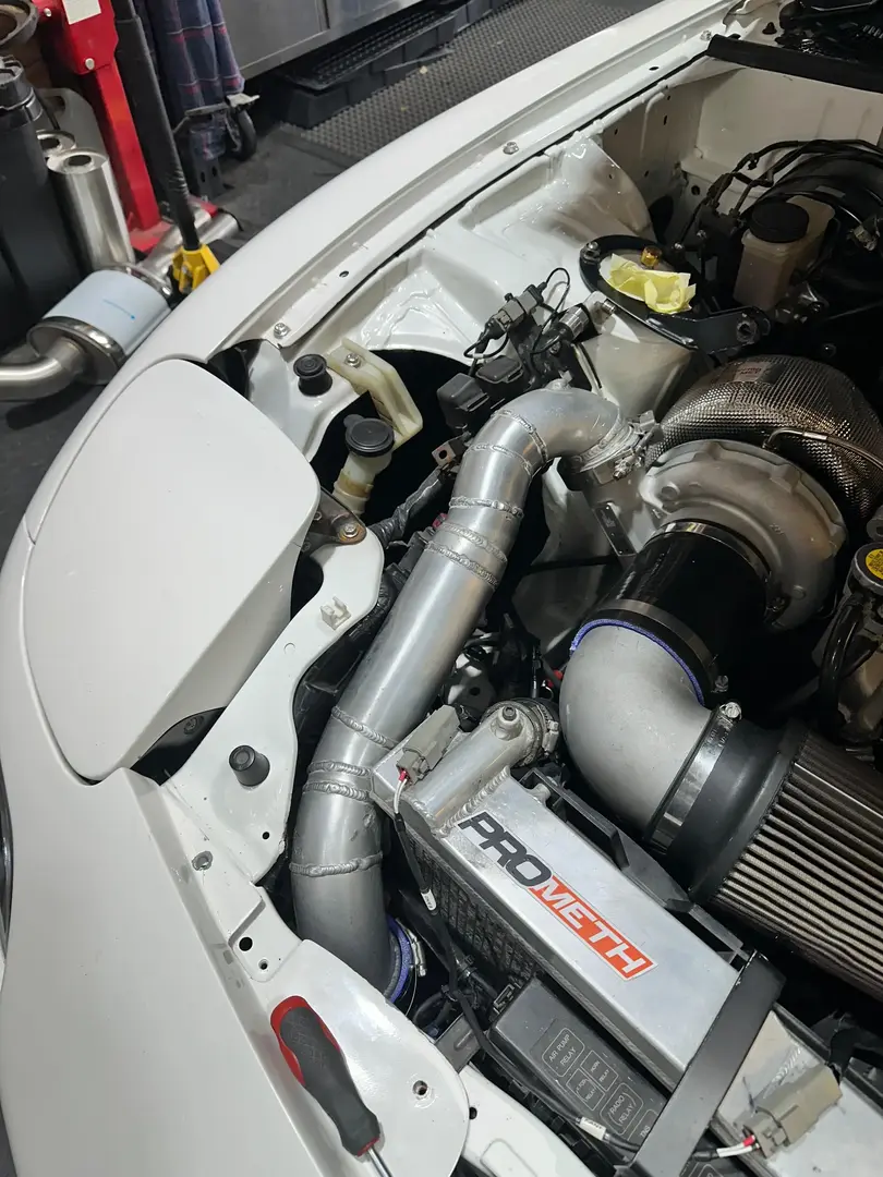

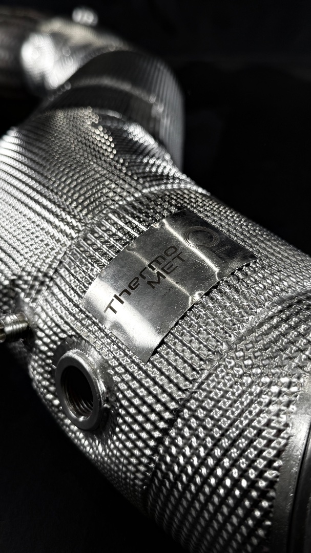

The down pipe has been amended along with boost pipe and EMAP coils.
I plan to have both boost hoses remade next year when I’m a little more flush, this last collection of parts and labour has almost wiped me out.
I’m off tomorrow for a 5hr round trip to Thermomet to drop the down pipe off. Hoping for a fast turnaround.

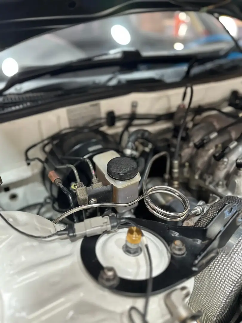

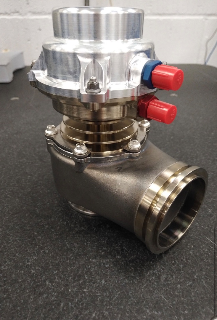

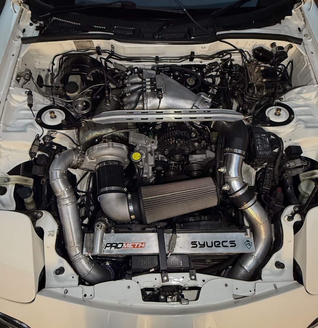

I have almost finished the wastegate lines, a just need a few AN4 fittings to make the last two lines.

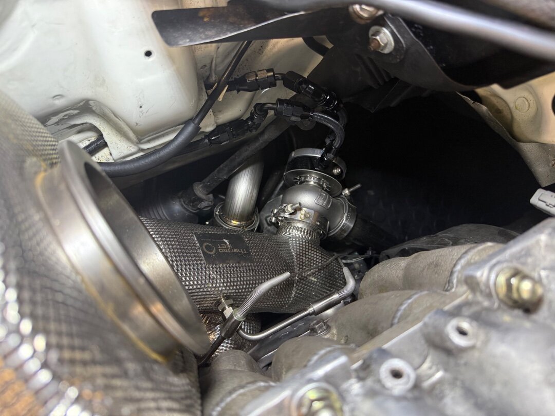

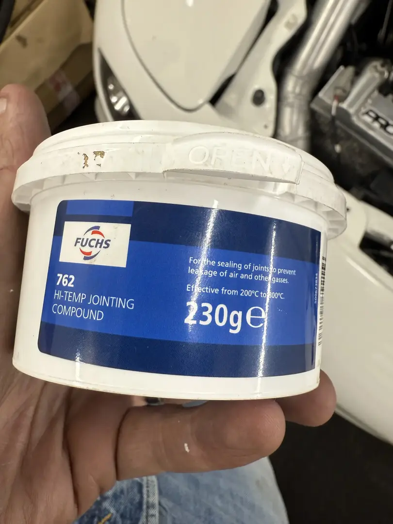

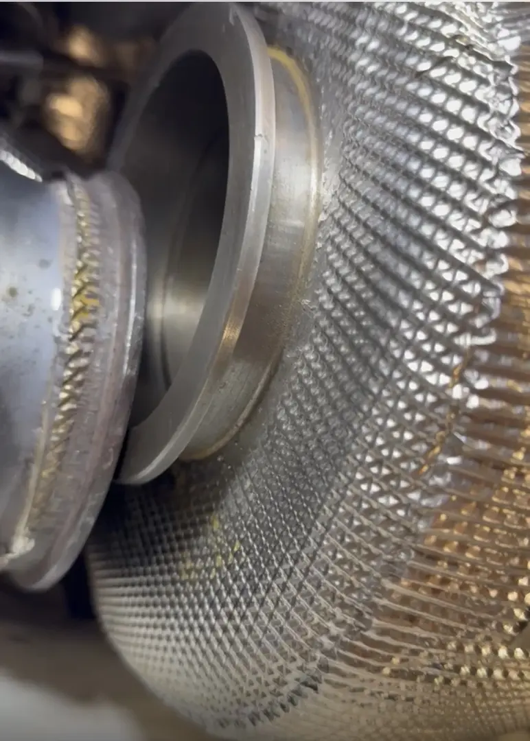

I did a little smoke test after the new down pipe was fitted and had a small leak from the v-band to turbo, it’s either going to seal with expansion or I might try a light slithering of this stuff on the turbo flange itself, anyone else had any joy sealing a joint like this.
