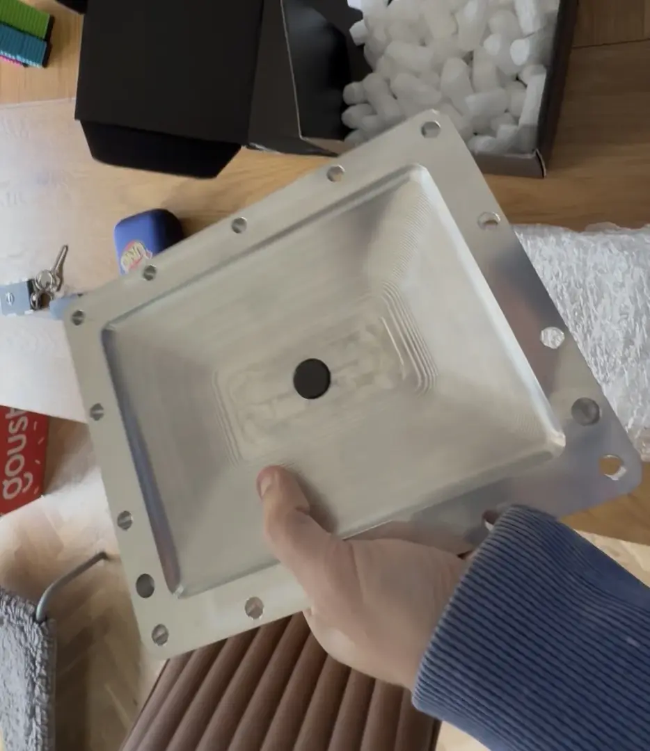

To beef up the casing as this is what OS Giken claim is the problem (case flex) I’ve purchased a chunky gearbox brace/bottom case from Billet rotary is AUS, Geartech will fit following their inspection.
It certainly looks the part, big chunk of billet, nice and shiny and pretty girthy 😉

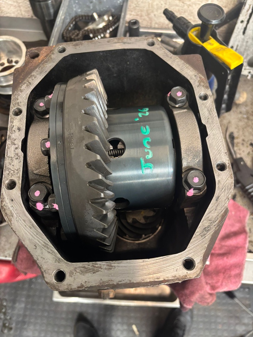

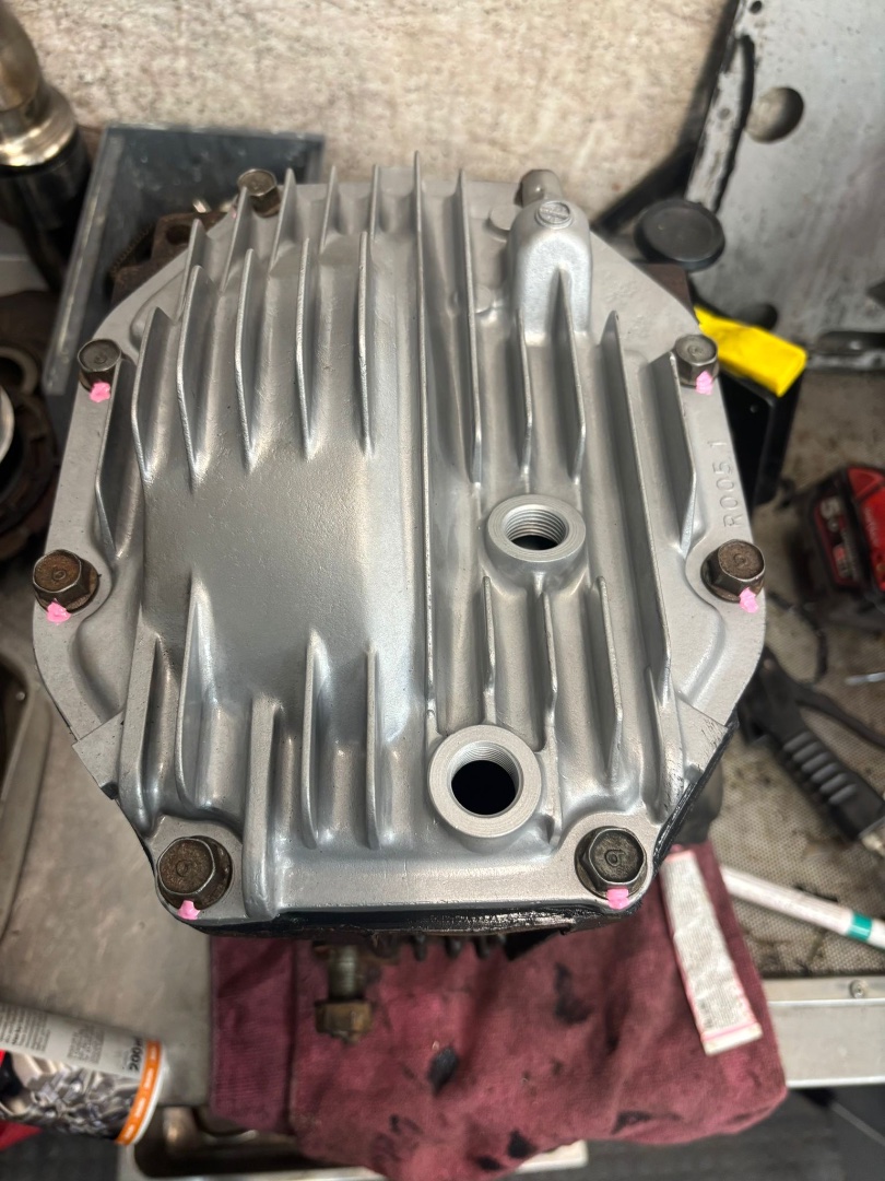

I’m going to have the diff bushings swapped out too in order to help with any potential play. Pretty certain they will be stock diff bushes so likely seen better days.

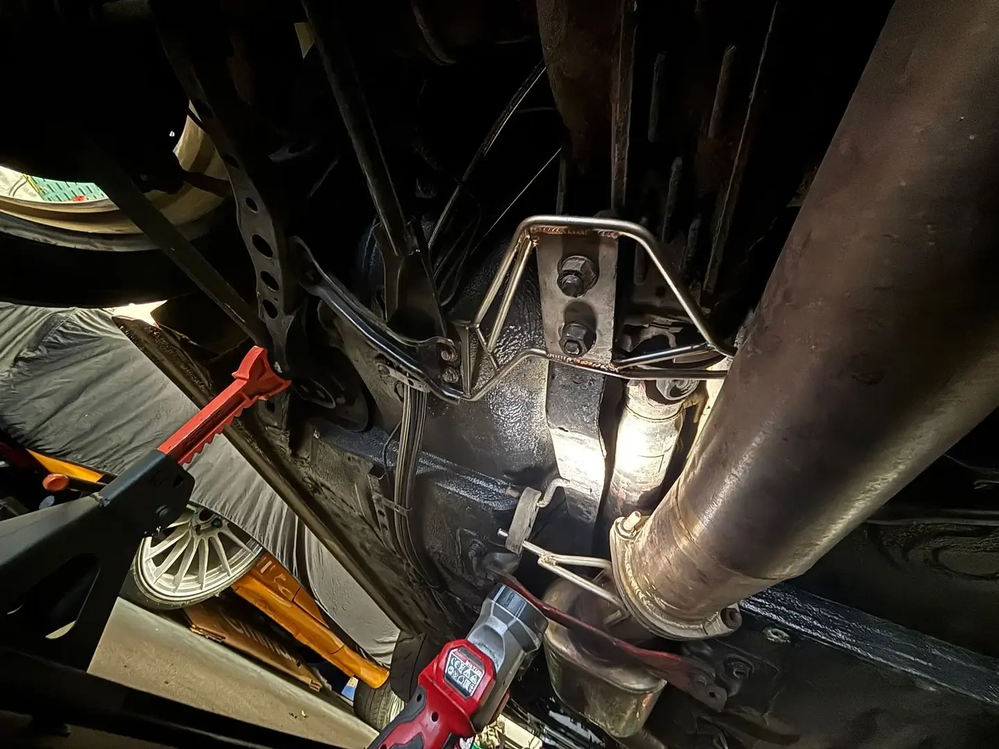

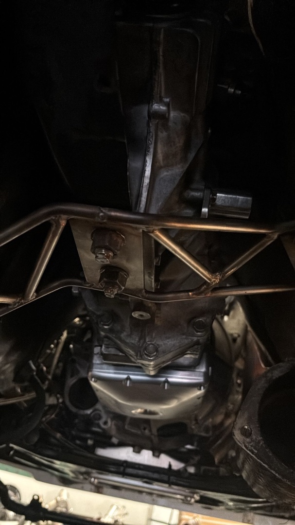

A few years ago I purchased a custom diff brace from Colum but never had it fitted so today it was finally installed. Looks good 👍
The final part to the puzzle is an actual gearbox brace at the front of the car too so I’m hoping as a combination this will fix the jumping out of gear issue and in turn save me having to invest in a complete gearbox swap.

Along with the brace pan, diff and gearbox brace plus new engine mounts and diff poly bushes, hoping this fixes it.

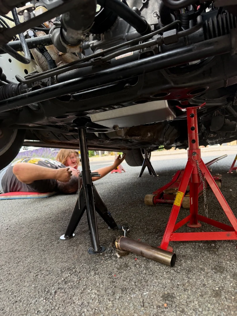

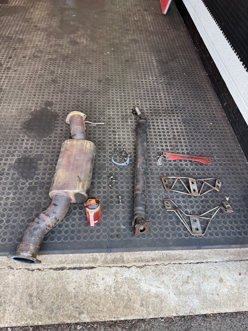

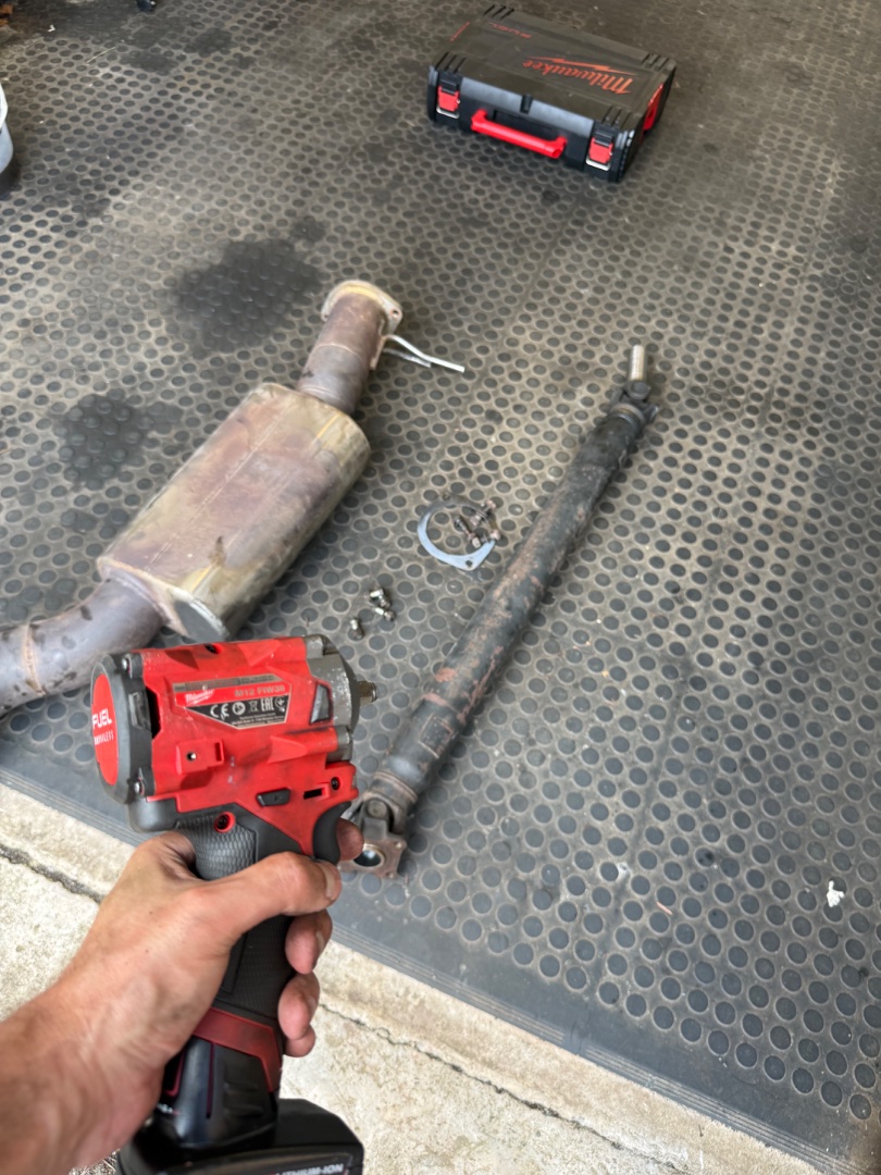

Never one to give up and with a preference to not keep relying on others I’ve started removing the gearbox myself to get a second opinion.
A few pics of my efforts so far, just the starter, slave cylinder, clutch release & PPF to remove before pulling box.
Quite enjoying learning new stuff but not doing it in this heat.
Shit news the gearbox is still playing up.
Tip for getting the box out - when you have the power plant off, jack the front of the engine up a little bit and wedge abit of wood between it and the subframe to angle the gearbox down abit. Makes it loads easier to get to the top bolts and get the box out
Did the gearbox in out myself for the first time recently. Not too bad a job, you'll need a deep 22mm iirc socket for the PPF. Getting it lined up with the clutch when your putting it back on is a bitch. Are you on axle stands?
Yes indeed, on axles stands.
You can buy dummy plastic input shaft to help line it up. That’s why jacking the front of the engine up helps as it’s easier to put the gearbox in straight at that angle
I don’t think I’ll have the option of jacking front of engine up. Its on poly mounts so will have very little movement and my sump is snazzy aluminium from USA which I don’t want to dent. I’ll find a way.
Ahhh you might be abit fucked then. When the Power plant is removed pull down on the back of the gearbox to see how much movement you have. The wood we used to wedge in was on about 1-1.5 inch thick but that angle makes a big difference
Where you put the wood it right at the front of the engine under the front cover so no danger of damaging the sump. Used to use a transmission jack to jack it up but a trolly jack with some wood side on would do the trick to.

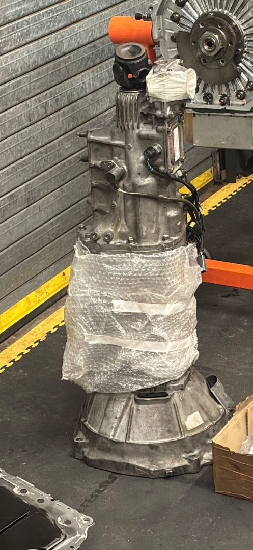

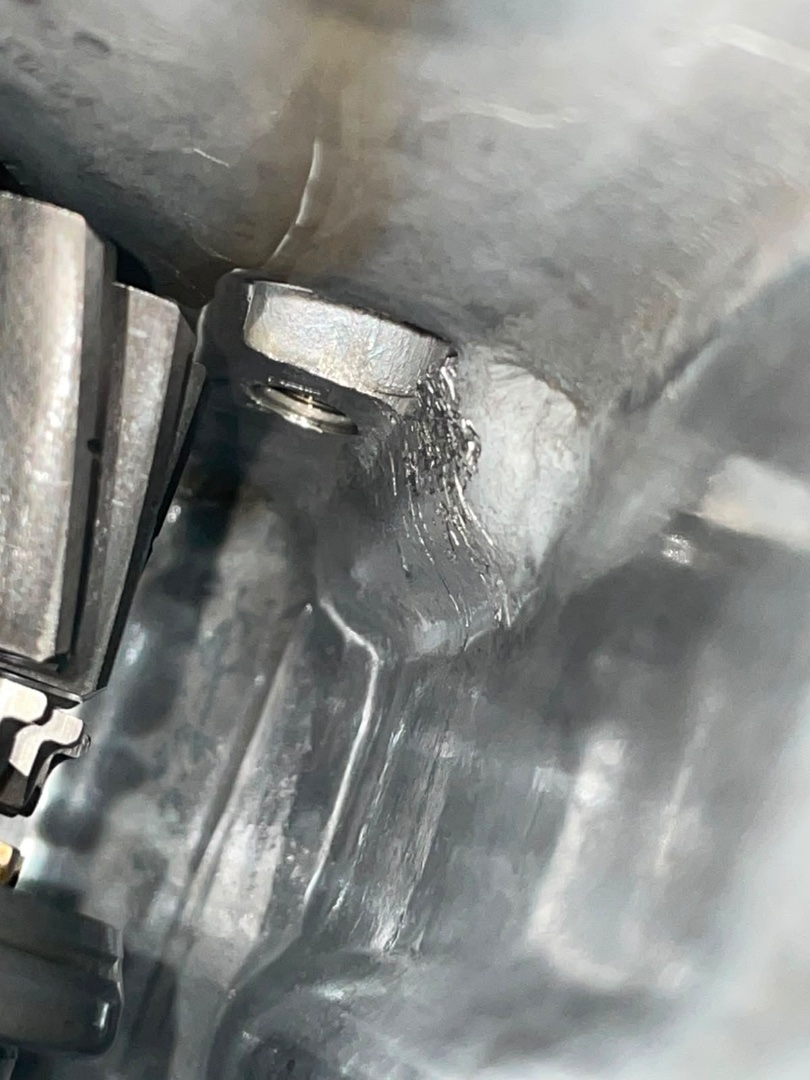

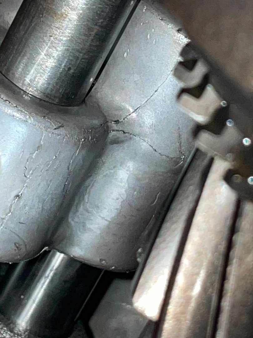

Still haven’t had the box fully inspected yet but visually looks like there are a few cracks and has seen better days. Hard to say whether these were missed by Geartech or whether they’ve happened since the second rebuild.
They could just be casting marks though the top one does look like a crack from photo below.

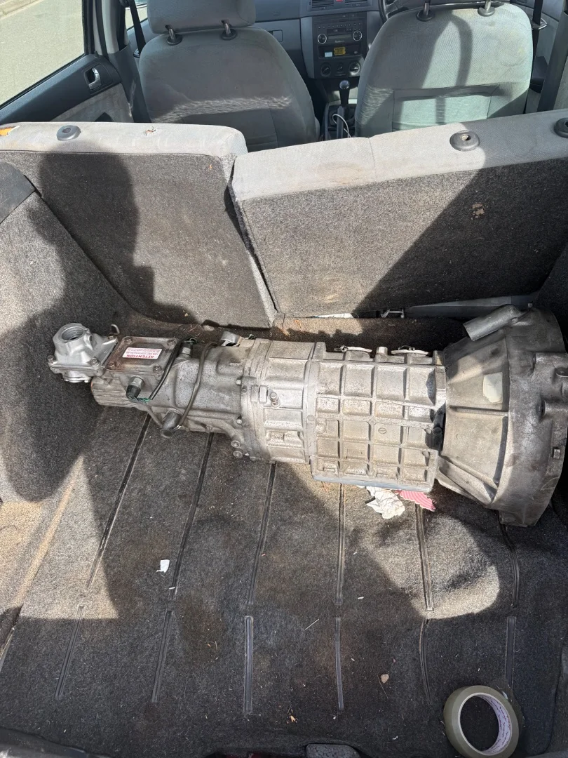

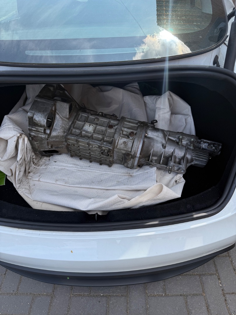

Regardless the consensus is to use this donor box I picked up today to compare and potentially use some parts to make one good one. If after this, it still doesn’t operate correctly then it’s time for a box swap.

Long drive earlier to collect this.
The thing is I don’t like buying random spare boxes, have no idea of the condition. Starting to think I should have just done down the CD00a route all along.
