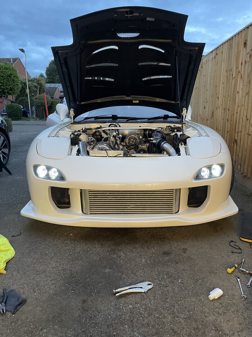

It’s been a few weeks since an update.
The ecu and D4 dash came back earlier this week. Life Racing had to make some amendments to the board to allow us to see all of the PDU information on the dash which also is required for safety measures and alarms.
Good news is all of that is fixed now so that’s a result.
Another outstanding issue was the wheel speed sensors seeing interference from the fuel pumps. The tuner has managed to solve that within the software by messing with frequencies. So a big tick there too.
Next up we had issues with the calibration switches for MAP and traction control. Finally solved too, partly my fault on this one because I didn’t realise there was a lockout switch on the rotary dials to allow me to get to the full 12 positions we needed.
Now the good news is we are almost ready to fire it up. It’s probably going to be this time next week due to other commitments for both the tuner and I.
It’s just a case of testing crank signal, checking ignition and fuel injectors. Prime system and pray to baby Jesus. Not doubt there will be some other issues along the way as let’s be honest that’s just the nature of this car.
Oh I also managed to fix my side lights.
