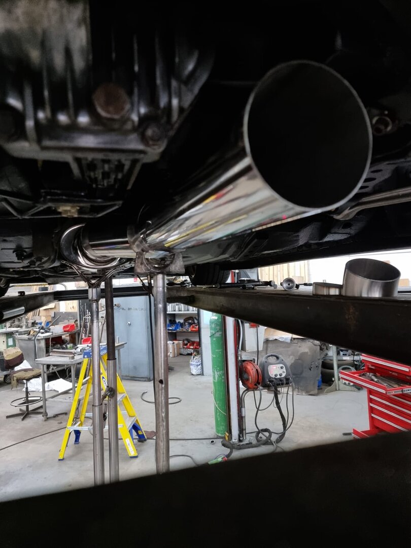

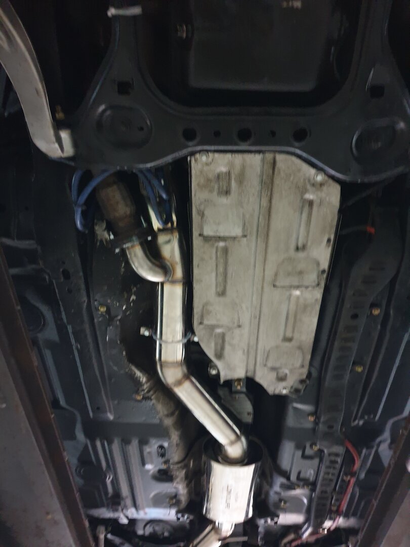

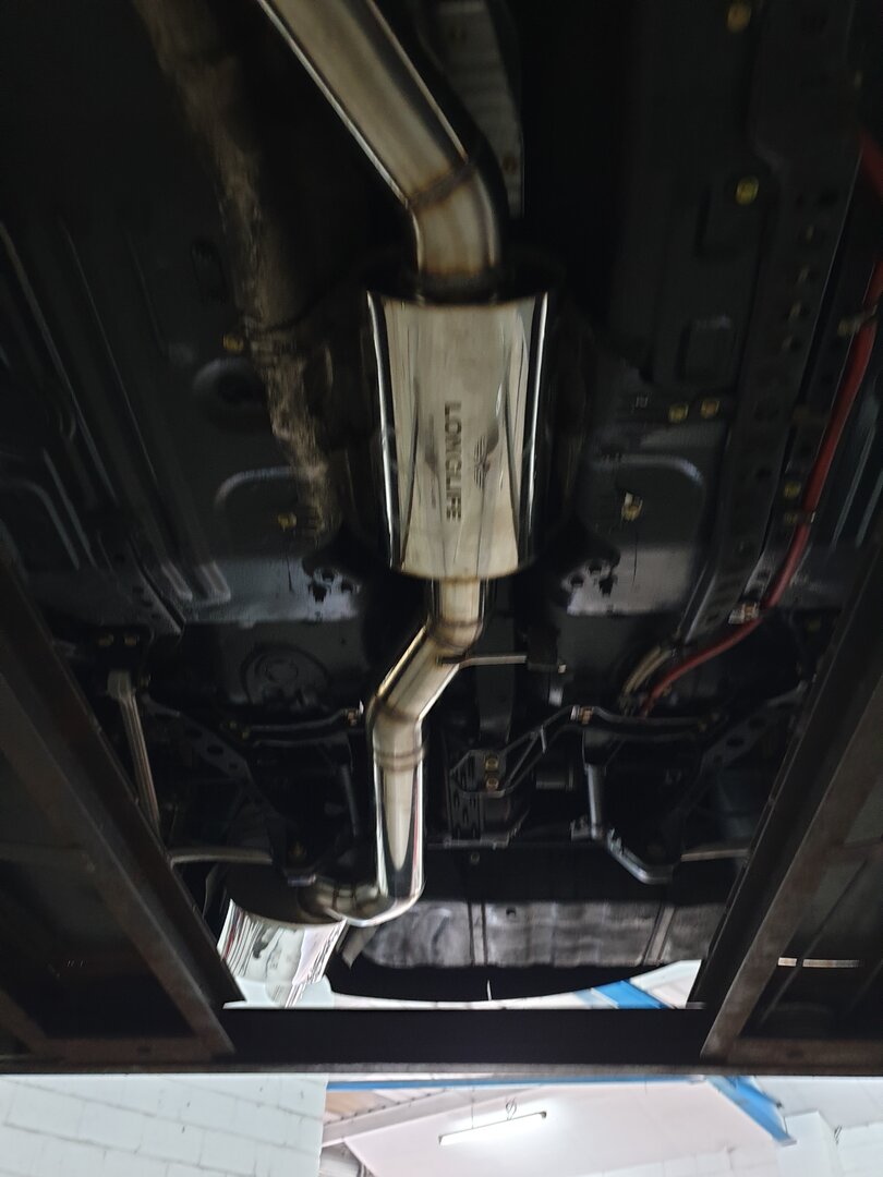

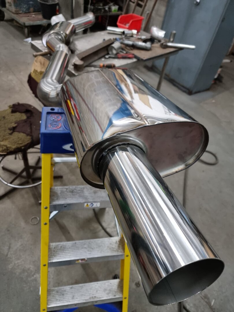

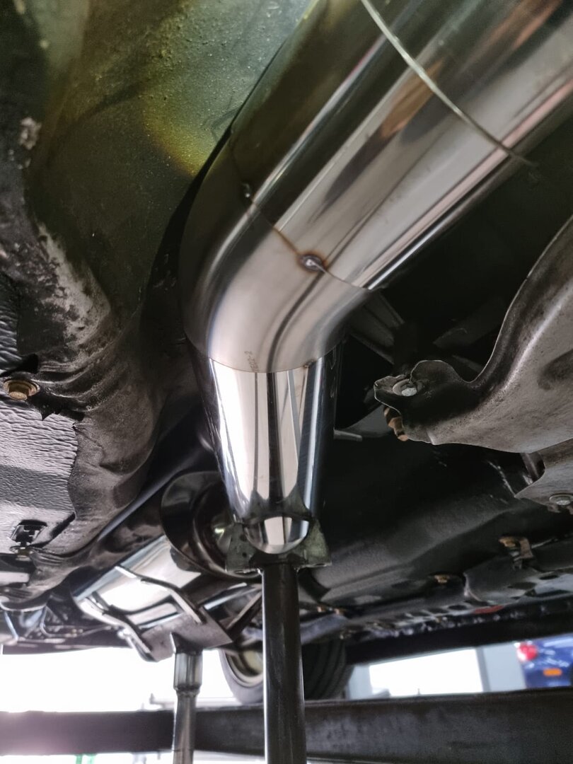

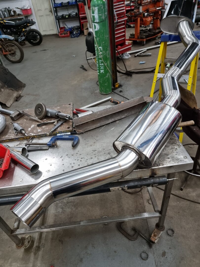

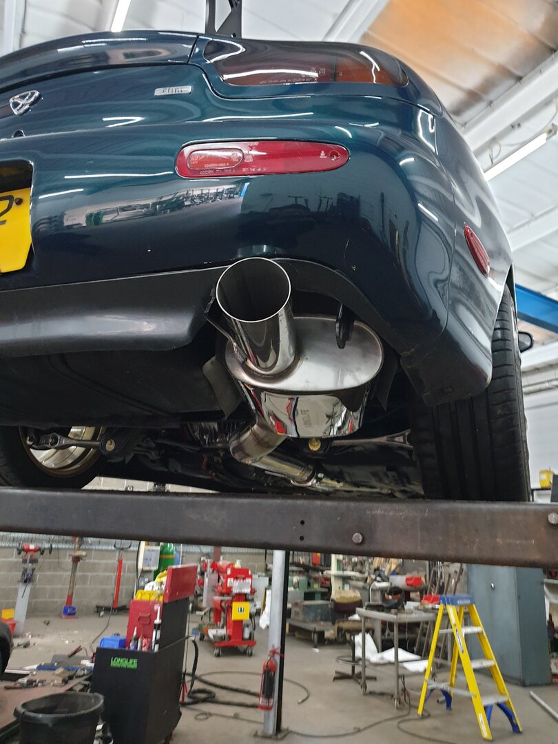

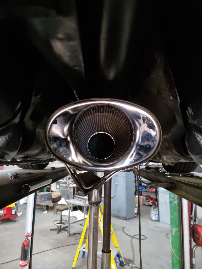

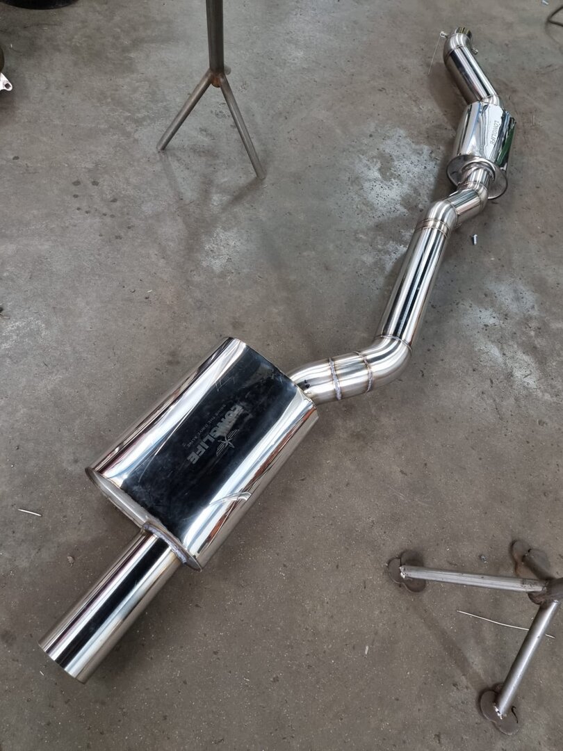

Got the car back today with the new 4" DP and exhaust system. Told long life exhausts, I need max ground clearance, zero restrictions and to make it as quiet as possible and they delivered all accounts. It is a lot quieter than my old exhaust system, which i miss already. This is more grown up...but with all the flow.
Time to start testing again and get into the 5s range for 100-200kph! Hoping it's possible...but only one way to find out.

Some more boring exhaust videos

Progress on the 4" system is not going as swiftly as I would have hoped.

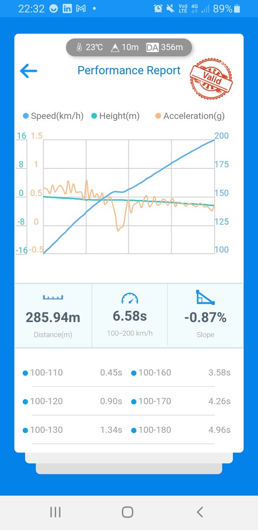

However, I managed to record the 6.58s 100-200kmh run on the old zaust when testing without the dragy overlay. Also found an interesting slope correction meter which predicts if this was done on a flat surface the time would be in the 6.7s range.

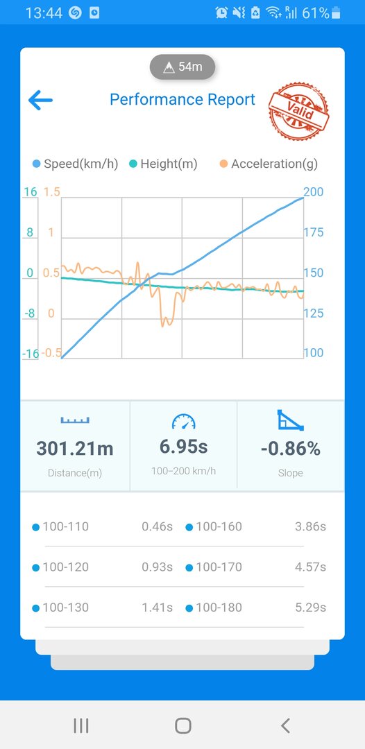

However, 1bar/14.5psi boost now runs a personal best for the 100-200kph sprint in 6.95s, which is a worth while gain.
Going up hill on the same setting. Fully optimized the G35-1050 on a street port is comfortably and consistently hitting low 7s to high 6s range at just 1bar boost. I was unable to achieve this pace previously. Looking at my data conservatively it is a gain of 0.27s in a manual car, which is significant considering i'm not running any additional boost.

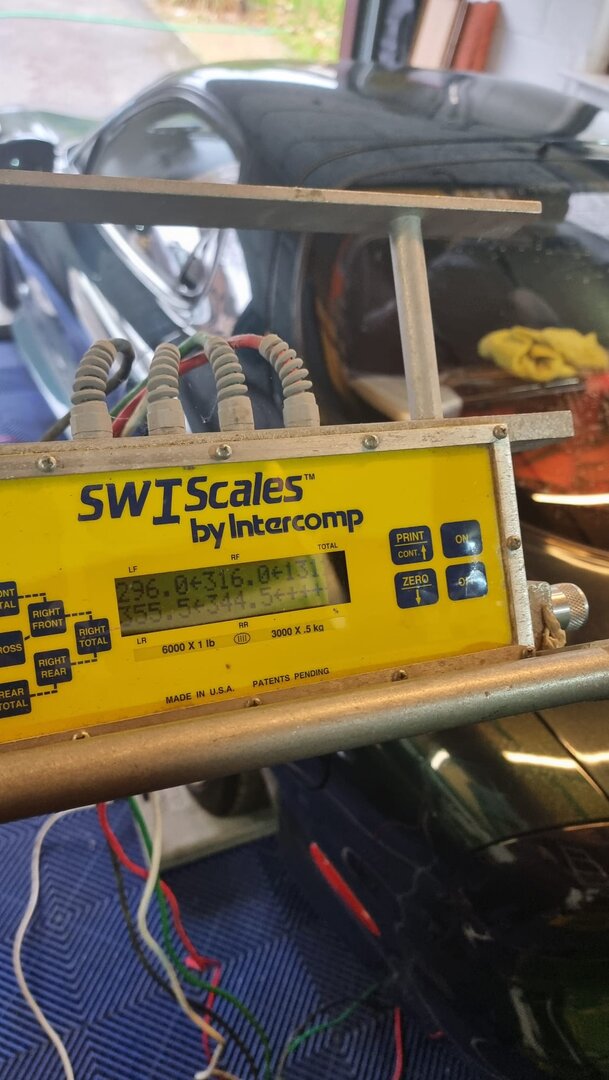

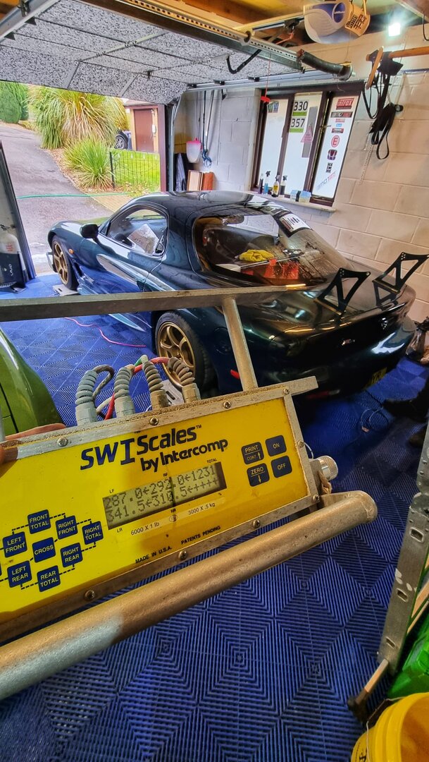

Met up with a mate to get the rx7 weighed/corner weights checked.
Mazda HQ?! 😂
Full fat wet weight at 1231 kgs, this settled to 1230 kgs after a few mins! The BWG was off but i had a 7kgs pc680 battery put in the boot in addition to my optima red top to make up
With me in the drivers seat and a full tank of fuel it weighed in at 1312 kgs. The weight distribution was fairly good as it was. If i was doing serious track days I would change the balance and get the front left tweaked a touch. However, for the dragy runs im happy with a full tank of fuel a good portion of weight is on the rear wheels which helps the dragy times and overall traction. Plus accelerating will push weight further back wards and keep it there. Overall very happy with this.
Update on whether the 4" down pipe and full 4" exhaust helped performance?
Eliminating the manual gear change and focusing on the 160-200kph time from the 100-200 dragy data posted above for all the runs.
The best run so far at 17psi. So 6.58s - 3.58s = 3.0s 160-200kph time.
The low boost pb previously was 7.38s 100-200 at 15psi - 3.51s 160-200kph time.
The current low boost pb at 14.5psi is 6.95s 100-200 run - 3.09s 160-200kph time.
This shows a real world gain of 0.42s when conditions are ideal. (manual change eliminated!)

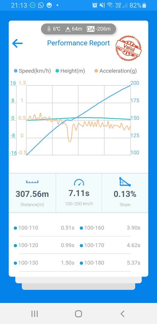

The same low boost run going uphill at 14.5psi ran a 7.11s 100-200 - 3.21s 160-200kph time
So when conditions are not ideal the gains are 0.3s.
Eliminating that gear change is showing a bigger real world performance gain of upto 0.3s - 0.4s depending on conditions. (For my application, in my findings confirmed by dragy gps data). Subjectively the top end with the 4" system is better, least my dragy gps performance shows a decent gain at 1bar.

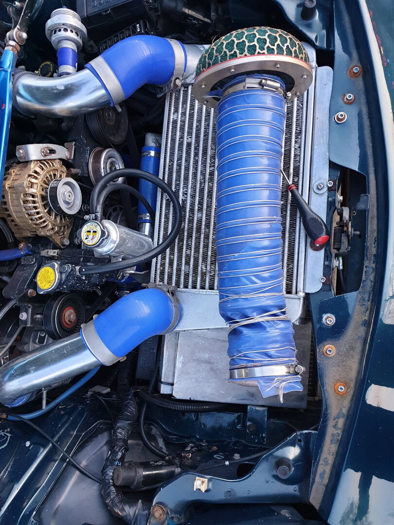

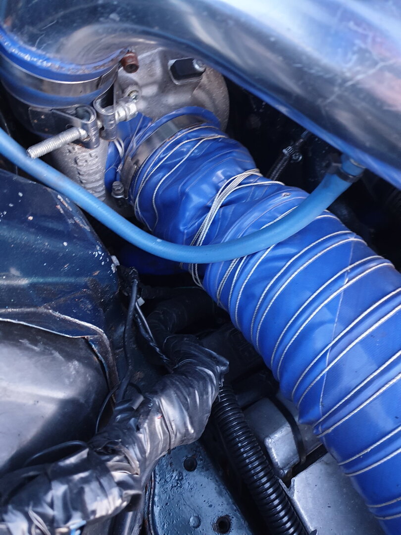

Increased boost to 18psi and noticed something wasn't right. Took a closer look at the engine bay and found the intake pipe had failed! Turbo was being choked!
Luckily caught it early and all is well. Need to get a new intake pipe and filter made up then back to the grind. Car needs a full detail as well!
