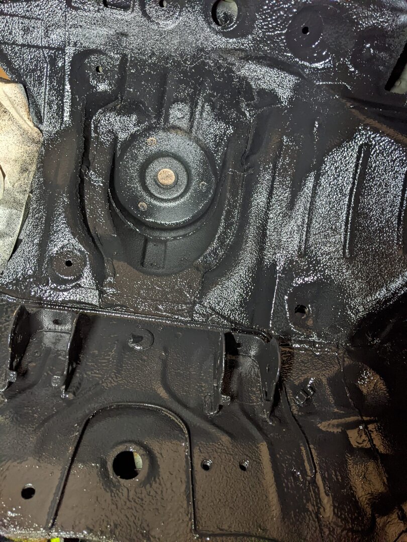

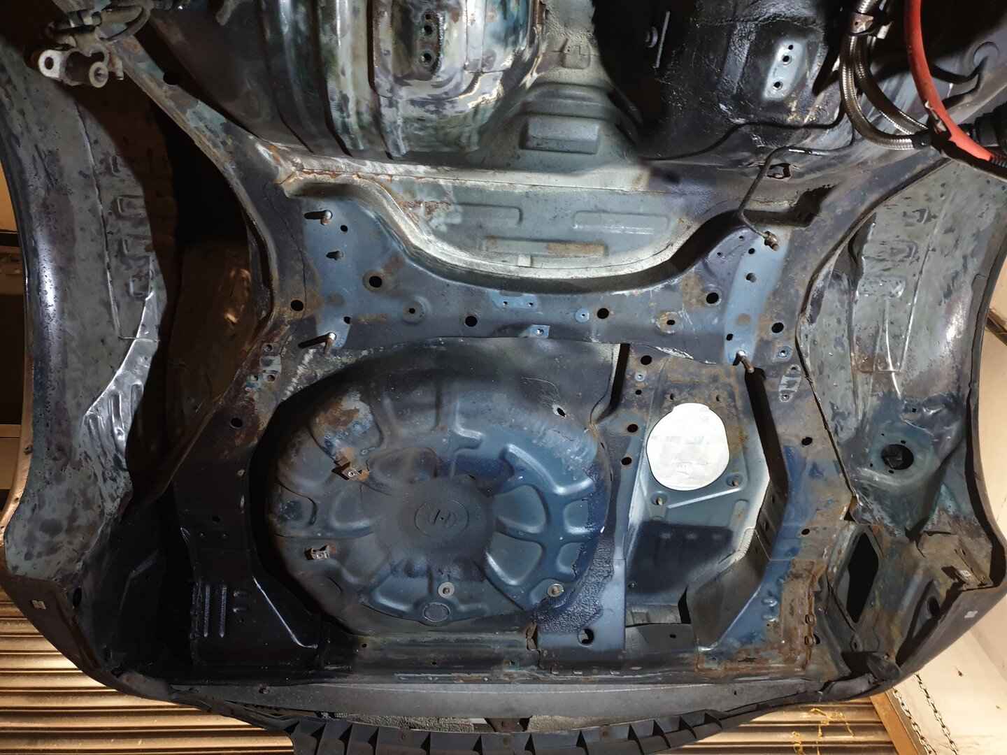

Rear Subframe dropped, fuel tank removed. Mike advised the rusty bits are surface rust and no major surgery is required.
Preventative maintenance being carried out with utmost attention to detail.

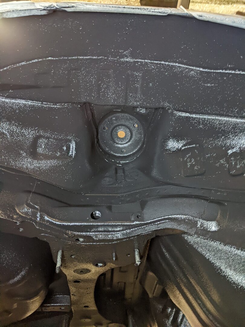

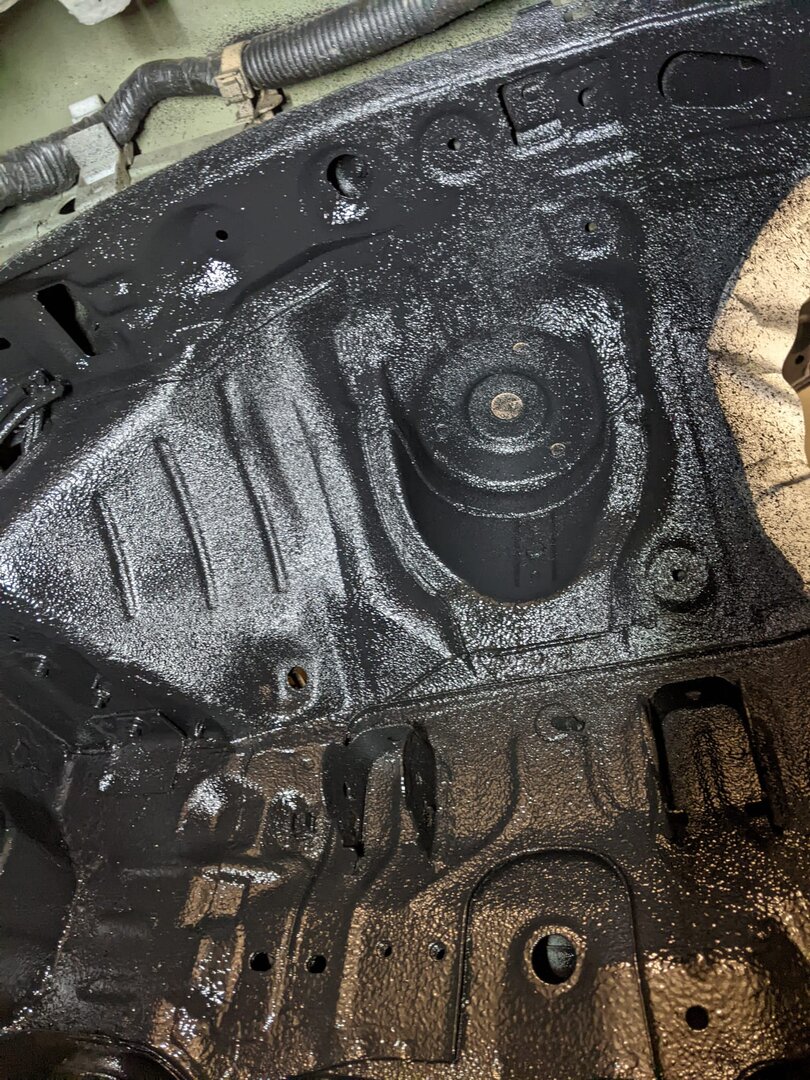

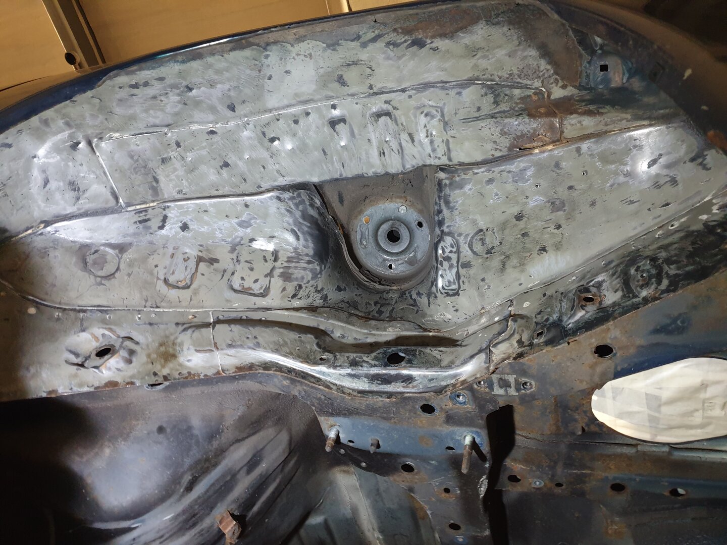

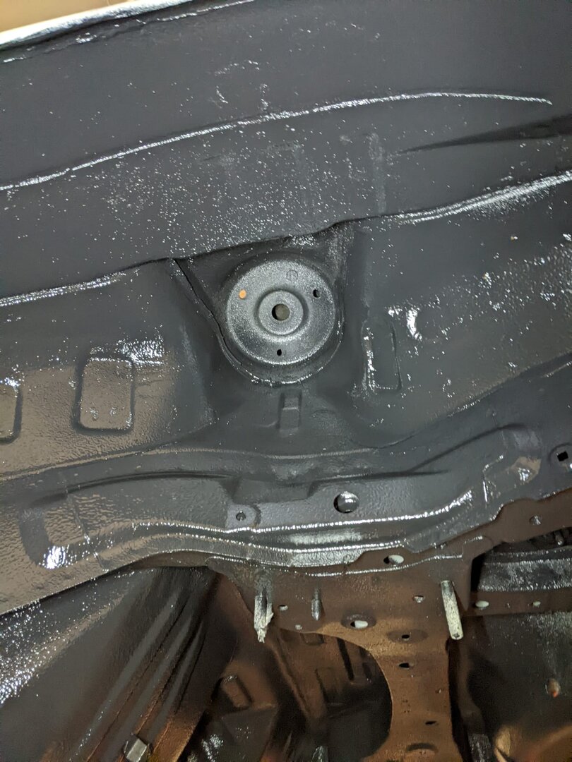

Rear shock tower - underseal removed ready for the next step.

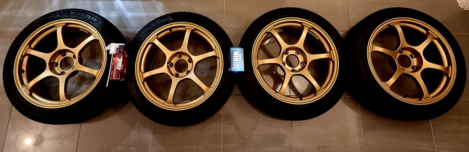

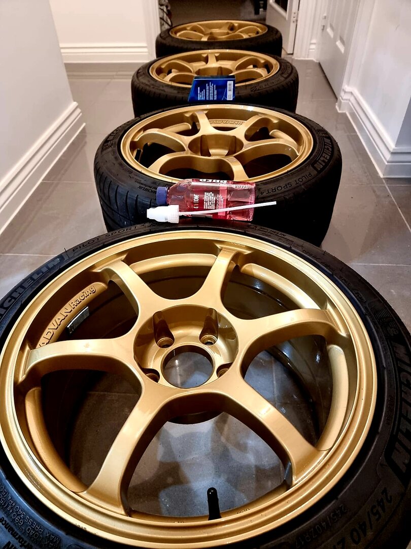

Picked up the freshly refurbed Advan RG2s from Mike. Got some Gyeon G2 Rim to ceramic coat it over the next few days/weeks; whenever I get the opportunity to do it.
Overall, extremely pleased with how the underside restoration is going.
Happy new year's eve everyone.

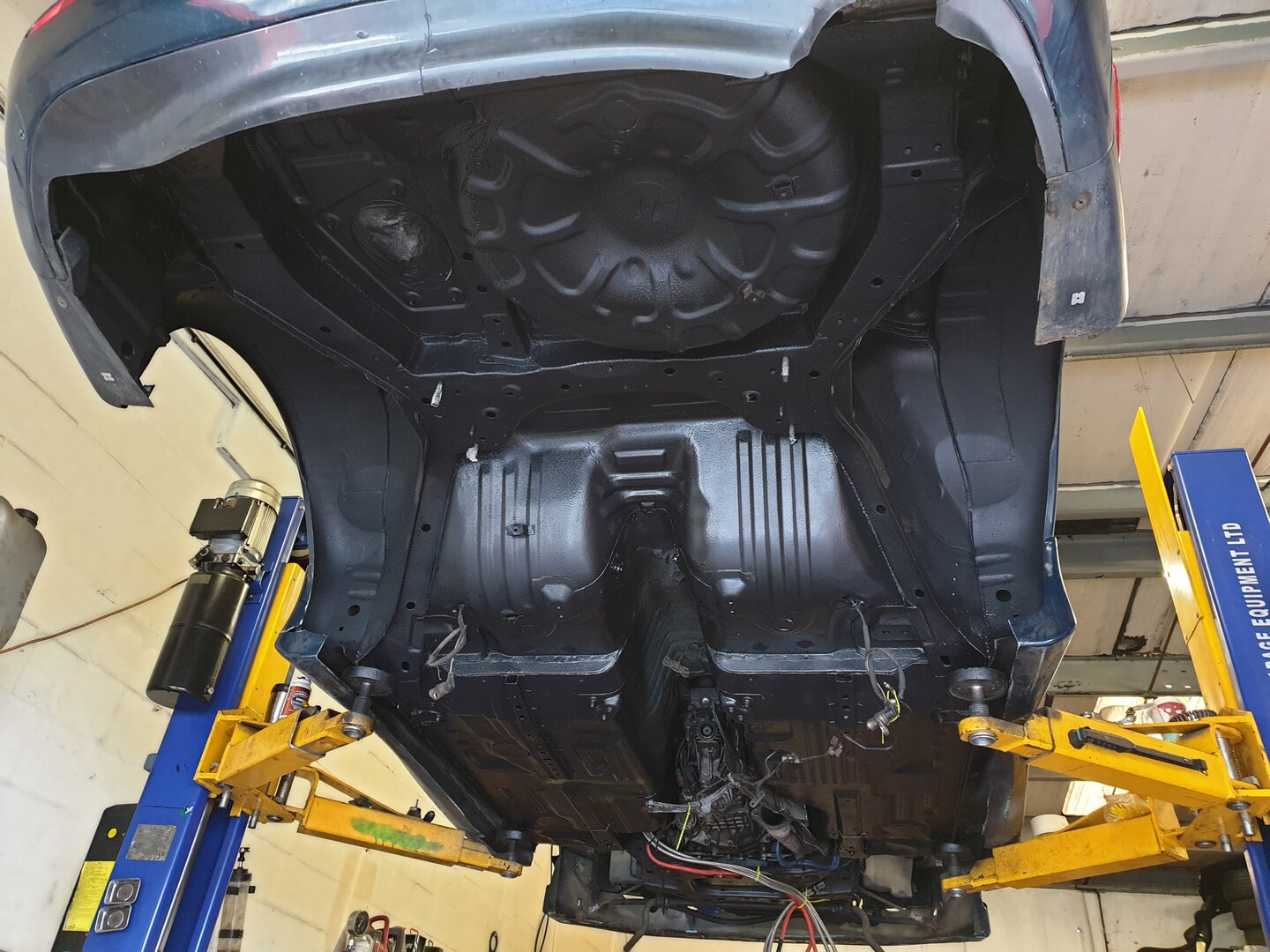

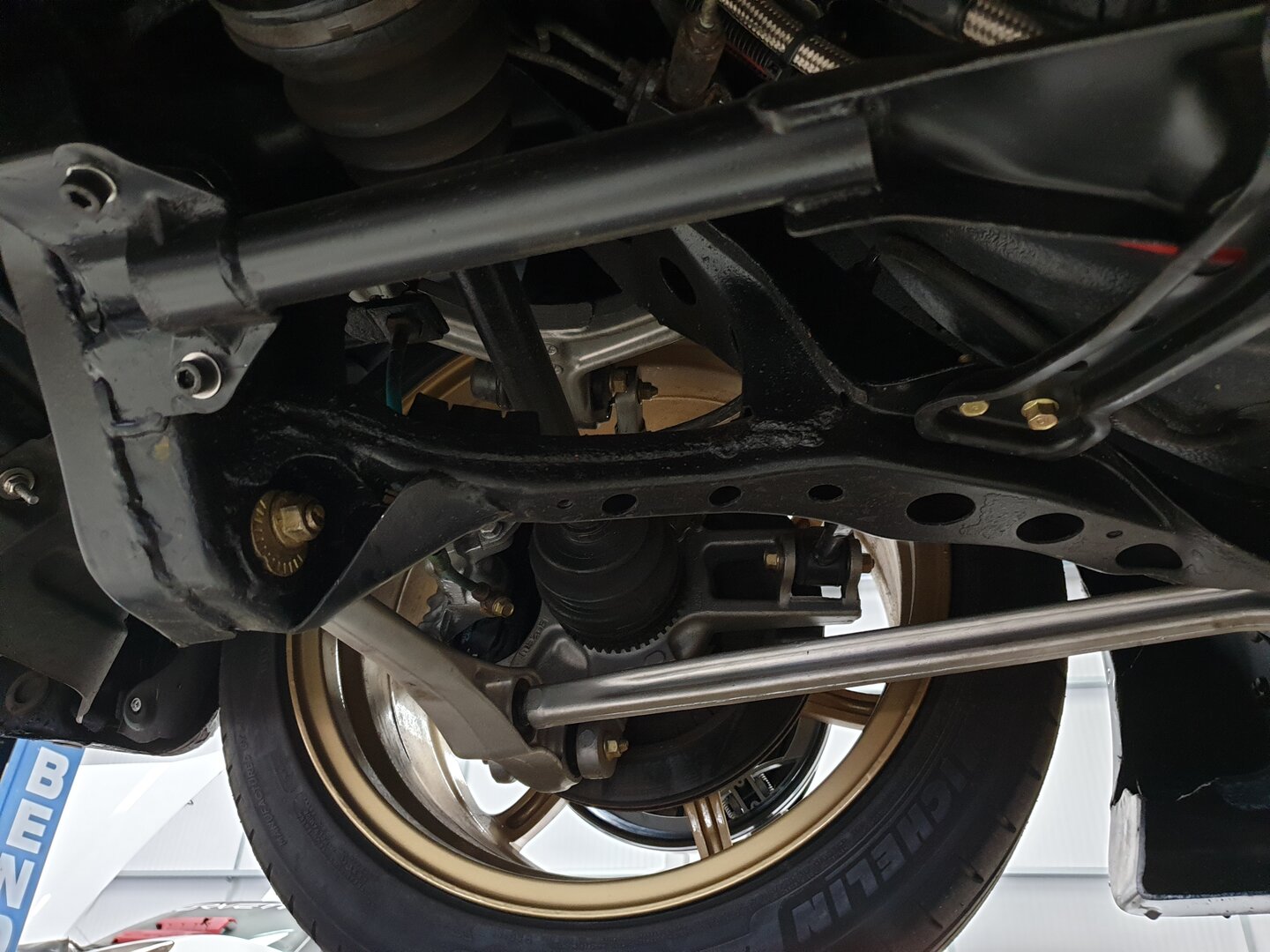

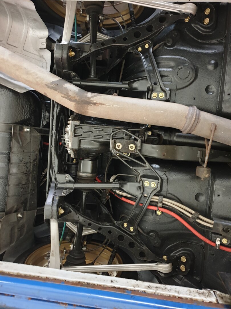

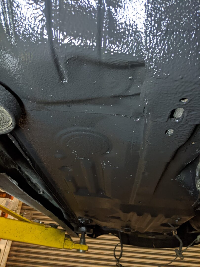

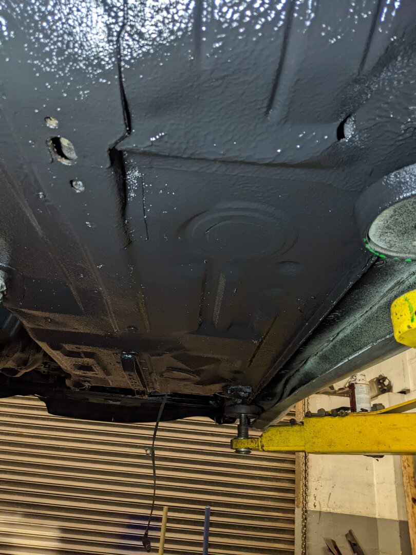

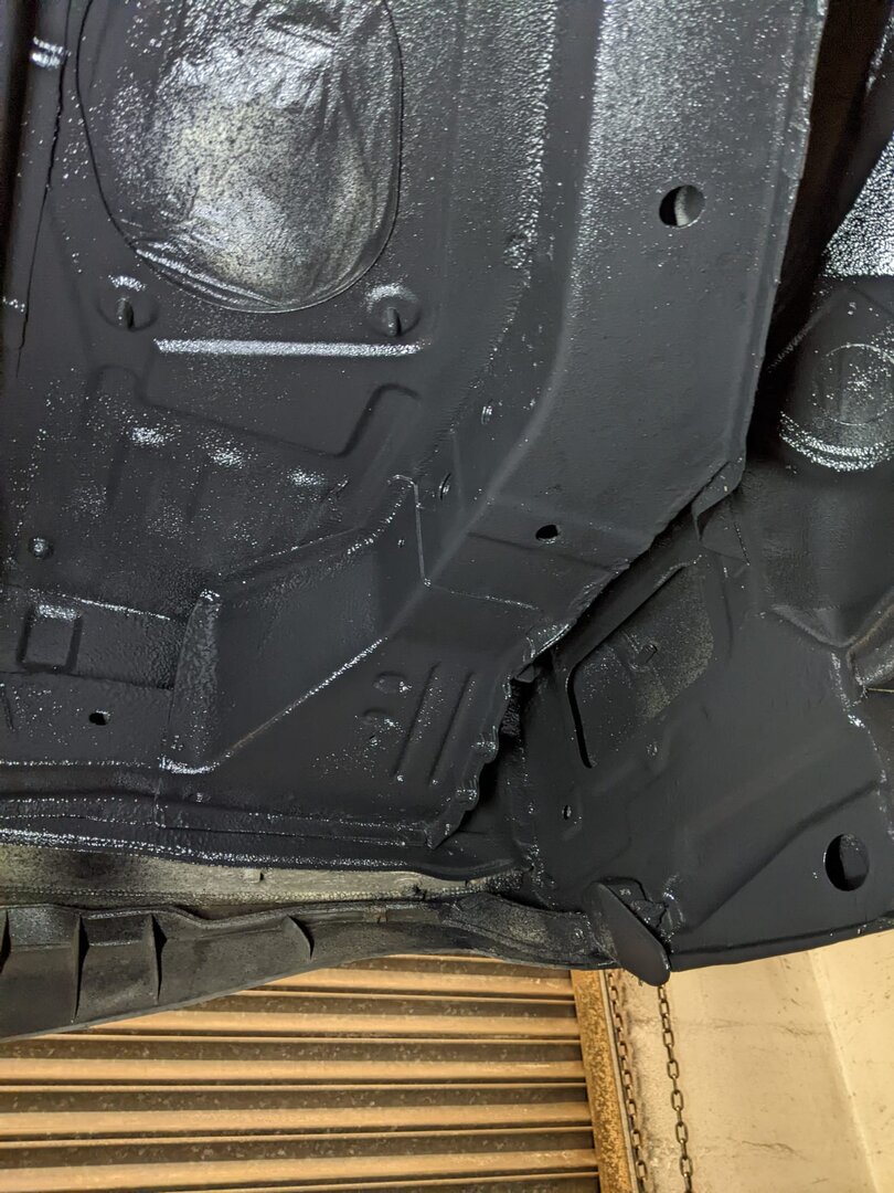

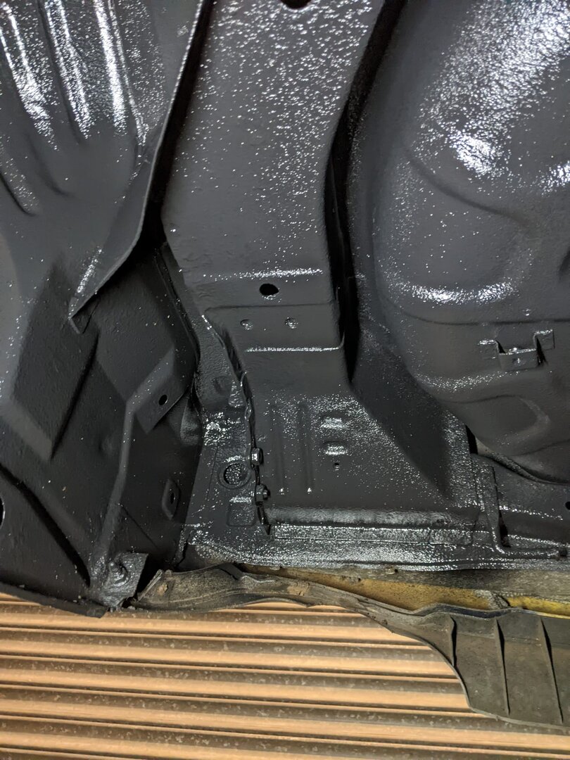

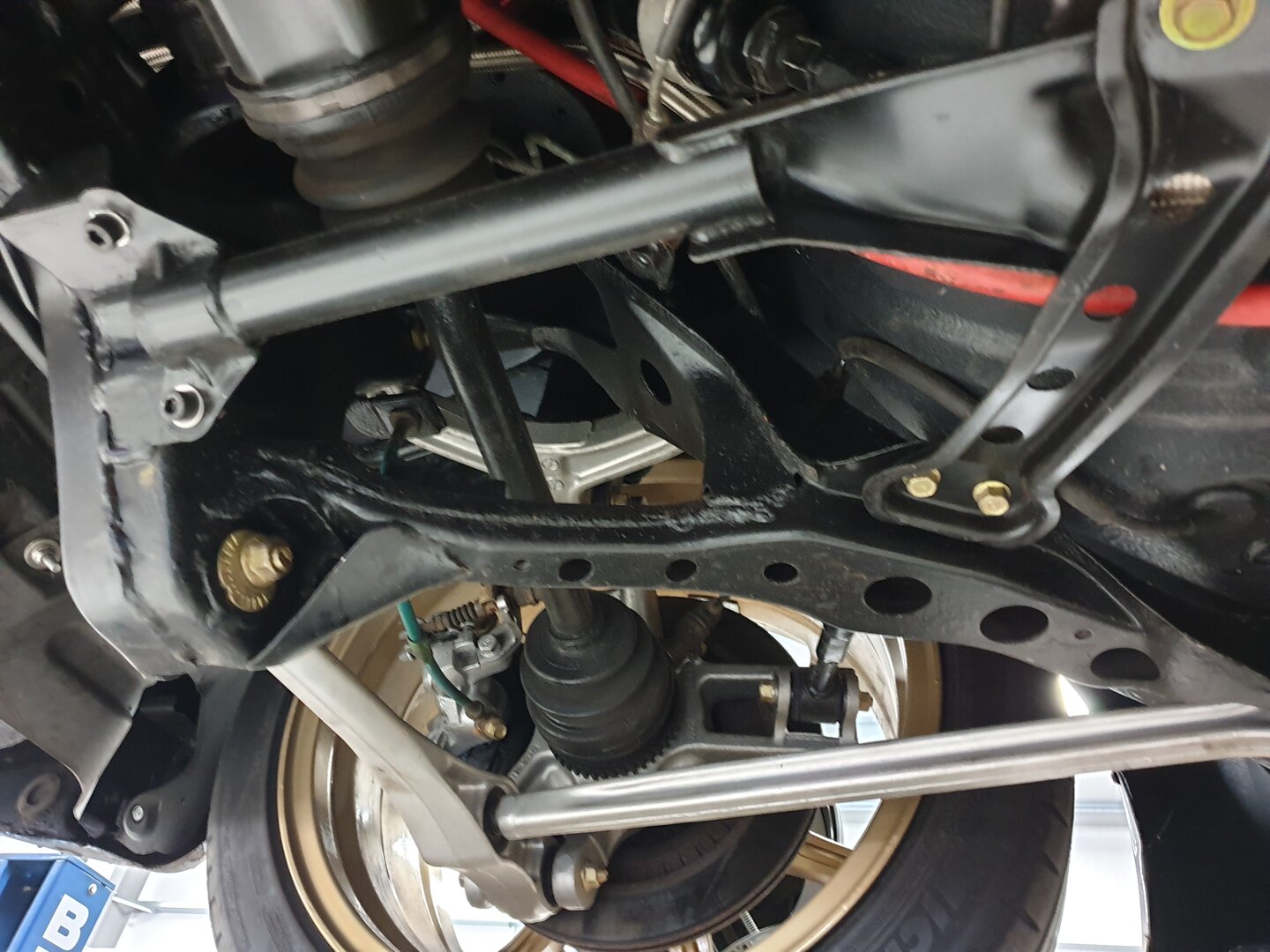

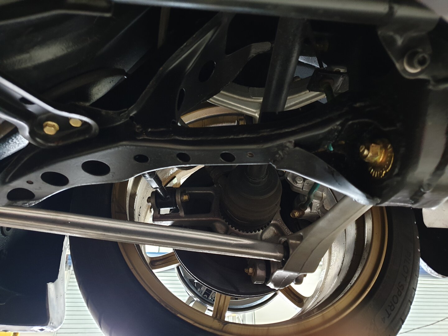

After the underside was fully stripped off the old underseal back to bare metal. It was repaired (where applicable) and treated with Bilt hamber rust converter, parweld zinc primer, raptor body sealer and bilt hamber cavity wax. I've been told by Mike it won't rust again for a long time.

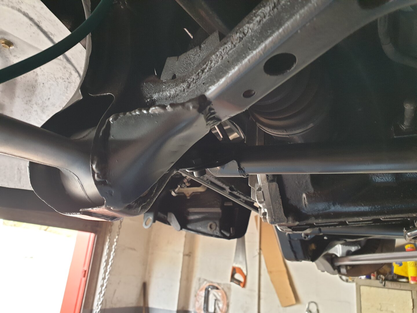

Mike mentioned he had to repair 7 small sections with new parts and weld them in. I'm glad no corners were cut and the underside of this rx7s shell has been restored to its former glory. Mike mentioned he would wear a white tux for assembly of the underside :ROFLMAO: . He's really looking forward to put it all back together.

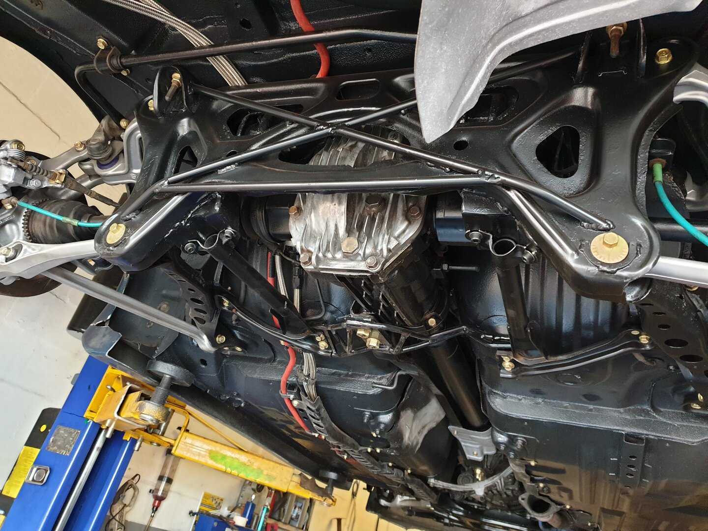

Almost 6 months later, the underside has been fully restored and reassembled and it started brapping right away. Really happy with how things are coming along.
Its going in for a detail and polish soon. Will be back with Mike to complete some final finishing touches with a geo setup left to do before it comes home.

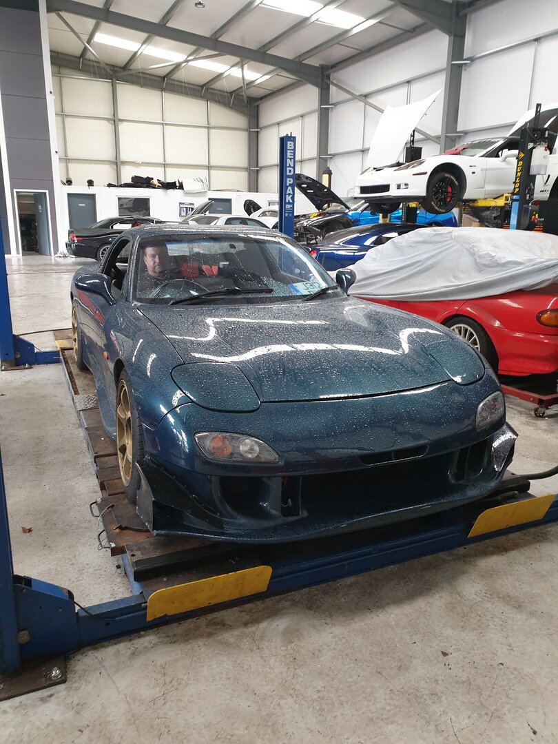

Made it to Indigo GT where I initially dyno tuned the car...but this time it was there for a full alignment.

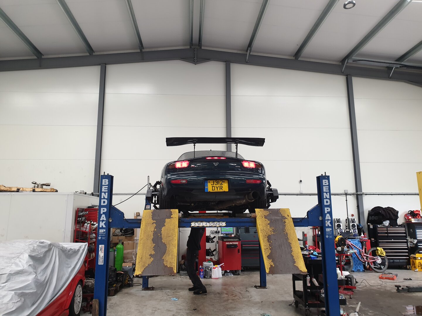

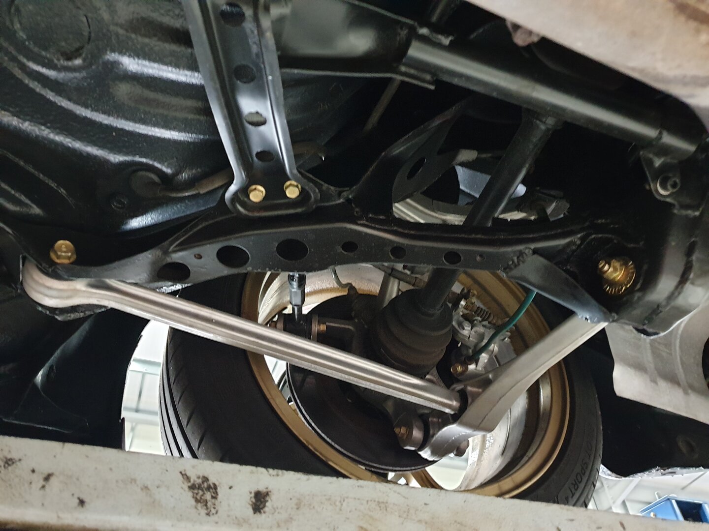

Unfortunately Mike did not get many pics of the masterful work he completed of the underside....so I managed to get some pics in while the car was on the ramp.

Settled at -2deg negative camber front and rear.
0.5mm toe in front n rear
6* castor front

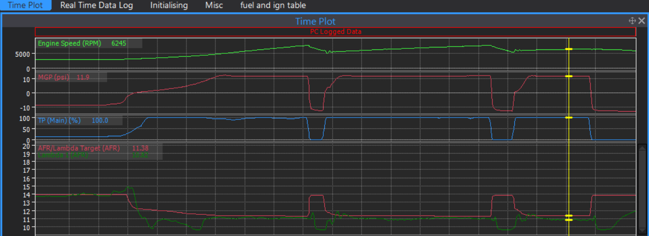

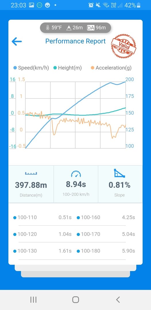

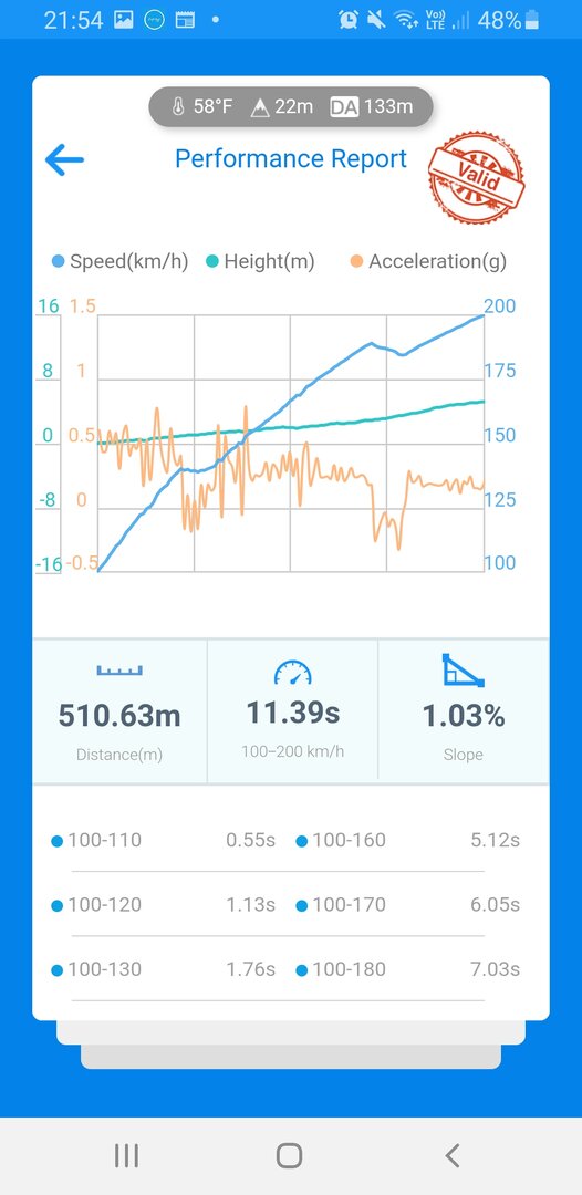

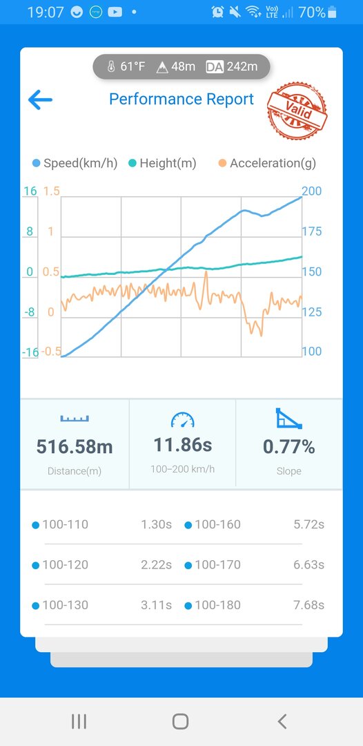

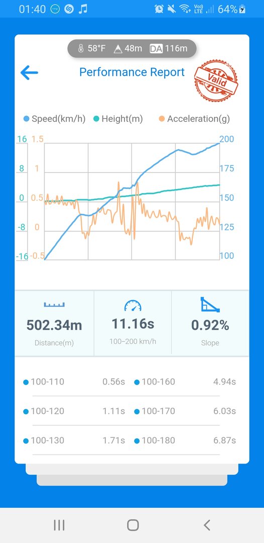

Tried again the next day....drier and a cooler. Made an improvement but not the kind I was hoping for. A 400hp RX7 should be doing a 100-200kph in sub 10s...so I did some data logging and found a few issues which I quickly fixed on the low boost tune.
The tweaks made to the map from the above data gathering exercise made a significant difference. 100-200kph in 8.94s was achieved going up an incline. This is a great result for 12psi circa 400hp power level. The tune in 5th is still very much on the rich side as evidenced below...so further optimizations can be made to the low boost/12psi map. I wont hold my breath for it to go much faster than this..perhaps a few tenths if i found a level road and leaned out the fueling in 5th
12psi 400hp 100-200kph in 8.94s. A lot better than 11s range.

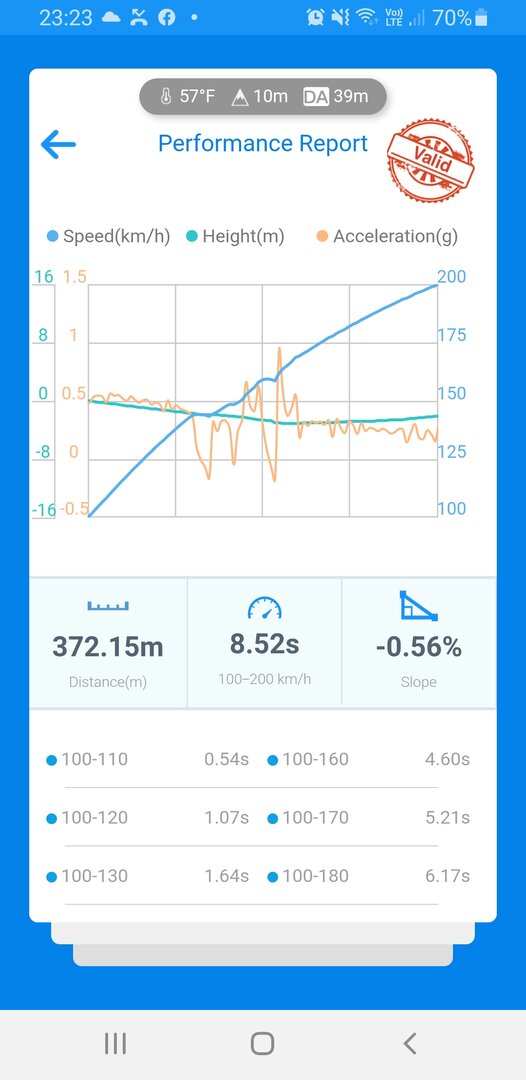

12psi 400hp and a 100-200kph in 8.52s is respectable, especially considering I had to do 2 manual shifts. If i had a DCT box....id imagine this would have been low 8s range.

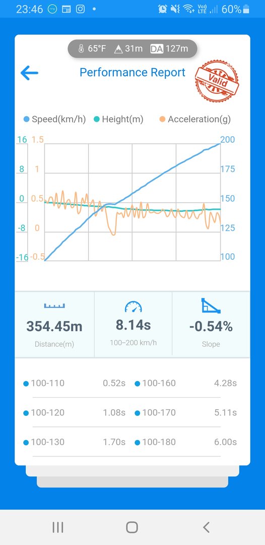

Final few runs to wrap up the 12psi map. 10*C hotter ait temps compared to my PB run and as I suspected low 8s runs from 100-200kph when the slope is bit more level. Starting to get a bit more consistent now with almost 20 runs ranging from high 7s range to low 8s range depending on temps and conditions. Overall very happy with the 12psi map including performance and most importantly the reliability.

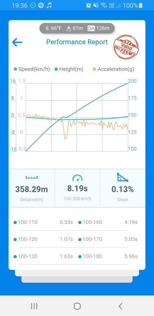

Finished the 12psi map and in hotter conditions with 30-35*C AIT with as optimized a tune as i'm capable of doing. I've ended with the FD successfully completing 25x 100-200kph runs. Overall I'm consistently doing low 8s range in hotter conditions with 30+deg C AIT's and with 20*C AIT the runs are faster. Overall exceptionally happy with the low boost performance and most importantly the reliability. The car just loves the revs and boost!
This is a run I completed in HOT conditions and the car is still doing 100-200kph in less than 8.2s on a hot day. On a very cool day high 7s are also done consistently. This concludes the 12psi tune and the FD with its manual box is fairly close in performance with modern cars like the OEM G80 M3 ( faster than the OEM F80 M3/M4 platform) and the 992 Carrera-S.

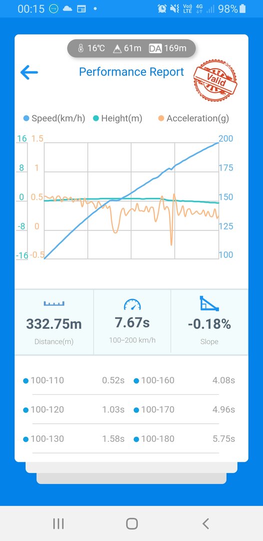

Had some time to up boost to 14 psi. The 100-200kph felt soo much better. Consistently in 7.6s range now! I need to get my go pro out and start recording these runs.
