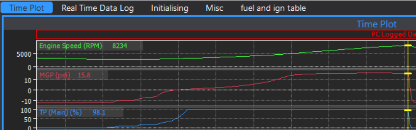

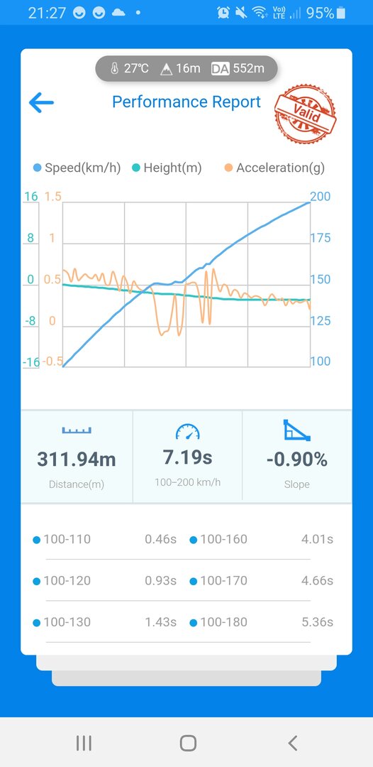

I've been going through some data I collected and to summarise
12 psi - 8.14s 100-200kph
14psi - 7.67 100-200kph
15 psi - 7.38 100-200kph
16psi - 7.19s 100-200kph
In summary, going up 4 psi I've gained almost 1s of performance. This is an insane real world performance gain by simply increasing the boost. So far its worth increasing the boost as the real world gains are being confirmed by the 100-200kph runs. I'll keep going until I max out the turbo or the gains stop.

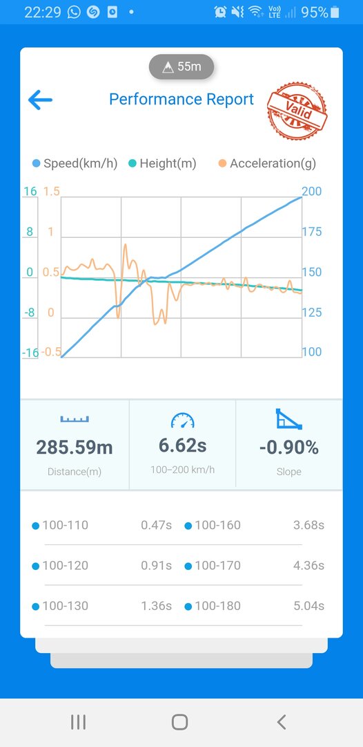

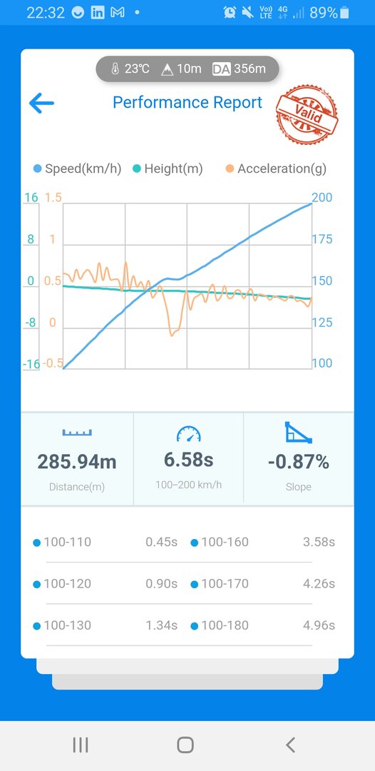

G35 1050 13B street port - 17psi runs a mega strong 6.62s range from 100-200kph. Everything on this run just came together.
Still running very much on the rich side...but I tune for reliability rather than outright power. Run felt smooth and strong. No ign breakup top end. Just right!! And the data confirms it.
18-20psi left to complete over the next few weeks. Hopefully ill be able to do this before the new 4" dp and exhaust system is installed!
Wasn't exactly holding 17psi to redline but its close enough for me.

17psi cleaned up..touch better. Firmly in the 6s range now!
Quite an insane achievement when I think about it. Changed the turbo and the results came to meet me. The old TO4Z was never this good at 17psi. Just goes to show that the G35 1050 is flowing crazy amounts of air for a mid frame turbo.
Think its fair to say I have achieved my initial goal of 450rwhp/very very close to it now!

To add some real world context to what a 6.58s valid 100-200kph means for a 30 year old RX7?
Lets have a look at the valid and verified dragy gps 100-200kph data collected by Auto Top Nl. These guys have tested some absolute weapons on their channel.

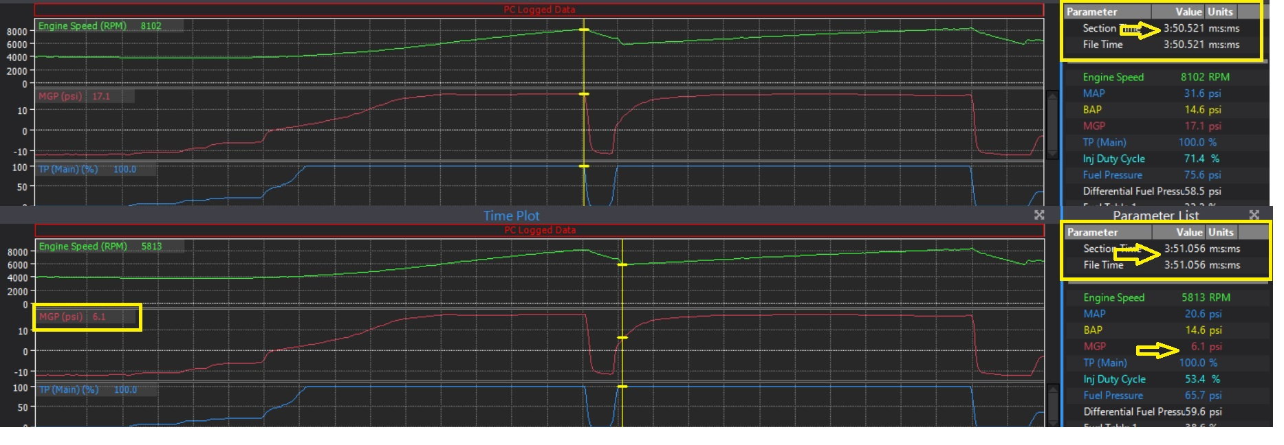

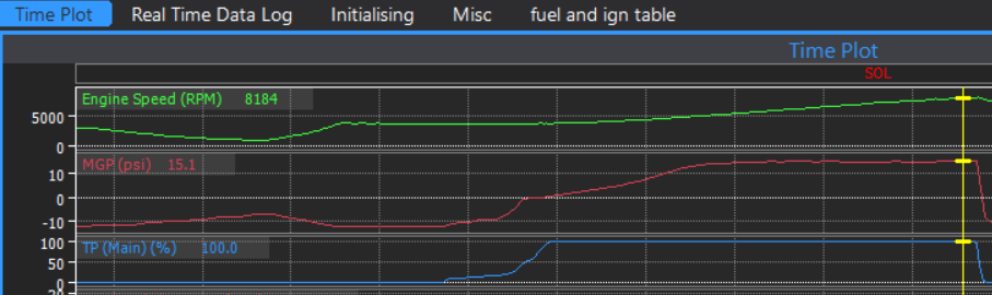

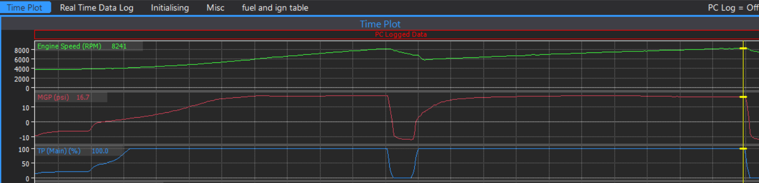

Now lets objectively take a closer look at the time lost by the rx7 because of it manual box and me granny shifting not double clutching like I should. Yes i'm getting all the excuses out haha!! 😂 (In my mind a faster shift = broken gearbox)
Im calculating from 100% TP in 3rd back to 100% TP in 4th and the time taken to make that entire manual shift happen.
3.50.521 is the section time in 3rd gear at 100% throttle (moments later as the TP falls to 0%.)
3.51.056 is the section time in 4th gear back at 100% throttle.
Total Time lost to the manual shift - 0.535s
Take note, in 3rd Gear at 8102rpm 100% TP i'm at 17psi (full boost level i was testing at). However in 4th gear 100% TP I'm at only 6.1psi. Almost 11psi outside the 17psi full boost window I'm testing at.

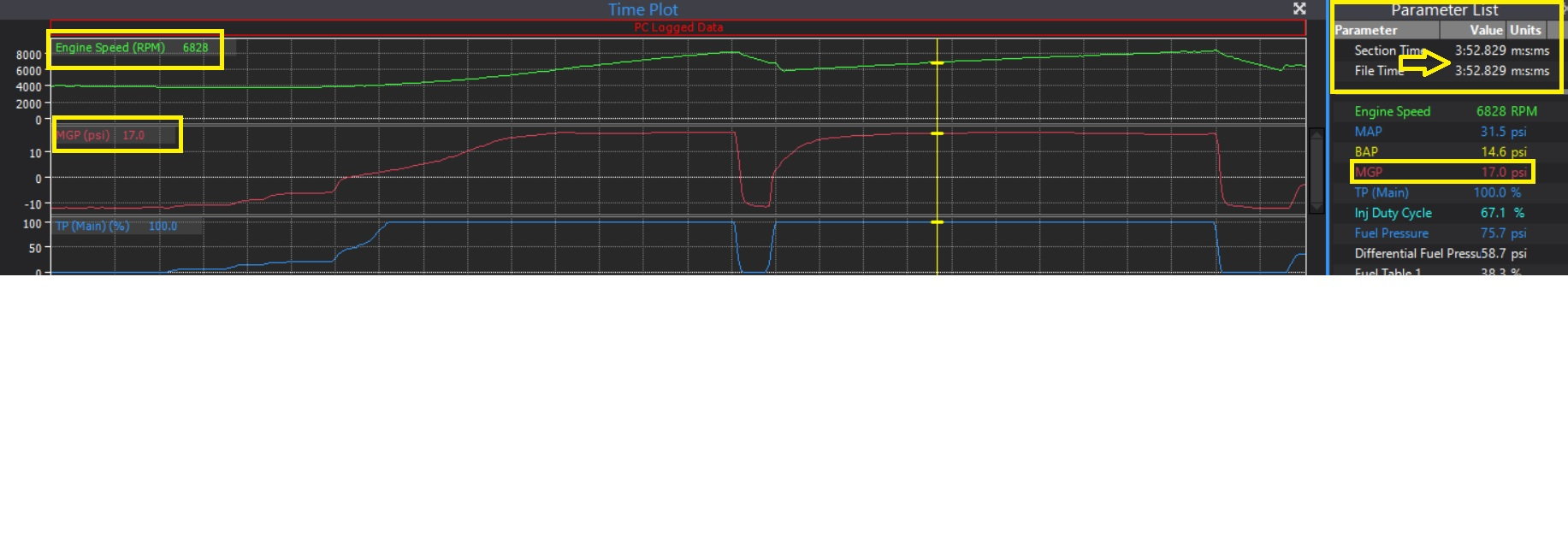

So how much time does it take to get back to full boost of 17psi? Lets take a closer look at the data.
For me the section time is 3.52.829 to get back to exactly 17psi. Im at 100% TP in 4th 3.51.056 = 1.773s to get back into full boost window of 17psi.
In summary, 0.54s lost during the shift and a further 1.8s to get back into the full boost window.
Isn't it great considering the time lost that the FD can still lay down a mega respectable 6.58s 100-200kph on pump fuel at only 17psi. I imagine with a DCT box which can shift up seamlessly within 0.1s and keep the turbo at max boost. The FD (without increasing a single hp) would easily run a low 6s range all day long.

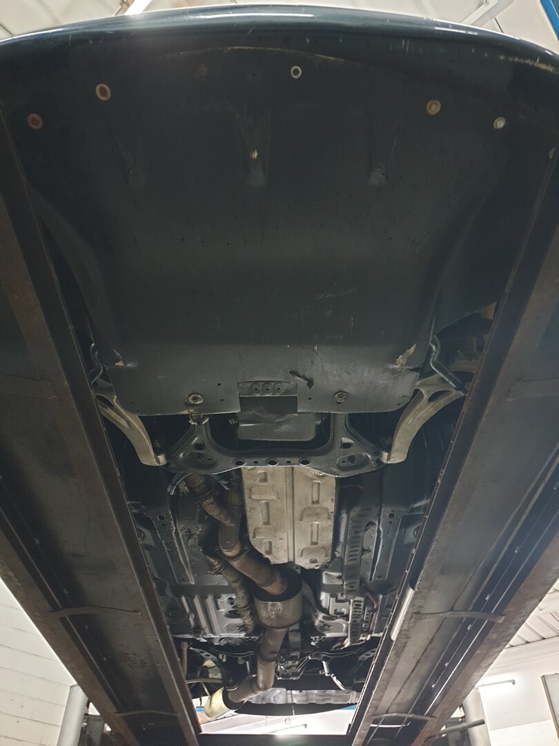

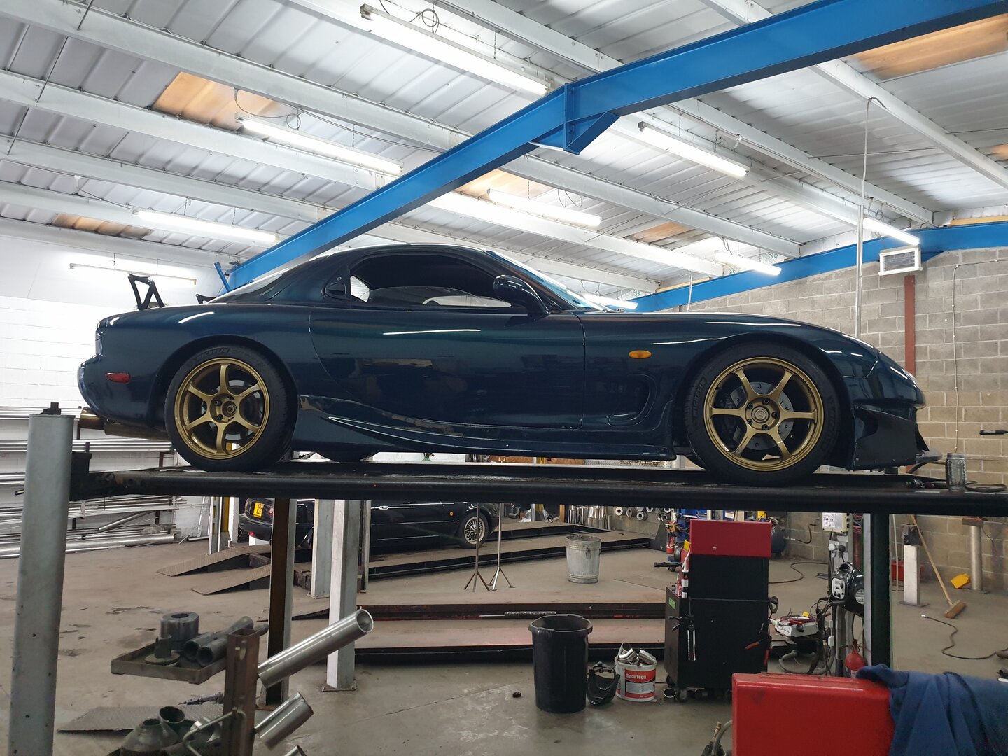

4" Dp and exhaust system. Gotta chase down those 5s range 100-200kph or die trying.
Didn't get a chance to test 18psi+ due to poor weather.
I'll re-run 100-200kph to see how the new exhaust does against the older one.
All things considered i guess everyone including me wants to see if 17psi on the 4" zaust can top the previous 17psi pb of 6.58s, which is already fairly respectable for a street port with a small ish turbo ha!
