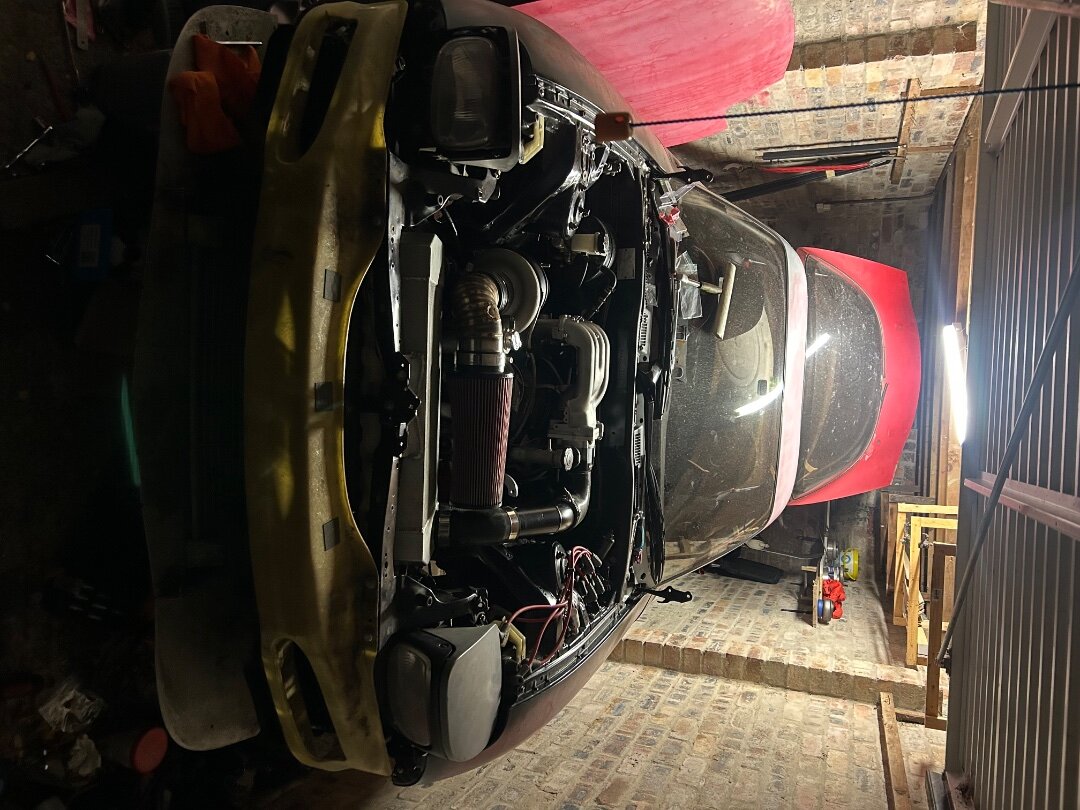

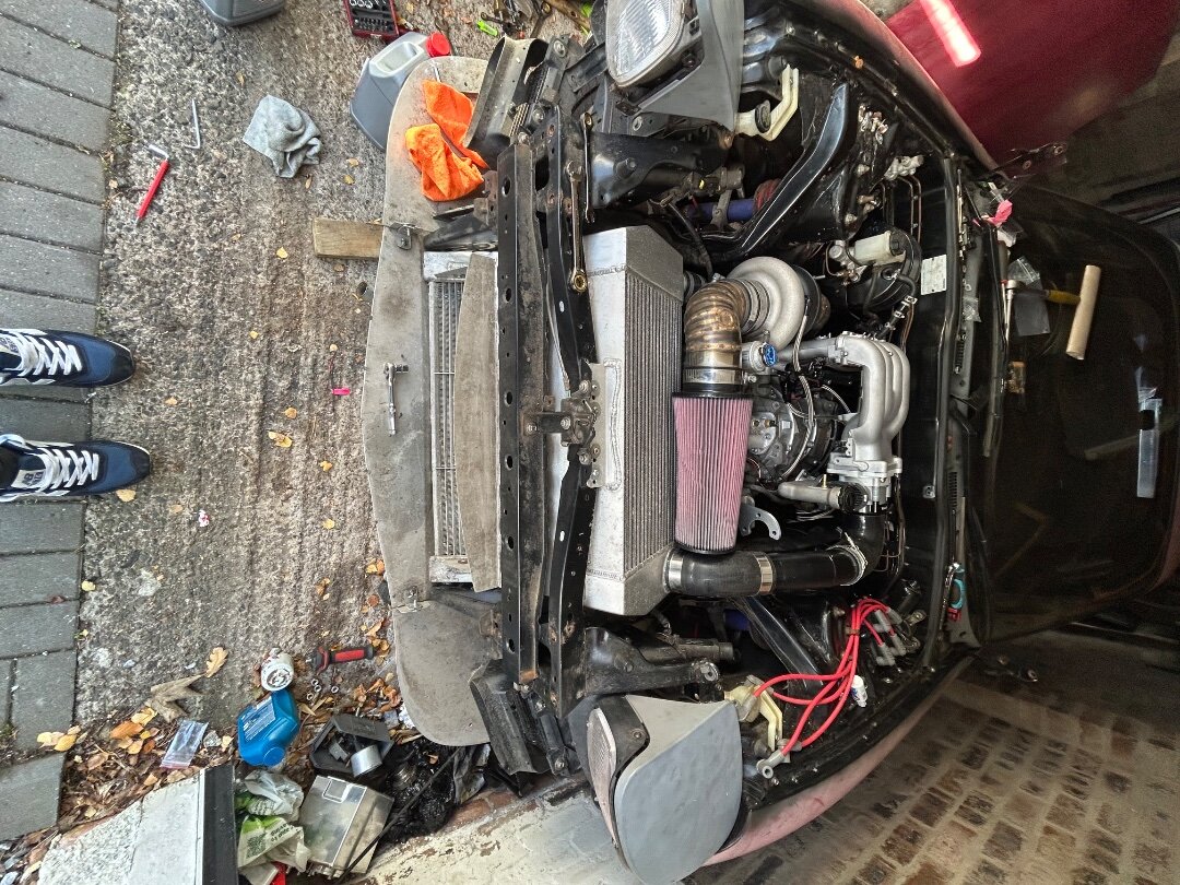

Some more progress today

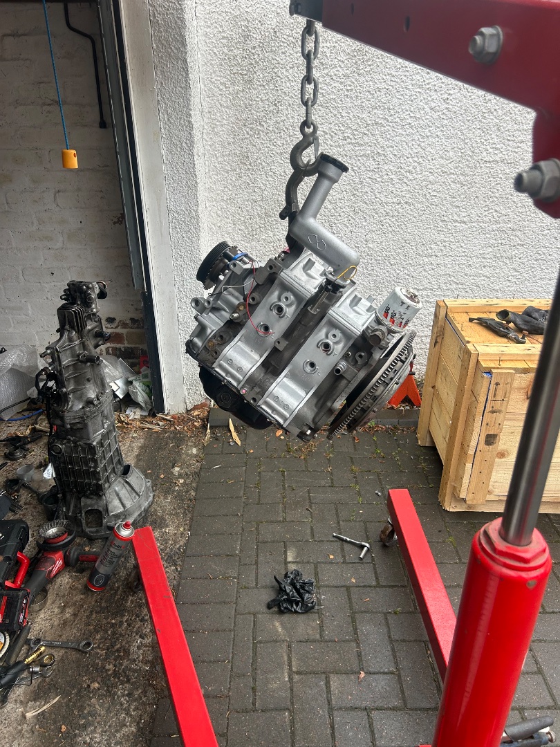

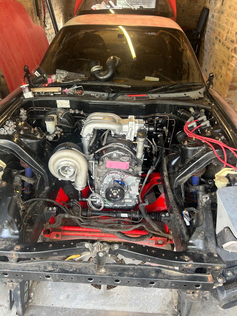

Cliff was gonna come give me a hand but I’m impatient and was at a loose end so thought I’d get a start on fitting the engine
Was a pain in the arse doing it on the deck the ppf and prop were right in the way but never mind I got it in a wee pic of my wheels too gonna keep the gold it will work well with a black car

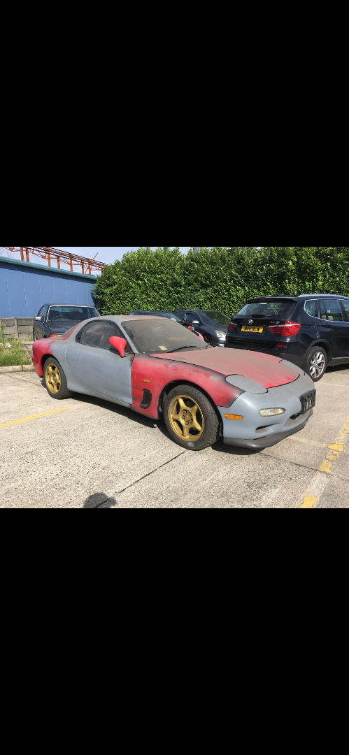

I’m trying to find a pic of my old Fd some folk might remember it from the Fduk days

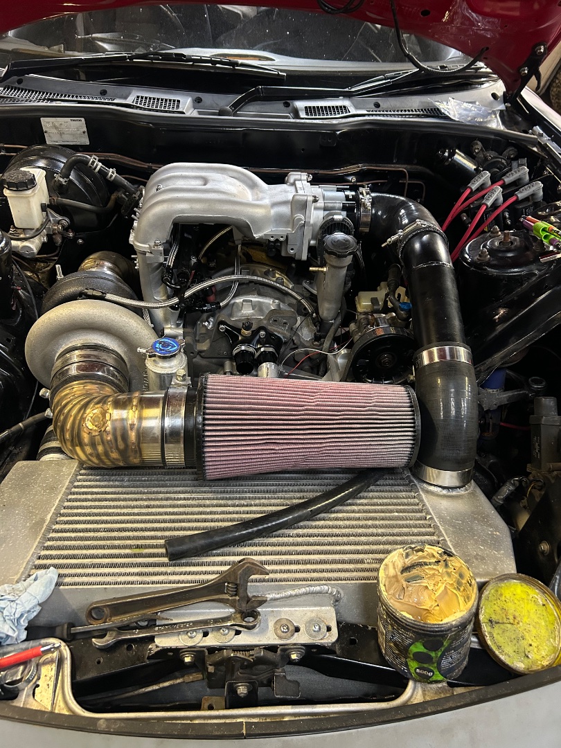

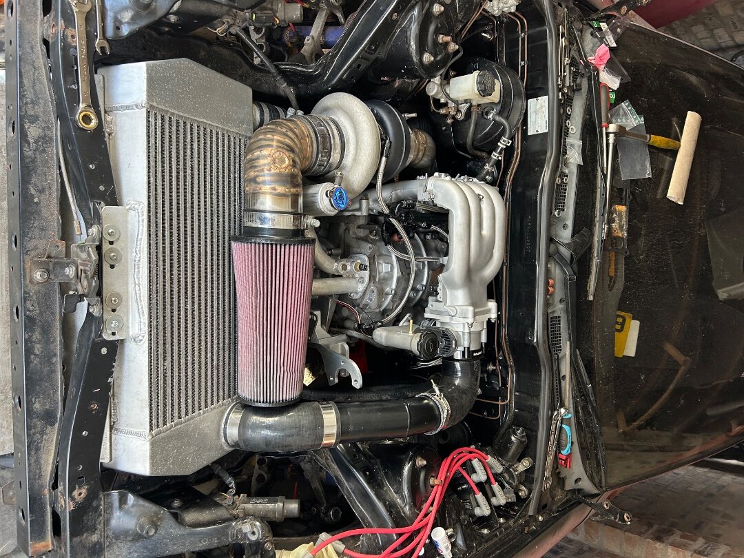

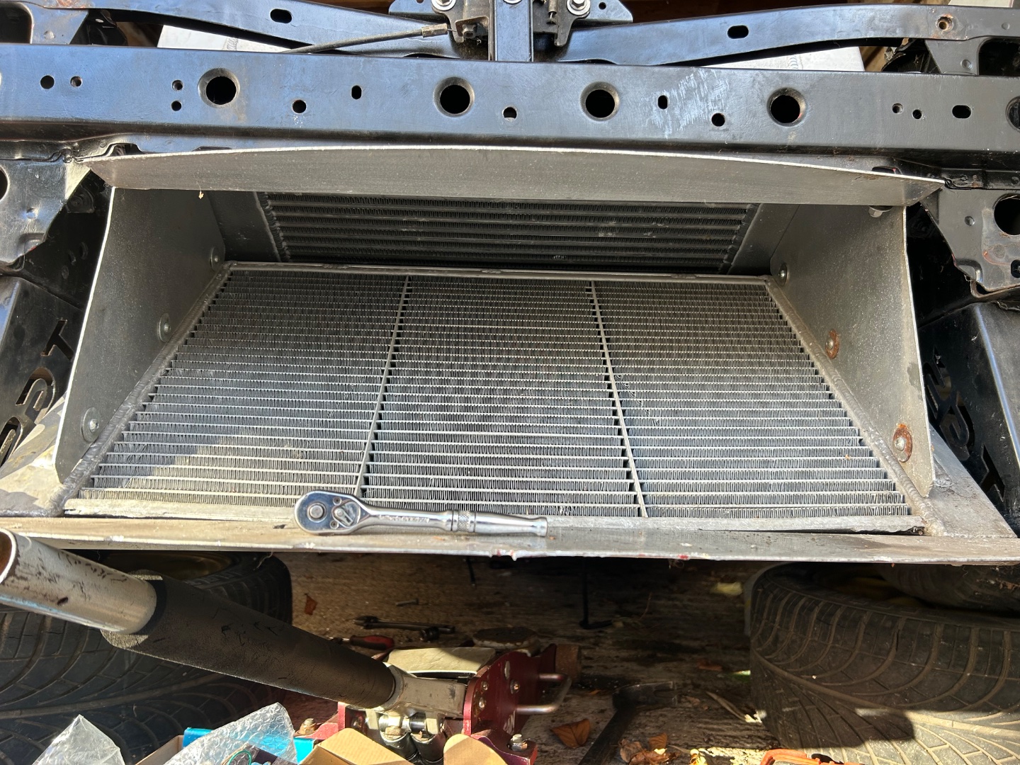

Bought another alternator relocation kit as I have went back to power steering found a load of metal filings in the intercooler so 10l of brake cleaner and a load of blowing it out with a airline it’s all clean
Hopefully have it back on its wheels in the next few weeks then it’s ready for paint or wiring probably wiring first then paint I guess anyway here is some pics enjoy

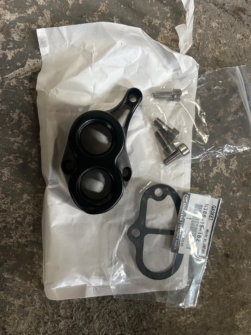

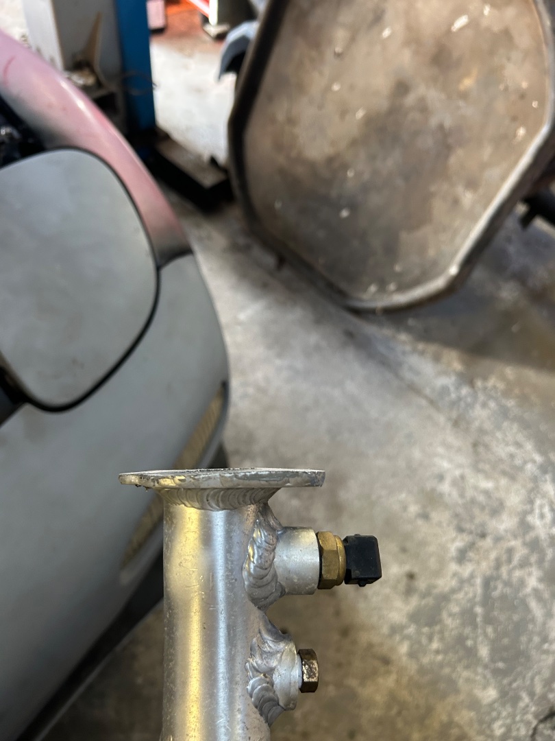

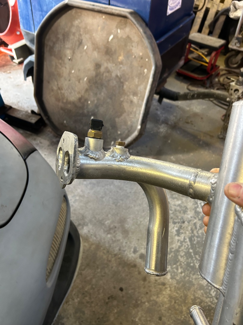

Put some coolant in the Fd and of course it was leaking at the filler that tgs had made it wasn’t flat from all the heat from welding so I put it on the belt sander I got it almost perfectly flat but wanted it perfect and of course it got jammed on the sander and ground it down to a wedge hahaha

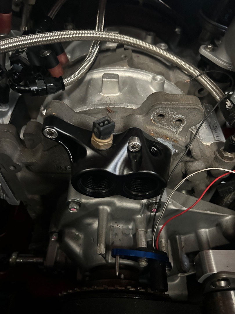

So I bought this billet adapter from Ryan rotary performance and it’s great has outlets for water cooling and temp sensors

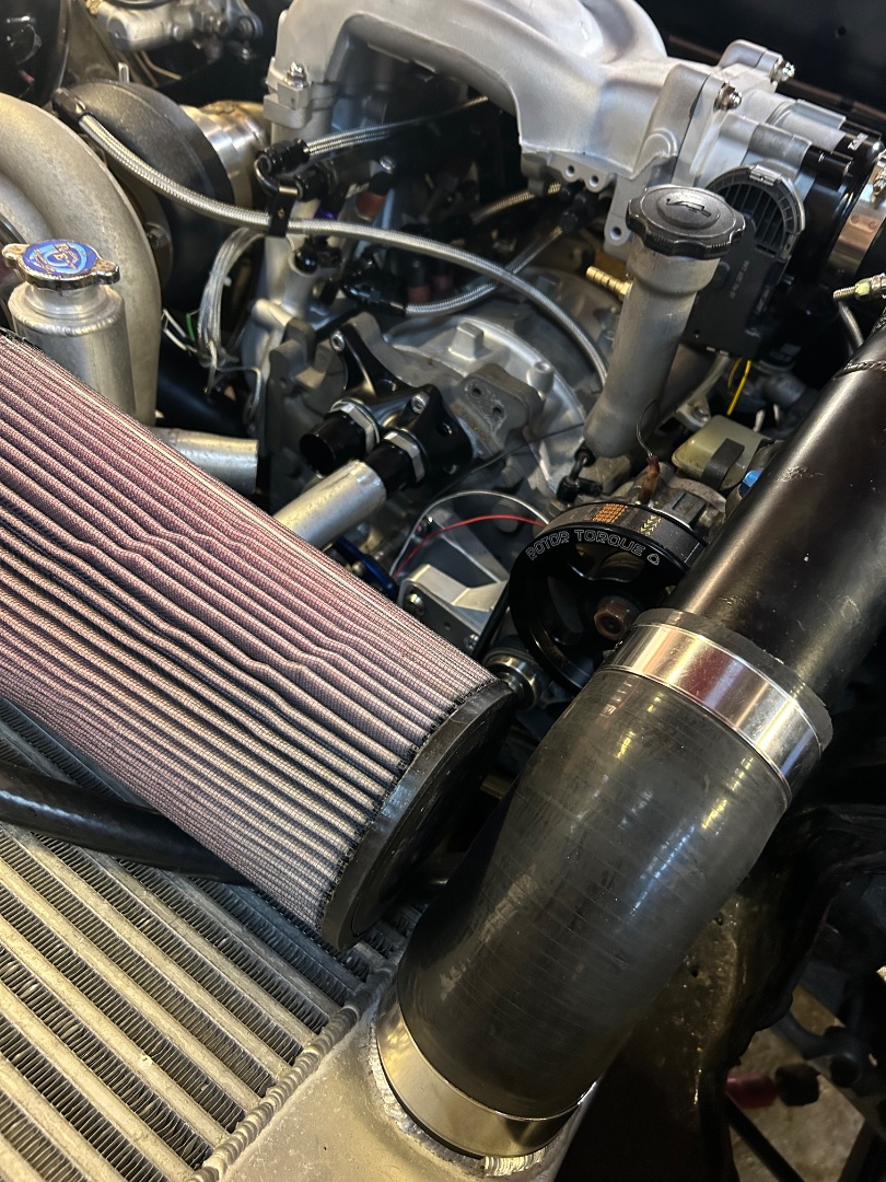

I also fitted a power steering pulley from Stu and got a uc10 and mount from him
I have a maxx ecu race sat and pdm20 too
It’s booked for wiring in April so I’m looking forward to getting it working then it’s just paint

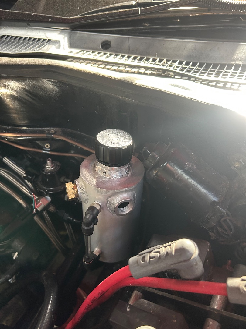

Not a huge amount to report done the coolant setup and bled the coolant perks of a ewp also bought a cheap catch can and modified it to take that cap which is a built in breather now it’s just a case of bleed brakes/clutch and make lines for the catch can then I’m ready for wiring can’t wait to hear it running

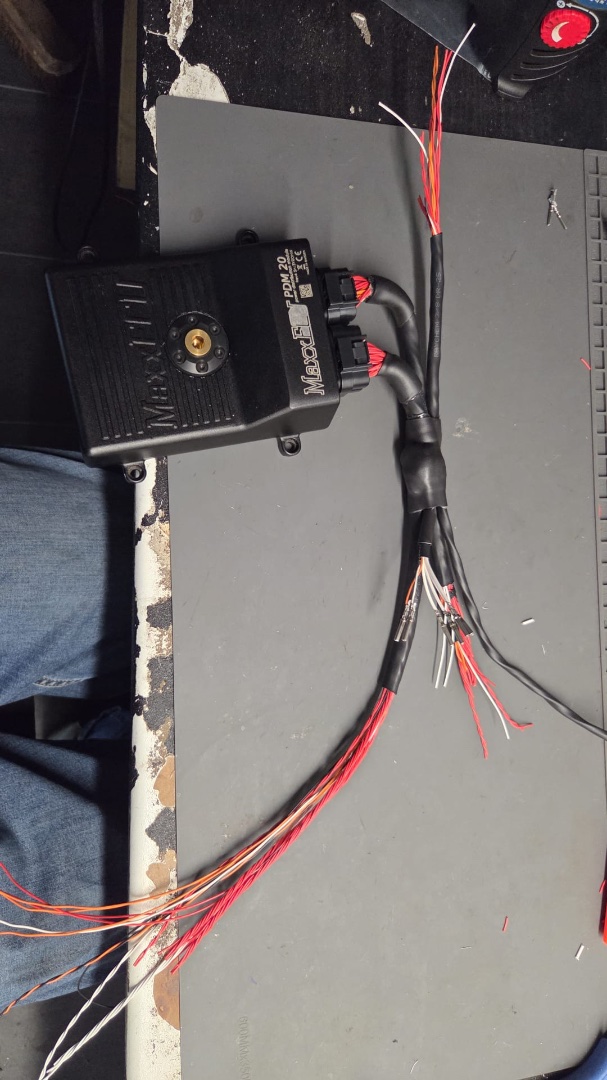

Wiring is coming along and hopefully the car will be started either this week or the next

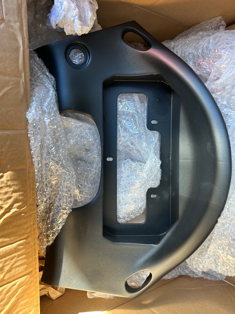

I bought a rear bumper off cyman as my one is wrecked so will be less effort when it comes to painting the car
