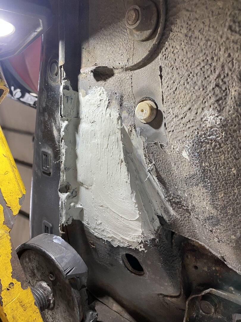

Just out the corner of my eye I noticed this patch where the sealant had broken away, not sure whether it’s the weather that’s caused it but either way it needed sorting!

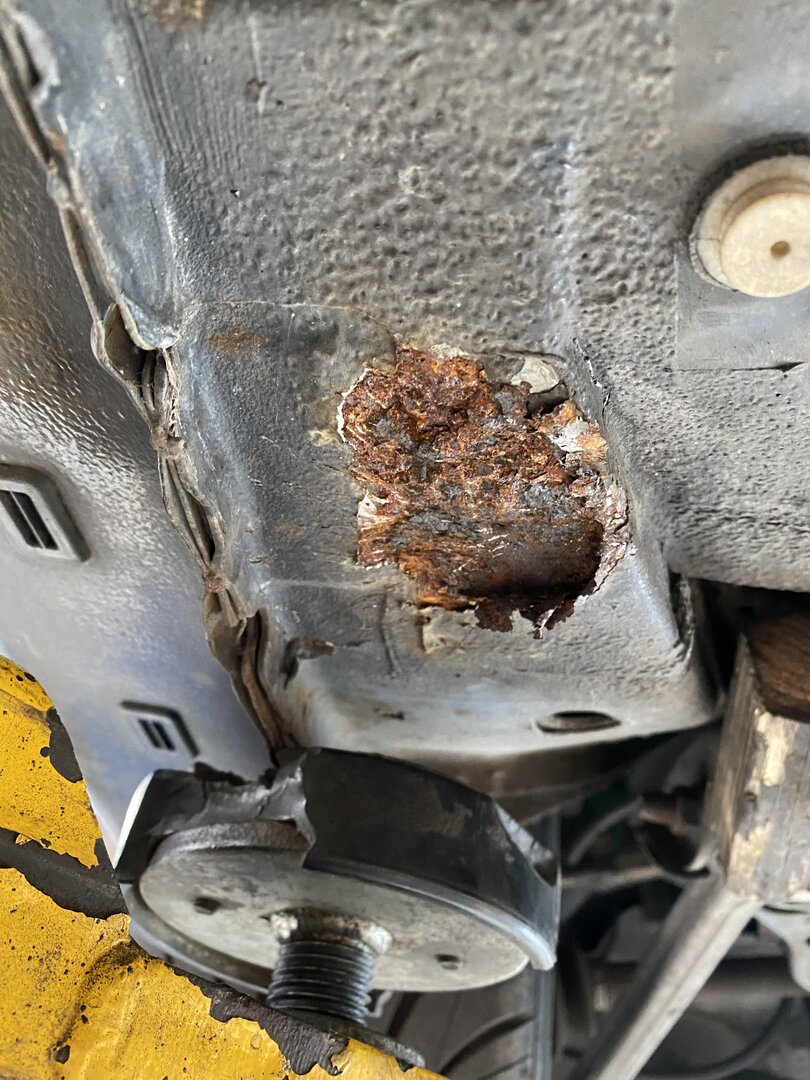

Go go gadget Angle grinder with wire wheel attachment - cleaned up okay ish but with the way the panels meet it wasn’t ideal 🙄
So from my point of view looks like it’s been incorrectly jacked up and the panel seams have been split from it- oh yay! think he did mention that this tyre kept going flat 😂

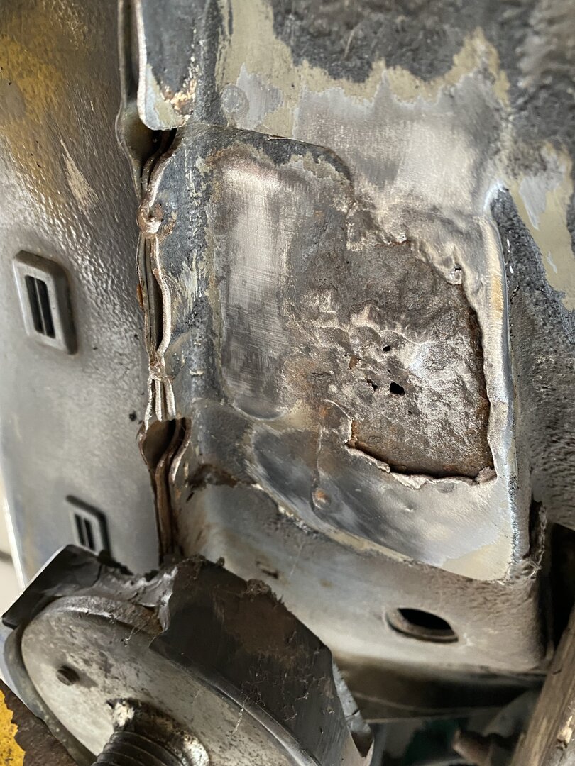

So I cut the bit of rust out best I could without trying to disturb too much, unfortunately the inner boxing had been caught by the rust so I wire wheeled that till it disappeared and I was left with clean metal- I’m not a professional welder as you can see but it’s got the job done- a small piece of 2mm thick steel and we are good to go!

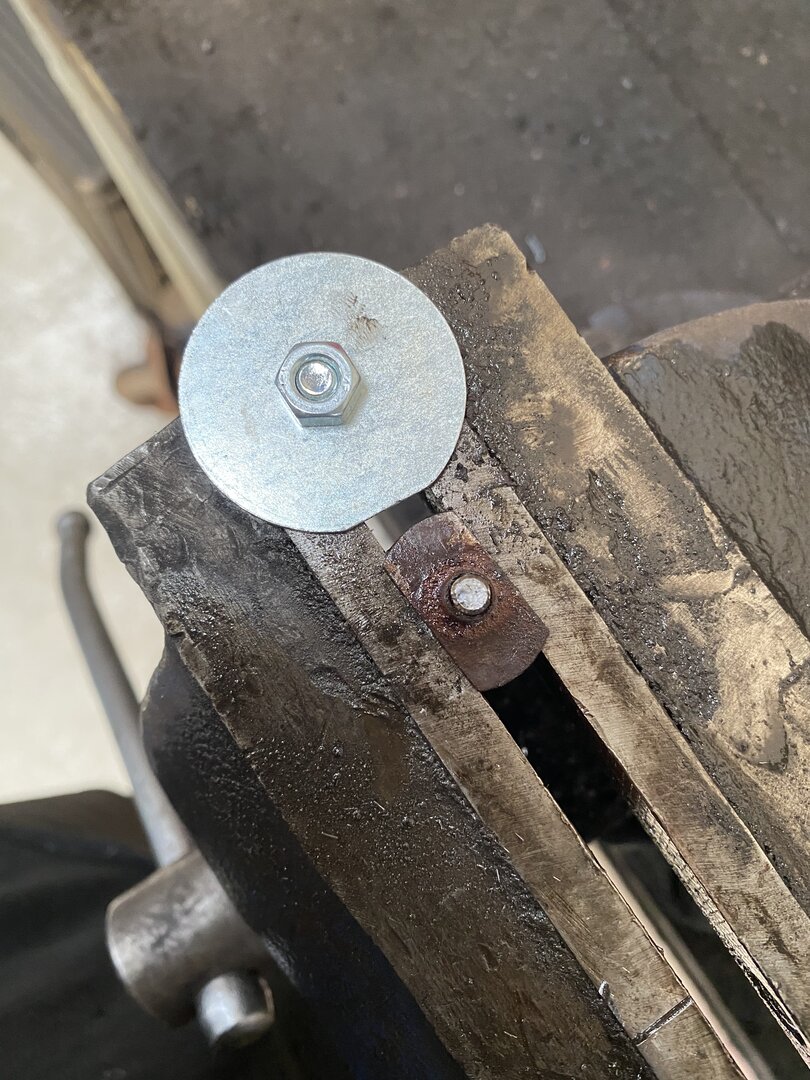

So continuing on, one of these little bastards didn’t come out, tbh he looked crusty asf and I knew it wasn’t my day so had to make up a suitable replacement! Nice washer and nut combo and some quick welding- this should suffice!

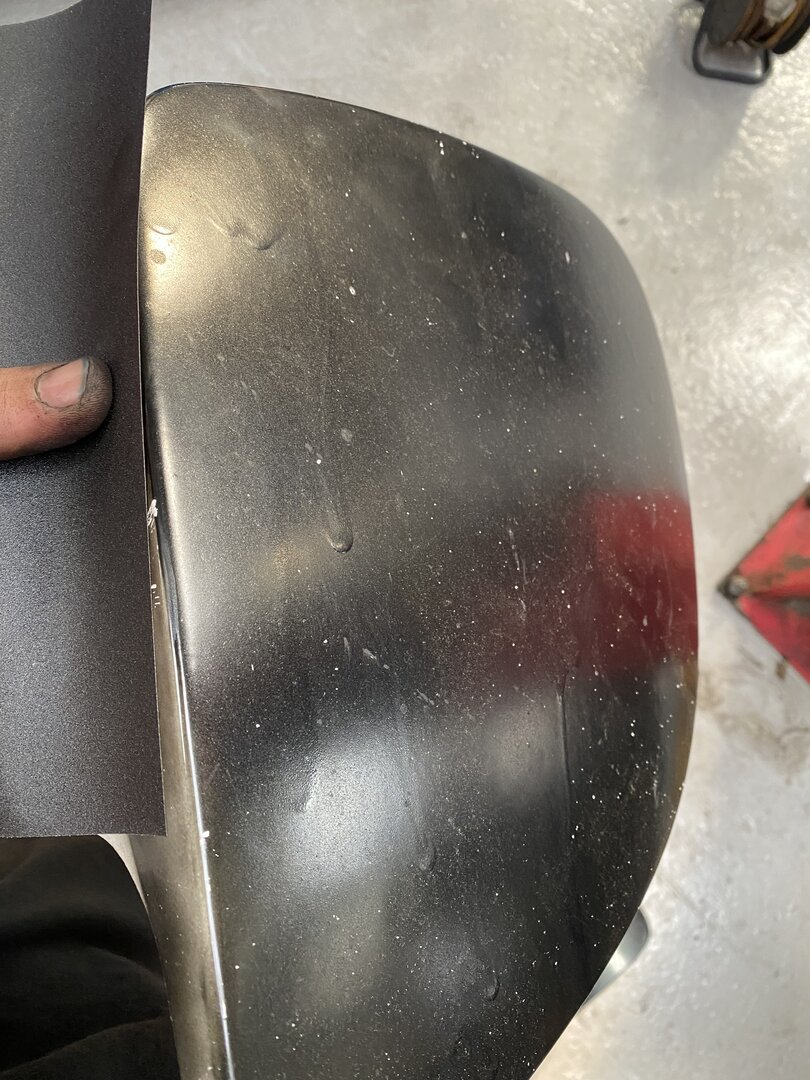

So the real reason I was messing around with the headlight caps is because the previous owner lost of the lids and gave it a quick lock of paint?m, me being me needed to sort this as it was driving me crazy so I spent and hour faffing around sanding down the runs and taking off the paint ready for painting tomorrow!
Hard to tell from the pics but if ita under the drivers footwell them possibly an old brake fluid over fill spill! Its what created it on my fd

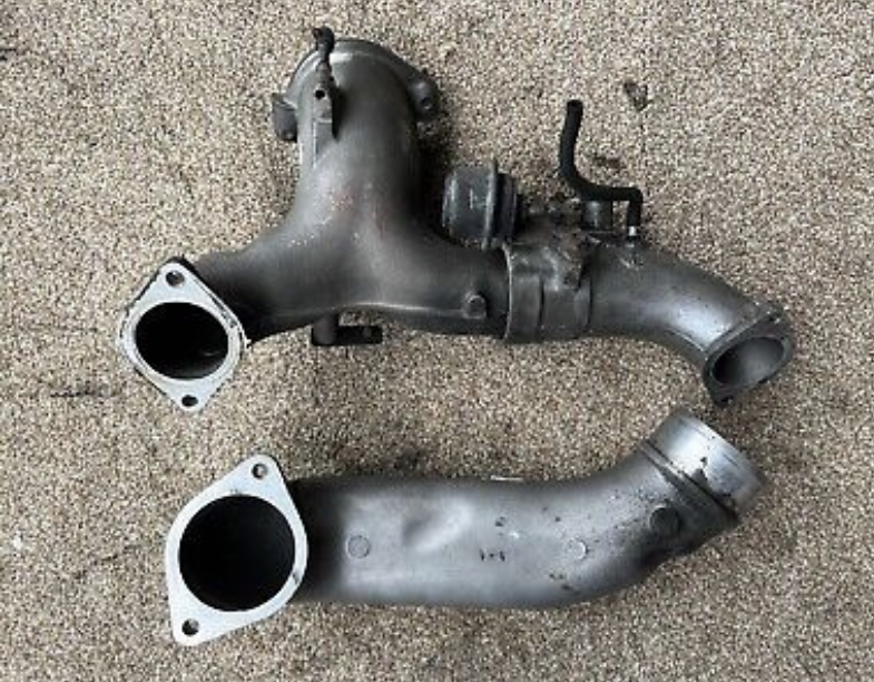

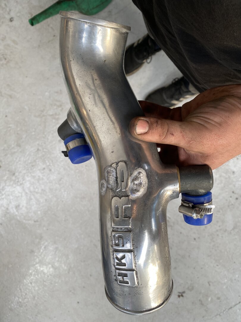

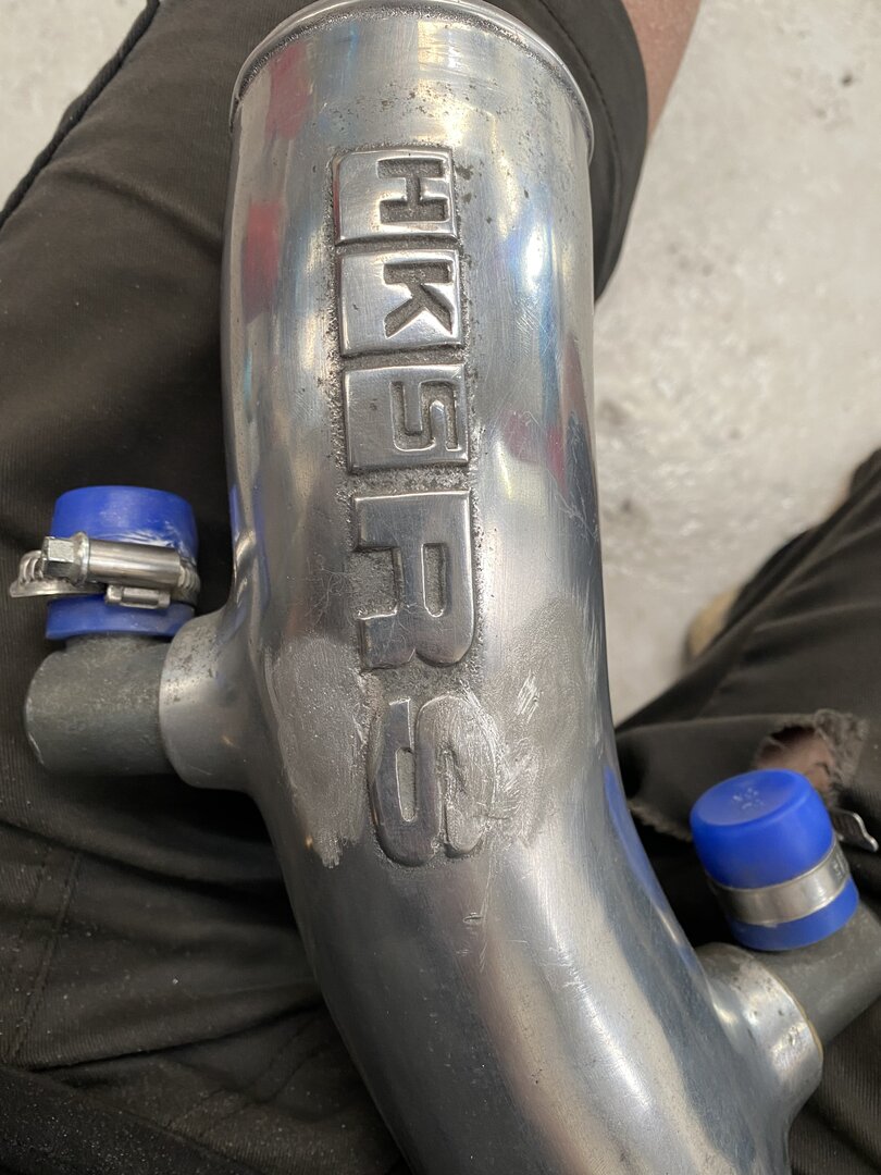

So I bought these hks racing auction intakes off @Jit, they had damage from where assumably they’d been touching the front strut brace, this wasn’t going to do
Nice work, now what about scuffing and powdercoating black then sanding off the HKS RS and buffing before clear coating?
Now that would look smart, only problem with polished bits is the amount of time it takes to keep them clean and polished and not oxidised.
