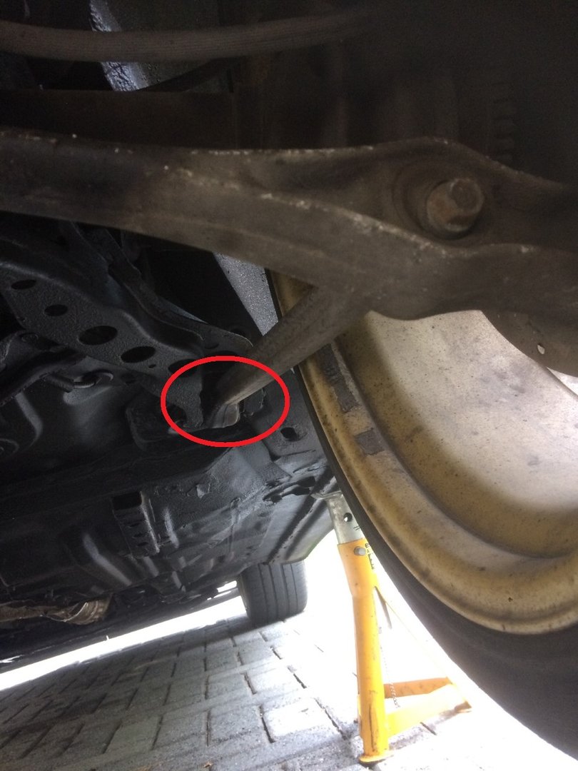

Is it this bush your referring too ceylon circled in Red?? Part No: FD162852Y
No, the control arm is the one with the two pillowballs in it. The inner bush that goes into the subframe with the camber bolt through it is the one you need to order (y).
The culprit is the small dog bone shaped one which you can only see when you remove the wheel..
