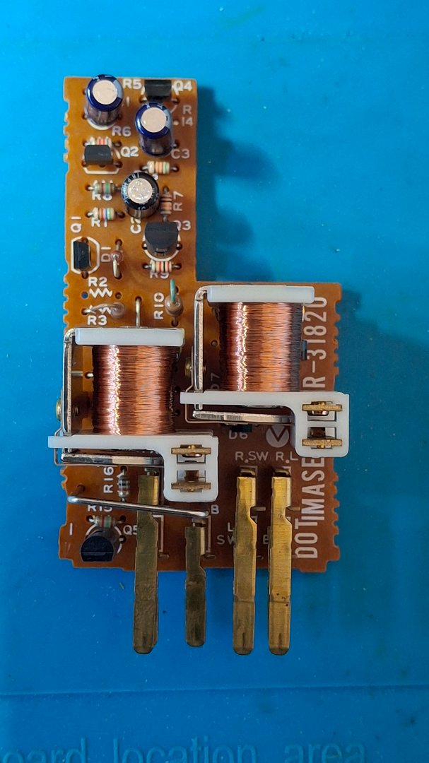

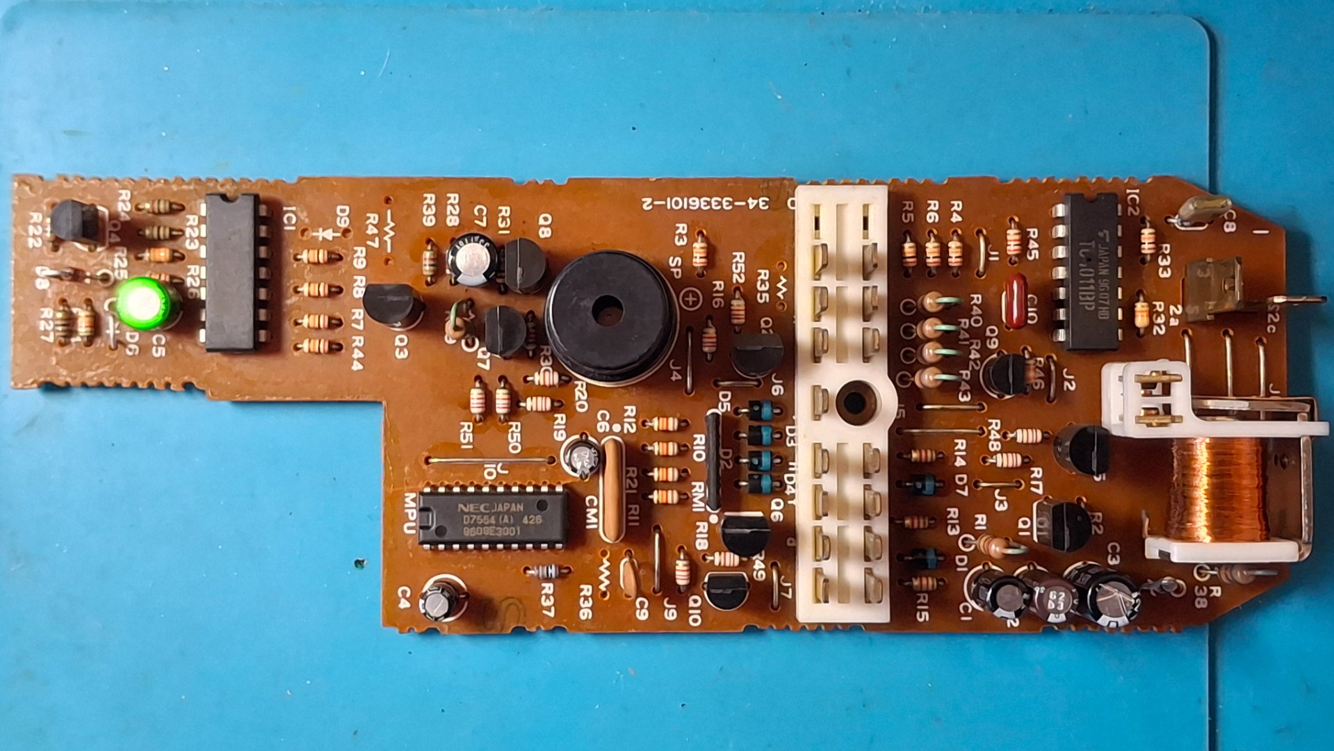

Following on from my cluster repair work (see here) , I'm now investigating how to repair F100 modules (and closely related F110's).
Related old thread from 2018 here
Many thanks to Efini-dan for the loan of his F100 to develop a test box. I have already dismantled the module for a quick look:
The F100 performs similar functions to it's predecessor, the CPU box in the RX-7 1st gen (FB).

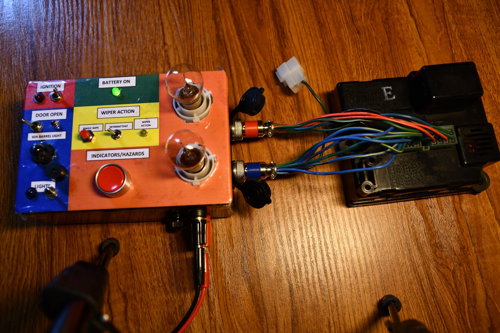

Some years ago, this was my first "RX" test box project, a tester for that CPU - amazingly, the main connector on both modules is exactly the same, so I can use re-use my test harness without the need to make a new one!
FB test box:
The same connector fits the F100!

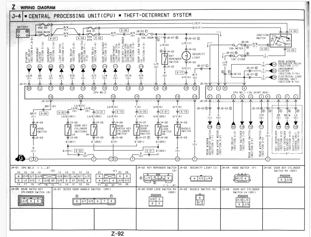

All the wiring diagrams (USA based I'm guessing) refer to the CPU#2 having a 20 way (J4-01)and an 8 way connector (J4-02), as in this diagram:

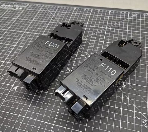

I found this picture of "CPU#2's" online which showed an FD01 and F110 (later variant of F100). Same size and shape casing, but much newer PCB design inside. Crucially, the FD01 has the 20 and 8 pin connectors, as per all the wiring diagrams I have found.

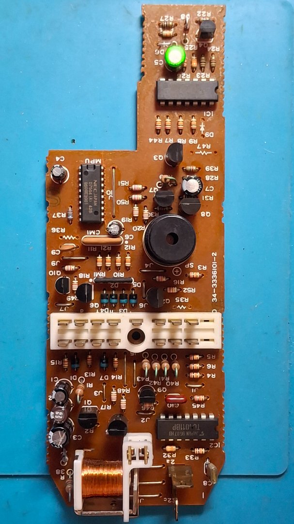

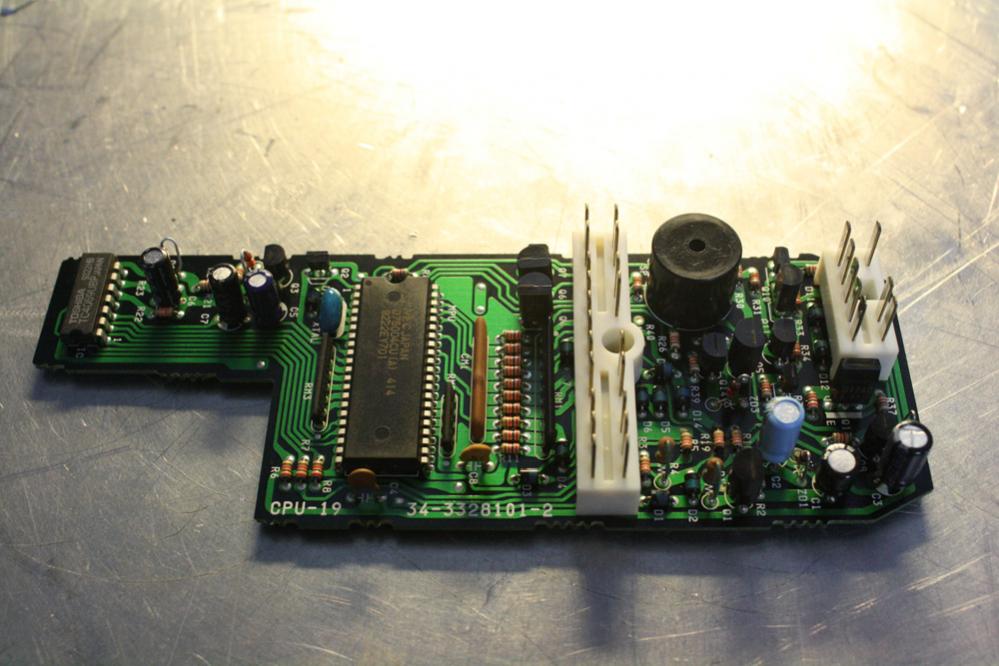

PCB inside FD01:

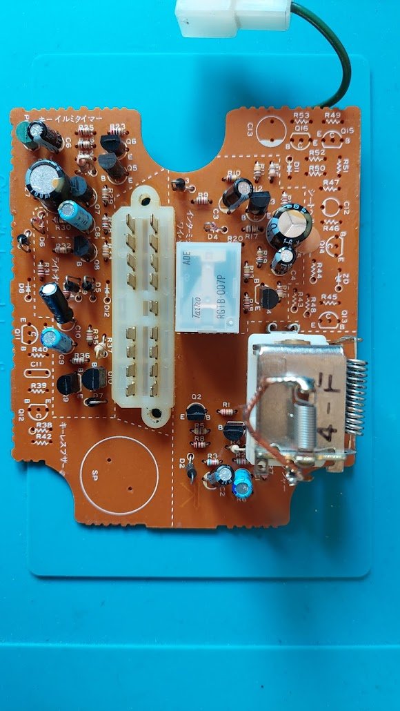

A much newer, double-sided PCB board, same shape as F100 PCB, but totally different!
So, there are 3 different CPU#2's!! Does anyone know anything about these "variants" and why they exist?
I need a wiring diagram that relates to the F100/F110 that is, seemingly, the most common module in (I'm guessing) JDM and European spec cars? Can anyone assist? Worst case I'll take a Japanese diagram, if that is the only one available, as I have a friend who is a Japanese translator.
I'm going to struggle without knowing how the F100 connects to the car!

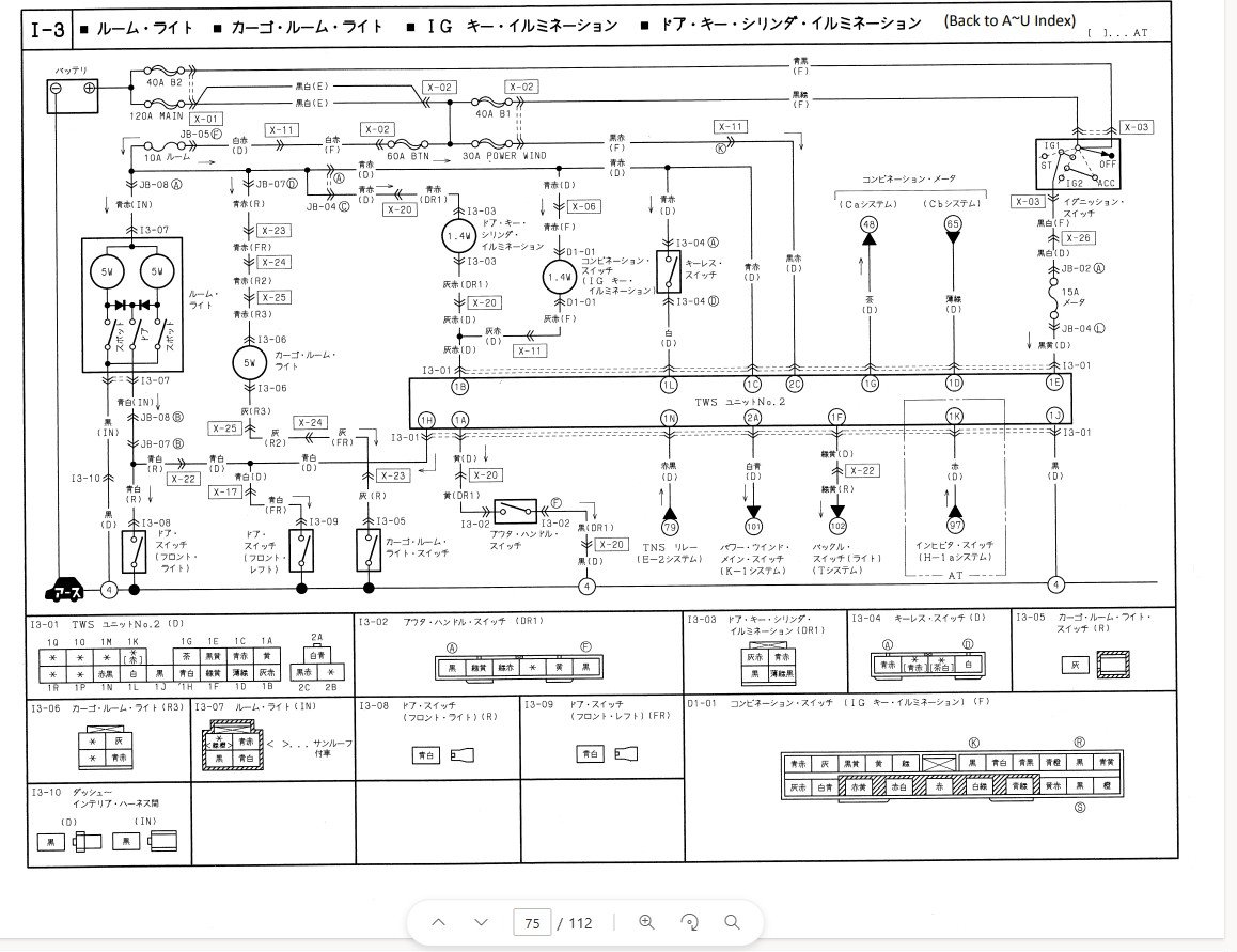

Update - I spent a couple of productive hours this afternoon with more "reverse engineering" of the F100 module. I reckon I have 80% of the circuit mapped out and I know which of the connectors go to IGN, BATT, or are inputs or outputs. Some of the circuitry is beginning to make sense now. In some cases I know where the inputs and outputs are connected (switches/sensors, lamps, etc). I have a English friend who lives in Japan and does translation for a living, so I have asked him for a favour, to see if he can translate this, as it would enable me to complete the task of understanding the F100 functions:
Eureka. I just found another document that confirms exactly where all (but one) of the F100 connector pins go (e.g, door switches) and the conditions (BATT, GND, etc) to be found on each of the pins.

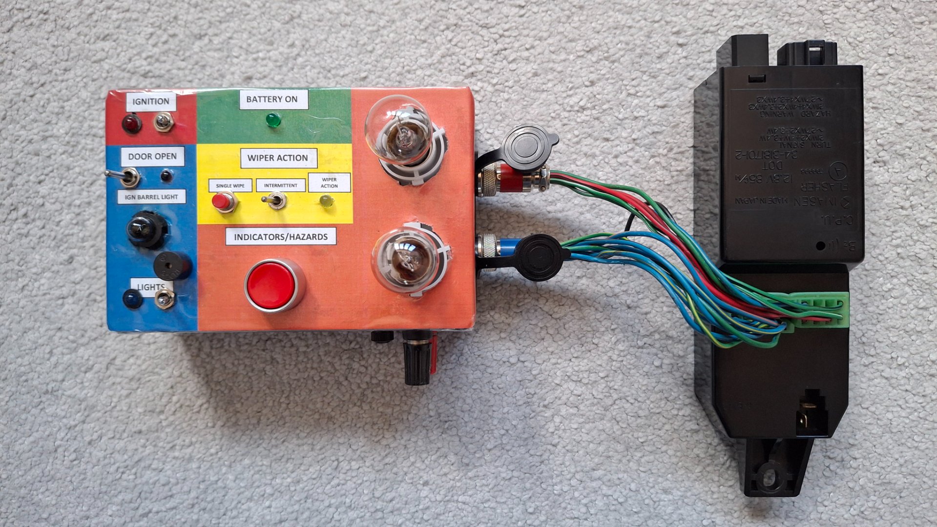

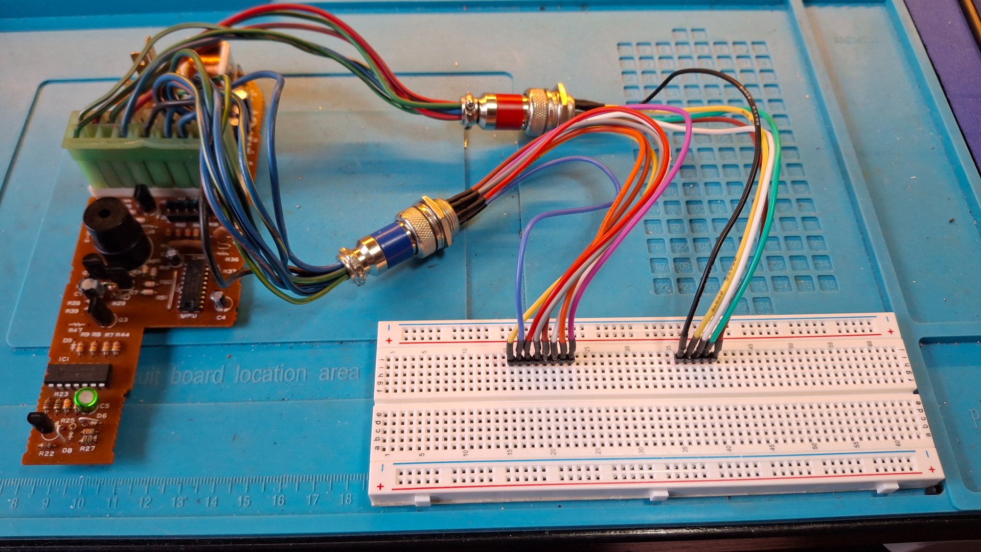

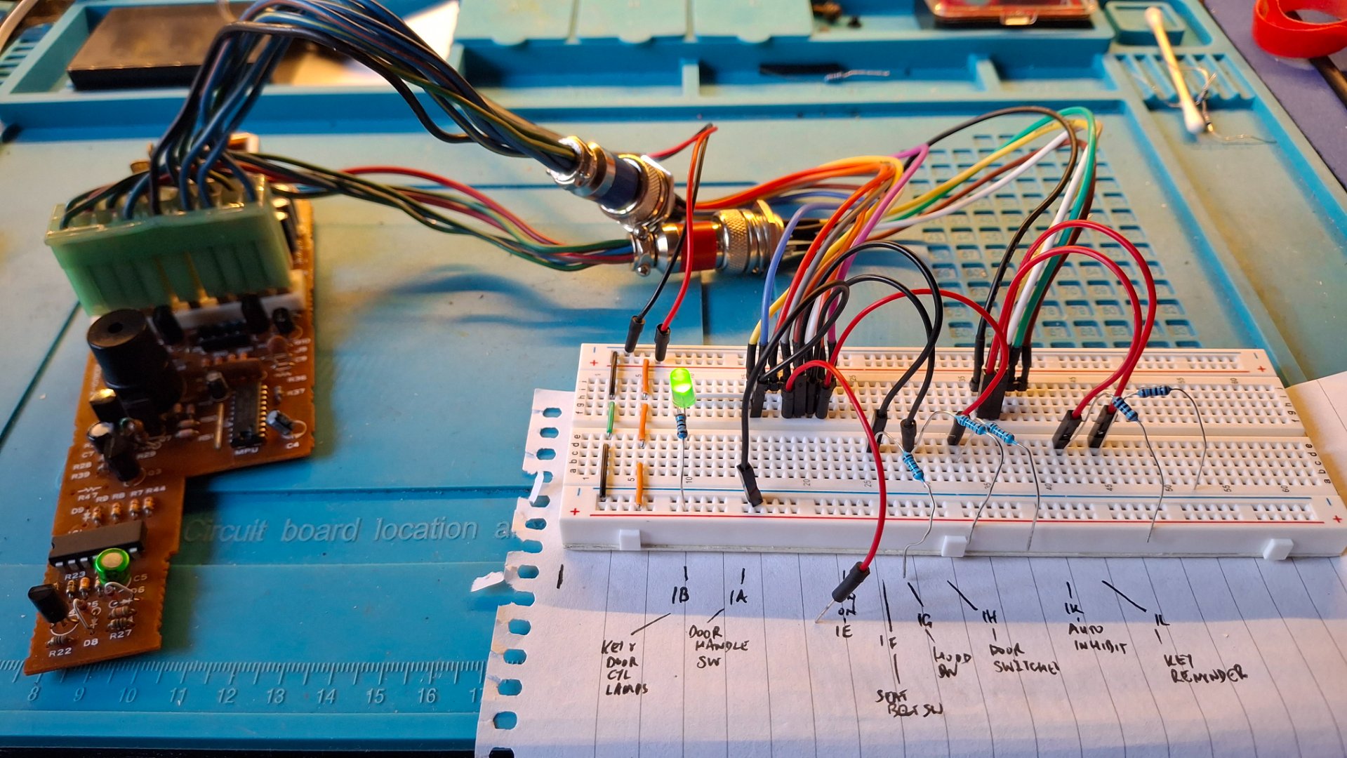

Some more progress, I have lashed up my original (RX-7 FB) test harness to a new set of connector sockets and on to a breadboard, so I can test the various inputs and outputs, before I decide on a design for a bench test box. Unfortunately, my FB harness is not fully populated with pins, so I cannot use this setup to connect to Pins 1D and 1N on the F100 module. However, the good news is, I have found several possible sources of the connector shell, and the pins, which need to be purchased separately. Sadly, the UK sources are very expensive, with a high minimum qty order. One of my US based suppliers stock then, but have recently increased their shipping charges, so I will have to wait until I can get another order of sufficient value to make it work.
With reference to the JDM "I-3" wiring diagram posted above. I have been able to confirm that pin 1A must connect to the door handle switch. When the handle is gripped momentarily, a ground signal is sent via pin 1A. If the ignition is not on, then pin 1B outputs a ground to operate both the door key cylinder and ignition key cylinder 1.4W lamps. The lamps will remain on for about 16 seconds, or until the ignition is switched on, whichever comes first.
If the ignition is switched on and pin 1H is at ground, then the buzzer will sound. The JDM diagram shows 1H as connected to the two door switches and the boot switch.
Not having an FD myself, can anyone confirm if a door is ajar when the ignition is turned on, the buzzer sounds?
If the ignition is on and pin 1K is at 12 volts, then the "buzzer" makes a chiming sound. I'm going to guess the JDM diagram is incorrect and that this alarm is a seatbelt warning?
Again, can anyone confirm that, with ignition on and seatbelt off, there is a chiming sound? If not, under what circumstances can chimes be induced?
Here is my simulation of the door handle activated key cylinder lights, represented by the illuminated green LED, centre of photo.
