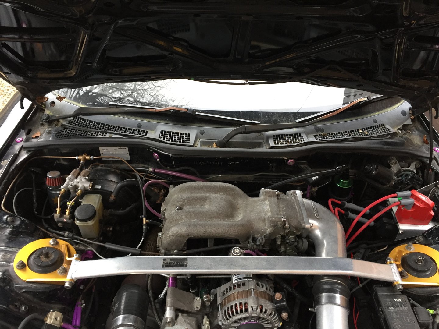

Had a kink in a brake line, used it as an excuse to re-do my ABS delete. Tucked the lines underneath the lip on the firewall using clips.

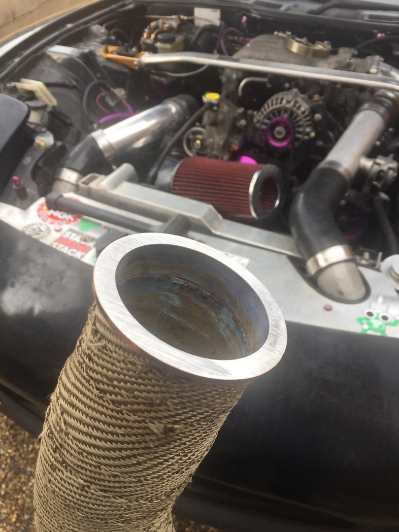

Got a friendly local engineer to belt sand my v-band flange. Has made the leak better, but still not 100% so I guess I’ll just live with it. Fucking v-bands.
That's exactly what I did with mine was belt sand both halves but then used a slither of exhaust paste as I couldn't get mine 100%. The stepped ones are the ones to get. Next time I make one that's what I'll use.
Get yourself a V-band gasket Jack, its just a crush seal.
Might be worth the small punt on it.
Cheers! Seen those before in my many research sessions. Unfortunately I need a 2.75" gasket as my turbine housing is an odd size. I have tried making them out of copper but still no joy.
Just out of curiosity, is your turbine housing warped/used? I have a turbo that turns out to have a warped housing including a warped vband flange. Maybe you can have that sanded as well...mine is leaking and warped badly so I’m just going to replace my turbine housing and be done
