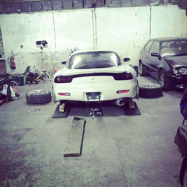

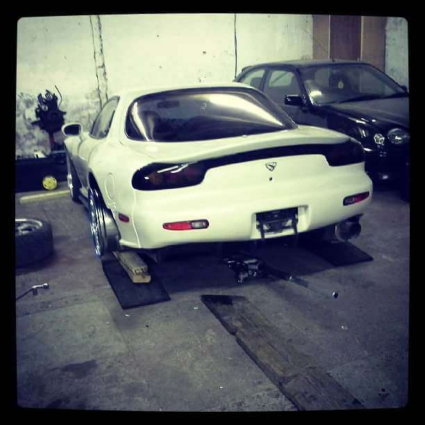

Anyway, back to the RX7, here's a couple of pictures I took before taking it apart again to start working on it:

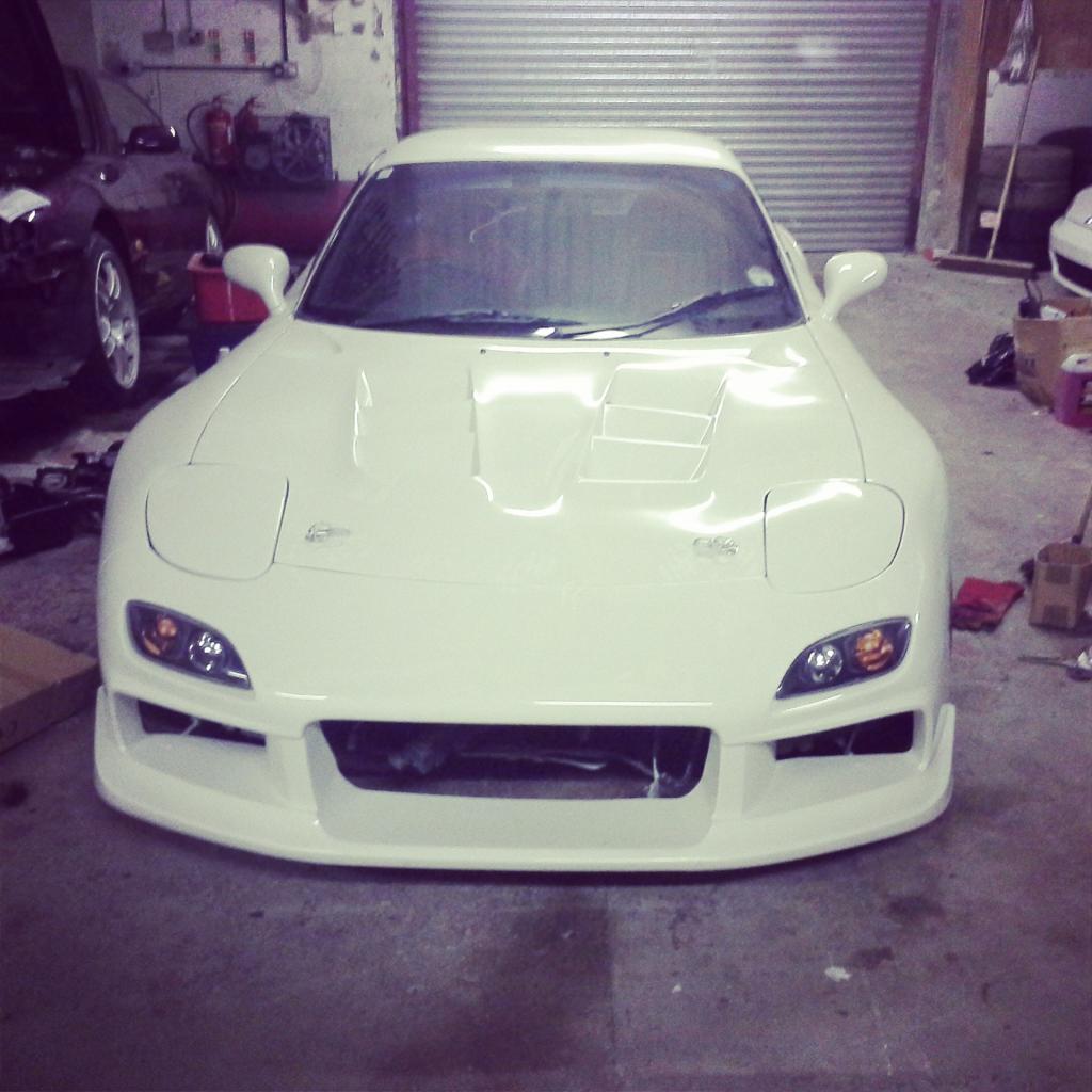

So off same the wheels and so did the front bumper to allow better access to the work on the engine bay:

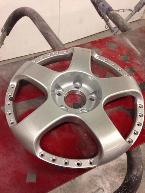

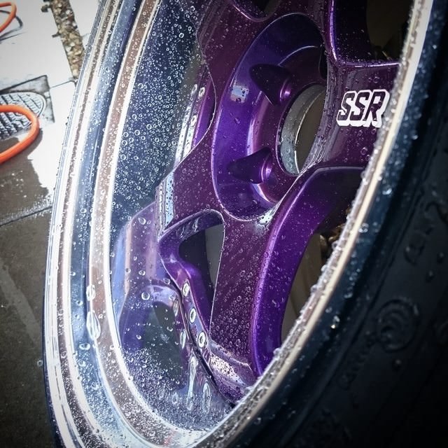

To paint the wheels I went to a friend of mine, Jaz at Endless Road, for any of the Welsh guys or even further afield if you want a proper good job doing on your car this is one of the places I'd recommend, just be prepared for his waiting list...
Here's some pictures of the process:
Obviously not to everyone's tastes but it was the colour I had always intended to do them and I think with a white car you can get away with something a little more garish for the wheels.
I then needed to get them home and with nerves of steel apply the decals using a ruler and chalk to get them spot on, I then gave them a couple of coats each of Carbon Collective Platinum Wheels sealant.

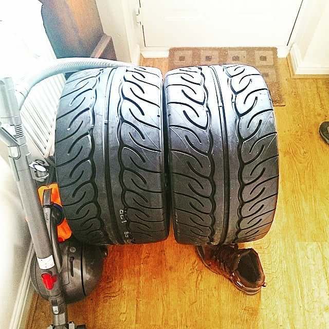

For tyres I opted for Yokohama Advan Neova AD08R, I know tyres are such a personal thing and everybody has an opinion about what the best tyre is but I can honestly say from all the tyres I have tried I have found these to be the best overall.
Size wise I've got 235 fronts and 295 rears, I may look at trying something else when it comes to replacement time because the price for them in these sizes was eye watering and far more than I want to pay in reality.
Tyres on:
That is a normal sized fridge for reference lol
