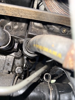

So with it running I needed to run the coolant flush theough - it burped a lot, the pipes are well clogged and I'll replace all the hoses and clips before it gets any sight of an MOT, but all worked out so far - I have heat, I have clean oil, I have revs, and I have starting hot or cold despite a weak small battery.

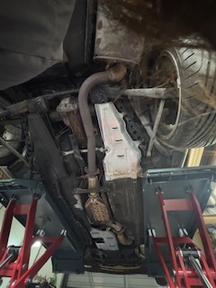

Scissor lift makes all the difference...
Ah, that'll be where the fountain is coming from :/

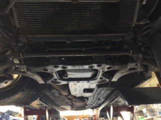

Meanwhile, the twins are waiting their go on the scissor lift. V6 versions of the 3 door C-Class are rare (444 prefacelift, 119 of these facelift ones sold new) - I think I own 2% of all C320 SportCoupes still on the road in the UK 😂
(For performance fans, the rarer C350 version has almost as much power as the special-order AMG C32 SportCoupe, and the 2.5 V6 230 is almost as powerful as the 3.2. But, those models are even rarer and also in the horrible tax bracket).
The one in the background was expensive-ish and sold as a great example, polished to death, but needs a lot of things sorting like stuck sunroof, leaks, etc.
The black one was a no-show sale on eBay locally and I bought it for spares after realising how misrepresented the first one was. Naturally it's turned out to be the better daily driver as it has non-AMG suspension and hadn't been thrown onto the road to sell after years sitting in a barn.

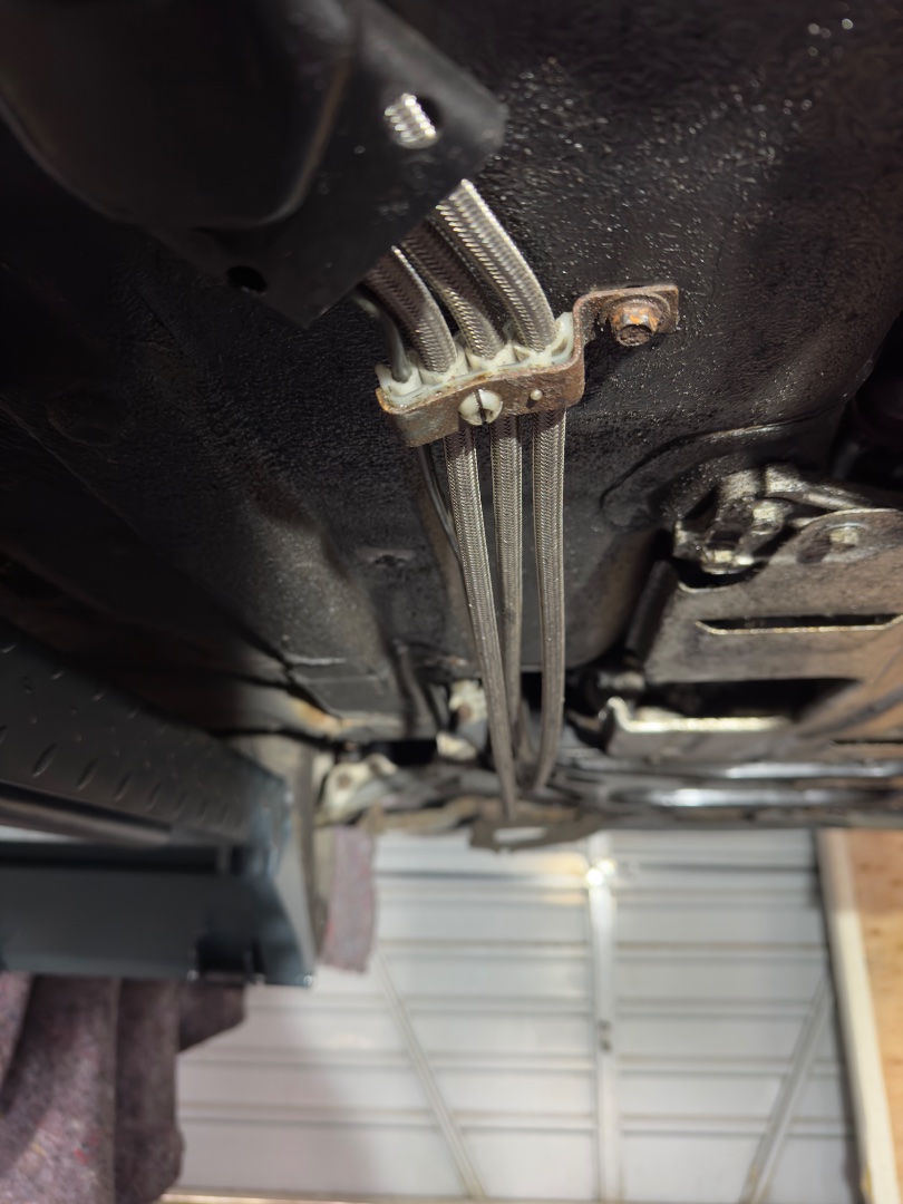

Aha, they arrived!
This is not as easy as the steel ones...
Even reaming the clips, it's pushing it - I wish I had better skill for fabricating new brackets and guides. But they are supported.
Time to try...
Bugger!
Didn't clip a pipe properly up here.

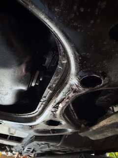

While working underneath I cleaned the oil off the gearbox shield - the car is very oily underneath.

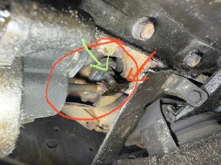

I also spotted an issue...
The E-clip is missing - but I wonder if this, and the perished brake booster vacuum hose, were the cause of the misfires Denny was trying to get fixed.
Good news - it hot starts fine!

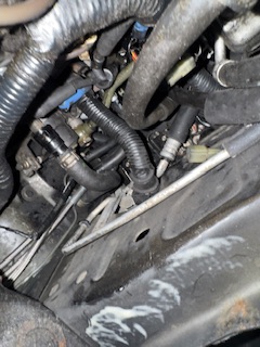

Bad news - that oil came from somewhere, right?
Wiped subframe and it already got a drip. It left a puddle in the garage. I suspect there is a leak when the oil is warm enough for the thermostat to open - also the oil pressure gauge goes worryingly low. I cleaned the connector and it improved, and it rises with revs, so I suspect the sensor is bad but maybe...
The oil cooler pipe looks a bit wet there.
I'll keep cleaning and looking for the source.

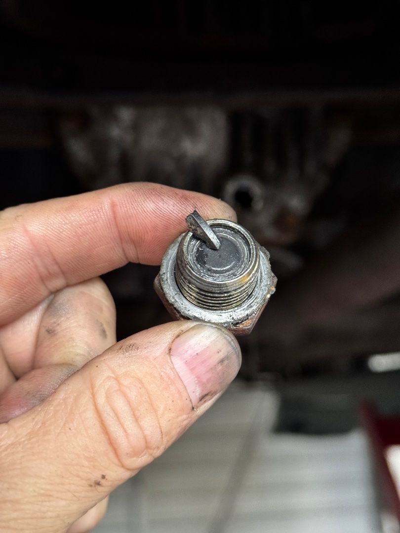

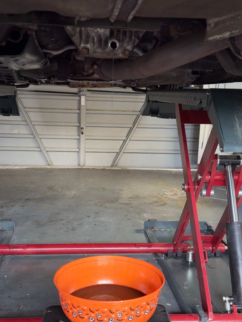

Dentist needed?
It has 75K miles and I've no idea if the diff oil was ever changed but this seems less than ideal.
It needs to be taken for MOT before I plan the big work anyway, but I guess I'll be looking for a diff or bits of one.
That's not a great find in the diff.
Like the quick jacks tho
Yeah, useful kit - I'm wondering how long that bit of diff has been on the drain plug given how it was inside a blob of black neglected oil, and how safe it is to try for the MOT and a few miles with it missing just to see what else the car needs.
Yesterday I moved it and ran up to temp (still with distilled water - I'm flushing it as much as possible) - fans cutting in, the oil pressure gauge still worries me. It showed 55 cold, around 25-30 as it warmed, but also dropped to 0 a couple of times and when I restarted it was at 0. I am 80% confident the sender is duff, but it's still concerning.
But the good news is I did not touch the pressure caps, I just let it cool down and make its crazy bubbling, exciting noises. The AST cap is clearly not secure - you can push it and play it like a kazoo and the yellow sticker bulges up with air passing the rivet, and I am fairly sure it allows water to seep past to the expansion tank even when cold.
When the car was cooled I opened the filler cap and the level was spot on - not dropped massively. I think exercising the cooling system and making sure the expansion tank and AST are behaving as they should has helped - suspect before it was just pushing coolant to the expansion tank from airlocks.
