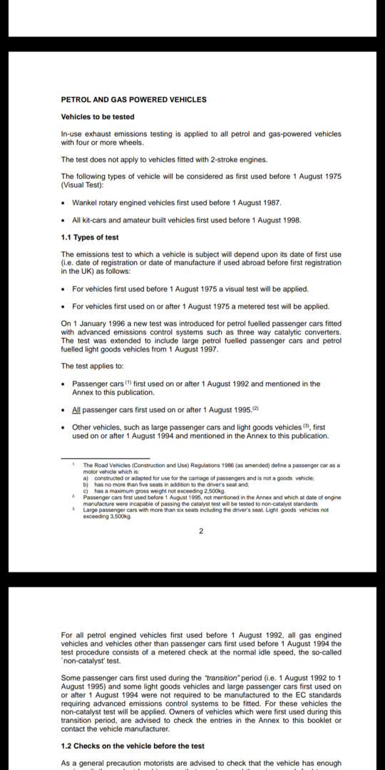

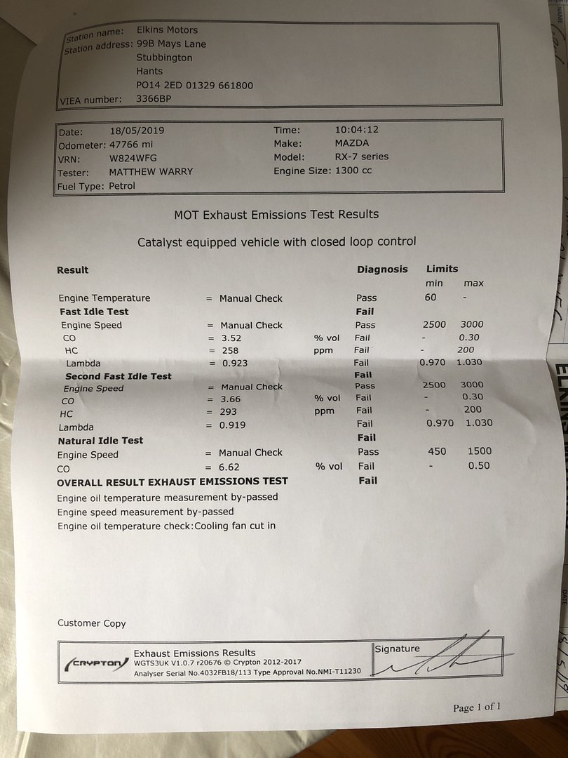

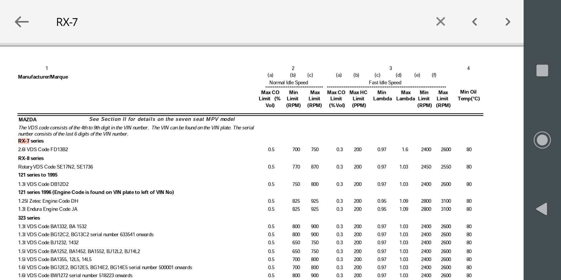

Hi, I could do with help getting my emissions sorted on my car.
It’s just failed the mot due to them and as I have little experience with rotaries atm, thought it best to ask for ideas on what to do to rectify it.
I’ve had a look through old posts regarding emissions, but haven’t done anything yet.
I’m hoping to get it sorted ASAP as if not, I’ll be unable to attend jdm Combe next weekend.
Here’s a picture of the results attached.
Thanks
