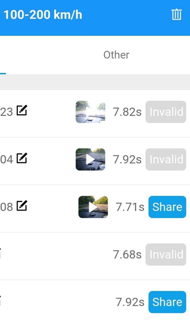

The new low boost setting, sitting around 15–15.5 psi, is consistently delivering 100–200 km/h times in the 7.8-second range when averaging both valid and invalid runs. I’m very happy with that as it’s a solid improvement of around 0.6 seconds over the previous 8.4-second runs.
This is all on pump fuel, with no wmi and in fairly warm conditions. The car feels really well-balanced on the street, especially through the twisties and on corner exits where traction is more limited for street use on colder tyres. I’m tempted to try bumping the boost slightly higher maybe up to 16.5 psi (around 1.15 bar) on pump fuel, just to see how it affects both the acceleration runs and handling through the twisties.

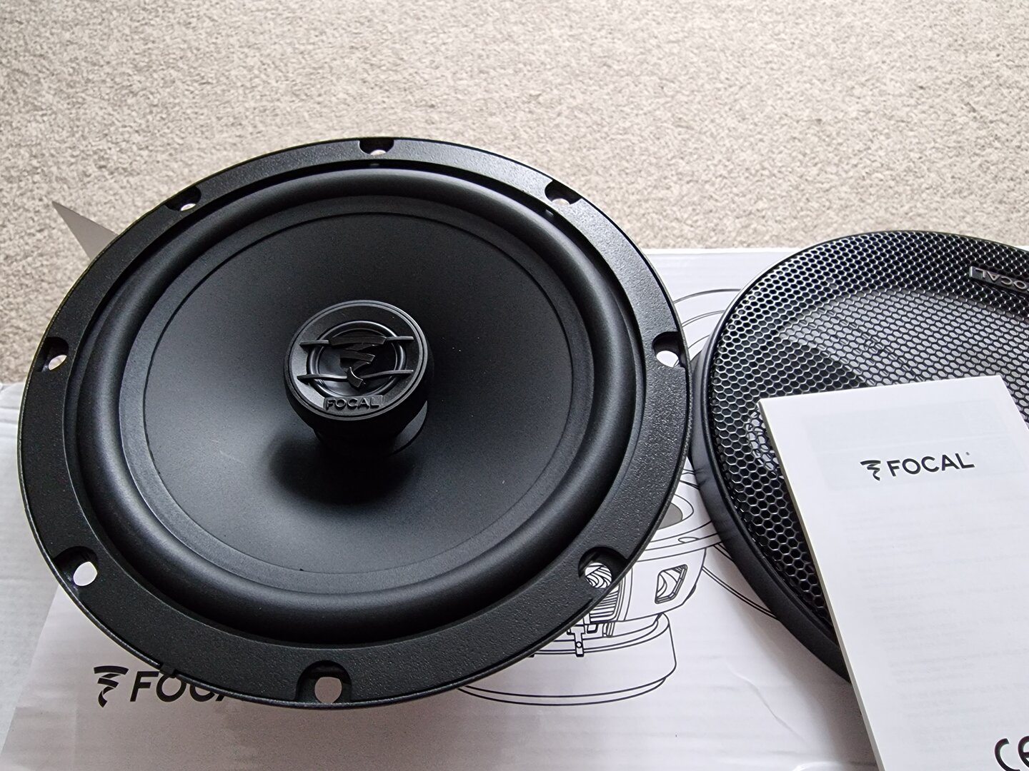

Recently, I was given a new to me but old pioneer headunit with bluetooth audio, hands free calls, and apple music etc etc. My previous headunit also happens to be a pioneer unit but with none of the modern gismos! In a way the headunit really brought the FD into the modern world....making me think why in the world I didnt get bluetooth handfree and ability to stream my apple music through the FD. I took these things for granted in my M3 and never thought I needed such luxuries in the 7, but I was wrong.
One thing led to another and its finally time to improve the performance of the stock audio system in my FD. The goal is better clarity, improved mid-bass, and reduced cabin noise, all while keeping the setup simple, affordable, and clean. That means no subs, no big amps, no additional heavy wiring and no rear speakers. Just aiming to get the best possible sound from the front stage.

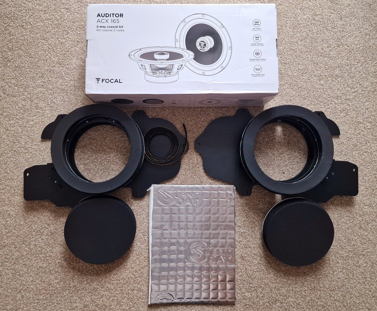

Changes being made:
  1. Front Speakers: Swapping in Focal ACX 165 6.5" coaxials (60W RMS) using new 6.5" adapters and foam rings for better fit and seal.
  2. Amplification: Adding a Pioneer GM-D1004 compact mini amp to power the Focals properly (45W RMS per channel). Plug-and-play using an ISO harness with no cutting. Hopefully will sit behind the head unit.
  3. Head Unit: Keeping the Pioneer DEH-4500BT as it easily integrates with the mini amp and also allows me to tune EQ and high-pass filter for cleaner sound.
  4. Sound Deadening: Its pointless, installing new speakers in a car like the RX7 without treatment of the door cards. So i'll be applying Silent Coat 2mm sheets to outer and inner door skins. On top of that, adding 3mm closed-cell foam (CCF) on the inner skin only, away from the window path and gasket tape around speaker adapter to reduce leaks and resonance.
Most will agree the stock audio setup is weak and distorted at higher volumes, like listening to music via your phone speakers. I hope the Focals will offer a cleaner, more dynamic sound, and the mini amp helps drive them properly without overloading the head unit. Sound deadening should help a lot in my RX-7’s loud and noisy cabin. Everything is non-destructive and easily reversible back to OEM, as if anyone would want to go back to stock 30yr old speakers :ROFLMAO:
Hopefully this will be a night and day difference in sound quality for those long journeys to Spa or Nurburgring. Fingers crossed, its a worthwhile upgrade without a significant weight penalty.

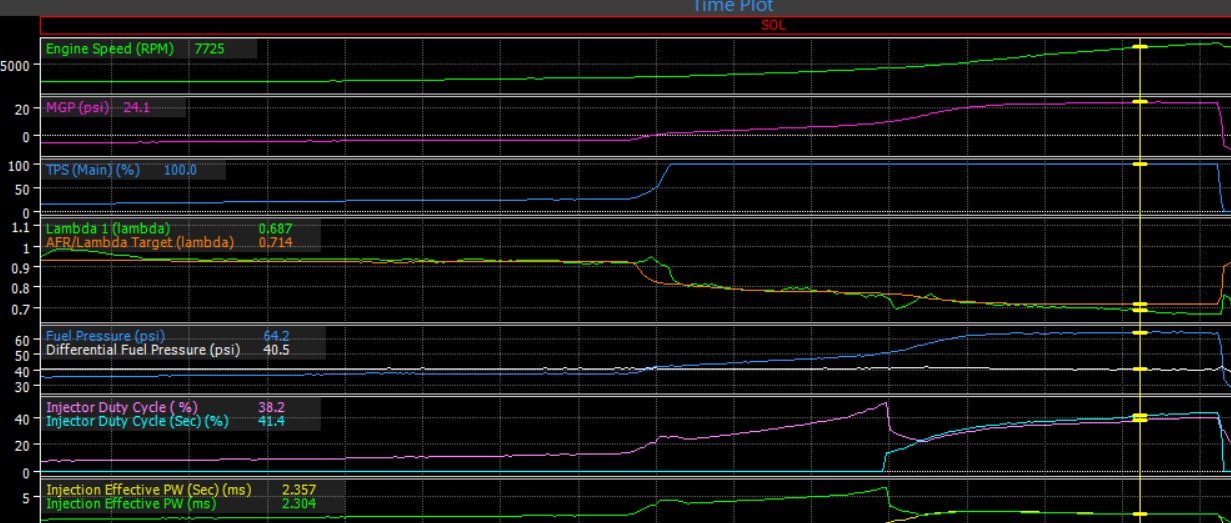

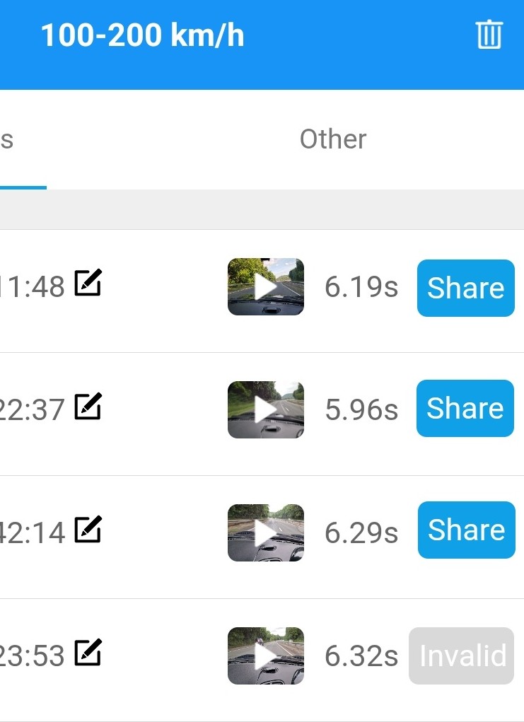

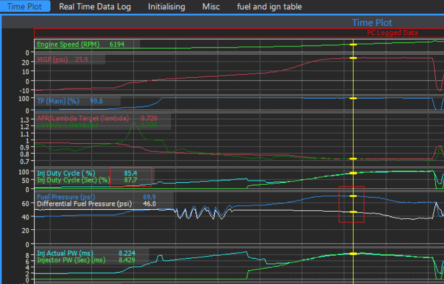

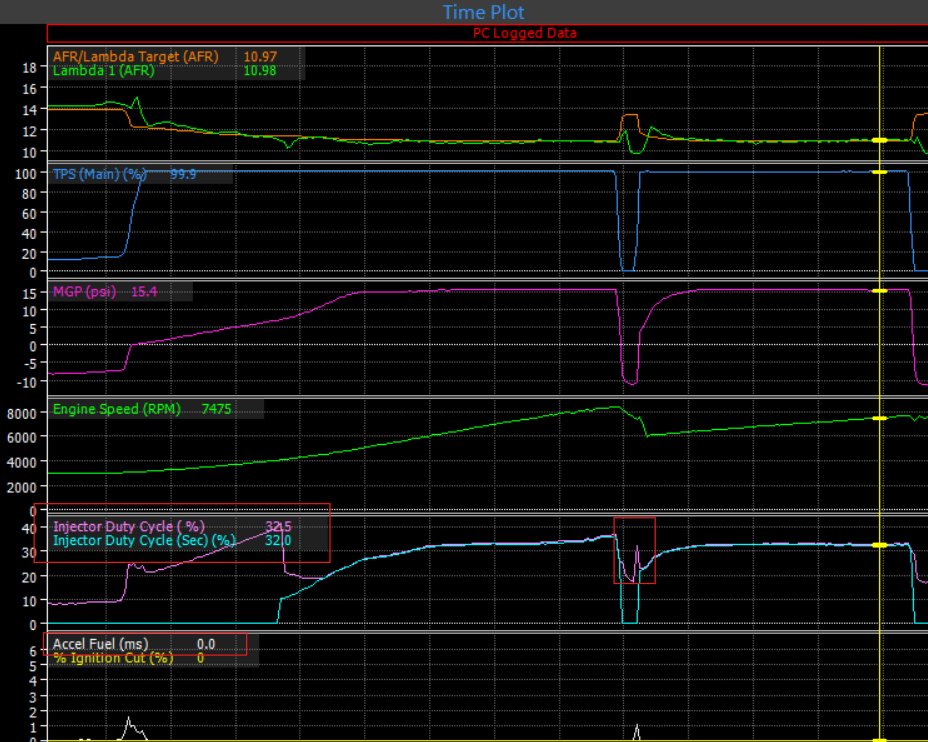

Refining the low boost has led to this point. After 11, 100–200 runs, the new fuel system has proven itself to be consistent, repeatable, and reliable which is exactly what I wanted to put to the test. In my view it has passed and all the negative air about the Bosch 2200cc injectors being rubbish and inconsistent is either internet forum rubbish or poor fuel system setup as I've not experienced any kind of inconsistency with them run after run.
There is enough confidence in the fuel system to start high boost tuning. I did a 24 psi test run to 6k rpm and the skies opened up so I had to call it a day. As expected, the fuel system handled it effortlessly. The injector duty cycle was only around 42%, and fuel pressure stayed rock solid, with none of the pressure drops I experienced with the old setup. I need to work on refining the high boost map but hopefully that wont take too long.

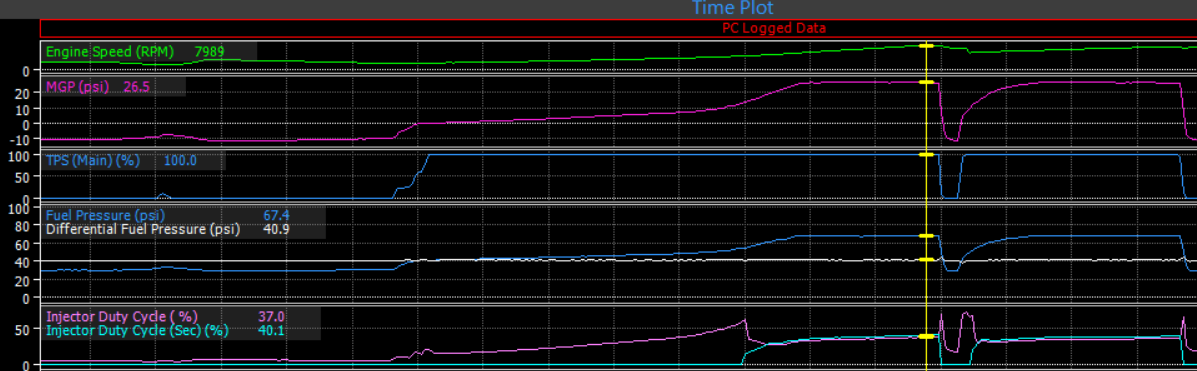

This is the previous run which did the 5.98s 100-200. The new fuel system confirms nearly a 44% reduction in injector duty cycle, and fuel pressure remained completely stable with no drop at all and those funky oscillations are gone too.

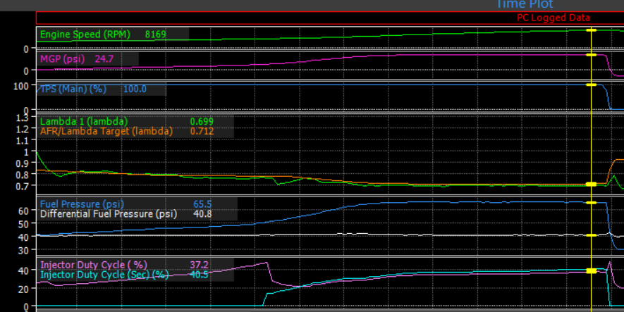

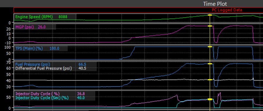

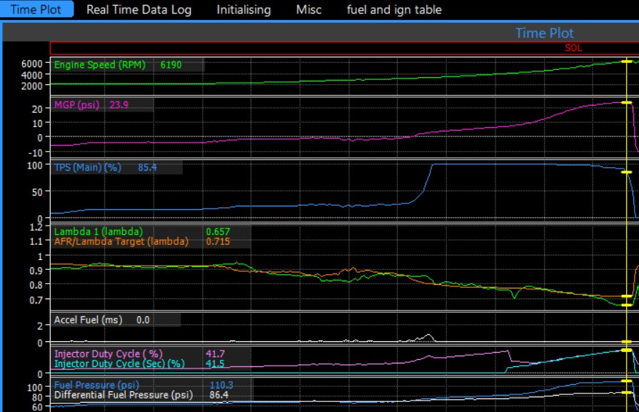

A few updates since the initial 24psi run:
  • Verified base fuel pressure using a manual gauge and confirmed it's set to 40psi differential.
  • Swapped in a new fuel pressure sensor and re-calibrated it to match the manual gauge. Took some time but worth it to reduce error.
  • Retuned the fuel map slightly to suit the new pressure. Injector data remains set for 40psi base.

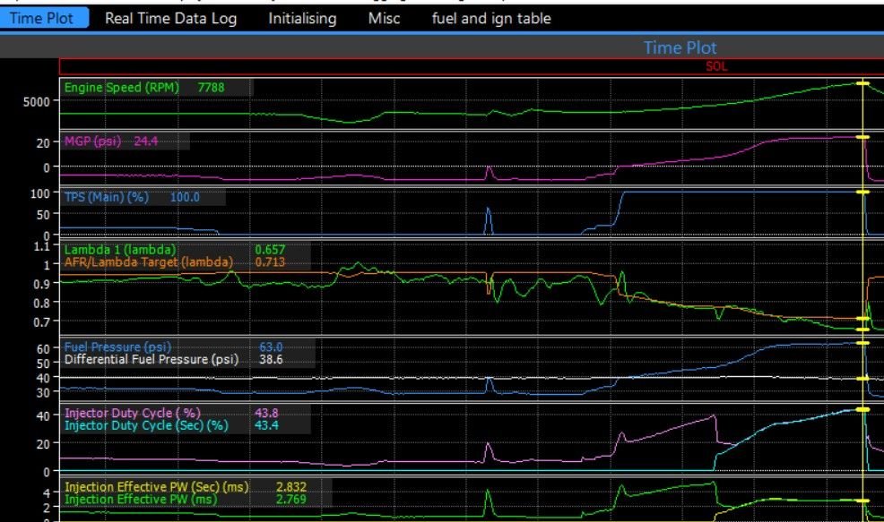

  • Staging is improved but still not perfect asit dips rich briefly as secondaries come in, then stabilizes. It feels smooth on the road, but logs show room for improvement.
Omar pointed out that injector dead times and flow rates in the Link G4X might not be ideal at the staging point. I have to explore the ECU logic further possibly lowering the sec/pri ratio to soften the transition and reduce that initial rich dip. Will see how it goes and may get Adam from Link involved to fine-tune it.

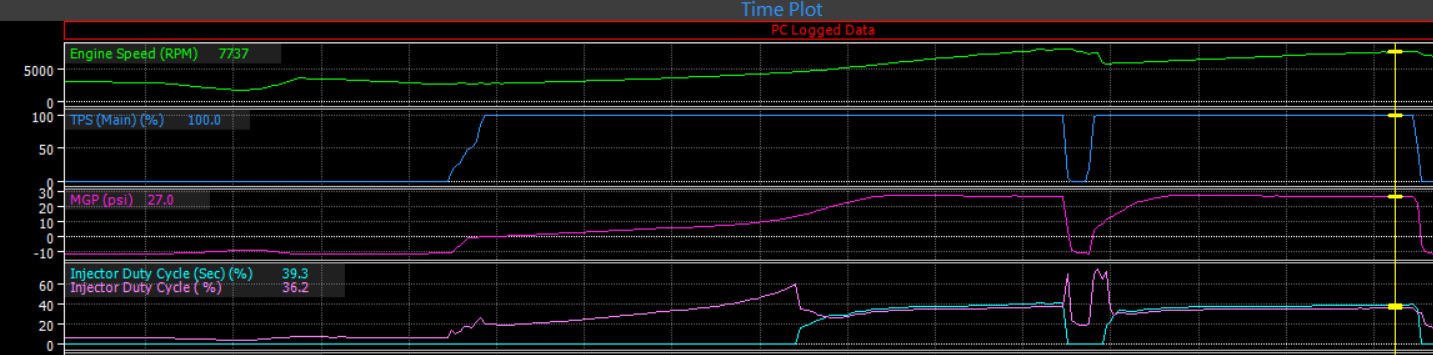

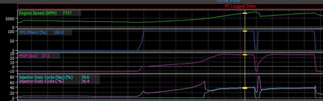

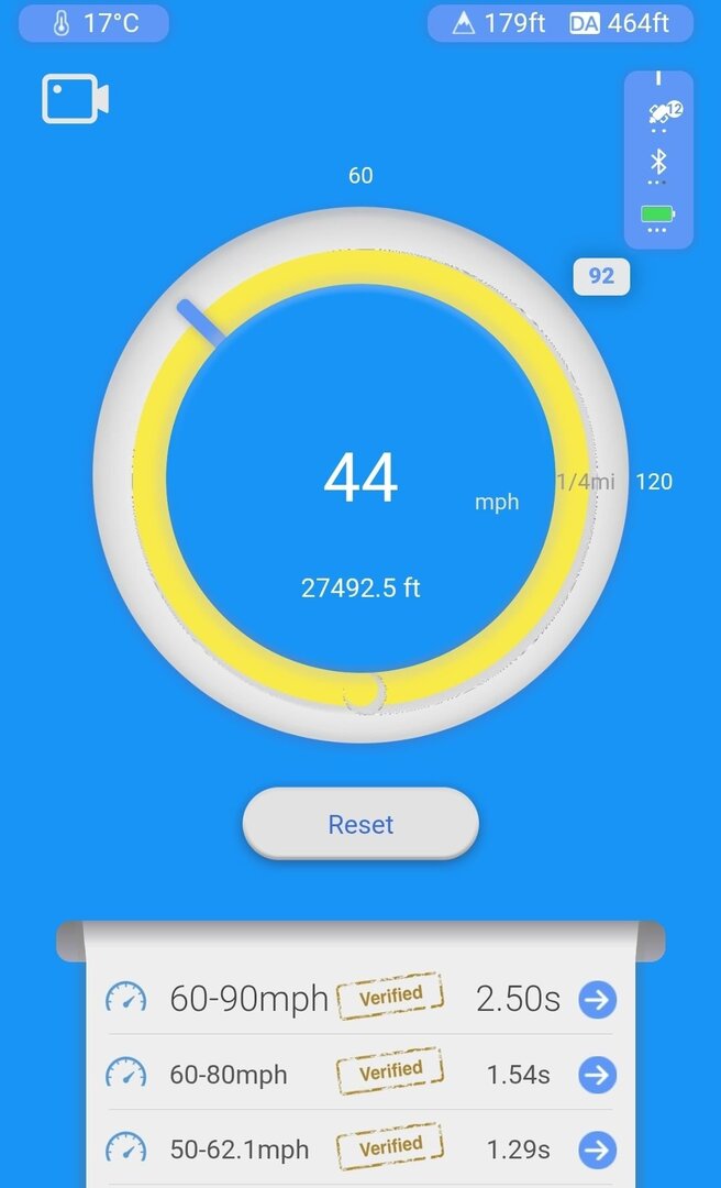

This was a 3rd gear pull up to 7700rpm before I lifted. There’s still a lot of fuel to clean up, but this is how I prefer to tune on the road, starting rich and gradually leaning it out until I consistently hit the target lambda across multiple runs.
I had the trusty Dragy with me for this session, and even with the map still being a bit off, it managed a 60–90 mph time of 2.50 seconds, which was a pleasant surprise.

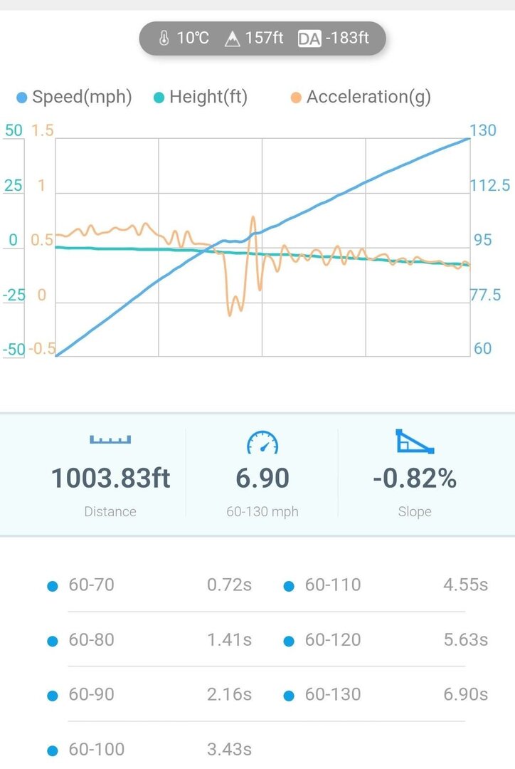

The run where I hit 5.9s for 100–200 km/h and the matching 60–130 mph pass shows a 60–90 mph time of 2.16 seconds. That’s just 0.34 seconds off my previous personal best, which is quite promising, especially considering there’s still a fair amount of fuel to trim and i'm not even close to the optimal tune yet.

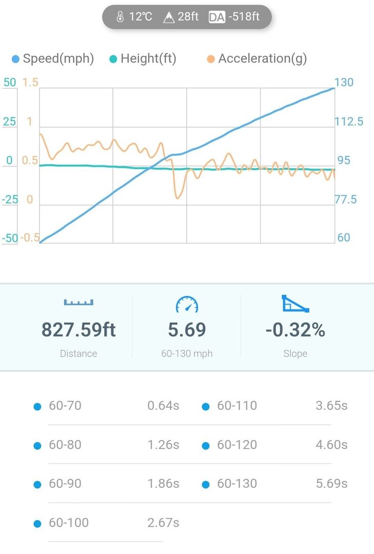

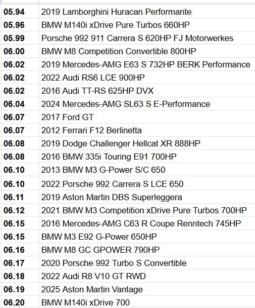

Below is Nath’s time from the leaderboard in his G42-equipped RX-7 running 29psi. He clocked a 60–90mph time of just 1.86 seconds. I’m currently 0.64 seconds off that pace which is a significant gap, and it makes me question whether the smaller G35 on a street port can realistically compete at the same boost level. Either way we will find out soon enough.

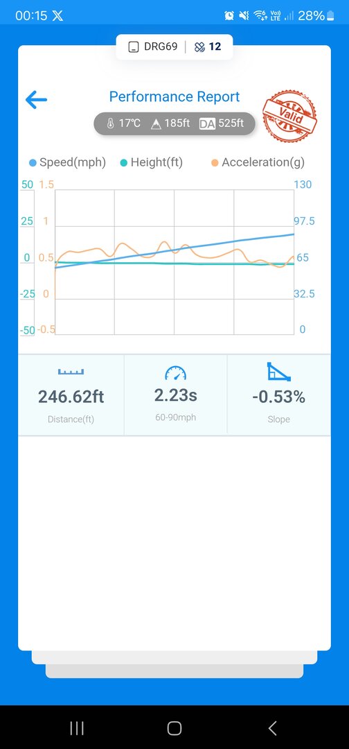

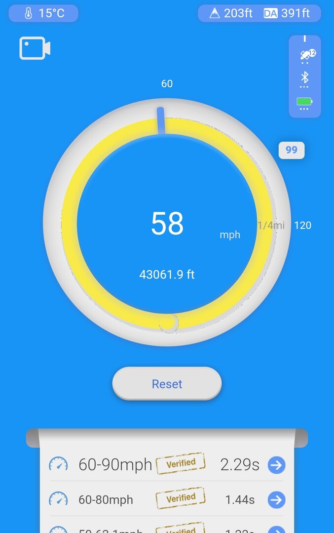

Close but no Cigar! Just 0.13s off my previous 60-90mph pace. Only a matter of time till i get the setting dialled in and run a new PB.

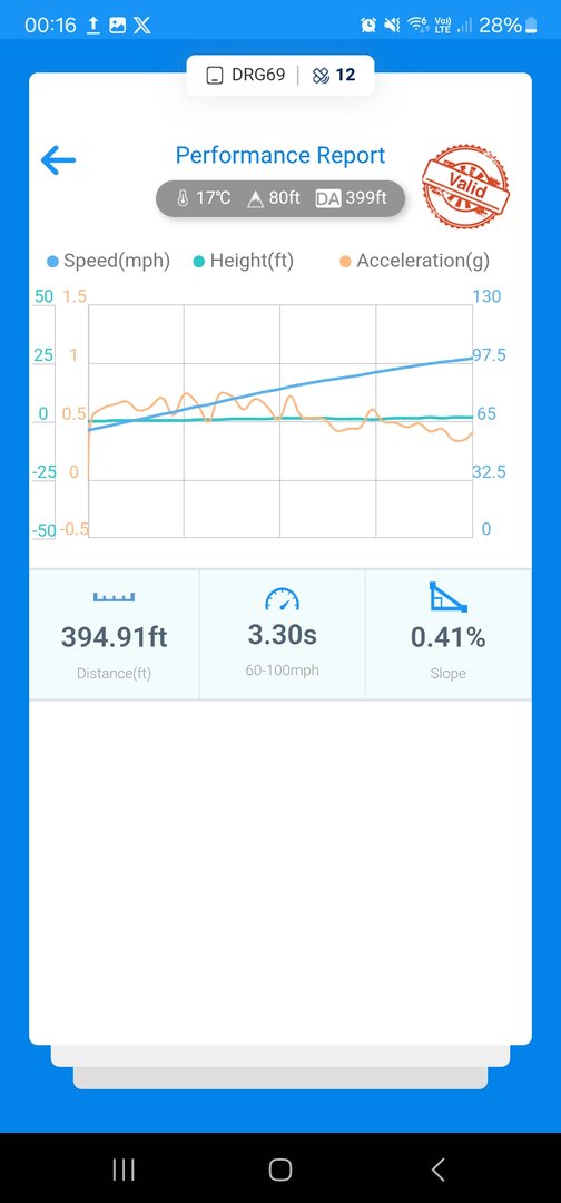

Getting better with acceleration 60-90mph 0.07s off previous pb and 60-100mph around 0.13 quicker than previous PB already. So some progress is being made.
I need to continue working on the transient fueling and accel fuel between the 3rd to 4th gear shift at 24pi to increase acceleration because dragy is a cruel mistress. I've done around 10 60-90/100 mph pulls and things are looking good to continue up to 29psi.

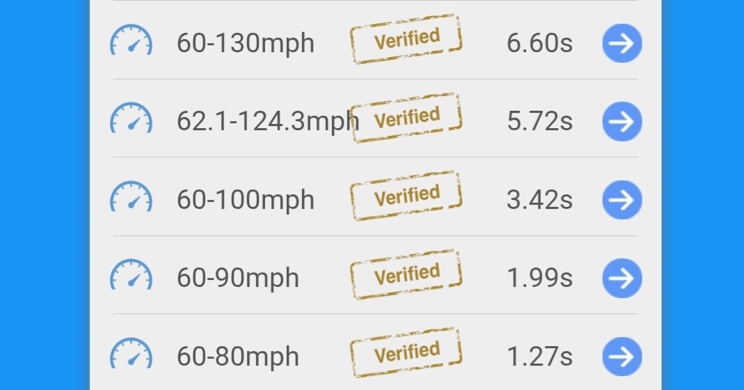

All performance metrics hit a new PB today. For the first time ever, my 60–90 mph time dropped below 2 seconds showcasing strong performance during a third gear pull.
The current limitation is the stock box, which is costing approximately 0.45 seconds during a manual shift. This includes time lost off boost as the turbo goes into vacuum and has to spool up again. A DCT or dog box would eliminate that downtime, keeping the turbo spooled and likely shaving off at least another 0.3 seconds, possibly more. That said, the stock gearbox is impressively holding up to some serious abuse!
