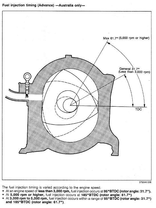

In my testing going by oem Mazda data 90 degrees is a good start for crank and idle below 5krpm! Play around till you find the richest AFR and don't be scared of using the full 0-330 timing for idle and cruise conditions. Only 1 or 2 settings will get you into the richest afr window. You should be looking for less fumes, less inj duty cycle as you're now in the optimal injection window (less fuel wastage), crisper throttle response with smoother idle and cruise conditions.

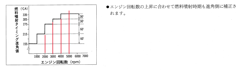

where did you get this picture from? I got this one from the jdm FD manual.
it starts at 155 and goes to 335 above 4000rpm.

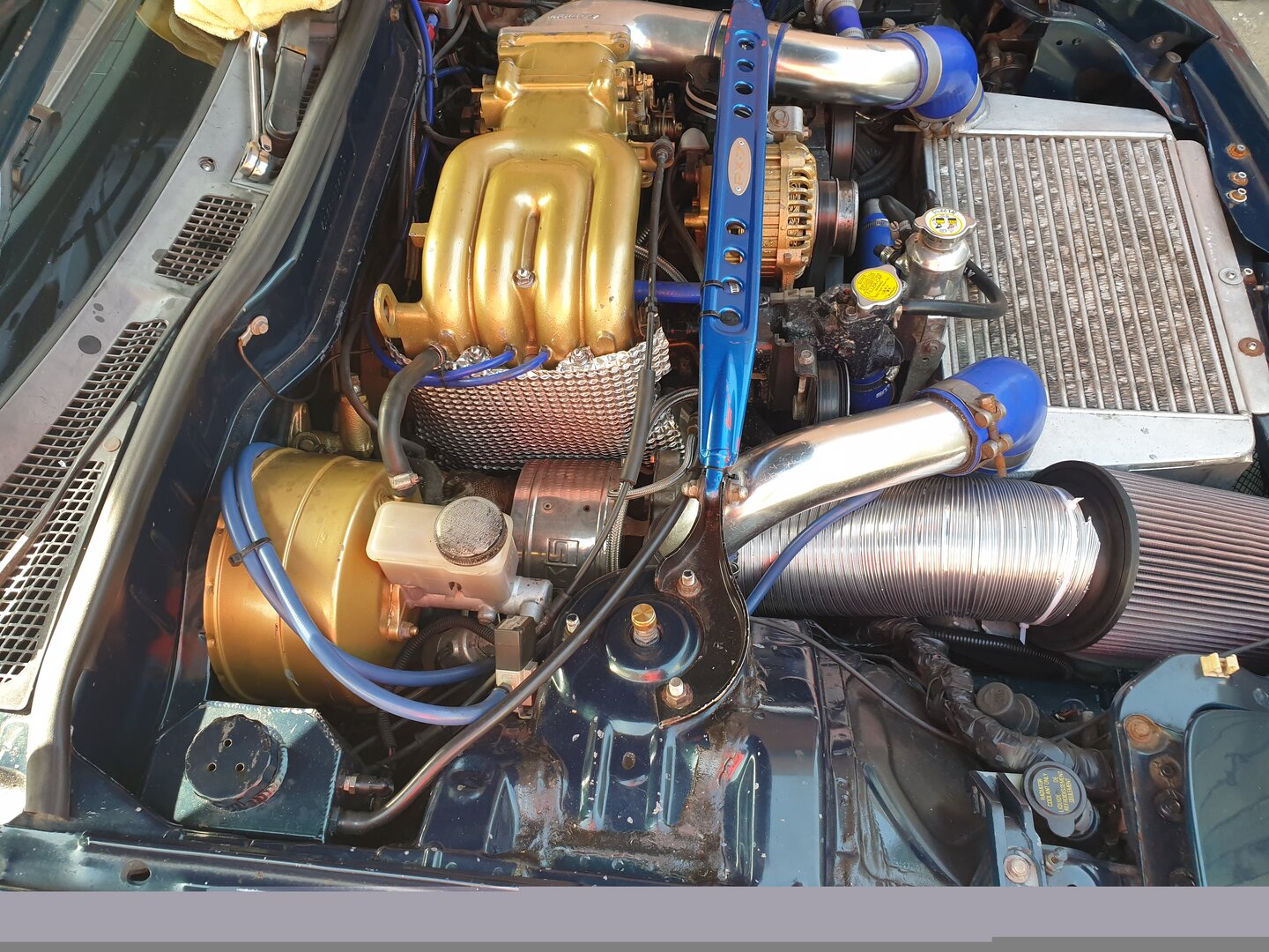

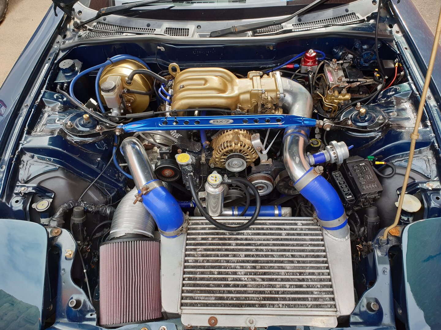

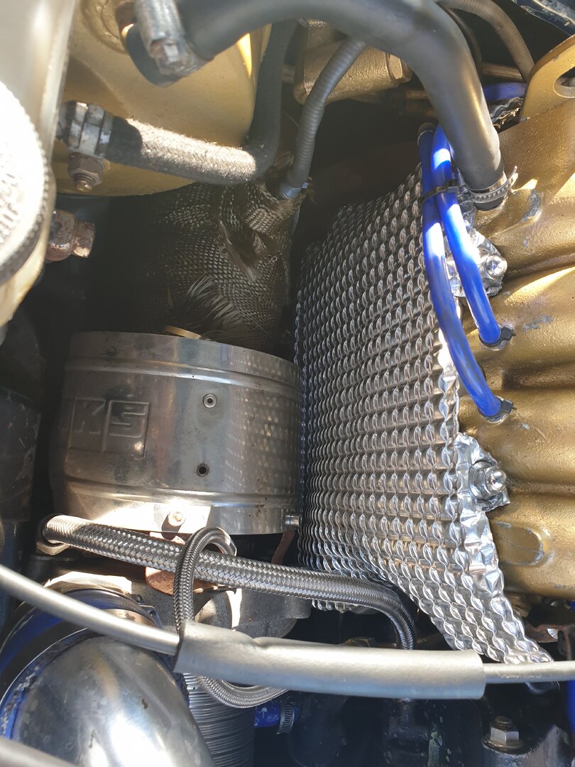

I've just installed the Excessive lower intake manifold, refreshed the primary and secondary injectors, added a new 100-amp relay for the direct fire ignition system, and improved the heat management in my car for the LIM.
Previously, I only had the HKS heat shield for this setup. I haven't gone crazy with the heat management mods costing ££££s, very simple and exceptionally frugal mods DEI's Titanium exhaust wrap for the down pipe and a Nimbus G2 dual layer aluminium heat shield for the LIM.
It's finally all back together after a short break and now it's time to put it to the test. Let's see what this can do!

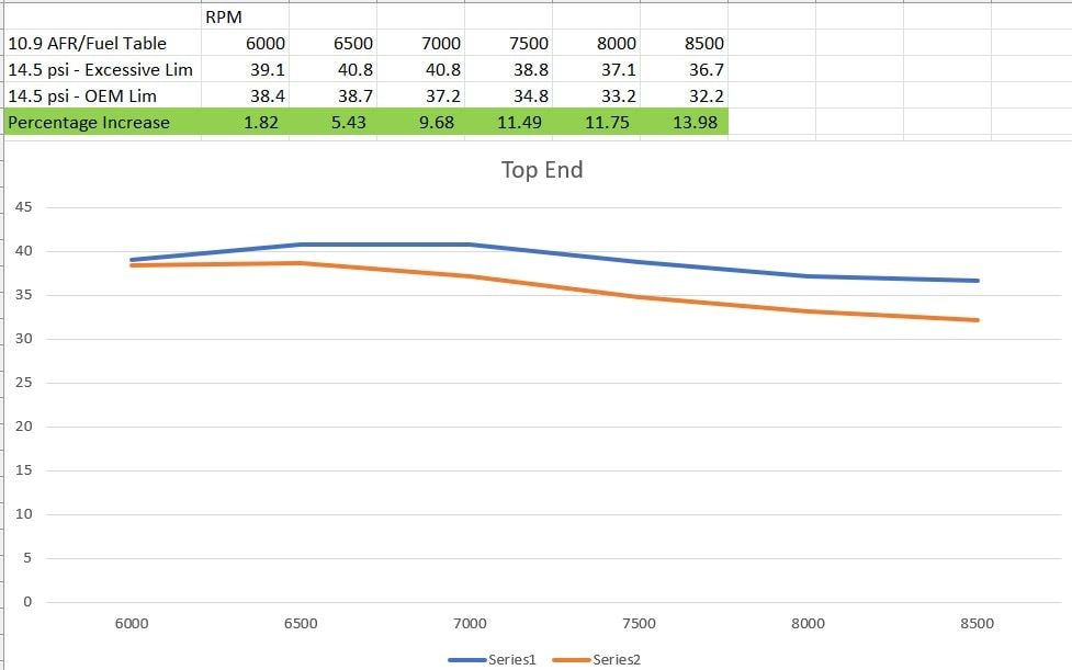

Yesterday, I took advantage of the good weather and started tuning at 14.5 psi. I compared the data to my previous runs at the same boost pressure, and found that the biggest improvements came at 6,000 rpm and above. Below that rpm, there was no noticeable difference.
The below numbers represent an increase in fuel delivery at higher rpms. All things within the map are exactly the same as before no change to the setup, the engine is now requiring more fuel top end.
One factor which comes to mind is, more flow = more air = more fuel requirement = hopefully more power or in my case i think it's holding onto the power much better than it did before.
For all the Data Nerds out there...see below
I need to do some dragy gps testing from 100-200 to confirm if it's objectively faster top end (or not). The fuel table numbers suggest it's holding onto power better than it did before!

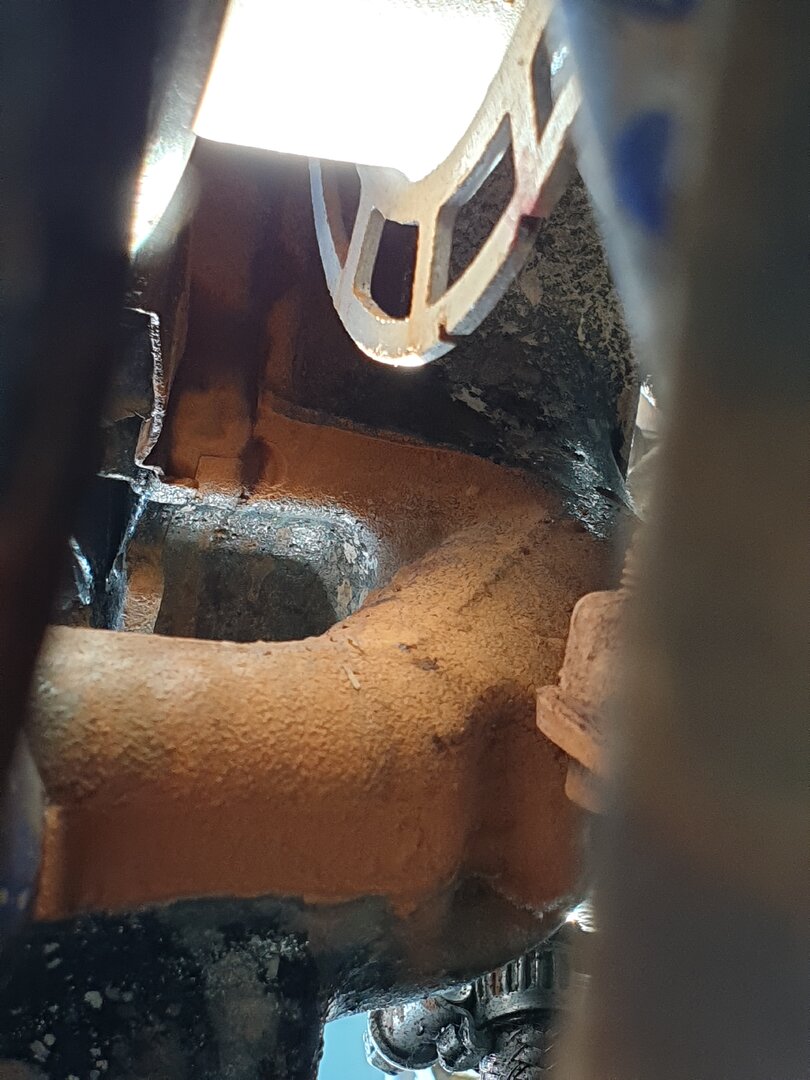

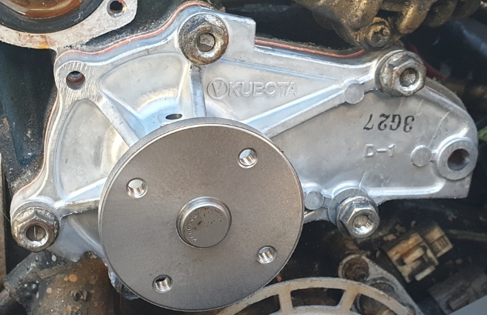

While performing a full systems check before increasing the boost to 25psi this weekend, I observed a recurring loss of coolant after each run. This raised concerns, and I'm seeking to understand the potential reasons behind this coolant loss.
The obvious one was did I kill the motor? or are the 250+ 100-200kph draggy runs catching up with me? Perhaps...so lets investigate further!

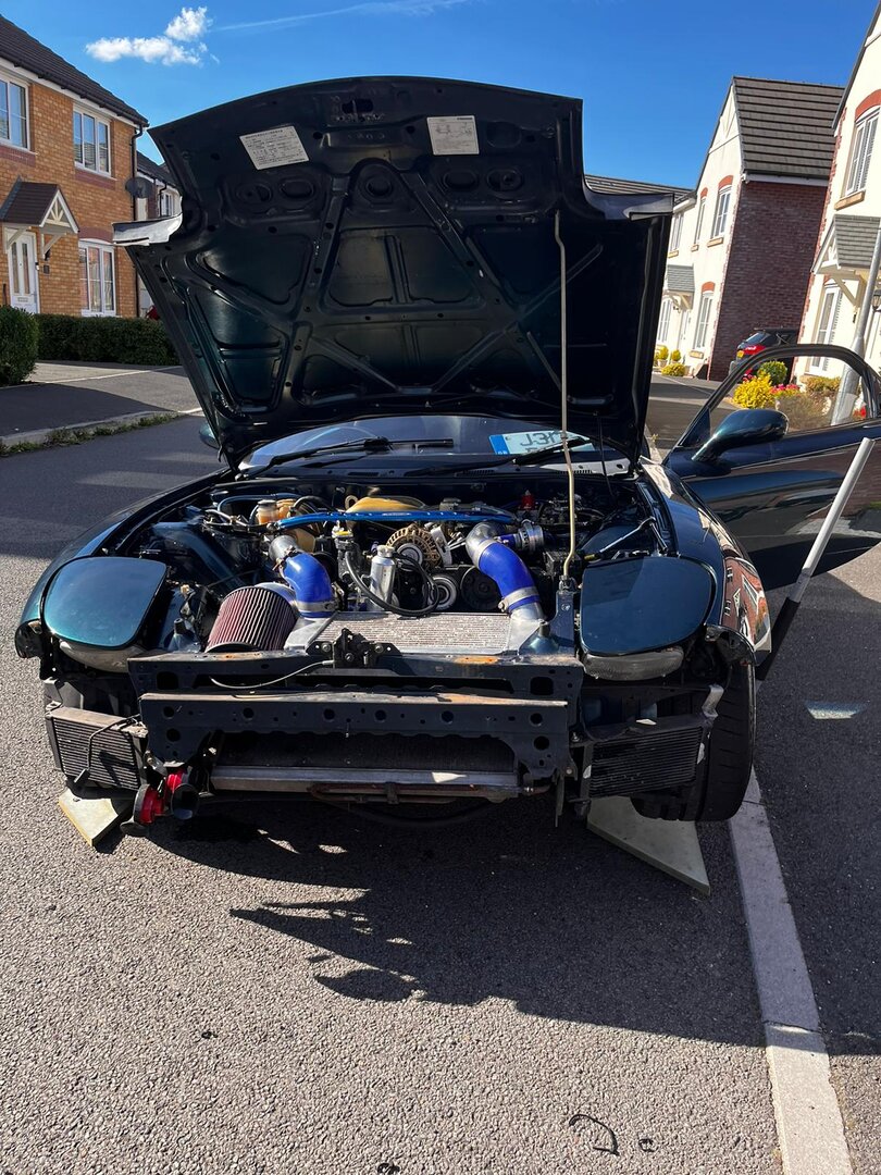

Took the front bumper off to have a good scan of the entire cooling system and make it easier to check for leaks.
Scooted beneath the car, and the mystery was swiftly solved. The water pump is showing its true colors, leaking from its regular spot and trickling out of the tiny orifice at the base of the shaft. Looks like it's waving goodbye!
Luck was on my side this time as I combed through the data. Caught a break by spotting this early – a mere 50-60ml slipping away after each boosted run. The attention to detail has its rewards, as this could have been a catastrophic failure at 25 psi. Remember, every detail counts when you're in the realm of these machines, folks! 🚀🔧🔍!!
Summing up and aiming to capture these lessons for our shared knowledge...
I completed 10+ draggy runs at 15psi, establishing a baseline with the new excessive manifold and perfecting the tune. A pre-run ritual I always complete before starting the fd is checking two vital factors—oil level and coolant level.
In the span of 250+ runs I've logged, minimal oil or coolant loss raised no alarms. However, in this specific series, a disconcerting 50-60ml loss per run was noted.
Acting on it, I kept an eagle eye for white smoke during idle, cruise, and acceleration in the subsequent start-ups. Luckily, no smoke materialized, eliminating water seal concerns. Nevertheless, a coolant leak remained to be tackled.
Bumper off, an inspection beneath revealed the smoking gun: the water pump was the troublemaker, luckily no detective work required.
Always be vigilant around these machines, Gentlemen!
Like you say, attention to detail looks like it's saved you here. Are you not tempted to replace the stock pump with adapters and an EWP set up?
Definitely considered it but seeing as my hp targets are rather conservative at 500rwhp or 600fwhp. The stock pump will do for me. Its been reliable until now and so I've stuck with genuine oem stuff.
If i was aiming for 800+hp revving to 12k+ rpm....that would be another story.
Keeping it authentic with a Genuine Mazda RX7 FD3S water pump replacement. Turning up the rotary love as the old one did an admiral job for nearly 30 years! Confirmed the seals failed on the old one...well they were starting to fail.

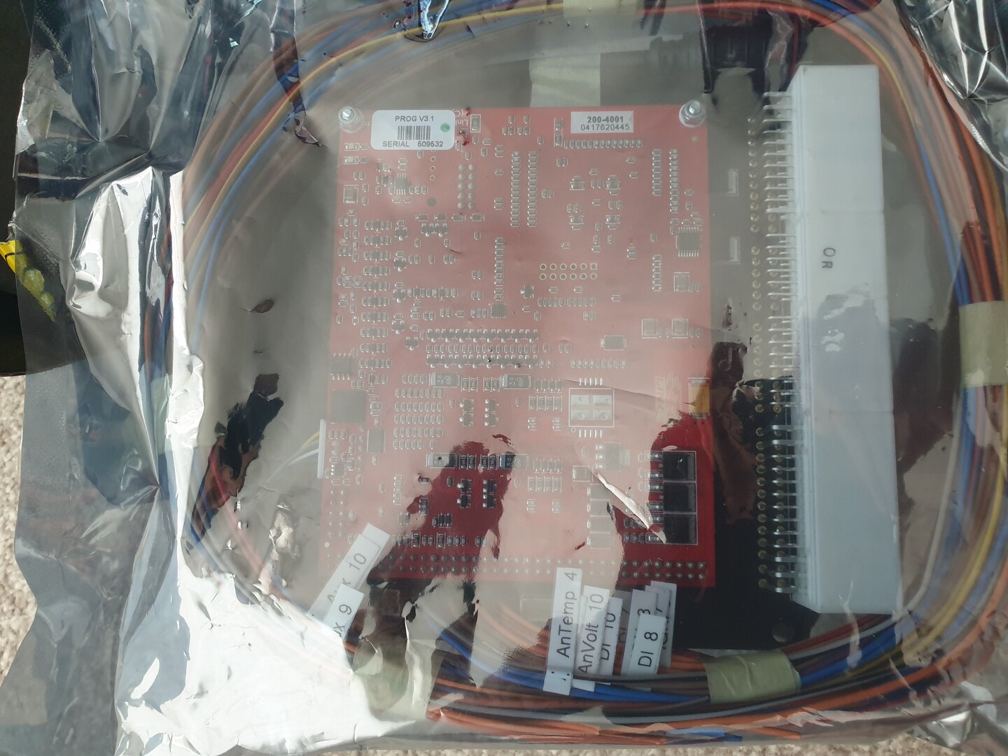

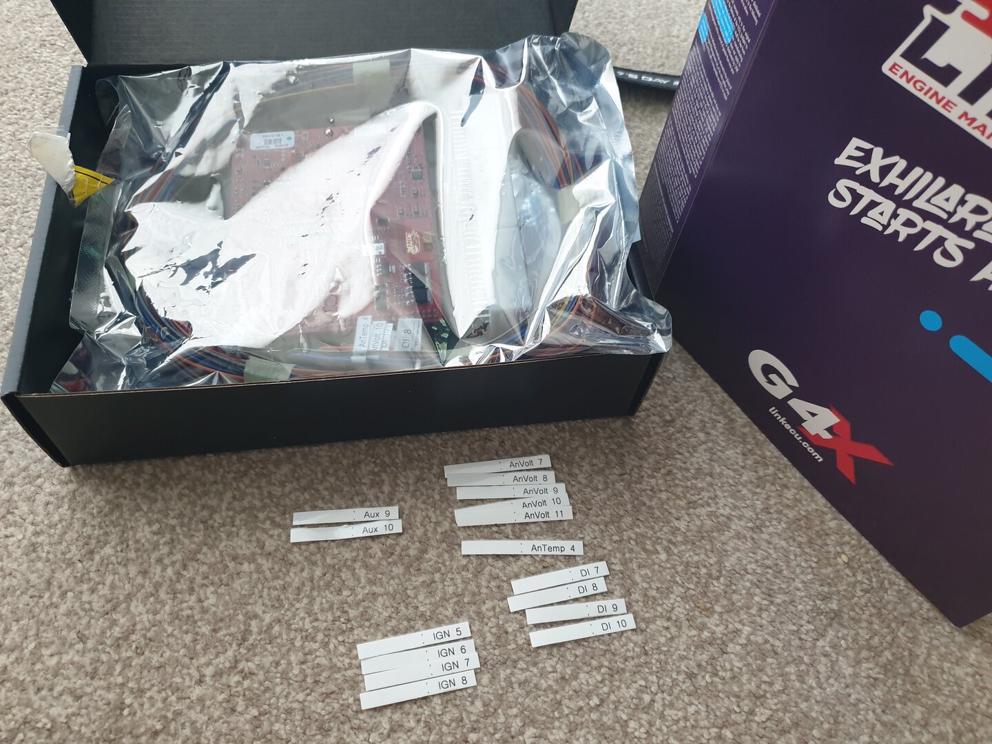

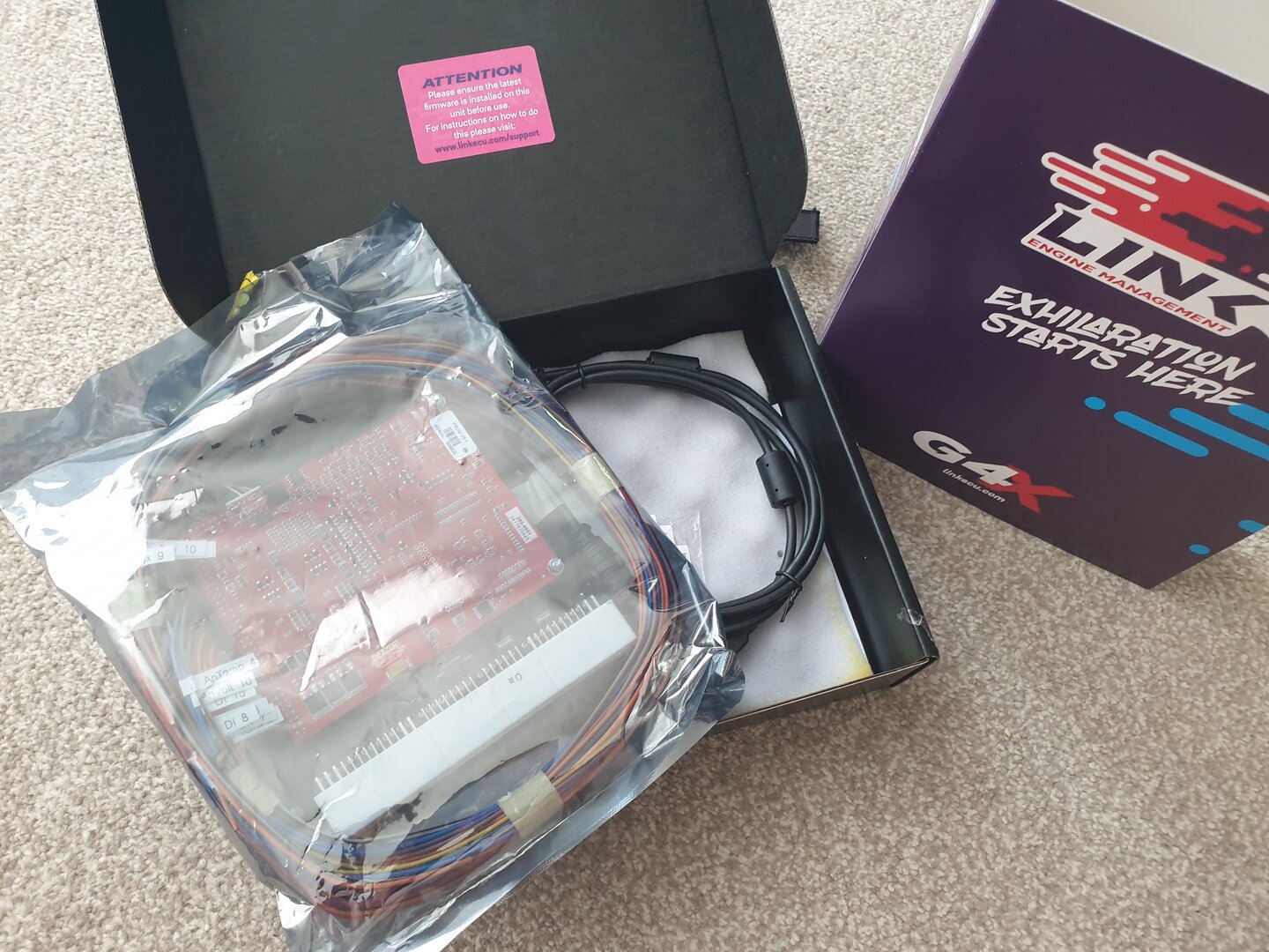

Spur-of-the-moment decision during the RX7 downtime! Had a catch up with Stu from Rotortorque, and upgraded to the Link G4X ECU! Time to unleash all the power the mighty G35 1050 can offer! 19 new inputs (over my previous G4+ which is still an epic modern ecu), lightning-fast performance, and a whole new level of control.
Time for a fresh tune-up! With the new Link G4X ECU in place.
Can have it all now, not just the safety but able to run all the additional sensors
