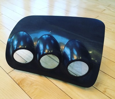

I agree with you about the triple pod from drakes liking a bit odd. I've got the double one to go in which is a much nicer shape and blends to the space better.
The following could be an option?
I do like that but never been a fan of the glovebox mount, feels too far away to me...
Your double one, is that 60mm?
I’d consider a drakes twin pod and a steering wheel column gauge pod, like the RE-A ones but get a drakes one knocked up for the 60mm gauge.
Theee gauges on the dash is to bulky I think and hard to find a nice pod like you’re looking for.
Just an idea 🤷🏻‍♂️
Just an idea 🤷🏻‍♂️
Not a bad shout that dude, nice one, didn't realise he did double 60mm gauges and they look smart / well of the way, that and an a-pillar may be...

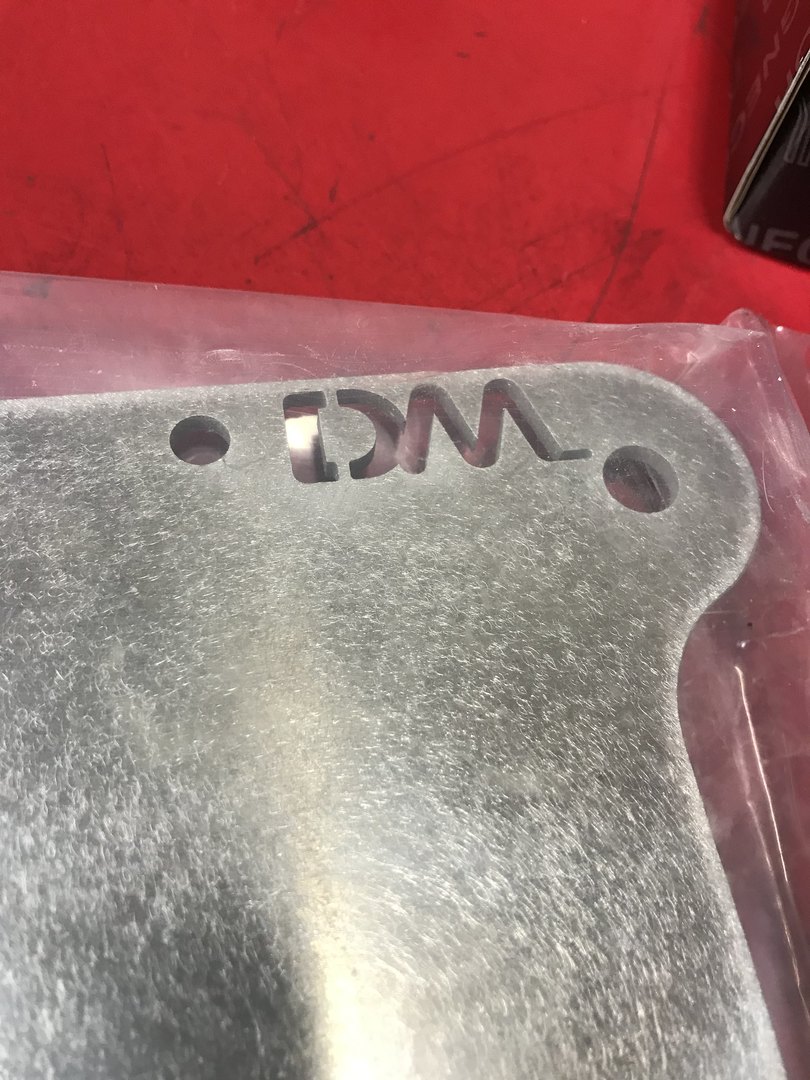

So first up, the DM Motorsport AEM Coil Kit, looked at a couple of the kits from the states, but this one was U.K. based, and had decent community reviews, so figured it was worth going for and being plug and play it should slide straight in along with the CNC mounts etc and be a neat solution.

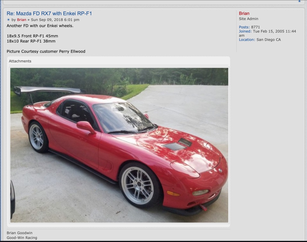

Front - 18x9.5 ET45
Rear - 18x10 ET38
So first up, this guy - sporting the wheel specs above, not sure on the tyre sizes though...
Secondly, this guy: why people post the wheel size and not the tyre size is beyond me, as that's bit that actually touches the ground, but hey, another vote 9.5/10
Third up, a name and a tyre size: GoodFellaFD3S
Lots of decent pics of the fitment on this one, was loving this guy:
Fronts: 255/35
Rears: 265
Fitment looks bang on, but still some more room I think, despite the Jersey ride height, enter this legend: David ArubaDave Govaard
Fronts: 265/35
Rears: 285/35
Or... Rear 295's like this utter ledge

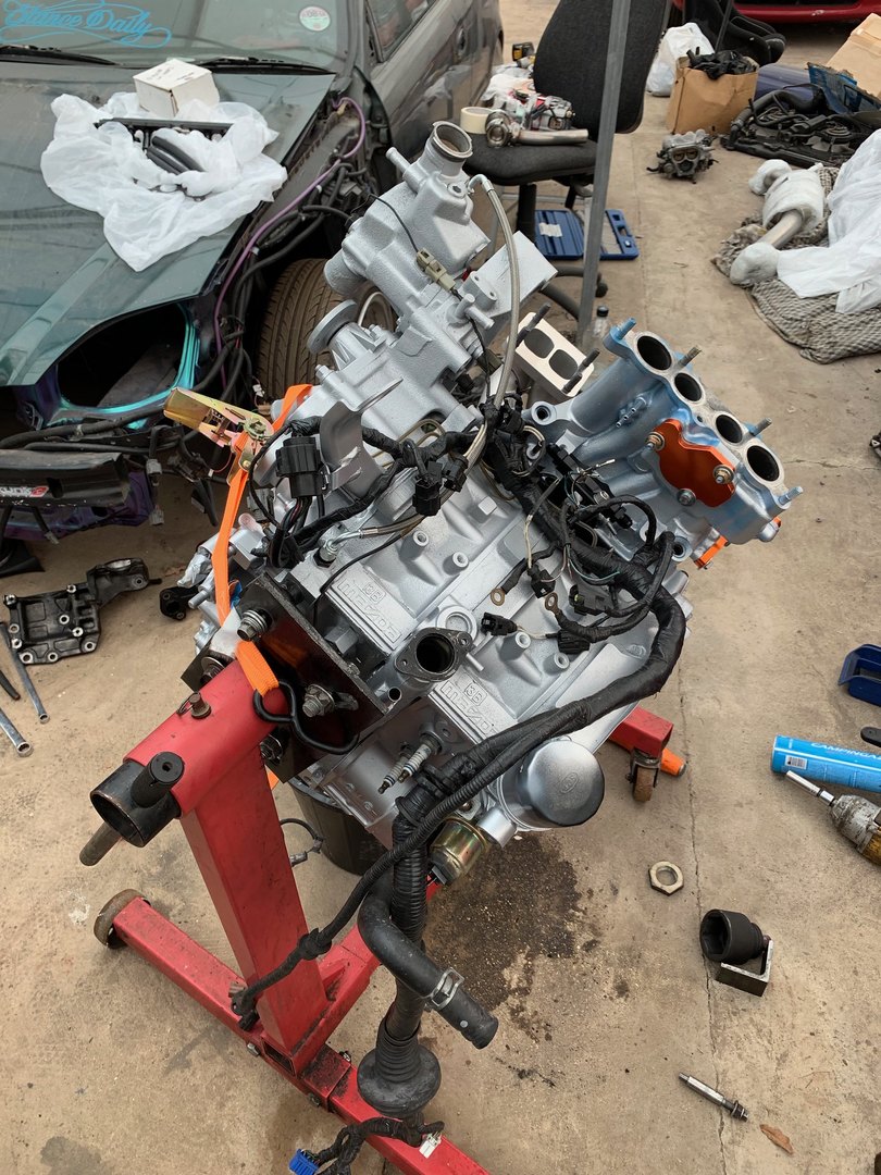

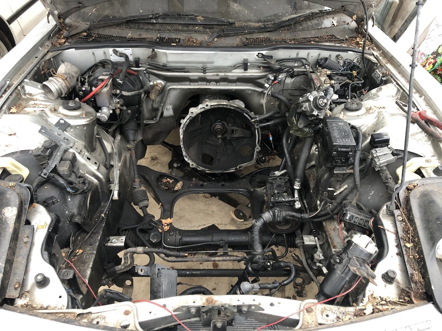

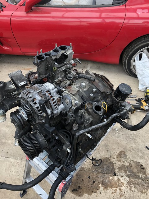

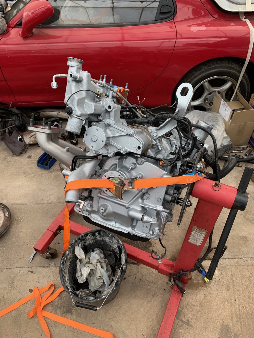

Happy Bank Holiday weekend to you all, little more progress...

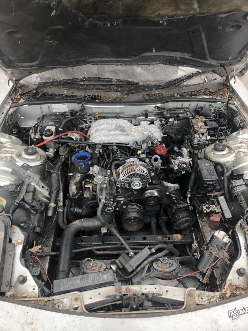

First of all, let's just just appreciate the stock-ness of it all :love: ... But it's all going to make way for something a little more awesome
Few bits off...
Yoink, she's outta there...
All in good shape, but a little crusty around the edges, so taking the opportunity now for a little clean up and give the block and bay a bit of love, because once it's back in I won't want to take it back out again.
So there she sits... It's soo small! Too funny, especially considering I've had the 4G63 out of the Evo earlier in the week, small but perfectly formed as they say
And one very bare bay, I don't think I'll be going super mental with it, it won't be full on show quality, but enough to make me feel proud and not embarrassed to open the bonnet ever.

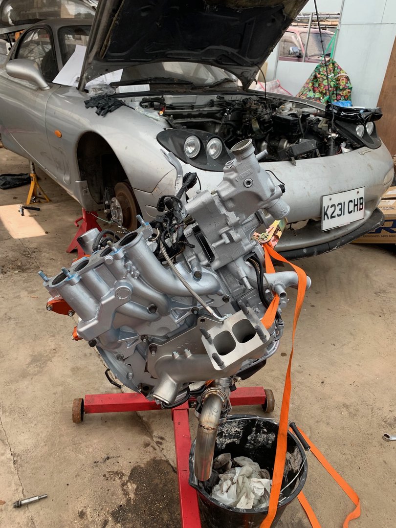

So here she is, back and post spruce up, nothing too in depth, just some scrubbing and spray paint. Also test fitted the manifold - first time really seeing it properly, J'adore.
Wiring is nearly there, just some bits to take off to accommodate the single turbo-ness.
Few more angles...

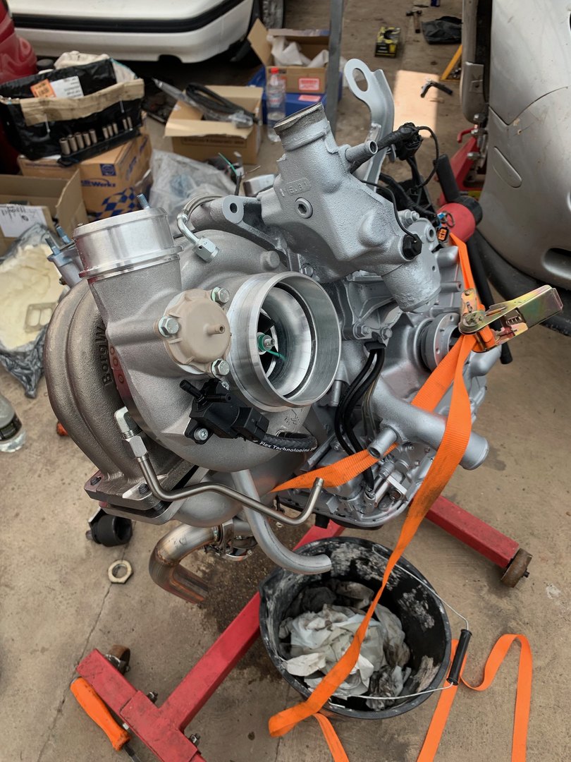

And with the turbo on :love:
So sitting pretty, really happy but have a couple of issues to figure out - It's all part of the process, but still annoying...
First up the very expensive CJ Motorsport kit doesn't like my injectors, the primary rail and injectors went on fine, but the secondary rail spacers are too tall, not by a lot, but by enough. I can't be doing with order more bits from America, so going to lathe down the spacers and run a snugger fit instead. Hopefully that should sort it once and for all.
Secondly the clutch, OS Giken STR-2C, isn's supplied with a counter weight, so I'm having to re-use the standard one, I'm assuming this is okay?
Third up: the water/meth kit tank doesn't fit nicely against the back of the seats like I'd planned, it sticks up beyond the seats (it's too high) debating what to do and potentially use the water bottle for the moment, until I may be buy a SakeBomb version? Although the water bottle in the back is tiny... So a bit unsure, but the UIM needs to be drilled and tapped first, so that'll be last on the list.
And lastly, the dump tubes seem a little odd in the orientation, I was trying to make them match up to Rob's style that I saw in his thread, but I'm not sure if it was the the heat, but couldn't get them to sit like this...

Yeah I ground mine to get the angeI i wanted. It's a bit of a fuck on to get them right to be fair.
When I removed my engine a few weeks ago i left the gates exactly how they were on the car to save the pisstake of doing it again. You want the gates to be sat like this. The dump with the bend at the front of the engine. Then once they are down mark with a pen and cut. I just rammed microfiber up the dump tubes and just got under the car with grinder. Also you wont be able to fit the engine with the dump tubes on the gates due to steering rack. Good look and try not to swear to much lol its tight and extremely awkward lol.
Man do they sound awesome at full chat lol.
