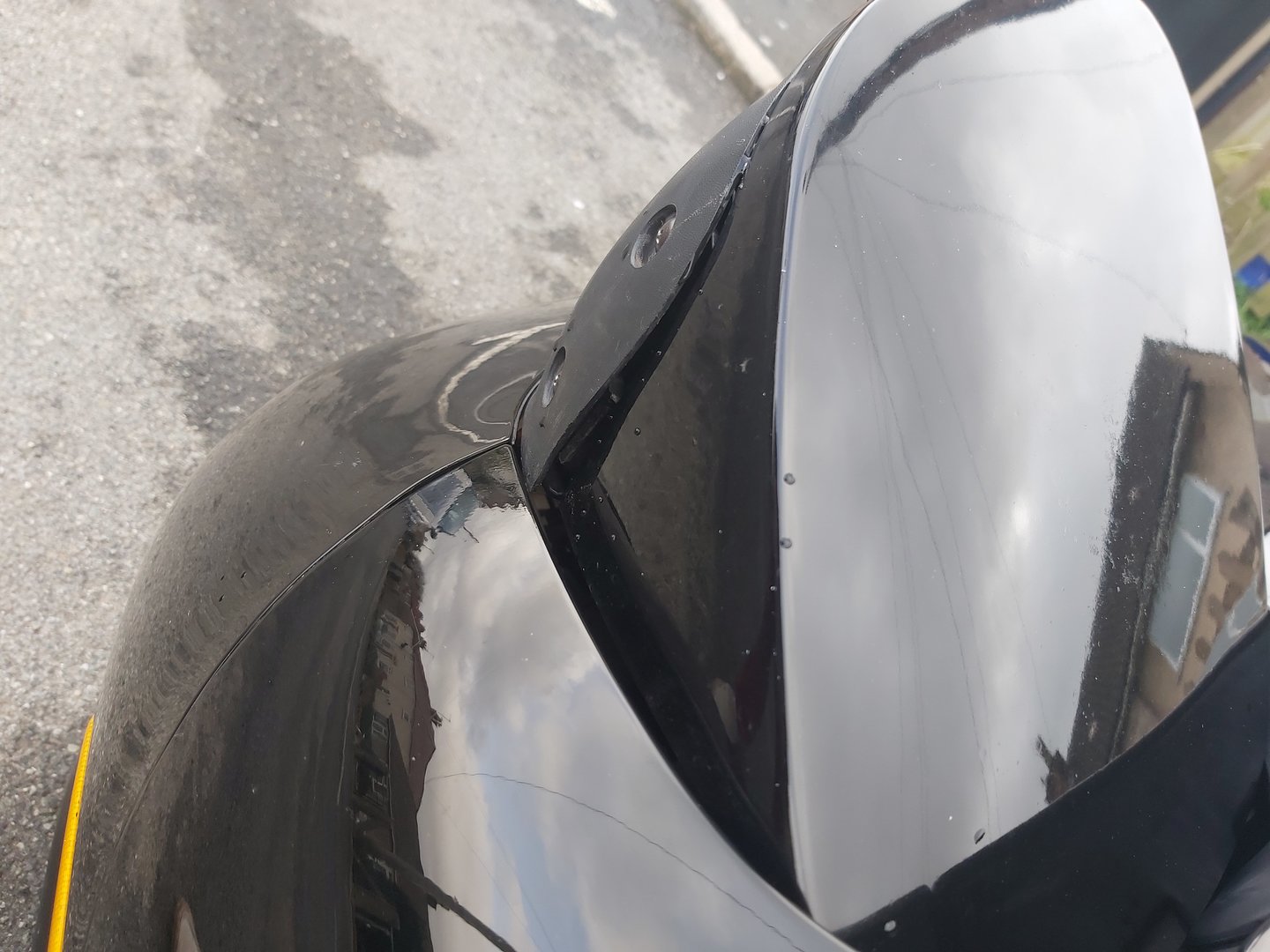

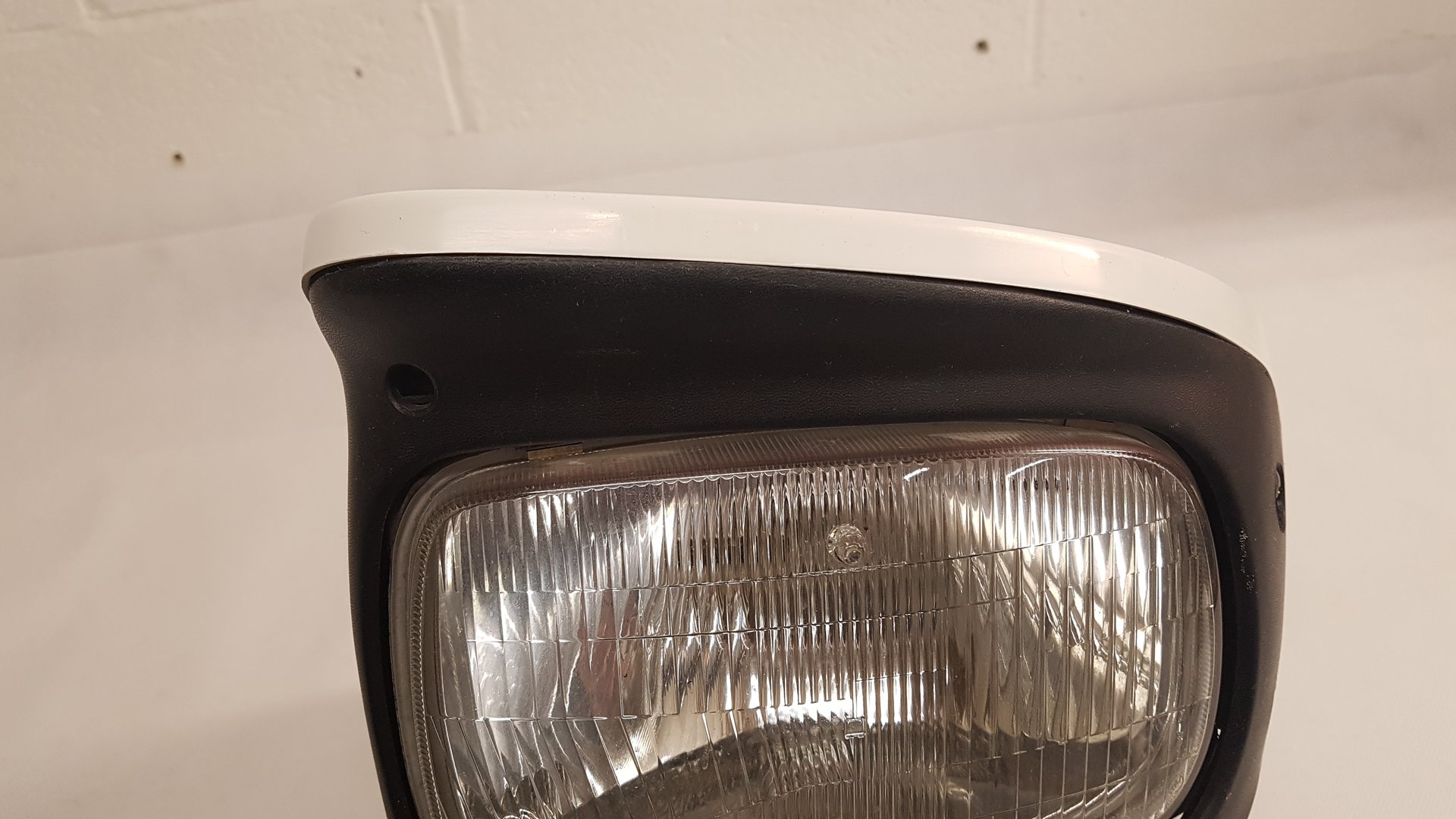

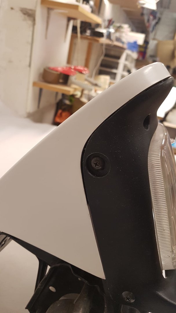

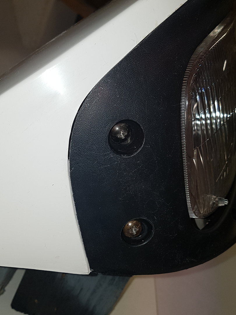

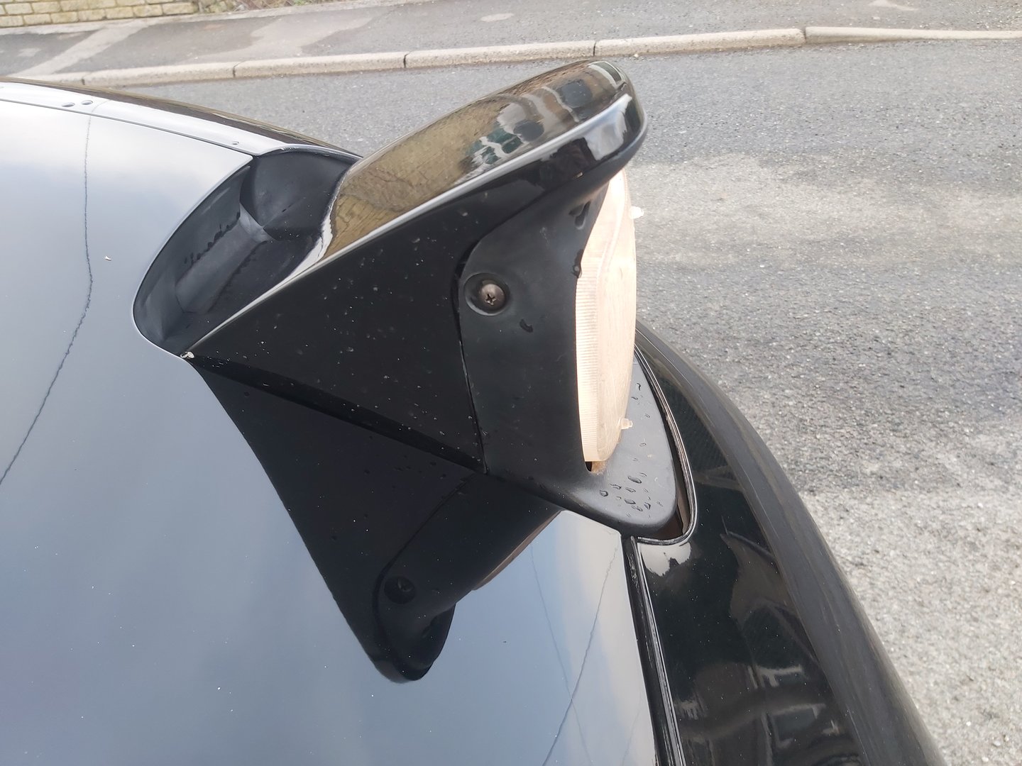

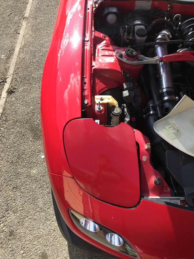

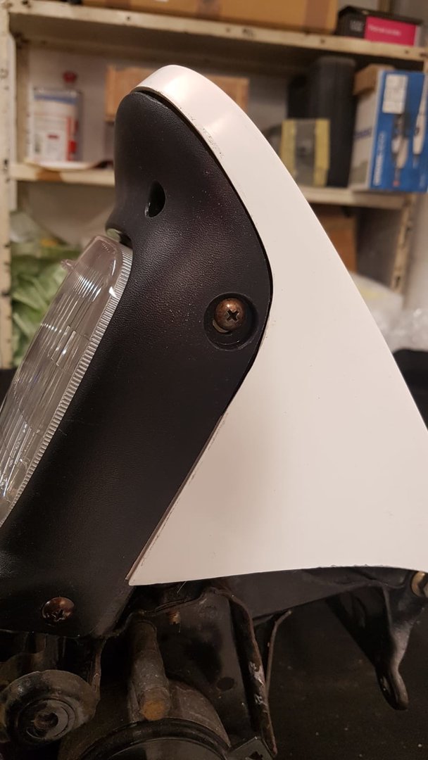

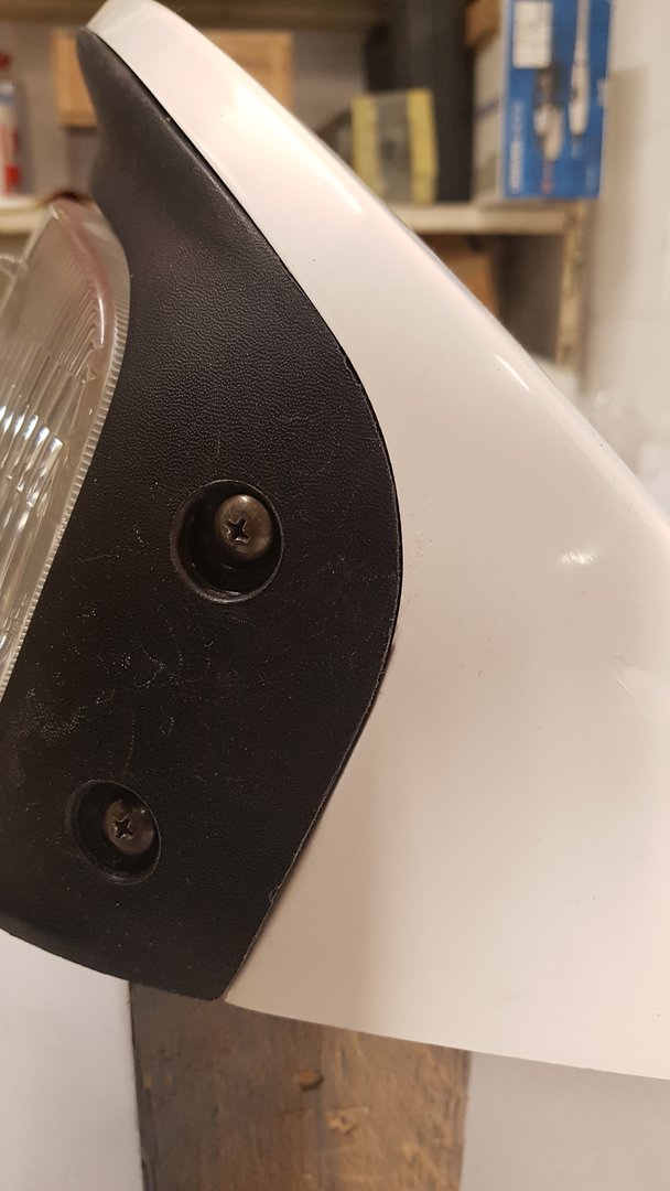

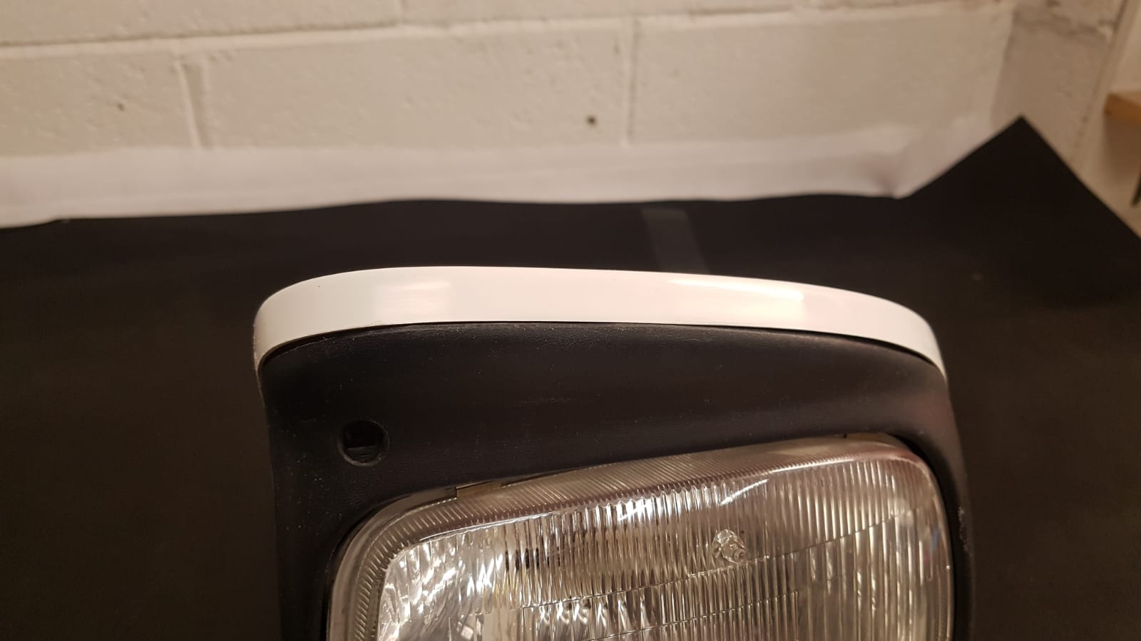

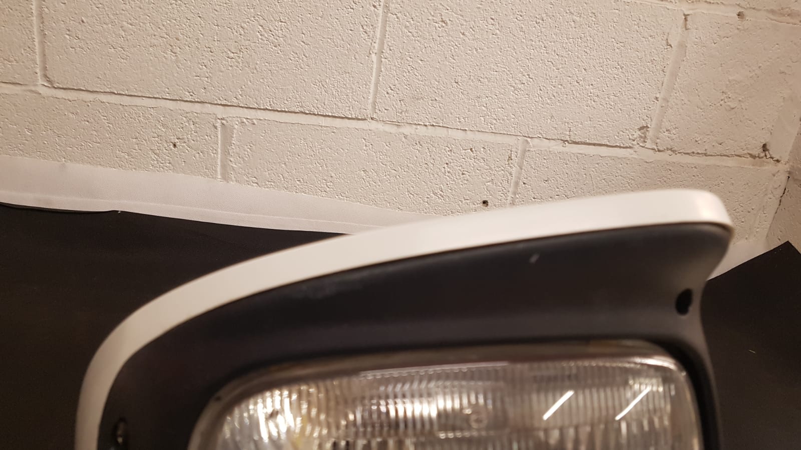

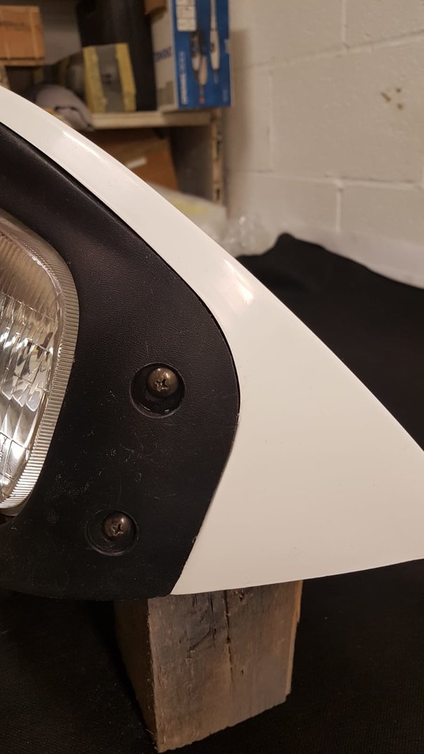

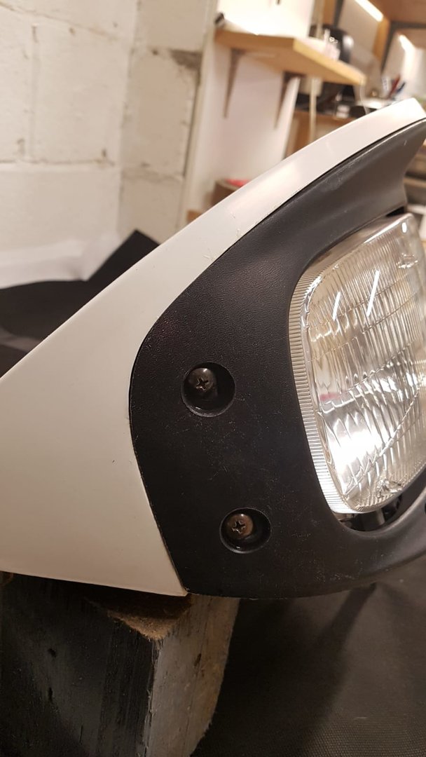

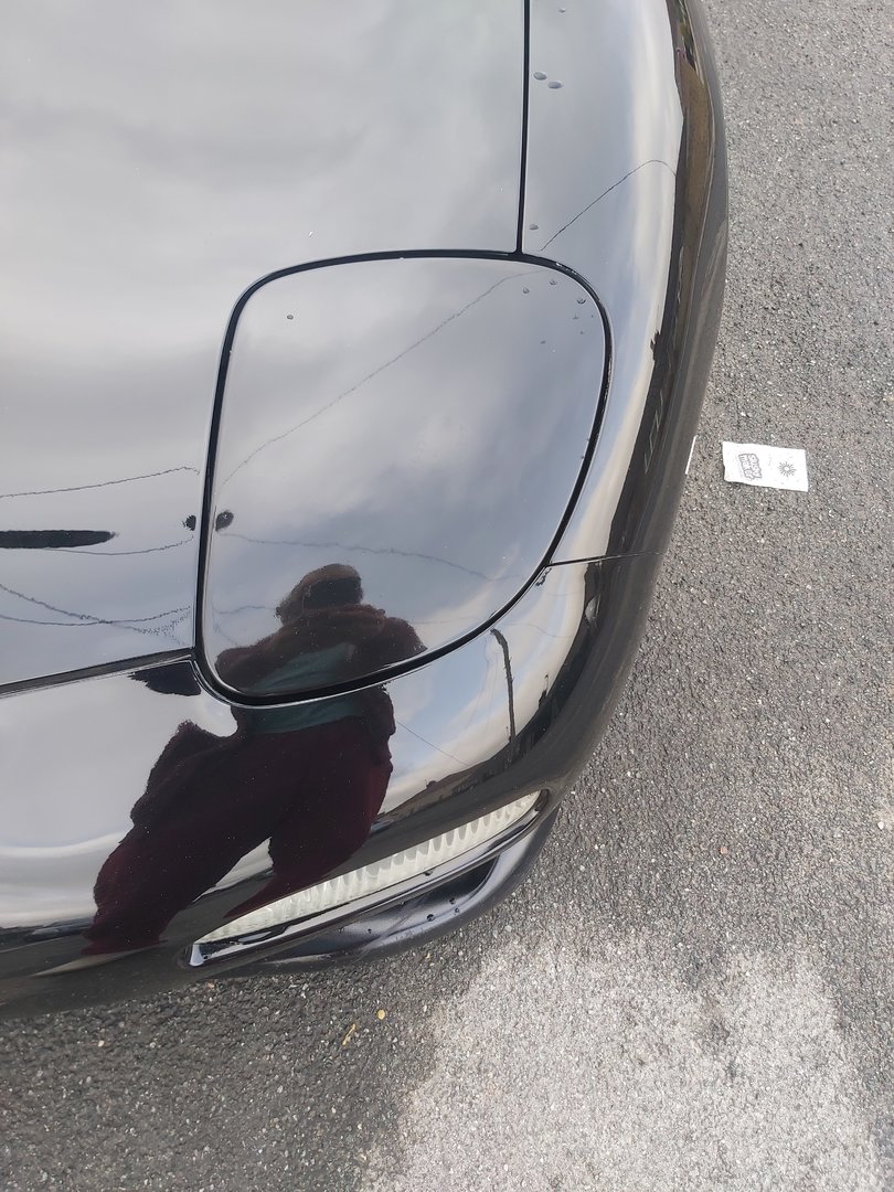

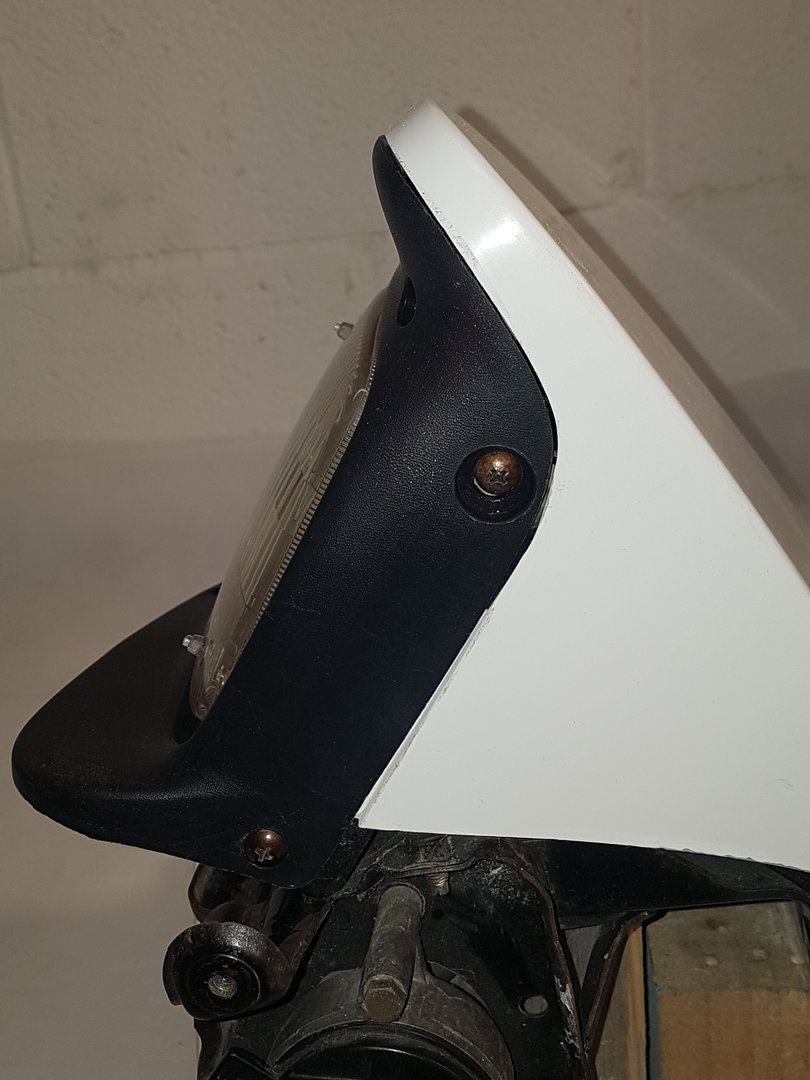

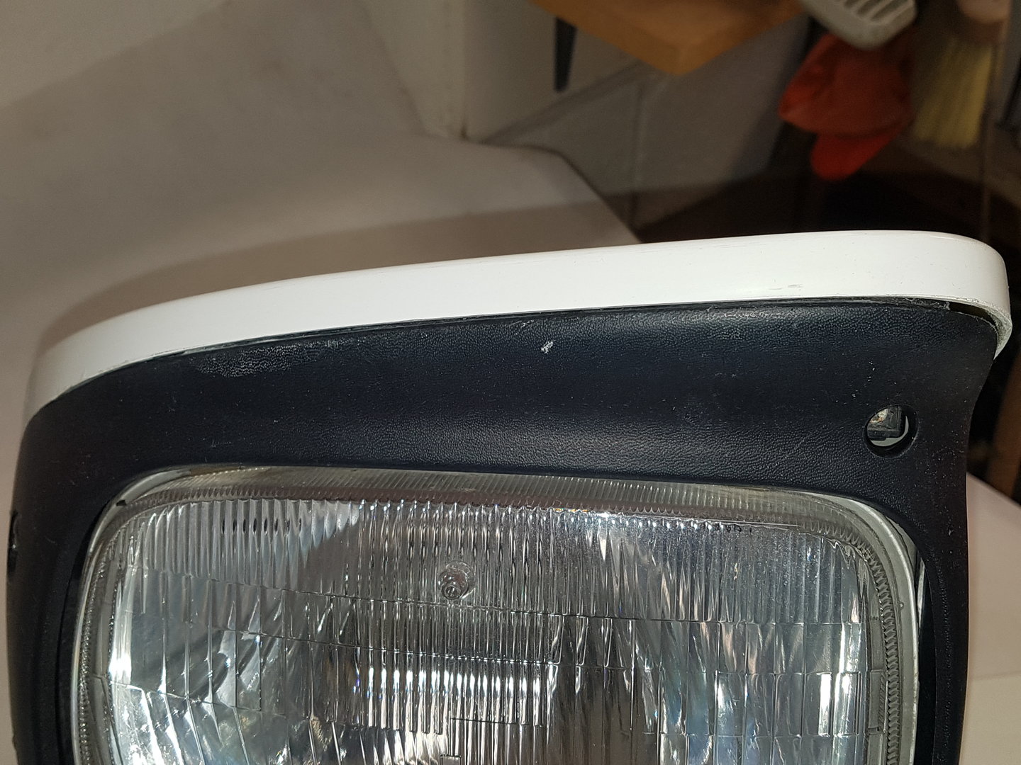

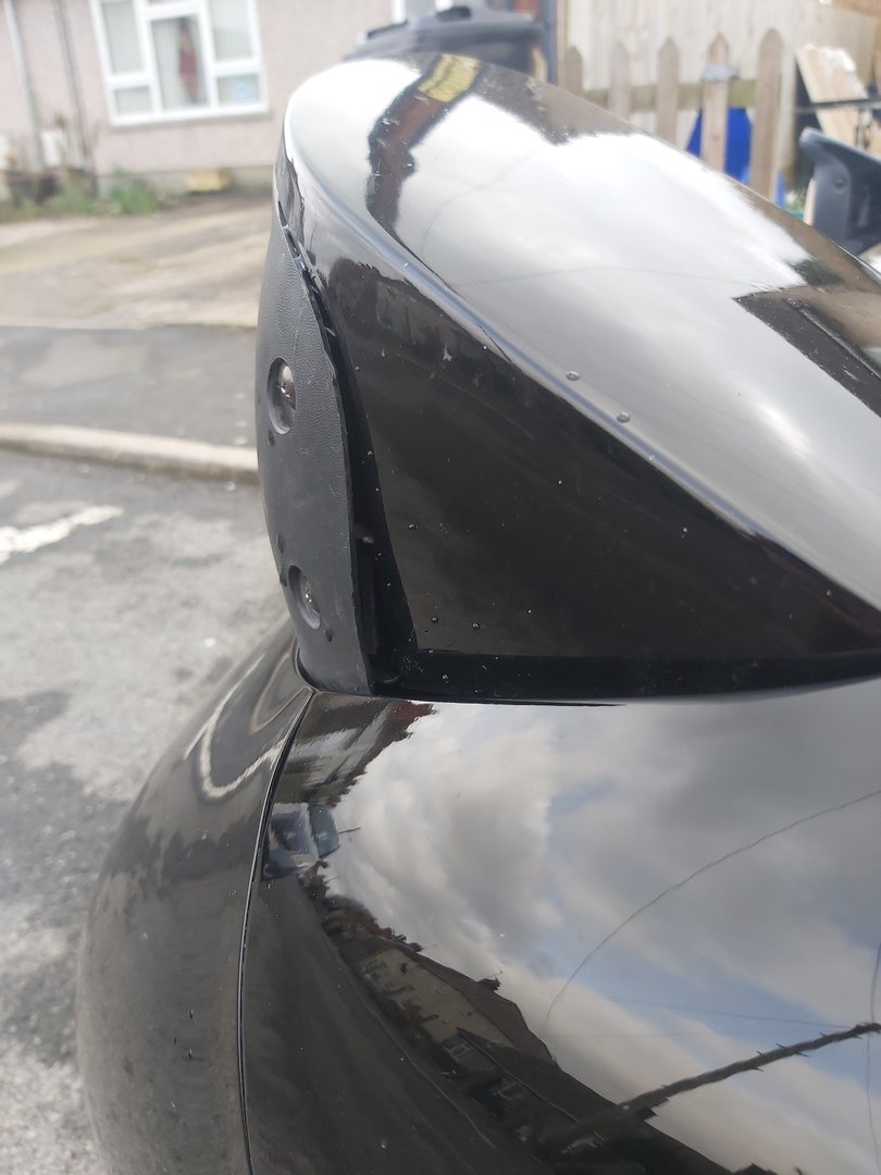

Thanks Taj1961 for posting up the pictures
Just to confirm these were a fresh set of covers taken out the moulds Thursday which i threw into the motor housings and popped the plastics on. fitment is as shown no messing around no nonsense.

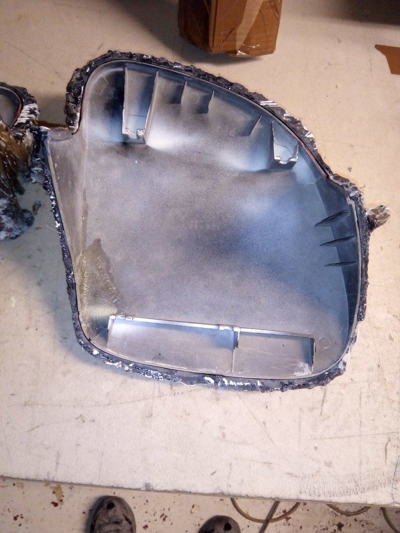

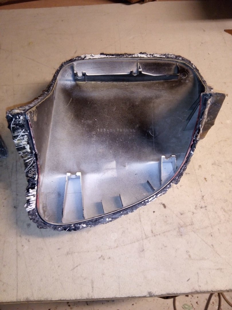

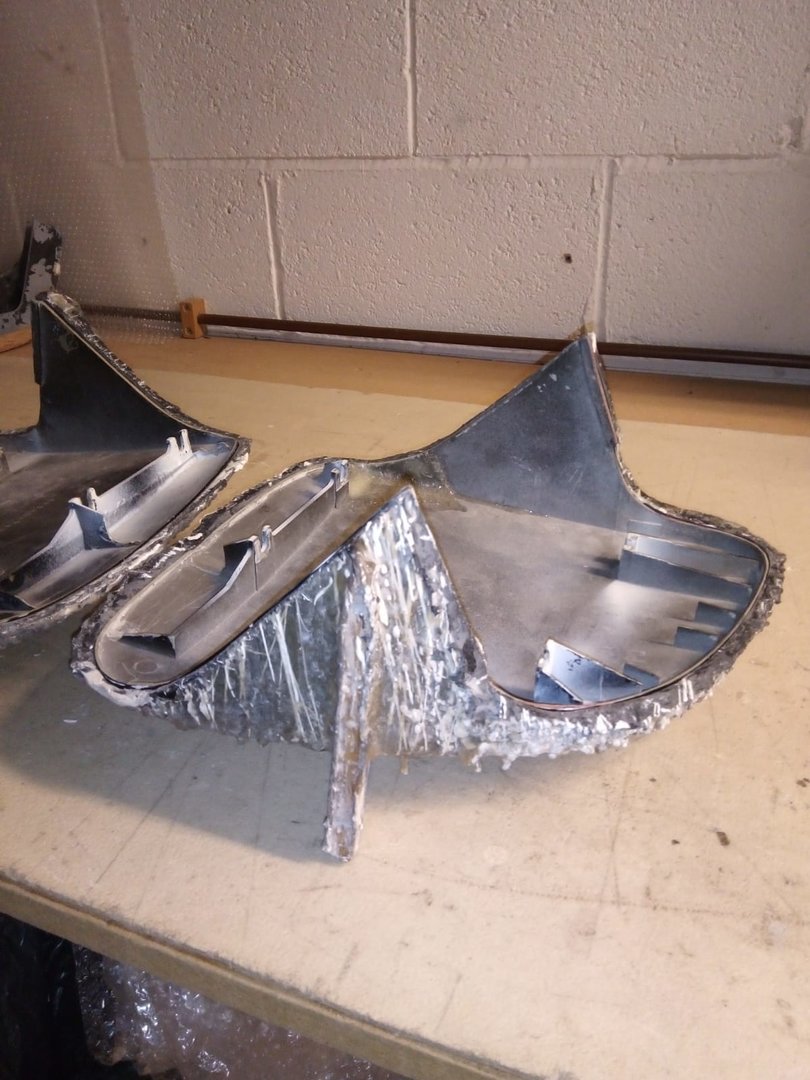

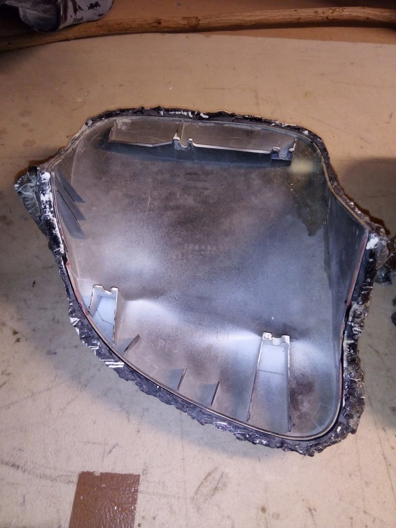

There seems to be a suggestive undertone that there is a problem with our covers. Now im sure you all have a basic idea how you copy existing products ie the moulding process.. iIn this case we have taken a pair of OEM (ABS) headlight covers and moulded from them. This mould produces piesces that are identical (shrinkage is negligible) copy of the host (scratches and all lol) !! No variance no hit and miss !!
That said wear can occur to the moulds when the piesces are trimmed. as we trim in the moulds themselves (see pics). This effects just the corner points and happens only slightly over a period of time. Now some time ago we had a comment which allerted us of this so we placed a stock cover back in the moulds and sure enought there was a couple of mm discrepancy. Immediately we re-built up the moulds and re shaped them against stock covers. This is a process we now check regular and adjust as necessary. but i must point out striaght lines are not effected its corners that are. Other than this the piesces are replicated as OEM every time !!

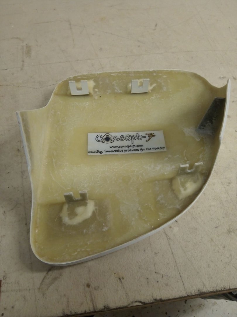

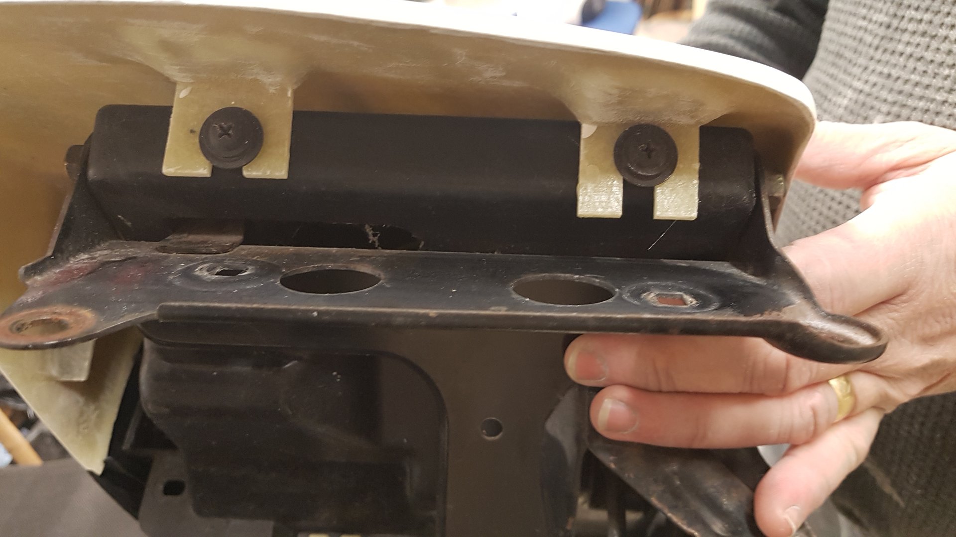

If we now turn our attention to the positioning of the tabs we have built our own comprehensive jigs which secure the covers as if they were in a moulds scenario, then a metal frame pivots down over the top which has locators on for the tabs. They are then attached and glued into position, there is no way of this varying in any way the position of the tabs its a precise bit of engineering and again does not give chance of any 'hit or miss' scenario.
Now i cannot speak for the fitting skills of the covers or the associated plastic front cowlings thats over to you guys (I have showed you what they are like in the post above) but you need to understand this. ANY PROBLEMS YOU ARE HAVING WITH OUR COVERS YOU SHOULD ALSO HAVE WITH OEM COVERS.
In actual fact the tabs on our covers have a wider slot (8mm) and are longer than stock to provide a greater range of adjustment over stock.
