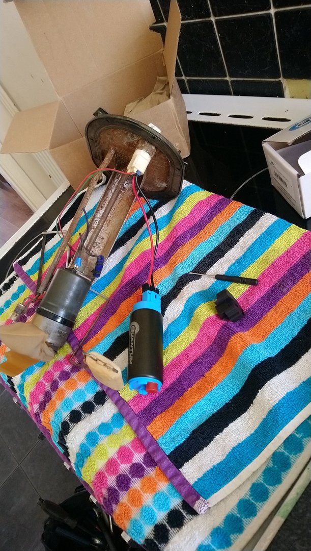

New fuel pump fitted, quantum 340.ignore the dirty hanger i did tidy it up a bit before refitting.
This is the only pic i took but u get the idea 😂.

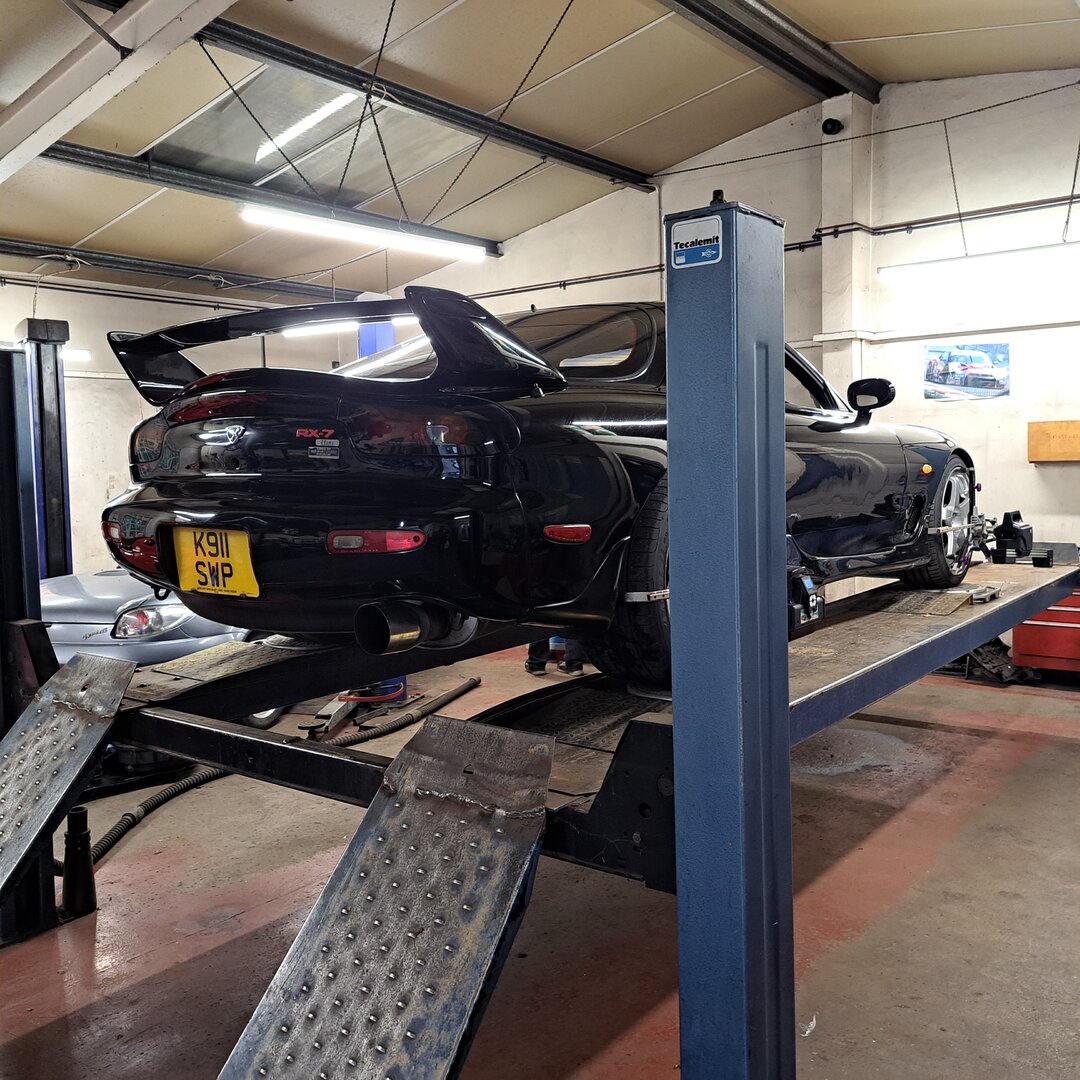

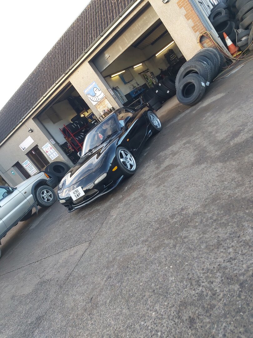

Today drove the car to rotortorque and met jay and stu and also met a few guys off the forum(nice to meet everyone)
They soon found a fair few issues on the car and didnt hesitate to sort them out for me which i was very pleased about.
First issue was the car was pretty dangerous and the alignment needed to be done so the guys arranged that for me and now it drives and handles alot better.
Next issue was a split pipe on the turbos which stopped the second turbo coming on properly.
And final issue was the dump valve wasnt working correctly so was replaced with a working item.
Had the car mapped to 1 bar, jay said the injector duty is 76% which is real good so we are assuming the injectors have been bored out as ive only fitted a fuelpump personally.
The drive home was real good.
the car wasnt fighting me when i accelerated anymore due to the fact the alignment was done now (i didnt realise the car handled so bad until stu said , i just thought that was how they drove being an older car)
The power delivery is much better and smoother, also feel so much faster and now the cars mapped i can really start to enjoy driving it again without worrying about being on apexi base map.
Very happy with rotortorque jay and stu are absolute legends would highly recomend.😀

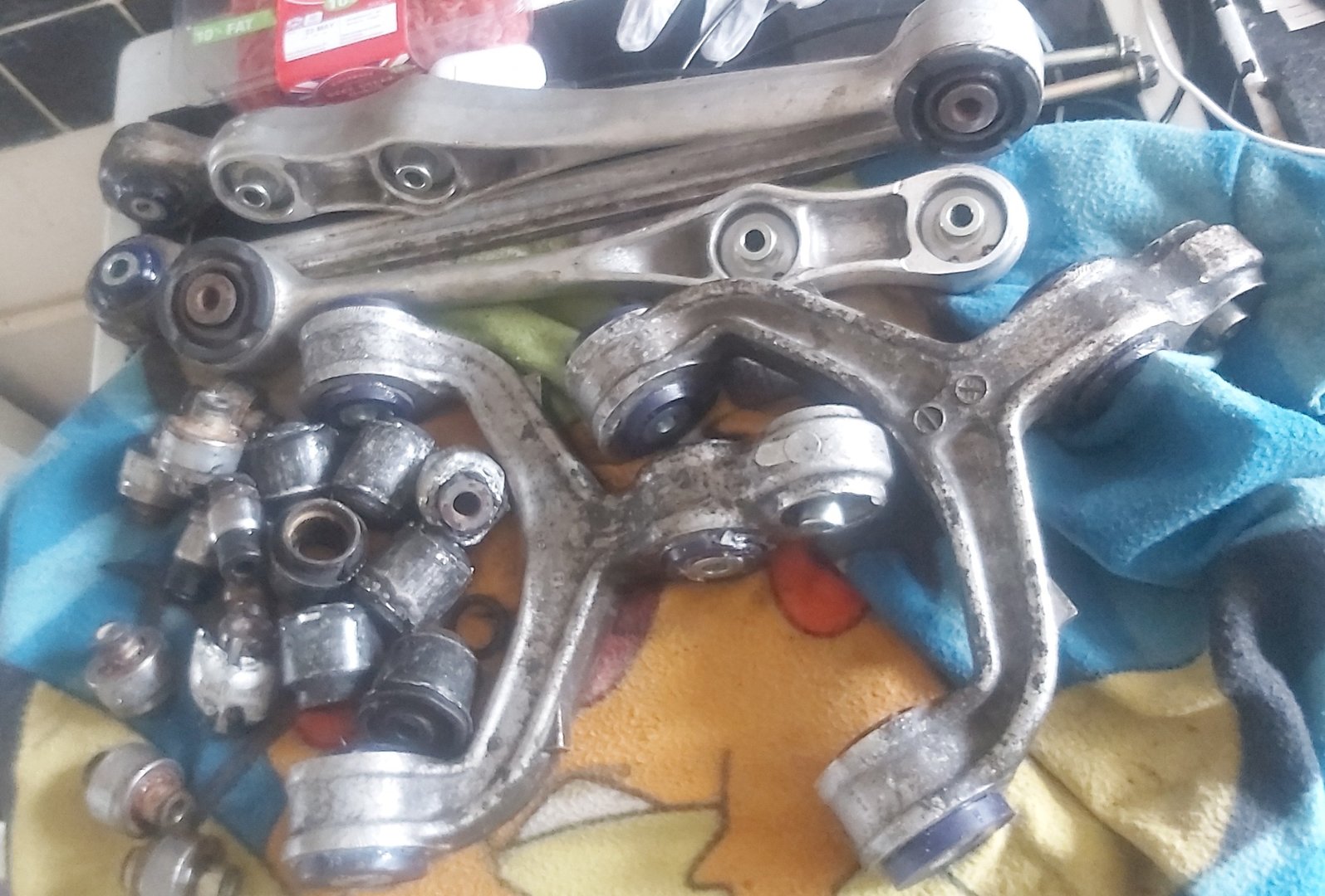

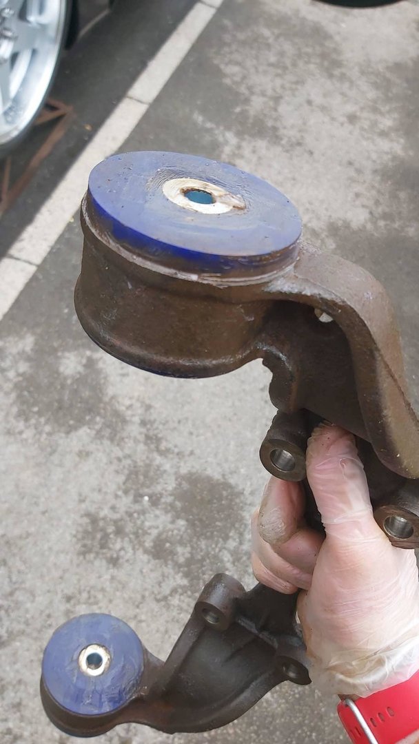

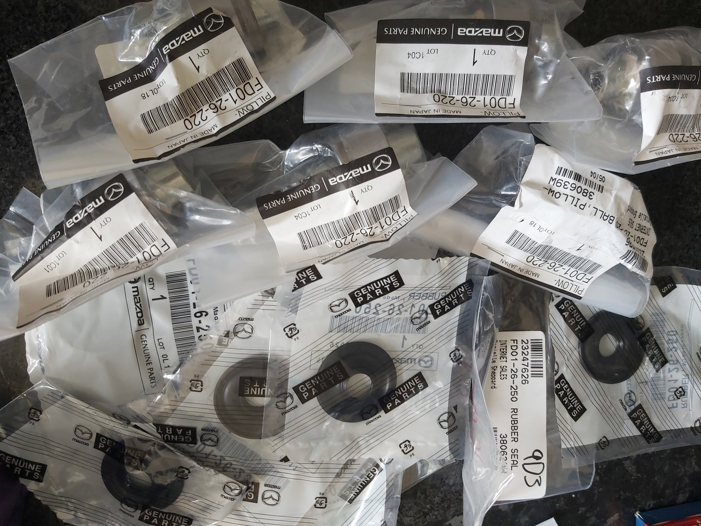

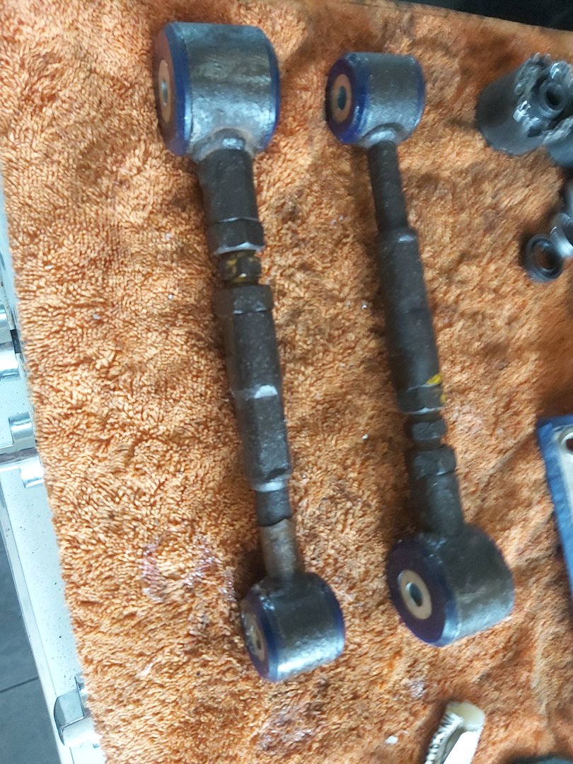

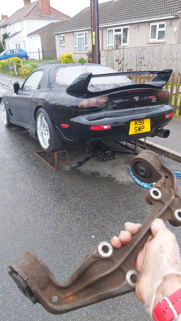

Had a few knocks and bangs from the rear so Ordered and fitted full super pro poly bush kit, and also genuine mazda pillowballs and dust covers.
All went well with fitting, also replaced the ppf as it was cracked,

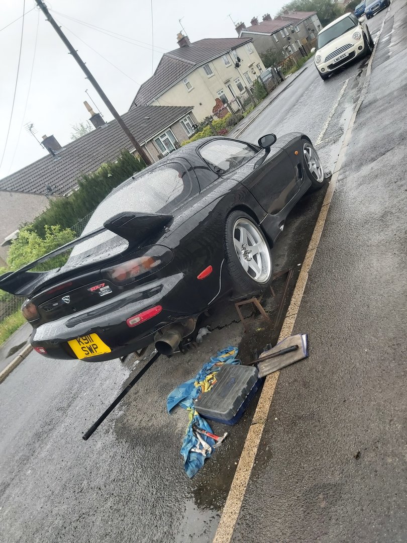

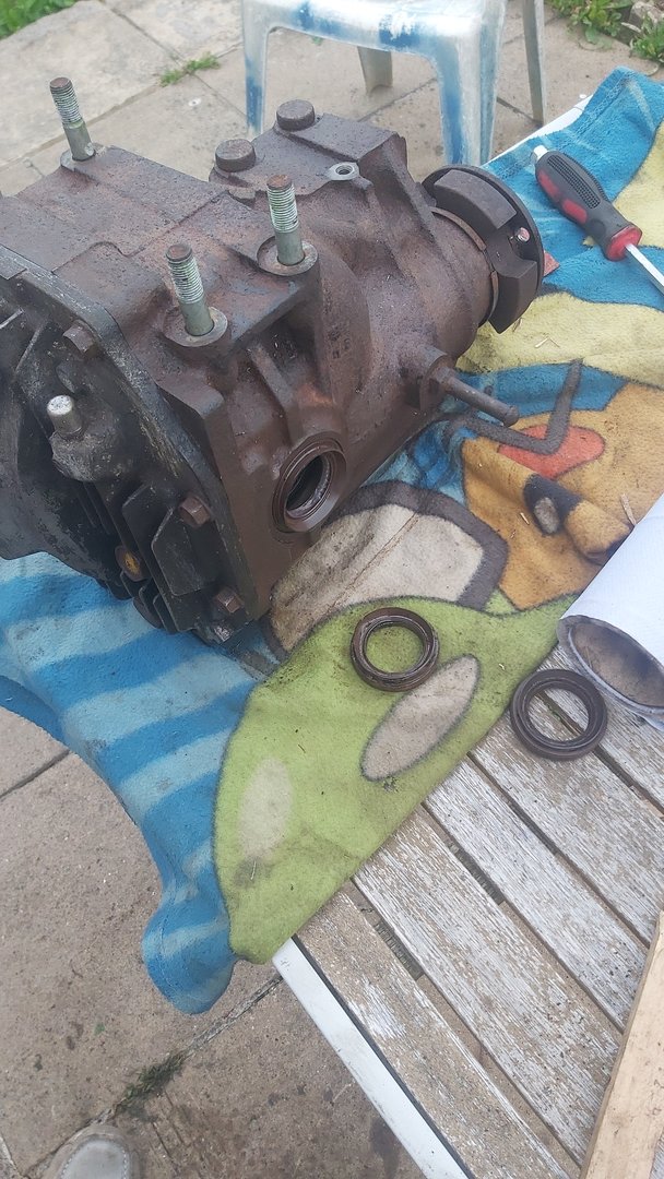

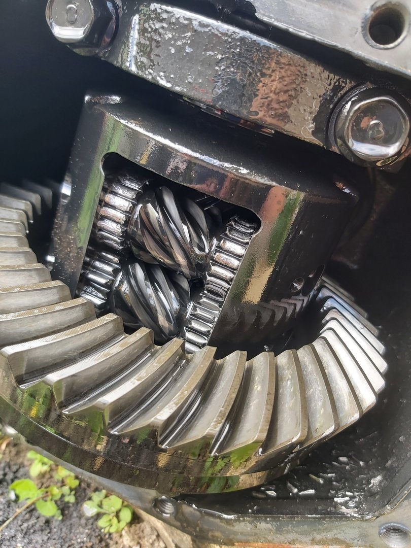

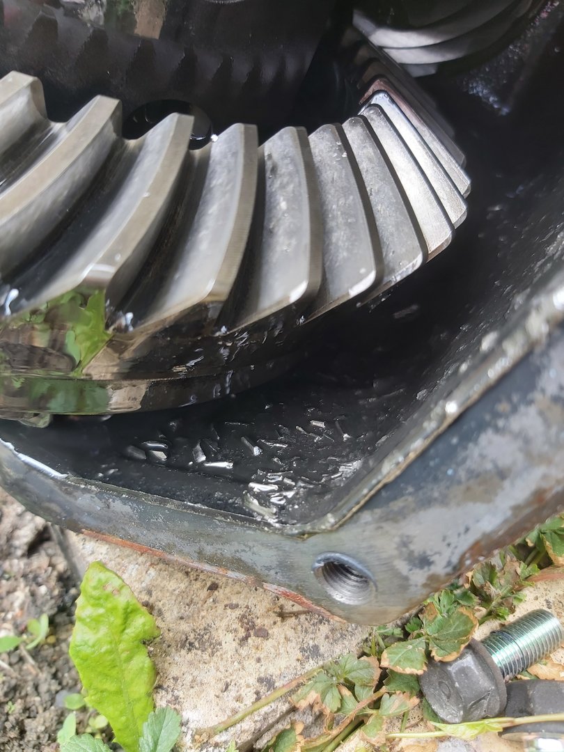

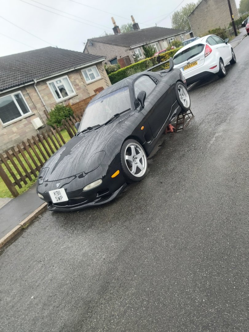

Then found out the car was undrivable due to the diff being damaged inside.
got a replacement diff and put new seals in it andfitted it up with some new oil and all seems well now 🙂
Was alot easier then i thought it was going to be to swap the diff out 😂.

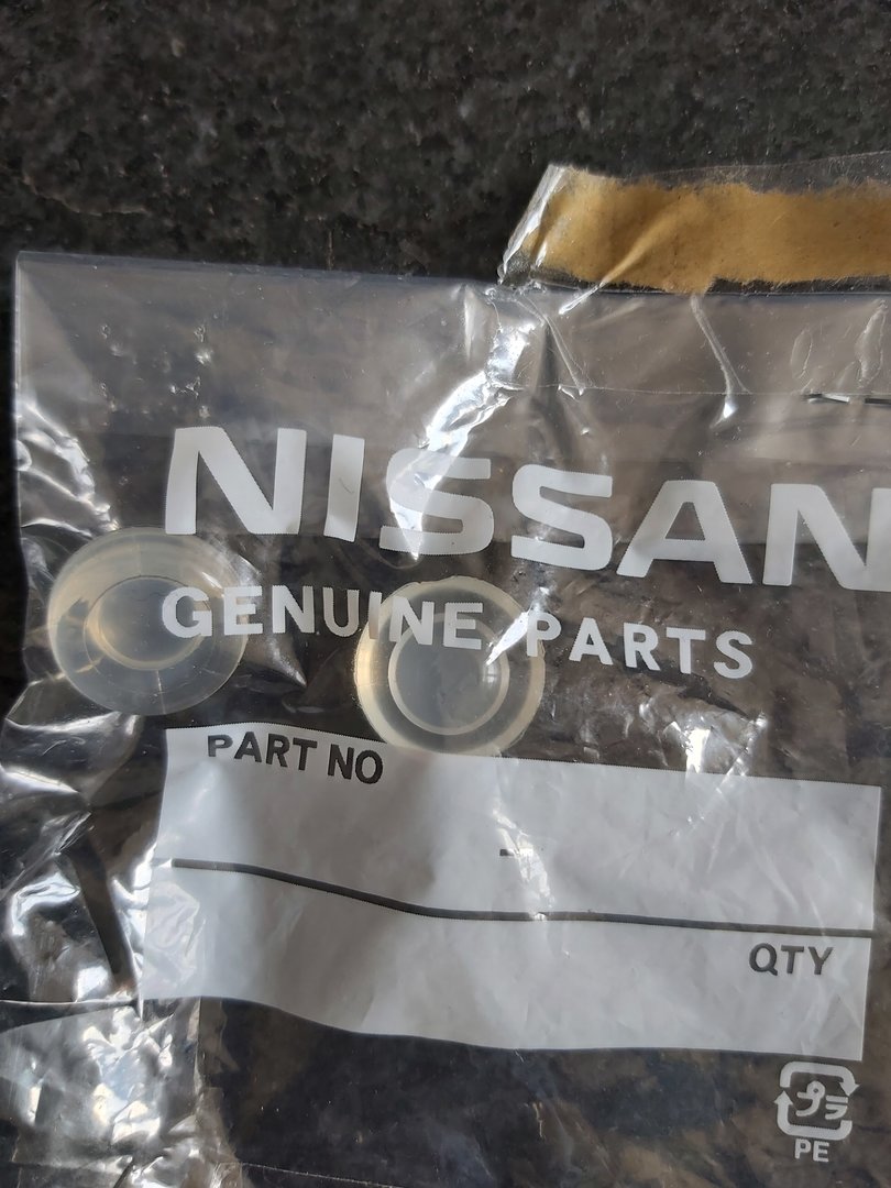

Replaced the brake pedal stopper with a nissan item
Also replaced an exhaust to downpipe gasket as someone had filled it with mastic 🤔..
replaced the worn suspension with a set of hsds with softer spring rates so i can daily drive it without it being so harsh.
From the 5 miles ive driven it so far it feela so much better, bit more road noise because of the poly bushes but that was to be expected.

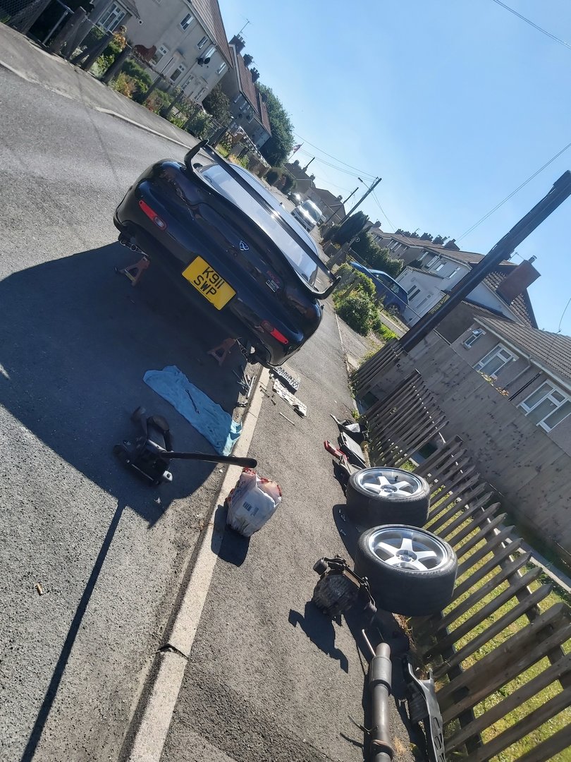

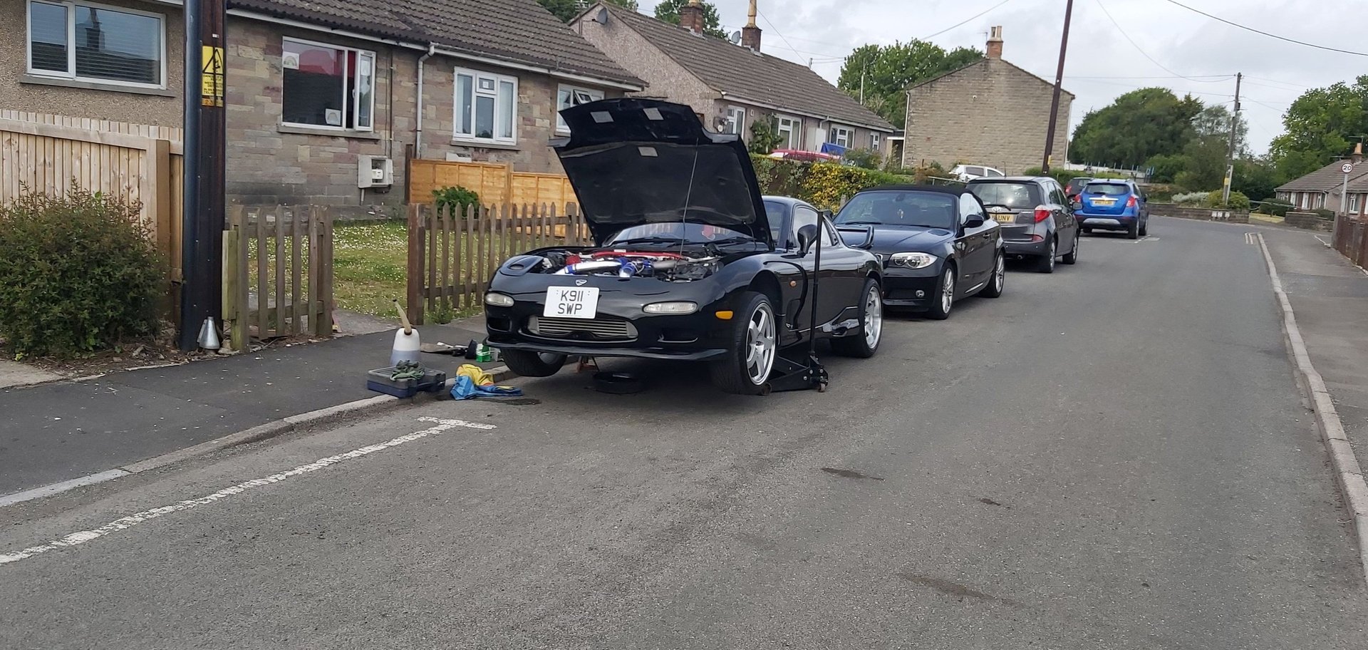

I certainly don't miss the days of having to work on the car in the street. My next dream is to get a garage that has power.
Did you swap the diff for another one or just slam it back in?
I got a replacement diff from jit, the old diff was dangerous and really loud clunking ,
Wasnt too bad working on the road, worse part was the weather being so hot 😂
