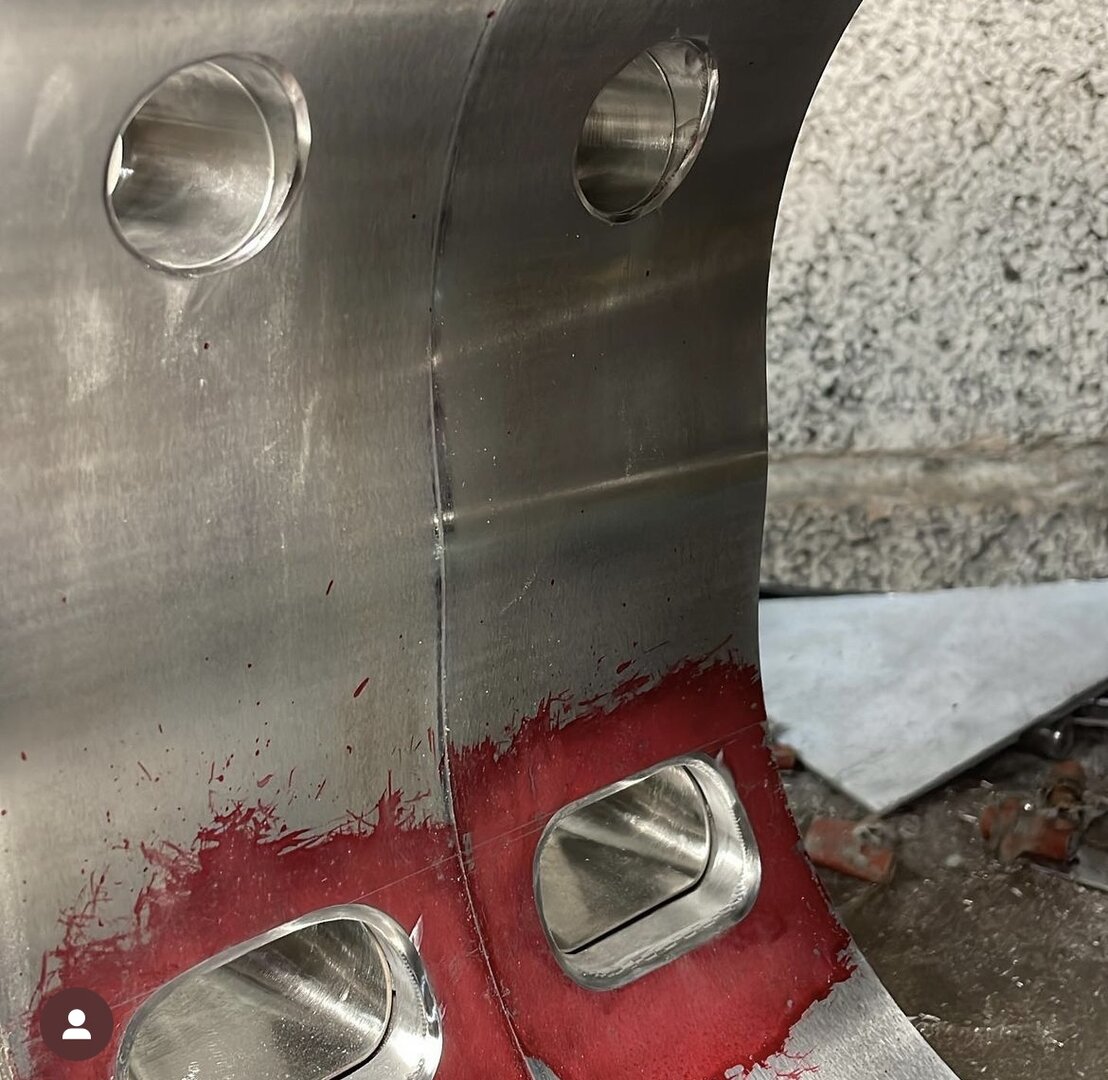

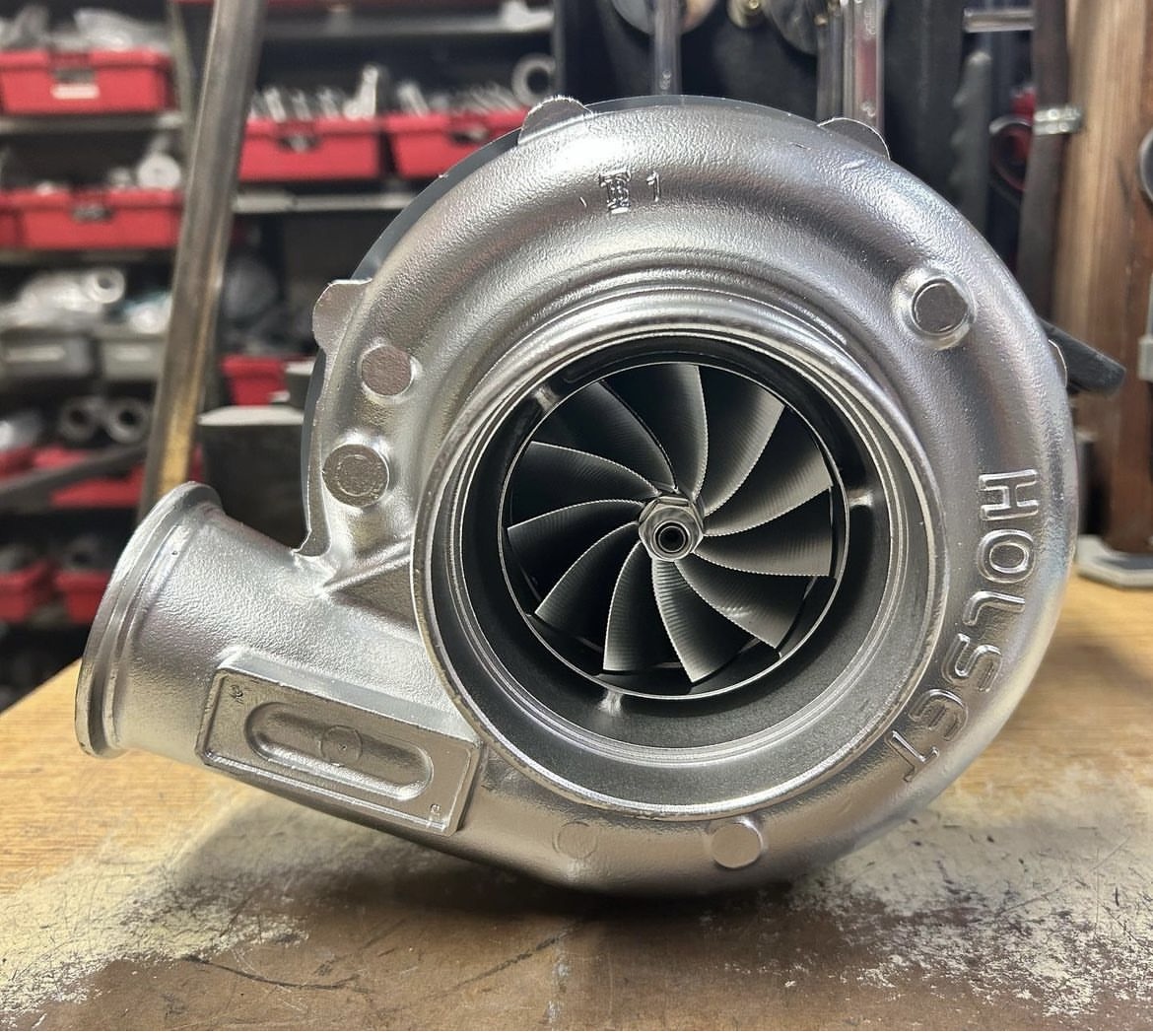

Because he’s a friend and it’s free.Why did you send the Holset off to the US, plenty of places in the UK that can do the required machining and reprofiling for that?!
£80 - don’t concern yourself with my wallet, I’m good.Shipping must not be cheap for a heavy blower to the US?

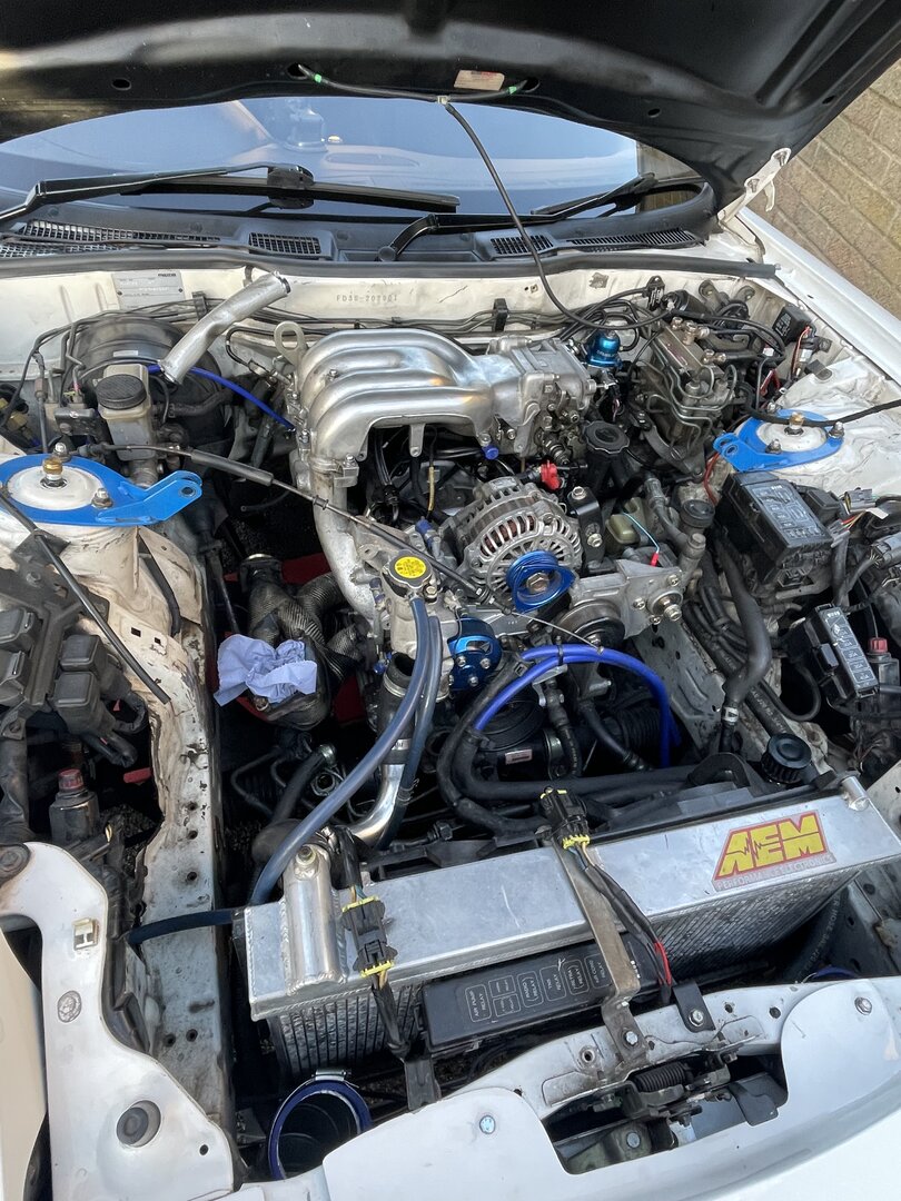

I remember this car and the intake mani. Made some crazy power and tq on a street port and held it to 8500rpm. If you do find someone to make this mani design it will be epic.I’ve started to strip the engine bay to remove engine but before I do I need my friend Mark to come and measure up for new loom.

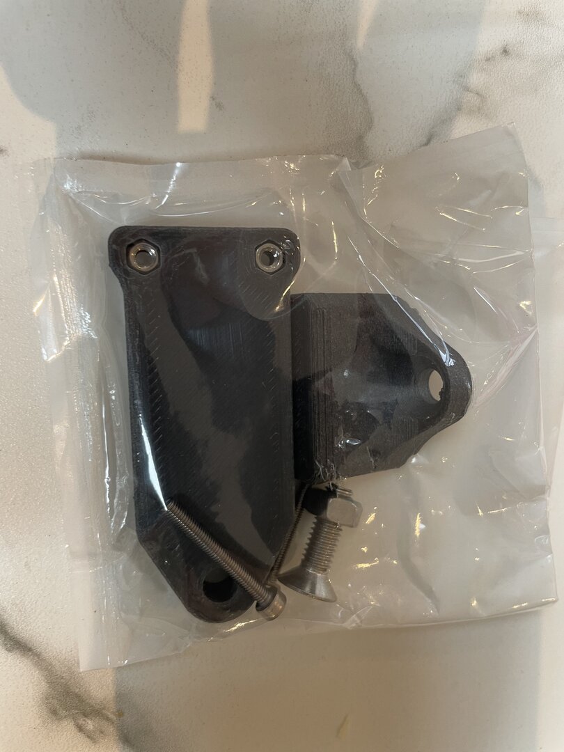

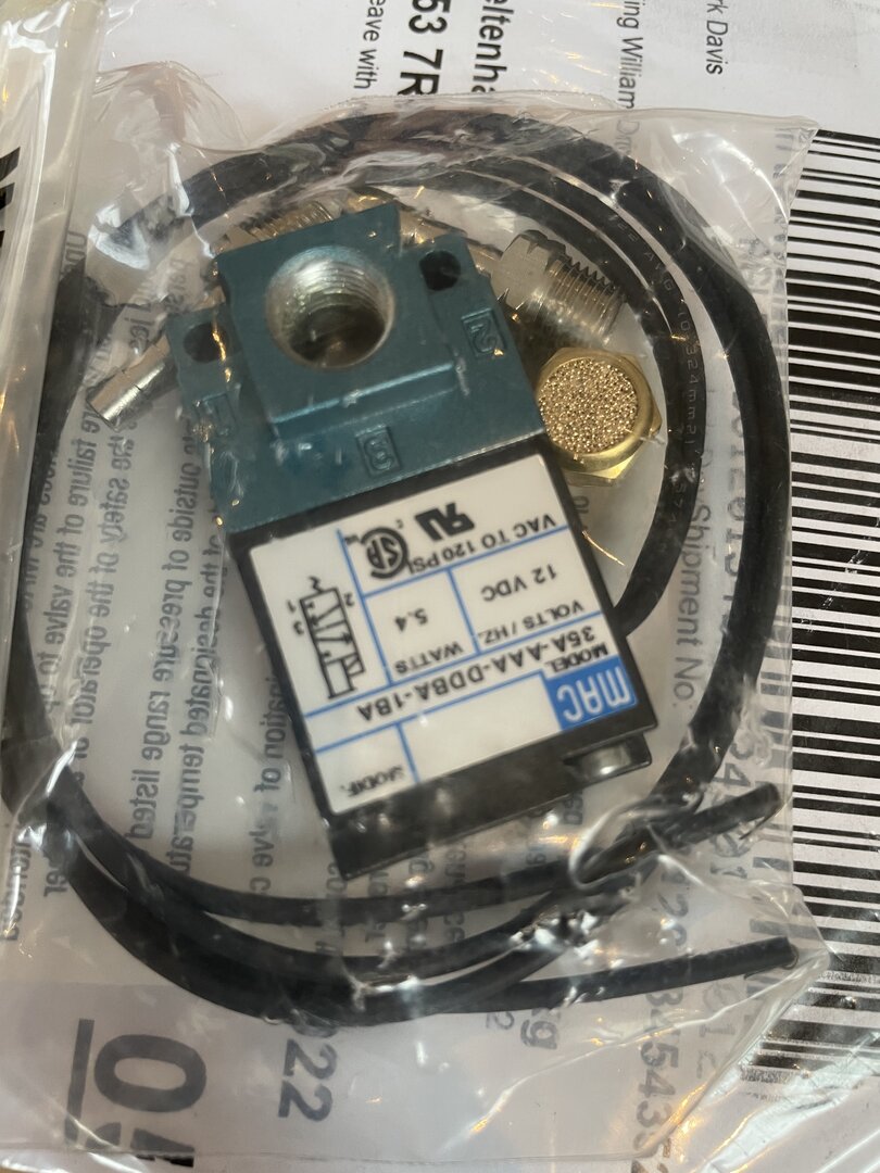

Meanwhile I’ve bought a few more little things.

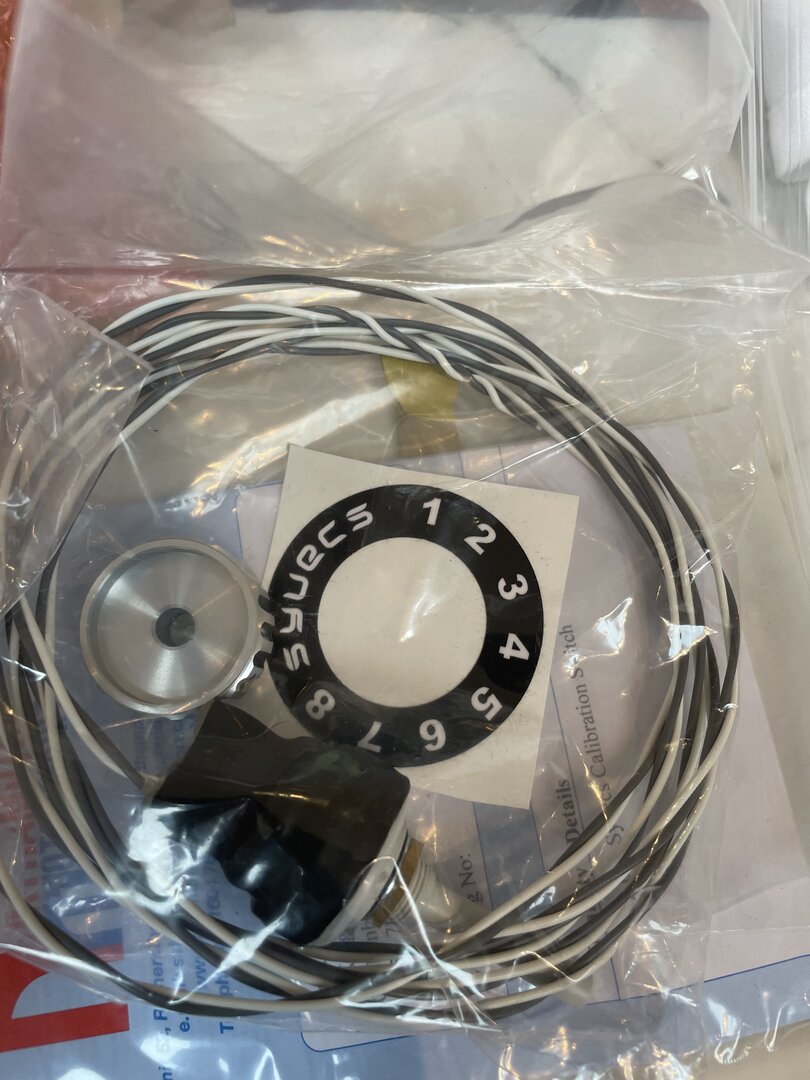

An additional 3 port MAC valve as will run two for boost control. 2 x 3D printed MAC valve brackets. 2 x Syvecs switches to move between various MAP settings when tuned and a 3D printed dash bracket for the Syvecs D4 dash for when I can afford one.
View attachment 33787View attachment 33784View attachment 33785

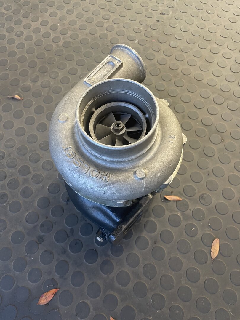

To help keep the costs down a tad before I move to a more modern turbo I’ve decided to keep the HX50 turbo but I’ve sent it off to USA to have the compressor wheel changed from a 67mm to a 76mm meaning I’ll have a sizeable 77/86 with approx 1.3 AR for all the turbine flow. I’d guess capable of 800 on a rotary.
Next step get Mark started on loom, it’s very substantial compared to current loom, this is probably my biggest hurdle.

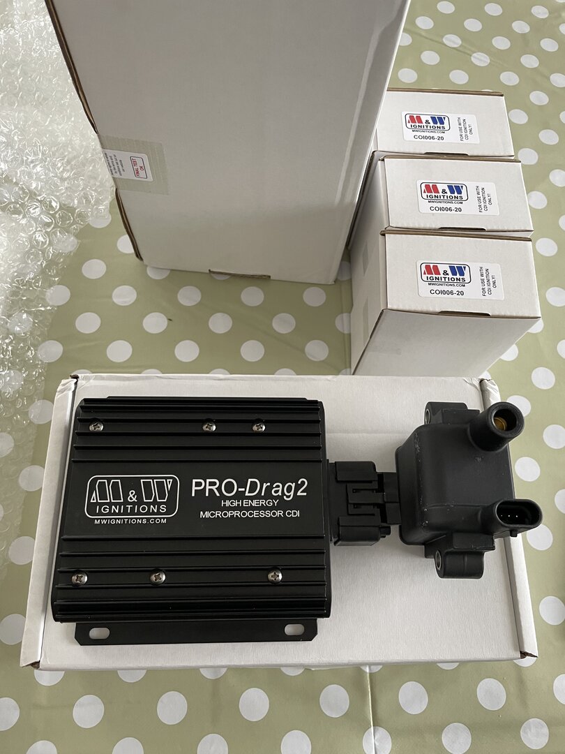

I then need to invest in a new ignition system - going to use M&W set up.
I’m waiting on an extremely swanky sump from Winchester - it’s custom made and still waiting for him to start fabrication.

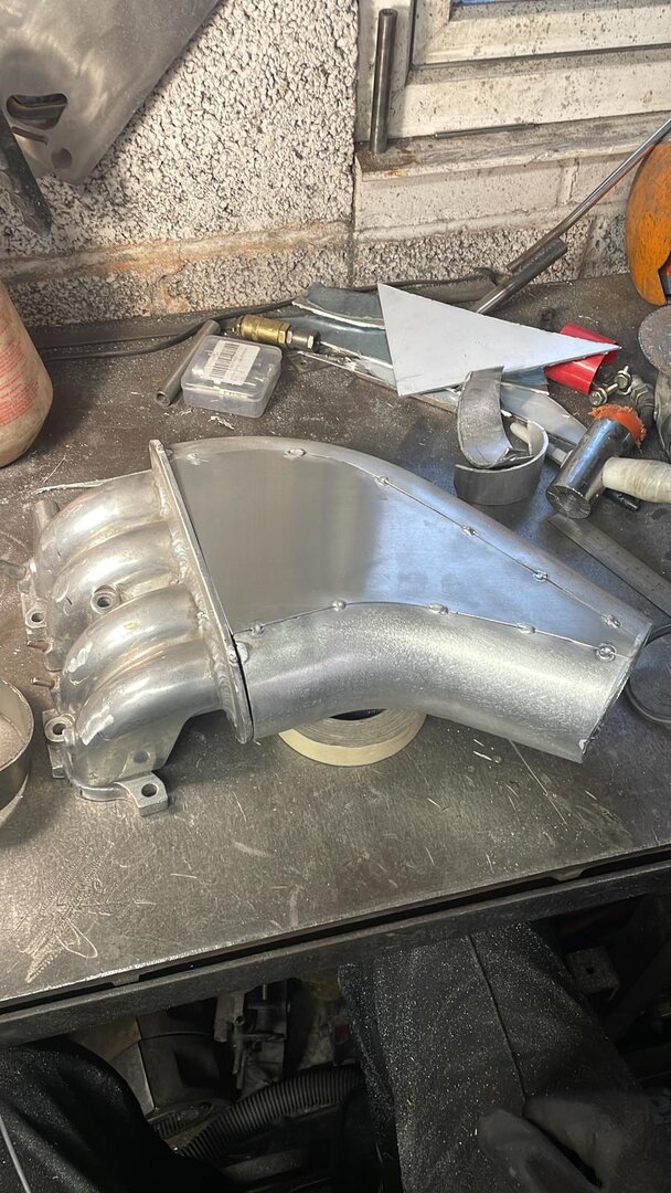

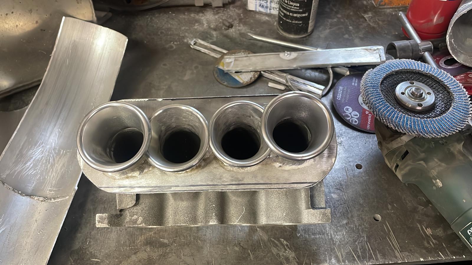

Then I need to find a capable fabricator to make me an upper inlet - this is the inspiration.

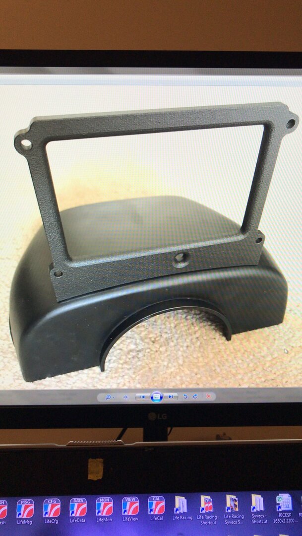

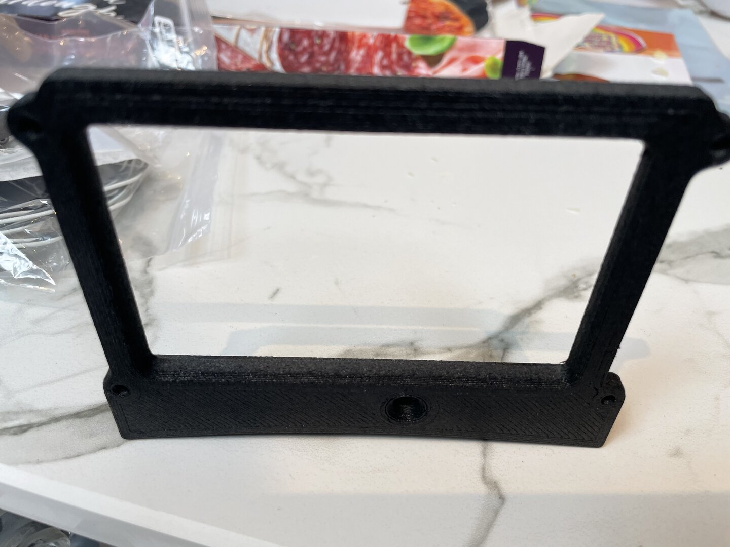

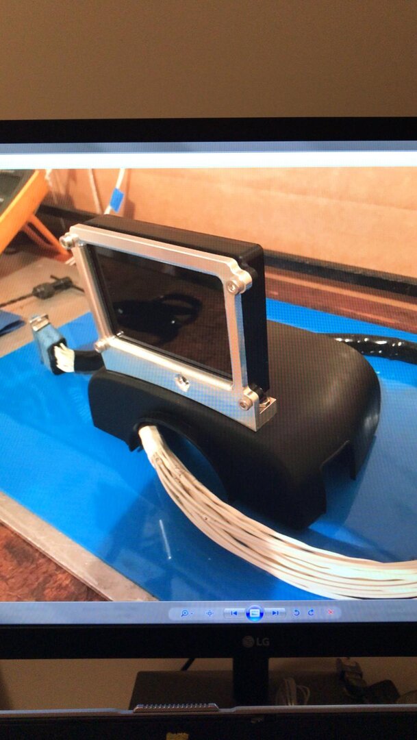

Yes going to use the Syvecs D4 dash so had this steering column surround 3D printed, have the CAD file so may get it made in aluminium at a later date but the 3D printed version seems sturdy enough.I remember this car and the intake mani. Made some crazy power and tq on a street port and held it to 8500rpm. If you do find someone to make this mani design it will be epic.
Is that the new ECU display in the steering column shroud?
All looking epic!!!
Nice dude.Yes going to use the Syvecs D4 dash so had this steering column surround 3D printed, have the CAD file so may get it made in aluminium at a later date but the 3D printed version seems sturdy enough.
I have a few options for inlet fabrication - just getting some quotes etc.
Wasn't concerning myself with your wallet at all, don't get it twisted. More the fact that the cost to ship and return might be more than the cost to have the job done here.£80 - don’t concern yourself with my wallet, I’m good.
The retarded company I sent it to here couldn’t even do it and they are considered to be one of the best, that tells you the state of this country.Wasn't concerning myself with your wallet at all, don't get it twisted. More the fact that the cost to ship and return might be more than the cost to have the job done here.
Not Turbo Technics by chance?The retarded company I sent it to here couldn’t even do it and they are considered to be one of the best, that tells you the state of this country.
Looks a fun challenge, but I am not offering as my TIG skills are weakYes going to use the Syvecs D4 dash so had this steering column surround 3D printed, have the CAD file so may get it made in aluminium at a later date but the 3D printed version seems sturdy enough.
