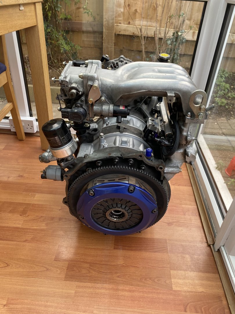

Stu has sorted the engine, hopefully have it collected next week. Happy new year all.

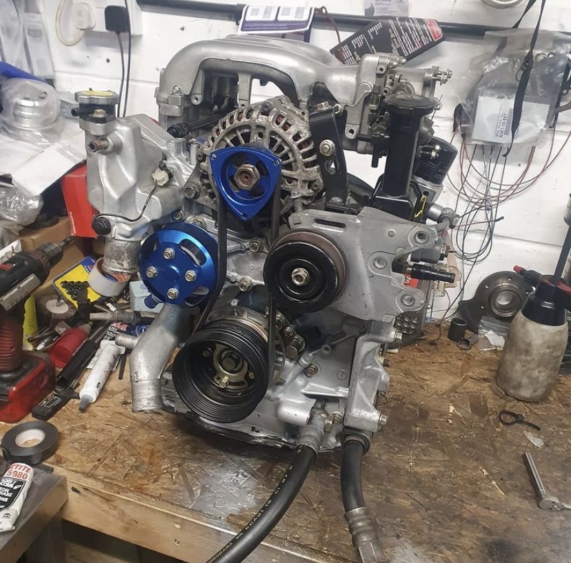

The Link ECU didn’t help with diagnosing the issue. Well it did help me confirm that the oil pressure was slightly too high as the ECU has a sensor to record that data.
The reason it went back to Stu was because I compression tested it and it was too low and also the oil pressure was too high. So he’s remedied both those issues. The compression was too low mainly in part to me not running it in correctly/long enough coupled with the fact Stu ran wider seal tolerances as I plan to abuse the engine at high rpm. So this time I need to properly run it in and Stu has tightened up the tolerances a tad as well as lowering oil pressure slightly.

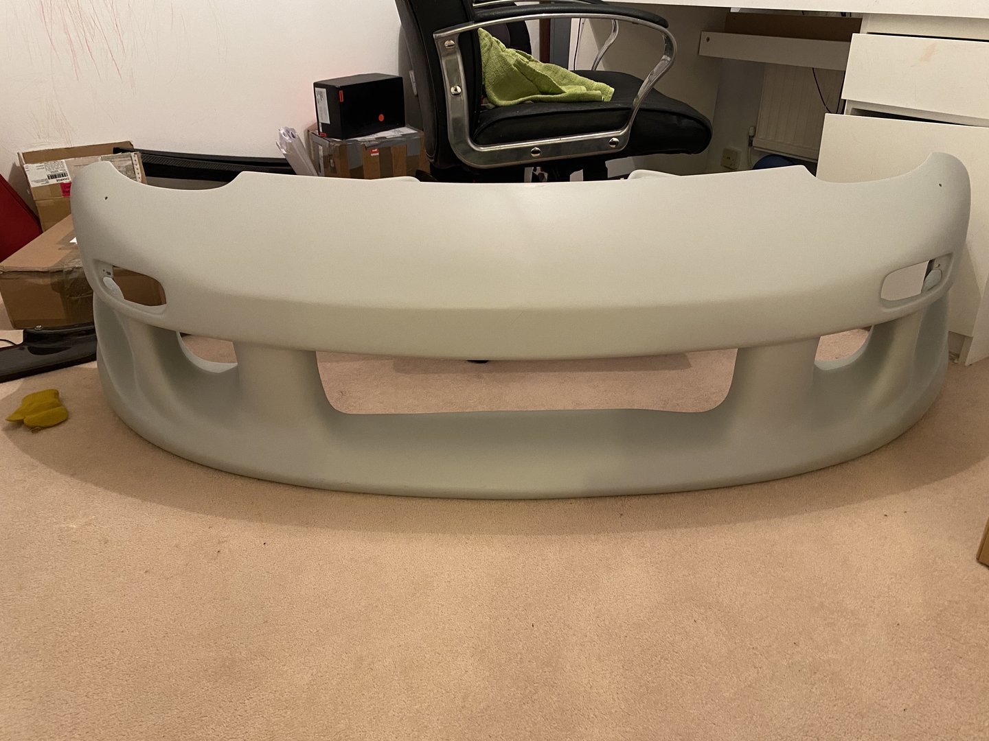

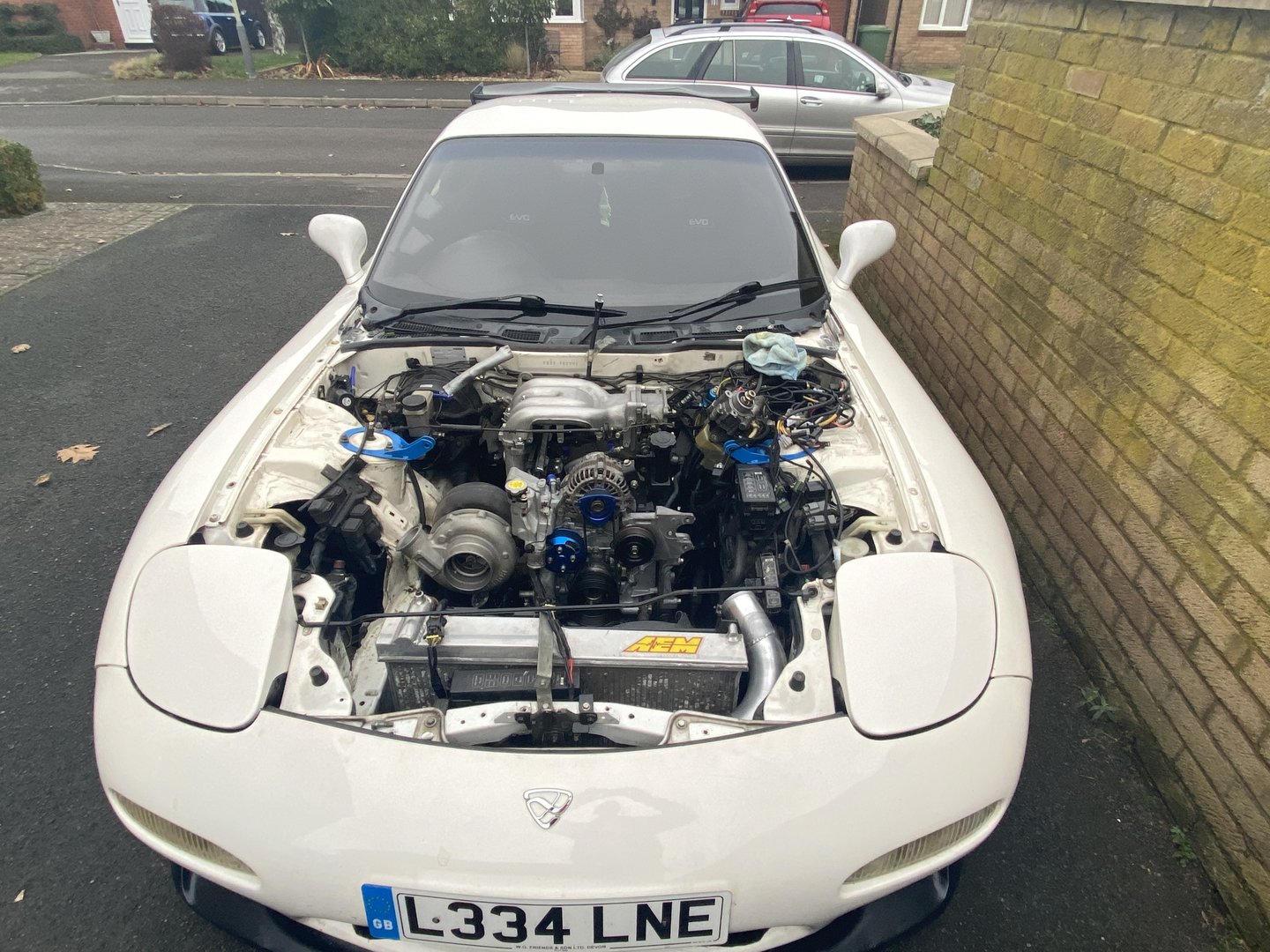

I picked up a Re-Amemiya style front bumper the other day, not sure if it’s legit or not or even if i like it yet, either way it’s going to need a decent amount of chopping to make it fit with my front mount. I may try and repair my OE one or find another style that I like.

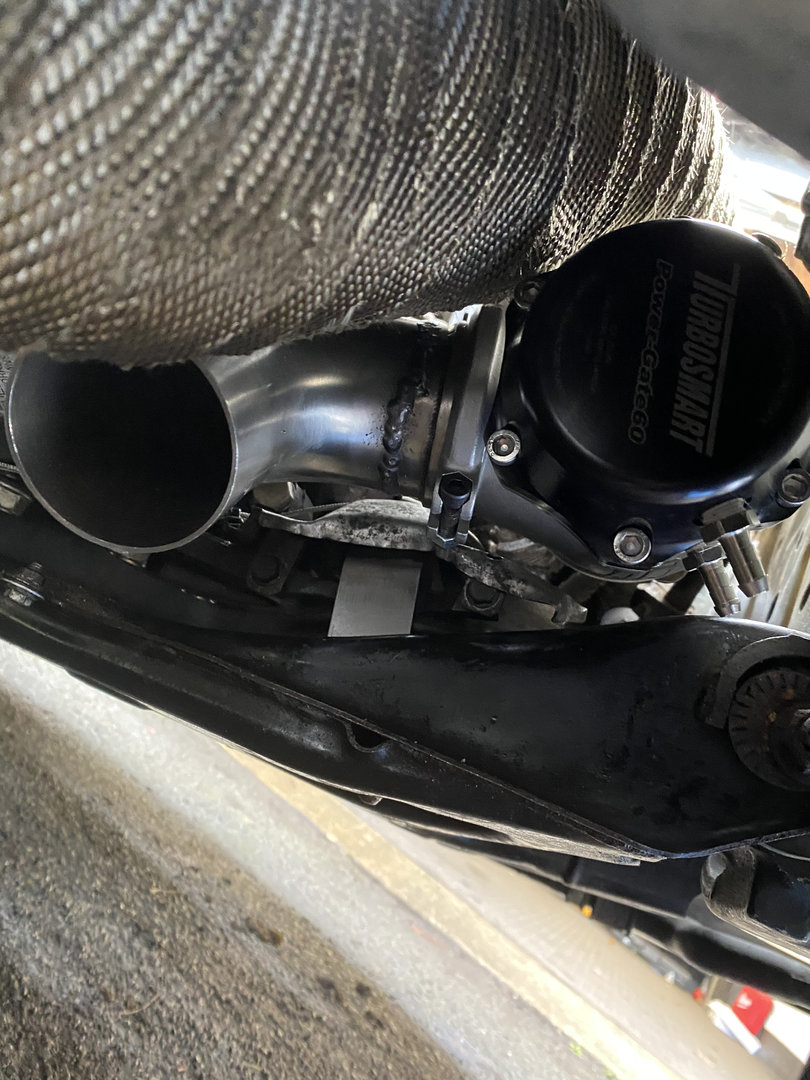

Ive been trying to resolve an oil leak issue with turbo oil return. I’ve just refitted it but currently charging the battery so I can test to see if the leak is sorted.
I am nearing readiness for an MOT but I think I may need some welding done on pass side rear inner sill.
Also met @Tangelos yesterday who bought a carbon front splitter from me, I think it suits his car well.

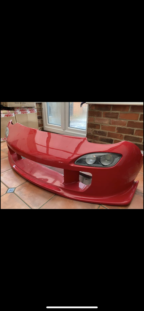

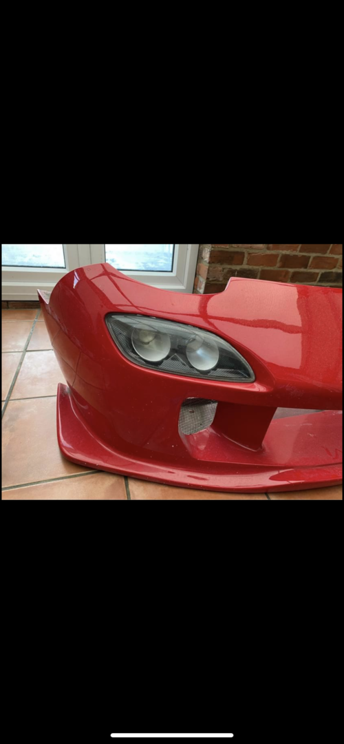

I picked up a second option for a front bumper this week. A genuine Re-Amemiya, I think I prefer it as like the front lights and the larger opening for my front mount.

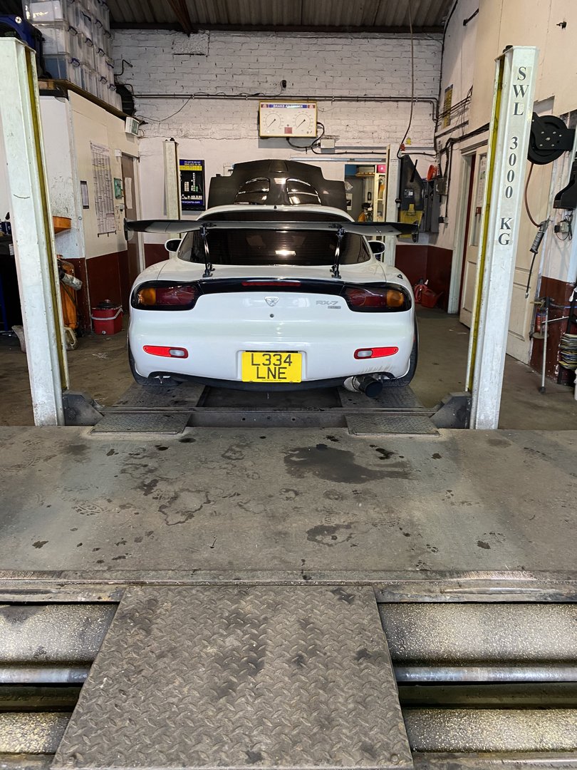

Also had my first MOT since owing the car today. It failed in two bits that I knew it would fail on and that’s having no rear fog light, easy fix this week. Also a small bit of welding needed on under rear sill.
Other than that it’s all good, will get it all under sealed
