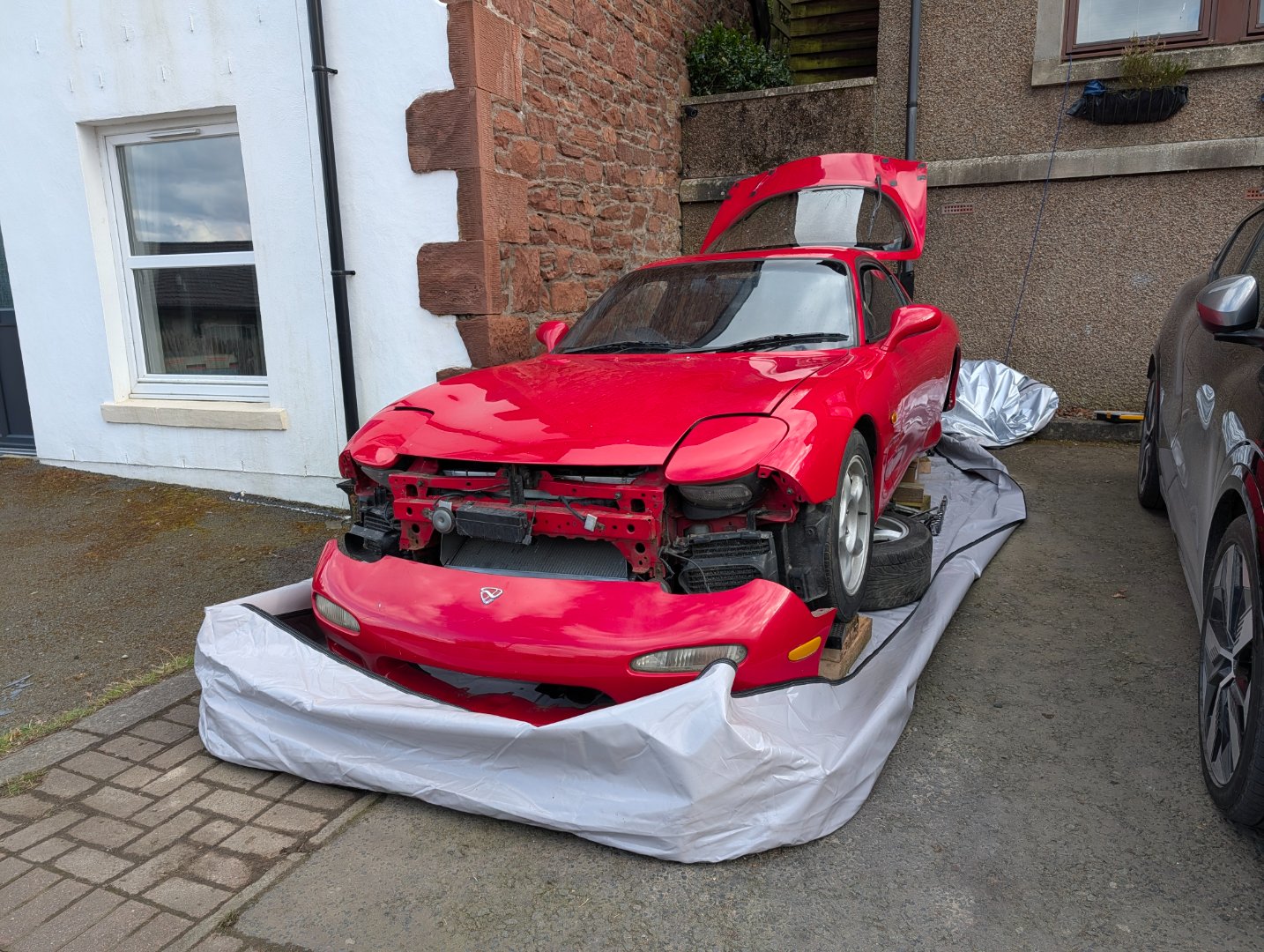

Here we are 2 weeks in
Literally pulling this apart in what limited space i have

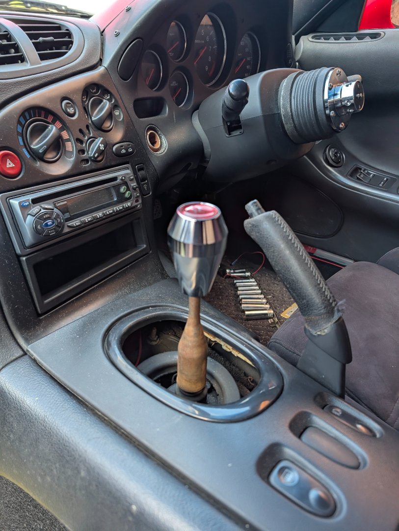

got most of the wiring ripped out along with defunct gauges and boost controller (might be going back in if this screen repair works)

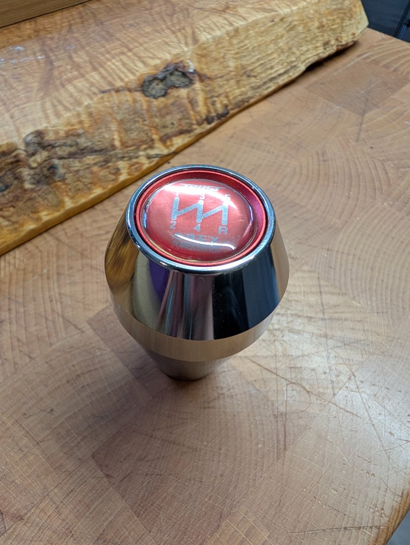

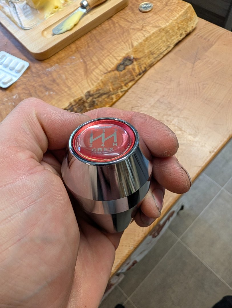

Who doesnt love a nice Knob

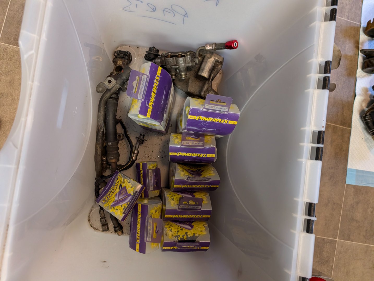

Got a box of goodies to fit underneath when i get chance

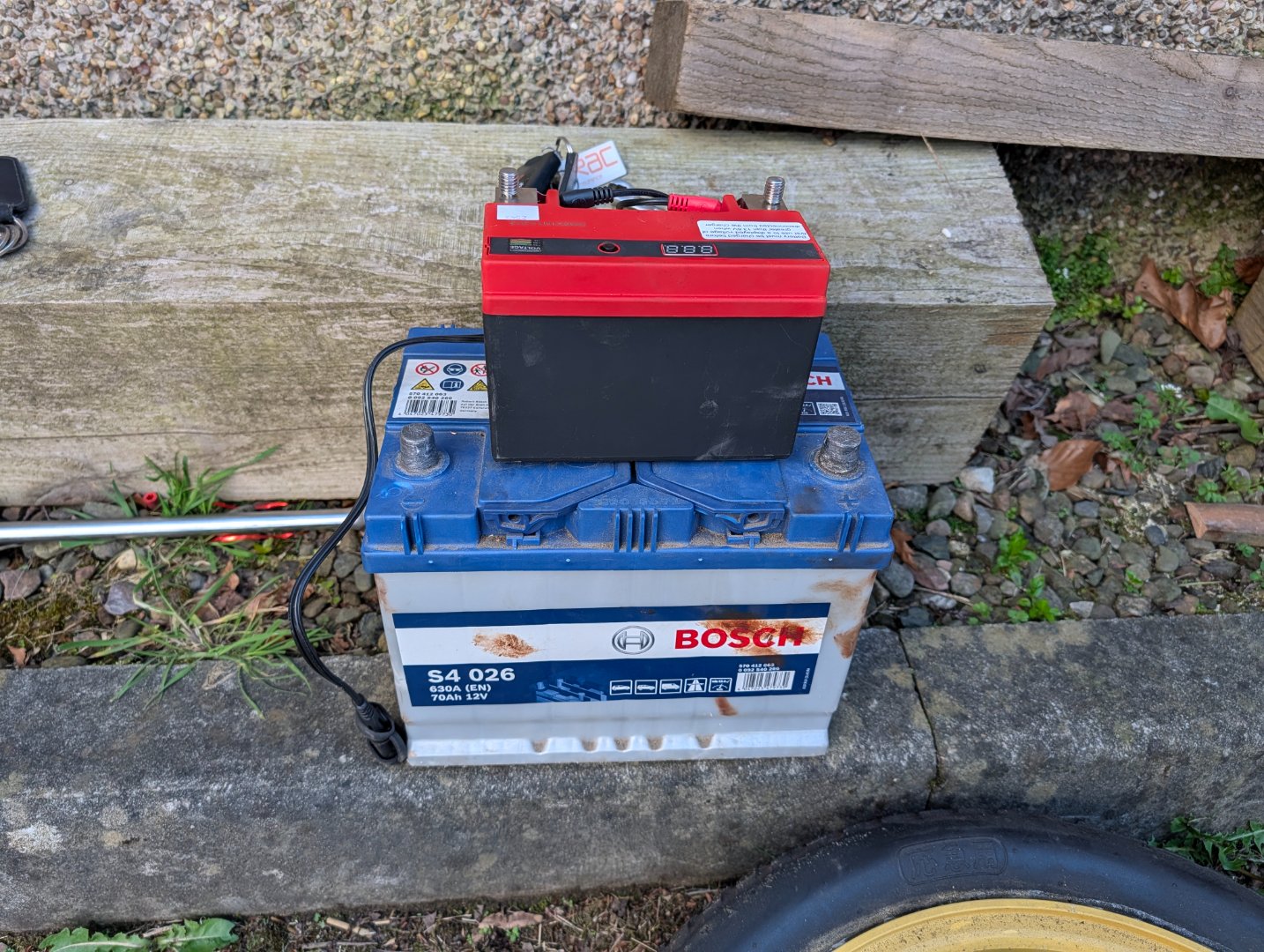

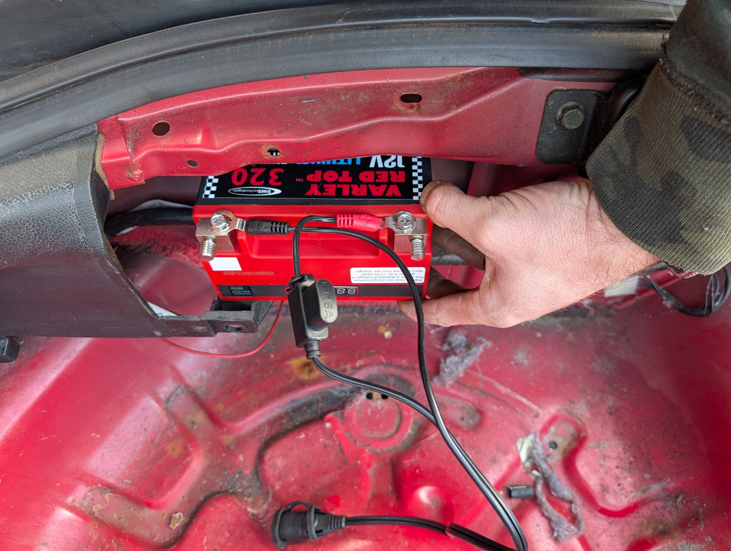

Got a new battery coming for it to go in next to the washer bottle at the rear going to get a bracket fabed up.

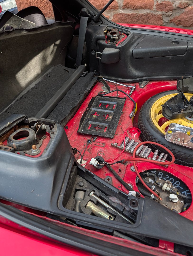

Soo done a bit yesterday not had much chance to get out with the absolute horrible weather we are having the now.

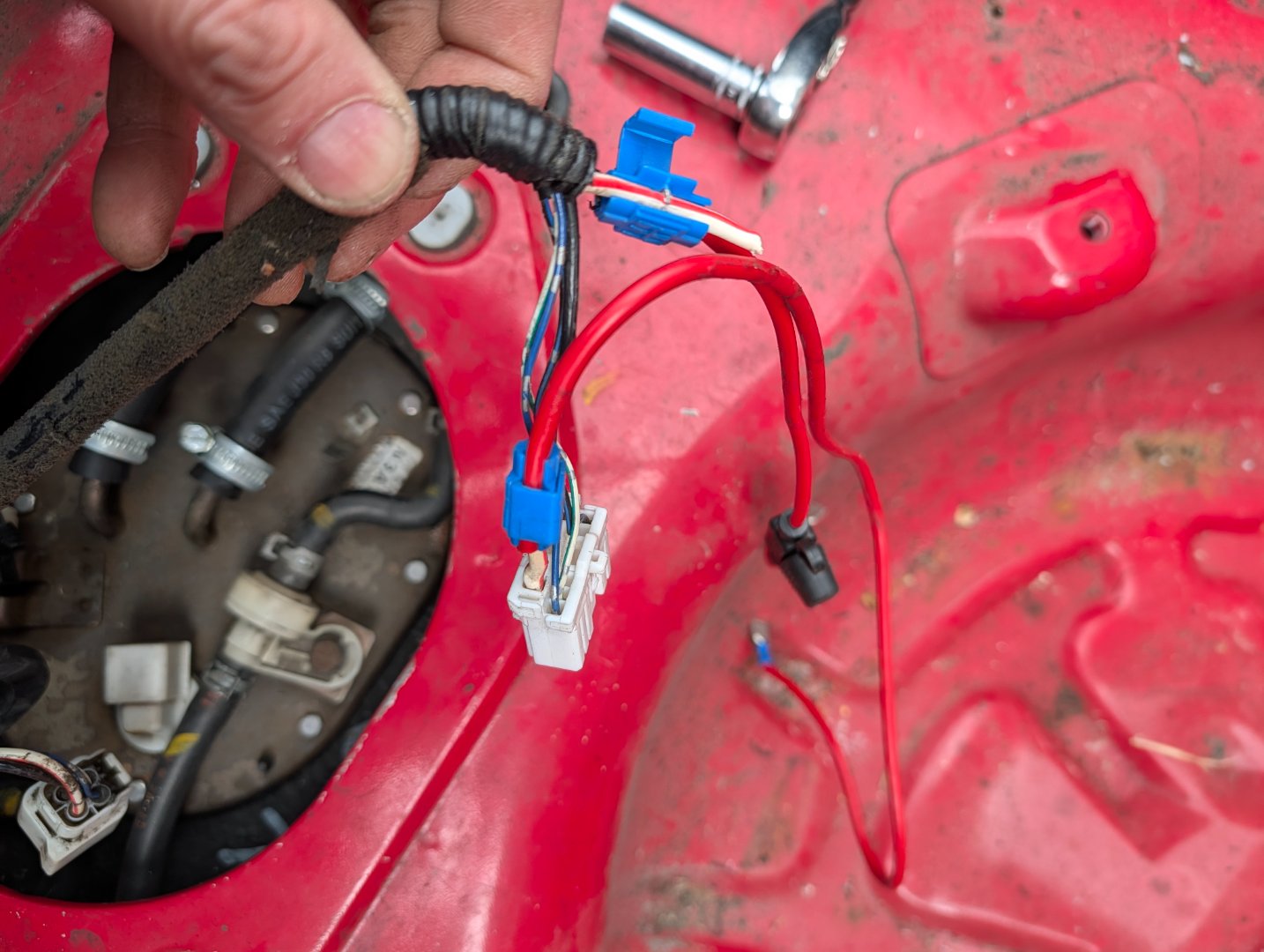

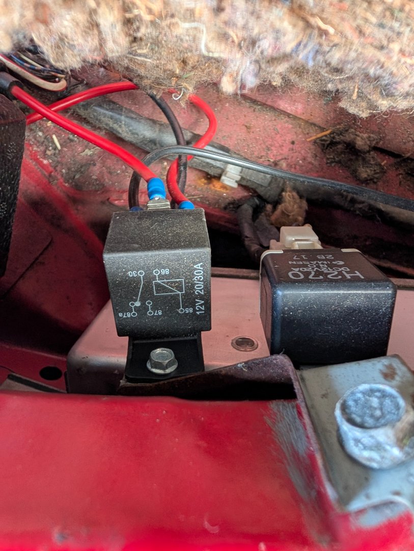

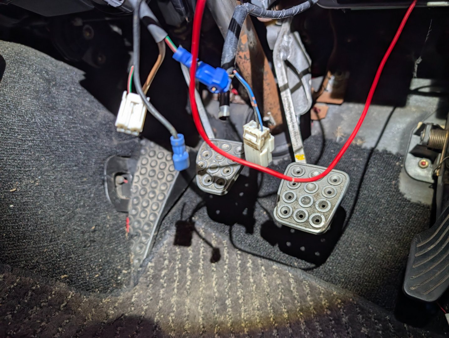

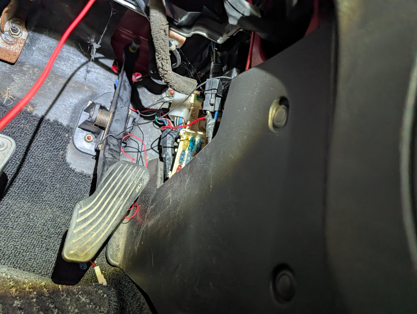

To rule out dodgy wiring I'm going through and returning most wiring back to stock as and where I can sooo that means all this fuel relay related stuff can go back to stock.
And whoever invented scotch locks needs shot cause they have no place especially here!!

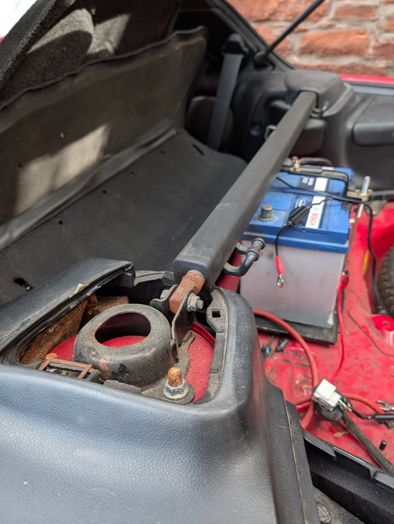

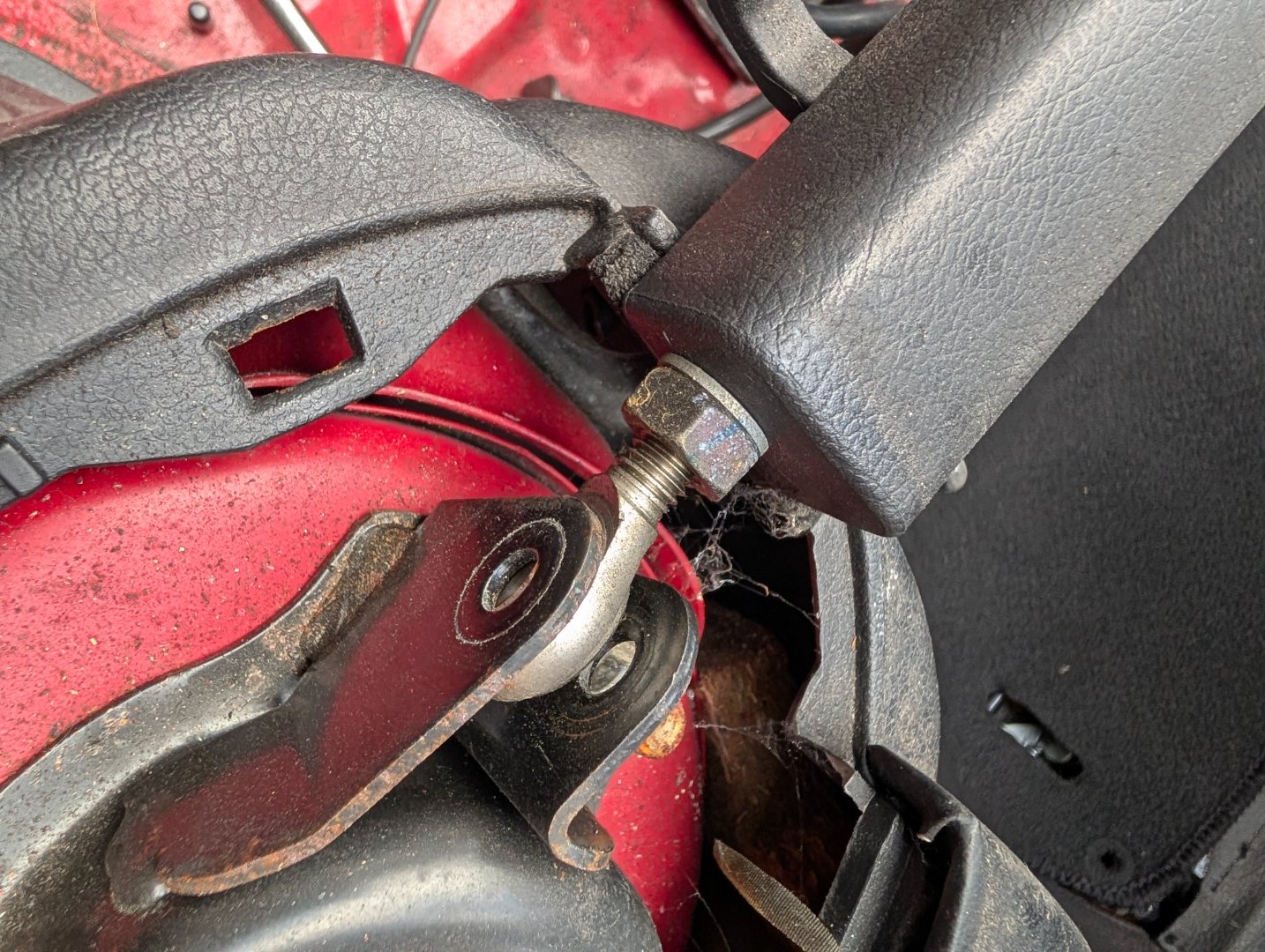

First car I've ever seen with a adjustable rear strut brace out the factory

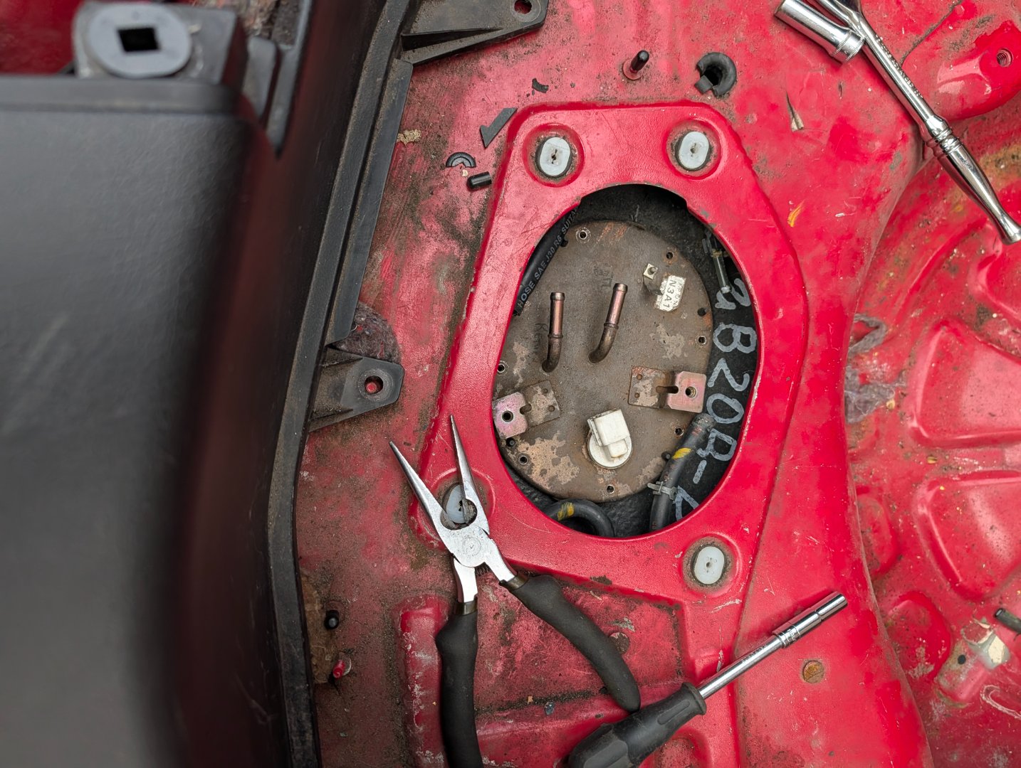

While I was there I pulled the remaining fuel out using the pump in the tank so I knew that was working then pulled the pump hanger to see the condition of the tank. It was clean never got a photo (dumbass).
Plus was getting ready to get this in its home and get rid of that dead weight (literally) for the red top.
Think here will be nice.

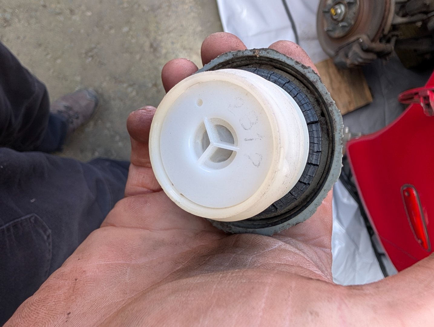

Also need a new fuel cap this is a bit funky and the release cable is stuck open aswell.
That's all for now folks.

Whilst the fuel wiring looks a mess. It is a recommended mod.
The old OEM wiring is routed funny all round the car and is known to drop voltage at your pump. Therefore direct wiring ensures you get good voltage at the pump itself.
You may find now you've removed it it will struggle to run.
You can put it back just much neater!
Yeah I'll probably do that I need to trace some wires anyway.
You got a link to the correct thread for doing it properly? Tia

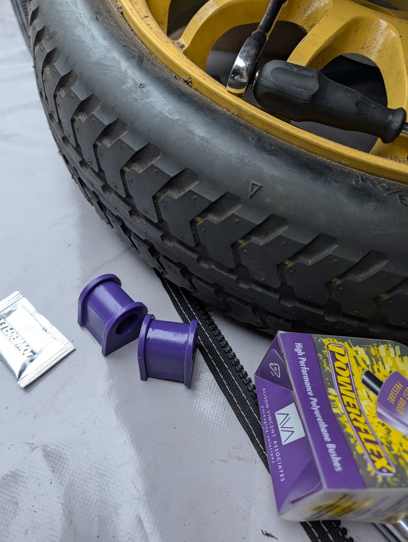

while i figure that out i made a start on the bushes on the rear
Ive got pretty much a full kit to do i also got one of the control arms done but didnt get a Photo

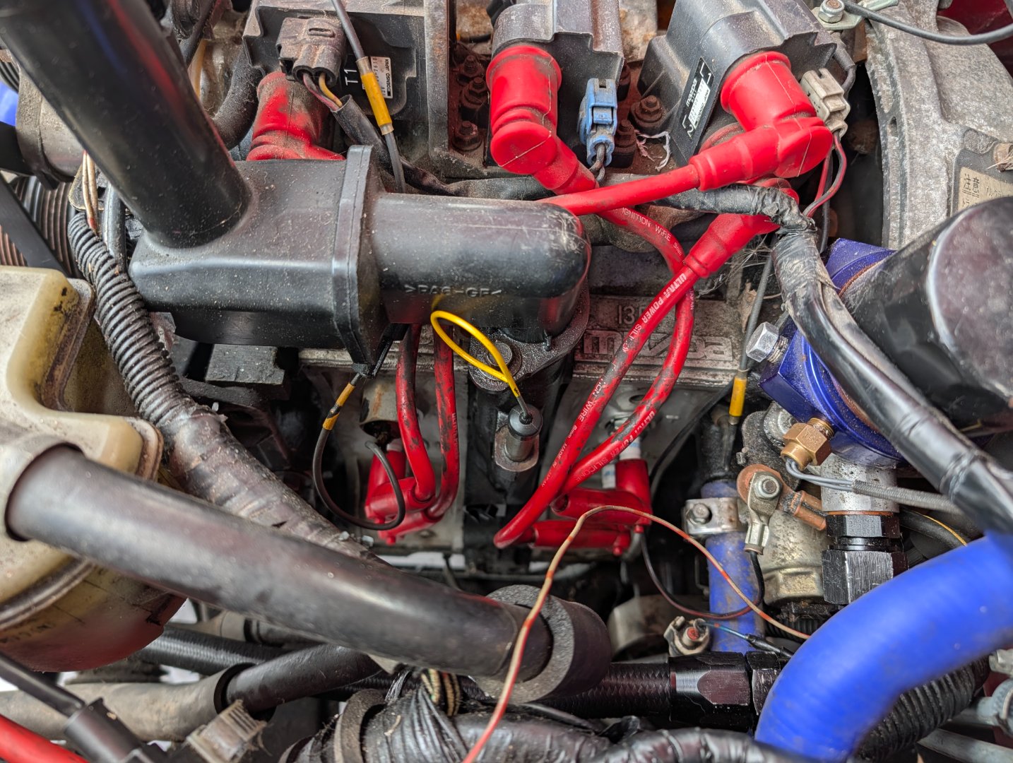

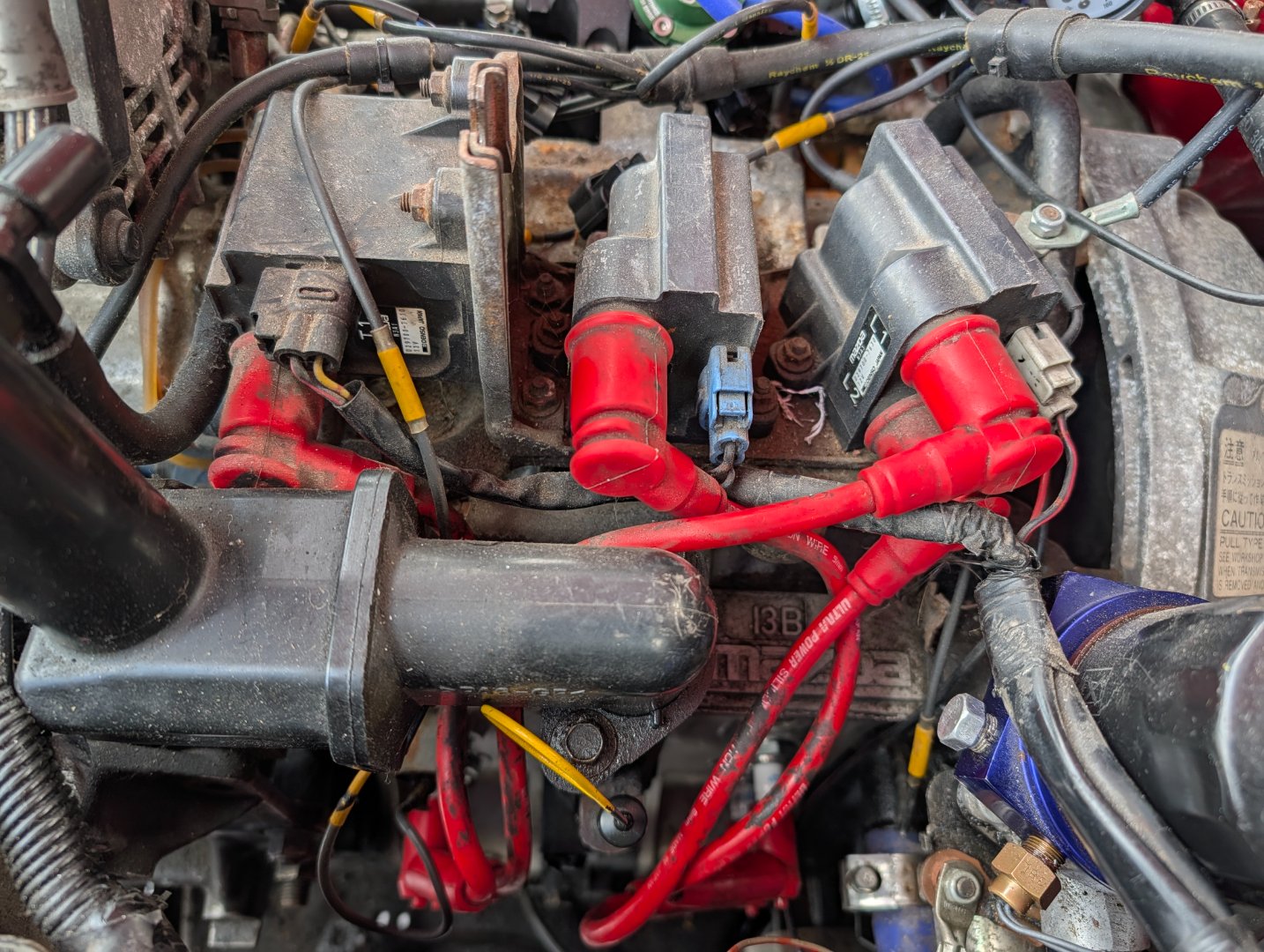

any advice would be amazing on getting this running
Sounds like ignition timing is out, check and clean the pick ups on the front of the engine

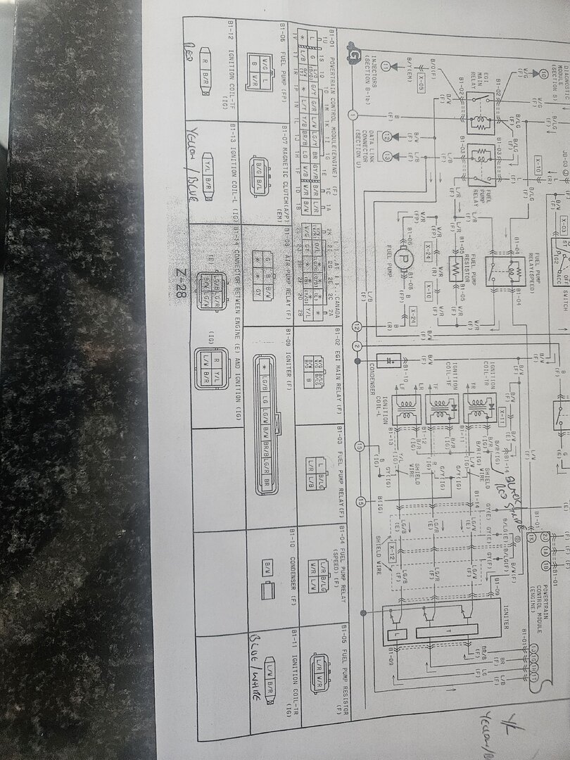

Have you checked the wiring to the coils? I'm not sure what model year this is but for a 94 the identifying wire colours are
leading = Y/L (yellow / blue stripe)
TF (T1) = R (red)
TR (T2) = L/W (blue / White stripe)
(they all have a Black with red stripe also)
Thanks Paul I think you have it looks like that harness is on backwards ill get that in the morning hopefully.
