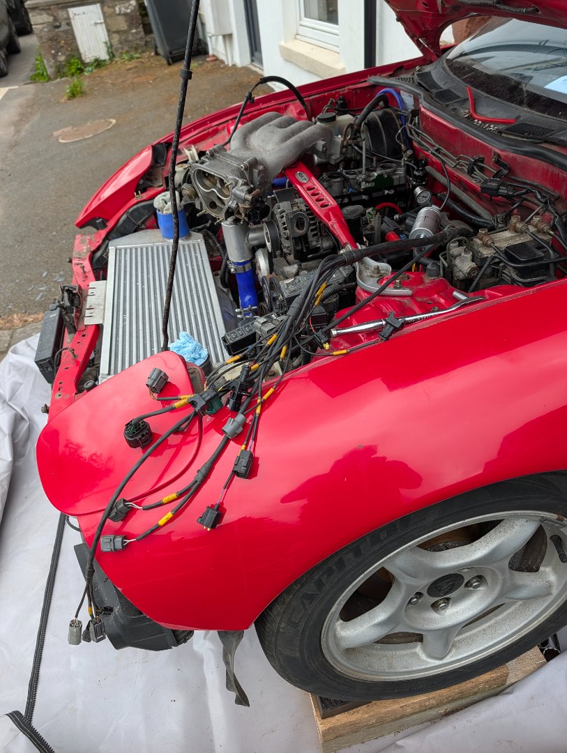

Here we go
What ECU are you running?
Also worth checking the impedence of the injectors they should be high impedence (if they are low then yoiu should have resistors fitted to the loom)

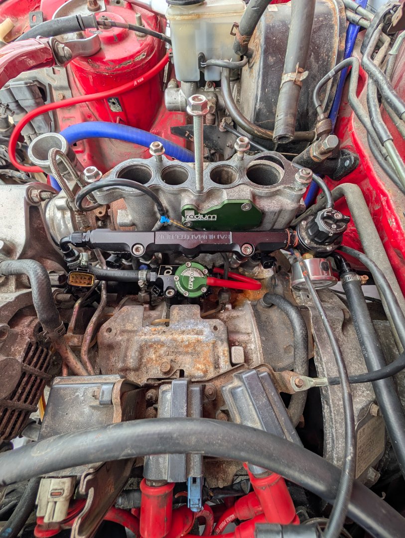

I'm guessing the fuel rails are Raduim or similar looking at the photos, can you read the static fuel pressure?
At the end of the day it's the same as any engine, do you have spark, fuel delivery, or are your flooded, pull the plugs, then move to does the engine have compression.
The big problem is it hasn't run in a long time, so why was it parked up? did it run when it was parked up, or has someone started something and not finished what they were doing.
I put mine away for 7 years, put a new battery on it, oiled the rota faces (spun it over by hand a few times to make sure the apex seals were oiled up and the chuffs sounded equal), and it started 2nd turn of the key, on the old fuel.
Radium upper and lower 42ish psi static fuel pressure.

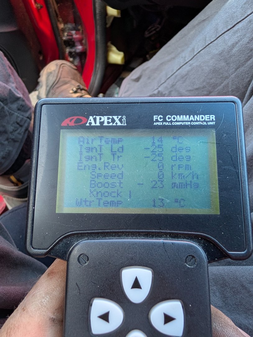

I checked on the commander it was scaled for 550 primary and 870 secondary but I didn't know if it was correct so pulled the fuel rails off.
Glad I did tho they weren't mounted correctly.
Seems to be a running theme with this car.
Pulled this off the commander last month
Googled the part number coming back as high impedance on the 1050cc ones the 1000s are the same so all good there.
Cheers Paul.
If you've got 1050s in the primaries and 550 programmed it will probably dump way to much fuel. Timing is also not split, should be about 15deg diff at idle.

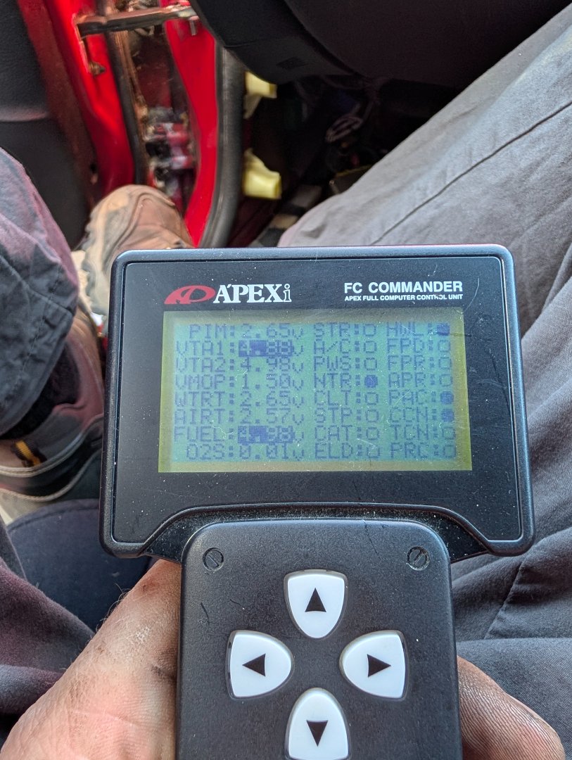

IIRC the blacked out readings mean its not happy with VTA1 and Fuel, like all things car it's just not happy with something it sees doesn't mean it's wrong. Gives you something to look into.
Personally I would consider resetting the ecu map and giving it new parameters for your setup, the ecu will build a "safe" map to get the car moving, just don't try to run under boost.
I'll dump the ECU once the cable comes and pick over it.

-5 & -20 ring a bell, but dont quote me on it. You're probably best to back up your map, if your map is set to 550 and 850 injectors I would reset back to base map and make the alterations as per what you now have fitted.
VTA1 is highlighted on that commander. I dont remember the ranges off the top of my head but they should be something like 0.5v 0% throttle and 4.8v 100% throttle. I would check your TPS is plugged in correctly.
Yeah TPS is plugged in correctly. I'll adjust it see if it moves.

Going to have to change the fuel lines come correct sized ones -8 feed -6 return and get some of the ORB fittings for the fuel rails. Need to put a proper filter in just threw a generic one in the now as it didn't have one on it.

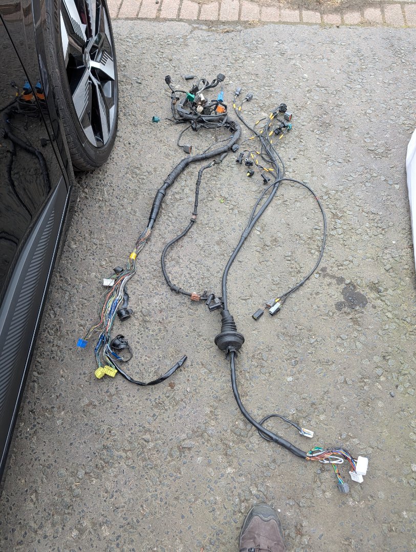

Pull the Rywire tucked harness out to put a salvaged firewall grommet on and also look at adding in a fuel temp sensor since there is a pair of spare wires already in the loom and the ECU has an input for it.
One thing I did notice on the Rywire is there are 2 plugs left not connected one which has "FAN" I suppose that's probably the old AC maybe. And one that says "BOOST" but that's not for the sensor on the firewall as that's already plugged into a different part of the harness and had 3 wires.

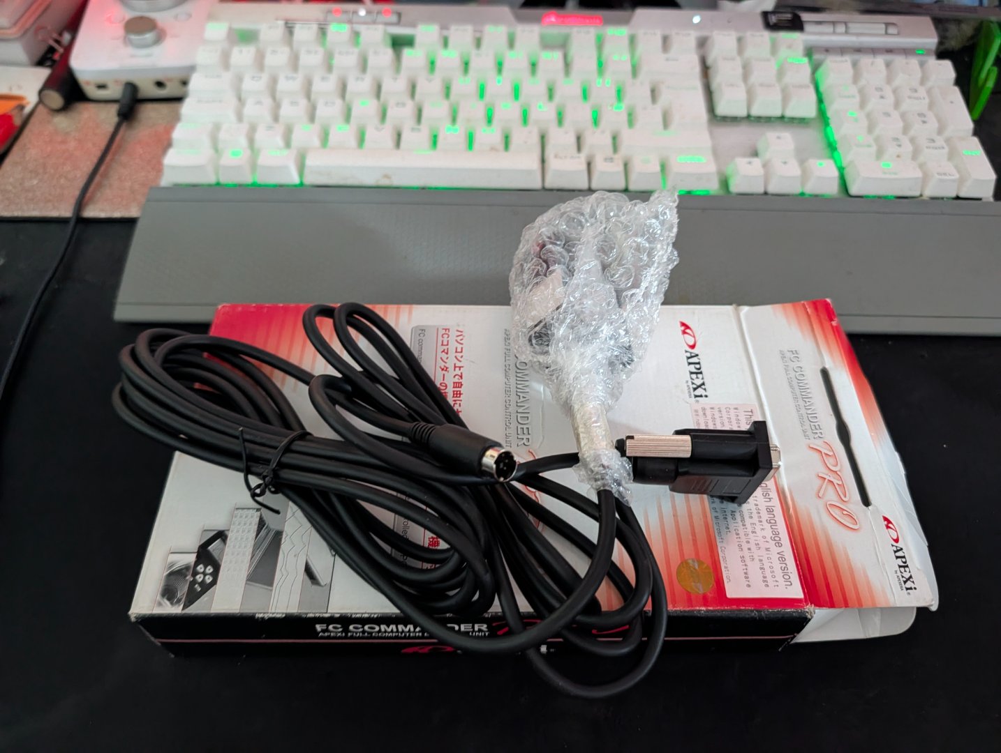

Soo got the cable for the ECU and looked into the settings
I can't see anything for base timing or anything so that might just be -25deg for a reference till it cranks then gains a reference. I'll need to read up on how the system works.

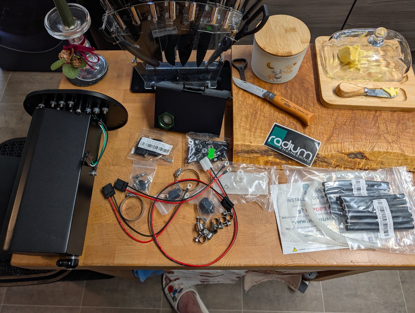

This is probably over kill ATM but the price was good and hard to let go 😂
Gotta love the quality of the radium stuff it's soo good.
As for the TPS issue I'm gonna have to pull it off see if it's correct and correctly mounted. From what I've read as well these are very specific to the FD and obscenely expensive to replace for what they are 🤣
