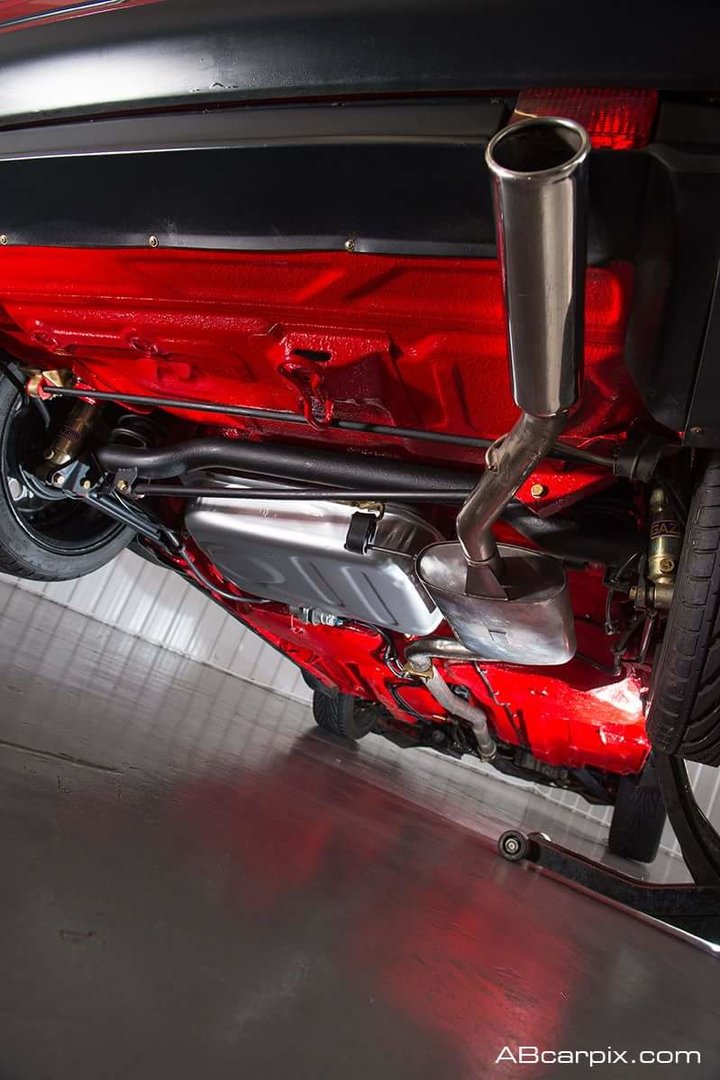

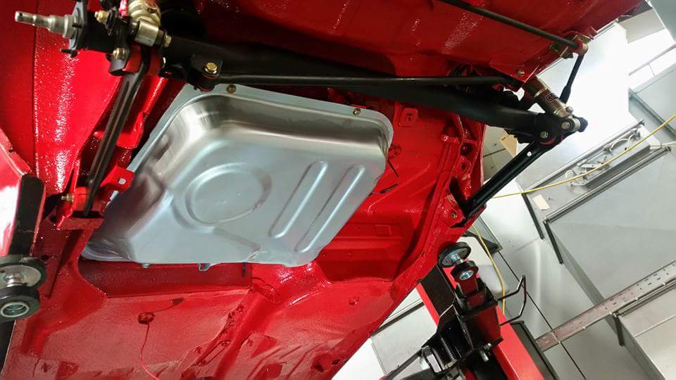

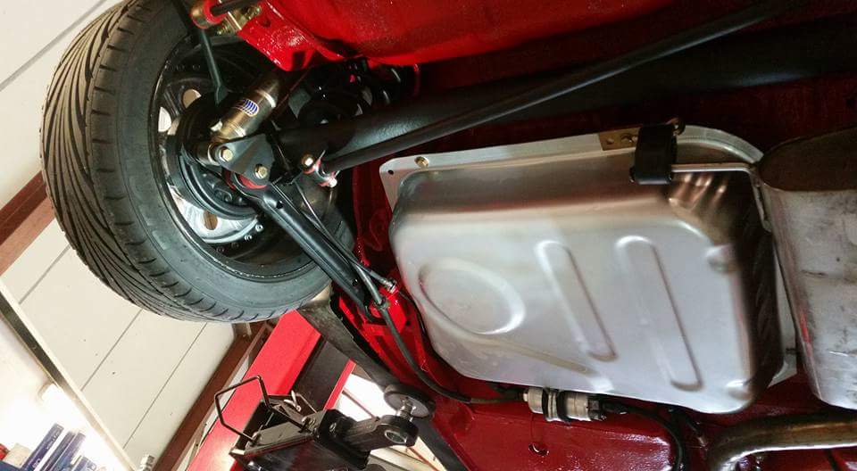

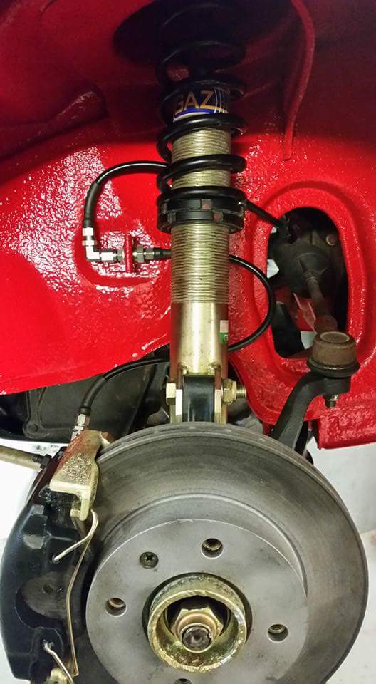

My XR2 is fully restored. I had mine done in 3 weeks by torques performance in south wales.

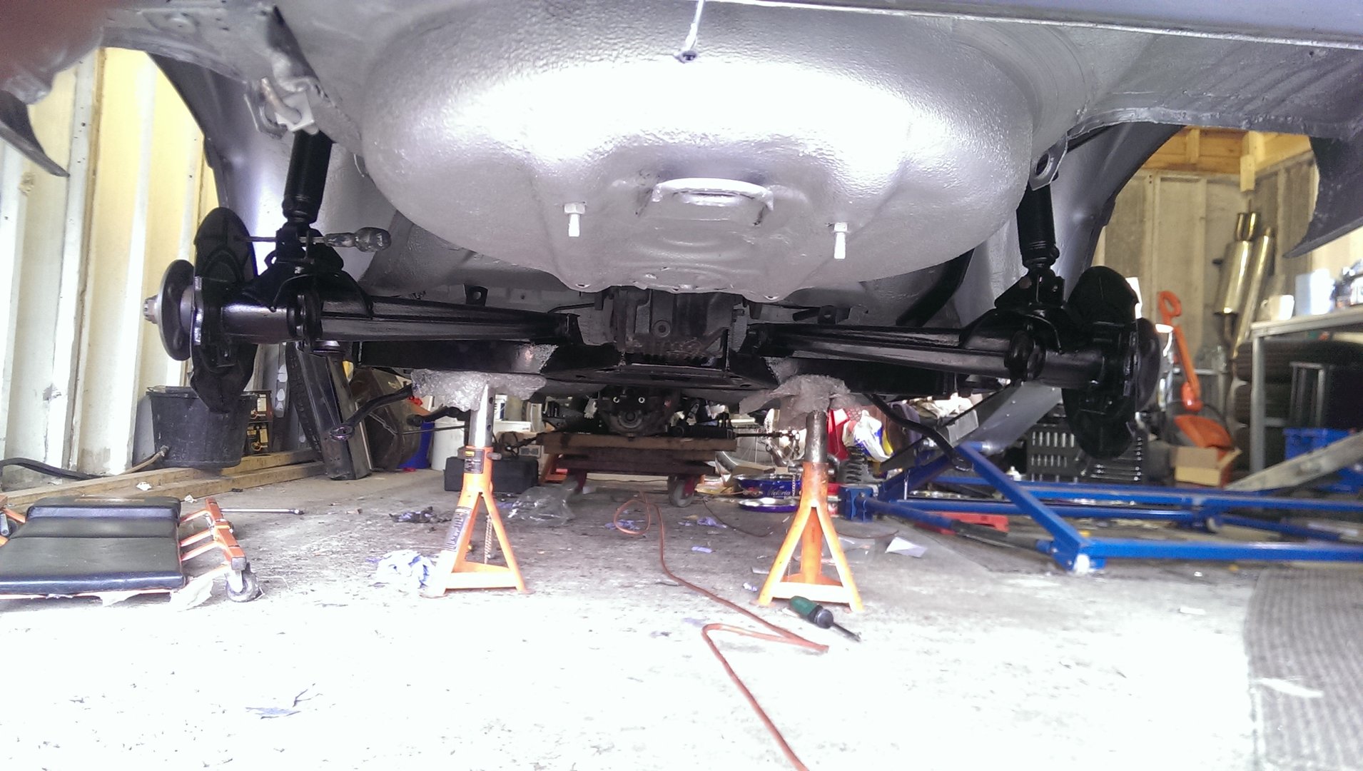

This BMW I built some years ago. Got mag feature and like Dean, I totally redid it underneath too. You think no one will see it so what's the point then you at a show and you spot someone doing this.
That's some work in 3 weeks. I guess they had it on a spit? which I know is not the technical term
They actually did it on a 2 post lift with engine in place. The bay was pretty good to start with so i didnt get it done as i would have a colour issue with the body and it matching if did (long story but my car was painted too pink so i cant paint panels the correct colour that touch other panels without getting the whole car redone).
3 weeks start to finish as they only work on 1 car at a time and do their own zinc and blasting. A fiesta is faily simple though aswell

Nas, they took the body kit off, did the underside and wheel arches to bare metal, then painted and rezinced everything and put it back together in 3 weeks. The bay wasn't painted and the motor didn't need to come out. Also the car didnt need any welding so that helped a lot
