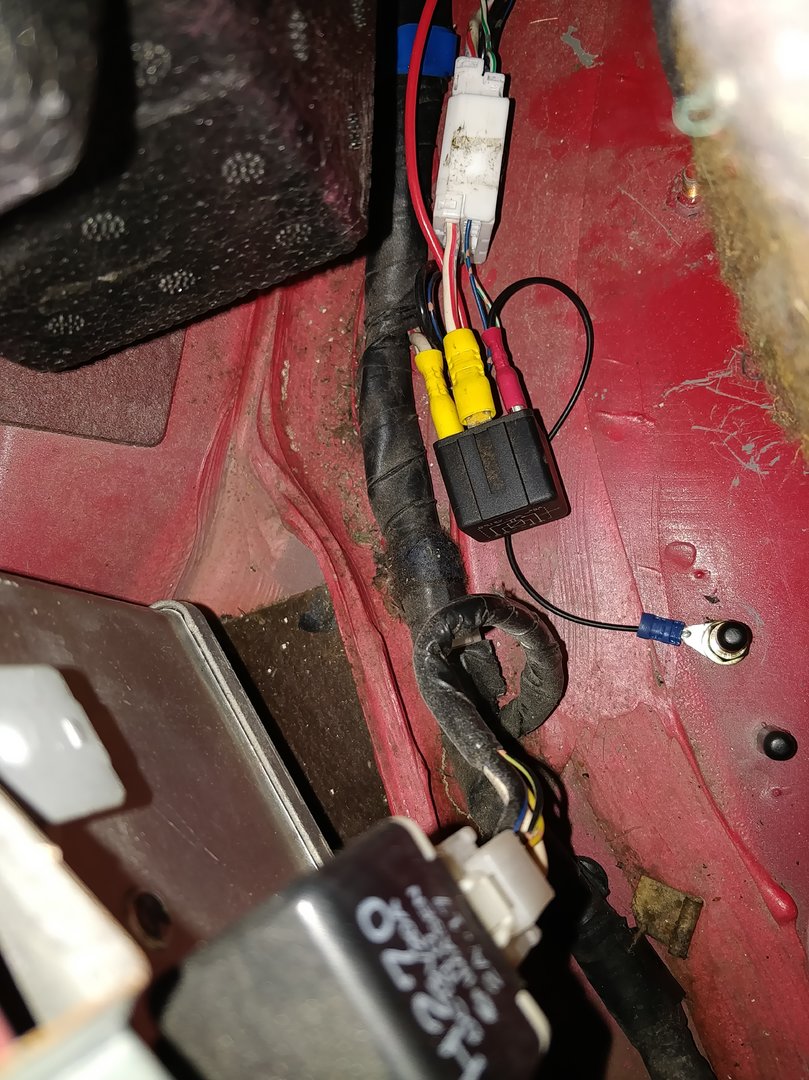

Also looks like someone has rewired the pump somewhere along the line
