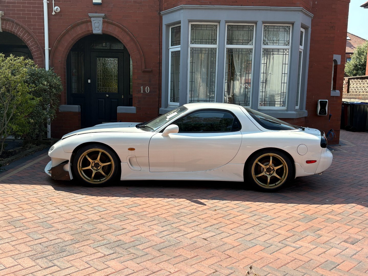

Hi all,
Thought I’d introduce myself - Dan up in Blackpool.
I won my FD in a competition raffle thing in Aus - lucky boy! Shipped from Japan to me and now sat on the driveway. When it arrived I think I was a bit disappointed by the condition; very rough round the edges. Not helped by having built it up so much in my head over the past few months… but I think a lot of the imperfections and issues are to be expected with the age of these and the general aura around the cars and modifications they lend themselves to. Plus I’ve been spoiled by company cars and good grade vehicles from Japan over the years.
I’ve been having a bit of a wobble the past few days putting it up for sale and then not, then for sale again…. But decided I’m going to keep it and make it mine/sort the niggles. I’ll probably never get the chance again, so may as well make this count. Having owned a couple of RX8s in my late teens and twenties, this feels like the real deal.
First and foremost. It. Won’t. Start. So very close to firing up today. Assumed it was the battery, so bought a new one, still didn’t start. So going to borrow a battery charger and charge the one it came with, as I was reliably informed it ran getting on and off the boat; and rightly it wouldn’t have been allowed to sail on the RORO. I suspect it’s not been run enough and may have taken on too much fuel. So I have some reading and fiddling to do just to get it moving.
I’m going to apologise in advance for being a pest and needing total reassurance at every step.
Anyway, hello and thanks for having me!

Well, many months later after new plugs and clearing that flood, it is running. A few other jobs sorted with her MOT booked in on Monday next week. Swapped wheels that were too big and sticking far too far out the arches - found some strips of rubber up in there when I was poking around. Rear fog done, lights/lamps swapped and working (still need to swap both main beam lamps as one is not working, doing the pair for), and got a battery holder clamp thing to fit. Should hopefully let me give it a quick run out to the booked MOT, via a bit of a detour to give it a quick blast on a bit of a more open road.
Not going to lie, given the amount of time its been sat I'm dreading it... but equally excited to hopefully get one step closer to registration. Just wish I had more time to get it to this stage and it not take 8 months!! Such is modern life.
Get these last bits out the way, then get on top of other maintenance bits/schedule stuff in so I know what I'm doing to give it the best chance of not going pop! Just can't wait to get it moving!
Well, was all going so well with a pre-MOT/checks that I asked for just before the MOT and then got the call that "there is no way it will pass emissions". Did speak to them about booking in another day and trying to get everything hot after a drive and going straight into the test but feel like they wanted to wash their hands of it, so didn’t. The rest was encouraging, I.e. said it was all good otherwise. So, I’m equally optimistic.
