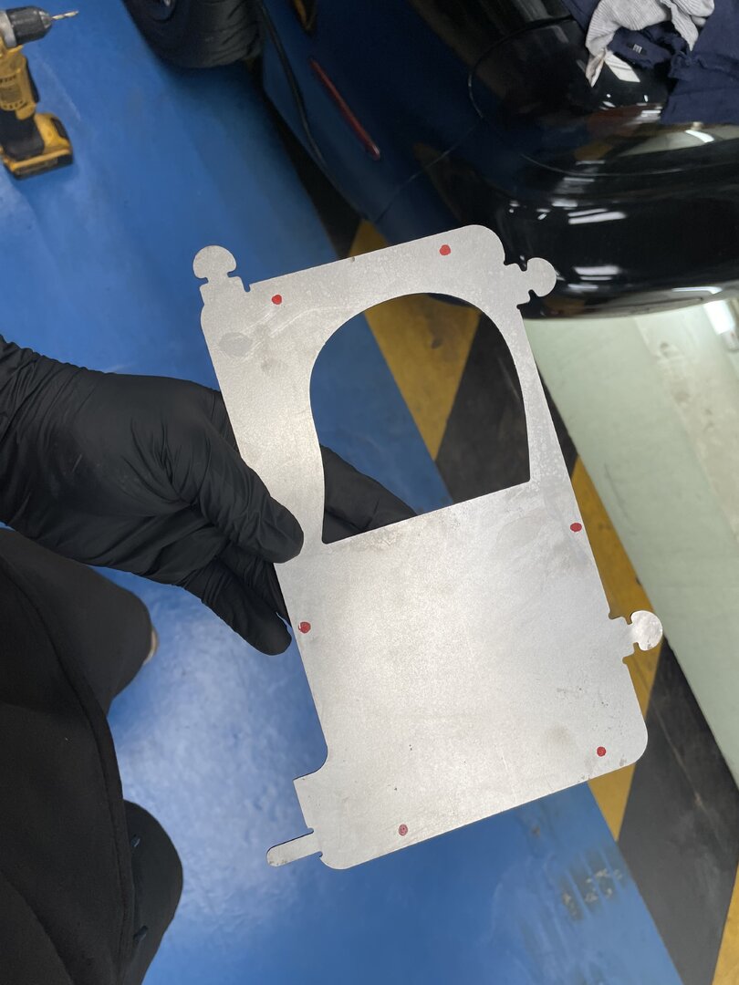

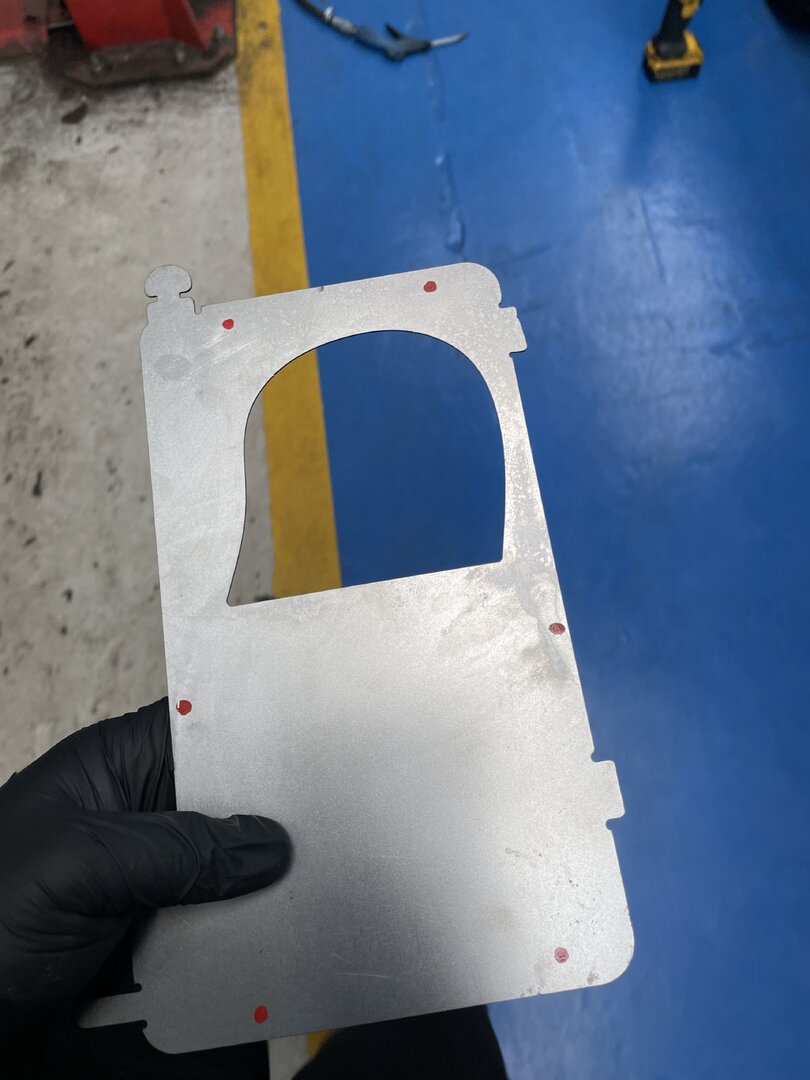

Ferrox117 Well-known member Joined May 7, 2022 Messages 602 Sep 3, 2024 #341 Here we have the baffle plate kindly supplied from Stu, make sure you figure out which way round it should go haha!

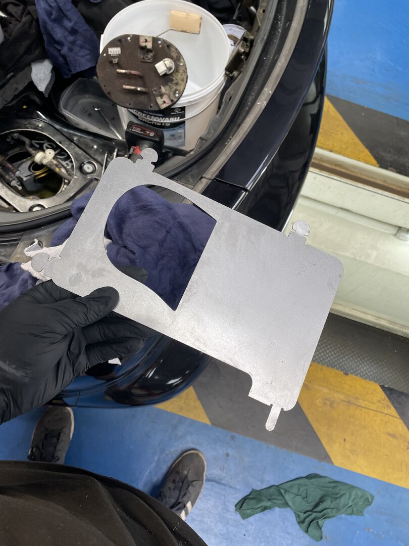

Ferrox117 Well-known member Joined May 7, 2022 Messages 602 Sep 3, 2024 #342 Due to this car be one of the early early first 7s around it has the original fuel tank cradle so not the same as the later cradles- it usually slots in rather than what I’m going to have to do
Ferrox117 Well-known member Joined May 7, 2022 Messages 602 Sep 3, 2024 #343 so I’ve had to mark out where the holes are going for the cable ties haha! I’ll have to drill out holes and then tie it in

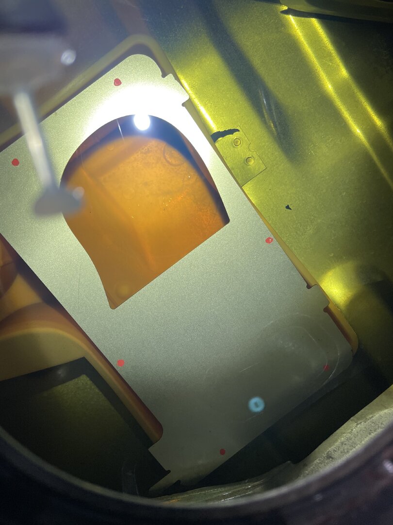

Ferrox117 Well-known member Joined May 7, 2022 Messages 602 Sep 3, 2024 #344 Cut off the extra bits that stop it from going into the hole
Ferrox117 Well-known member Joined May 7, 2022 Messages 602 Sep 3, 2024 #345 Checking where it sits haha looks like it’ll be fine! Make sure you clean it off before putting it in the tank
