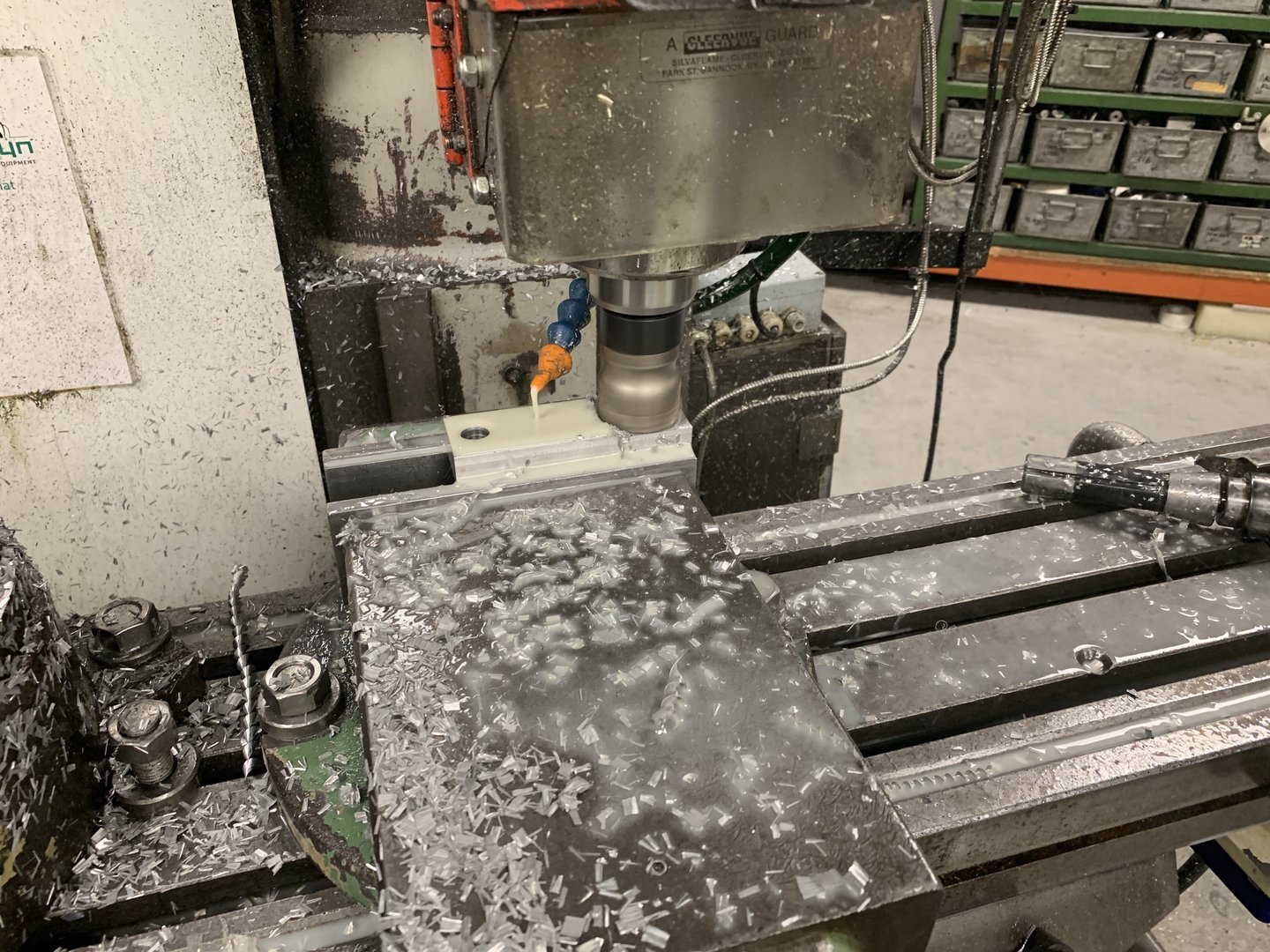

Had a chance to offer up the plate today pretty happy it fits
Gave it a lick of crackle black and it’s finished
Just need to get some time to set it up

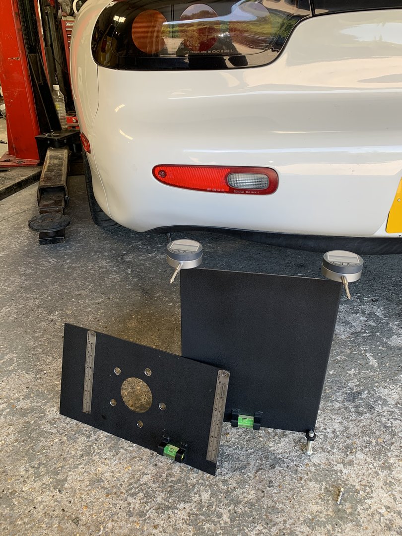

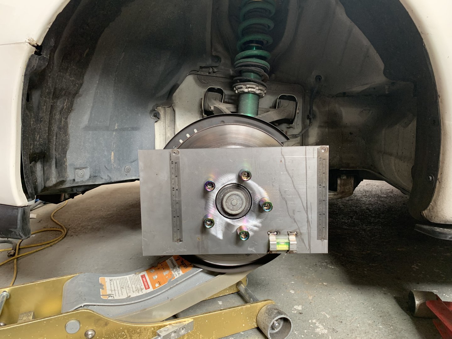

I need to get my head around bump steer still. It looks pretty simple but I've just spent 20 mins staring at diagrams and it still hasn't clicked how it works out! Tbf though, you've saved yourself a wedge on building that gauge ellz 👌
If the instant centre doesn't line in, what do you adjust? The track rods so they line through the top and bottom arms is it?

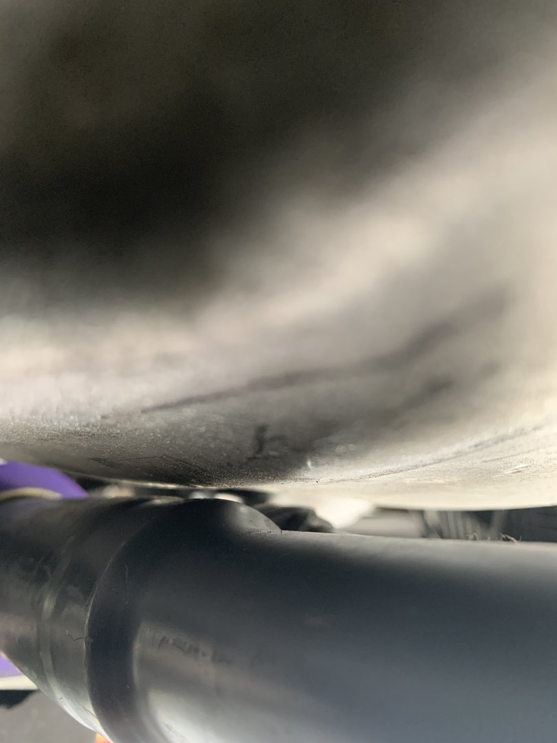

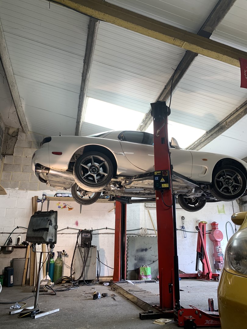

So using the bump steer gauge I tried to dial it out and found that I couldn’t with 17” wheels so made some rack spacers to lift the rack as high as possible managed to get 16mm without hitting the sump

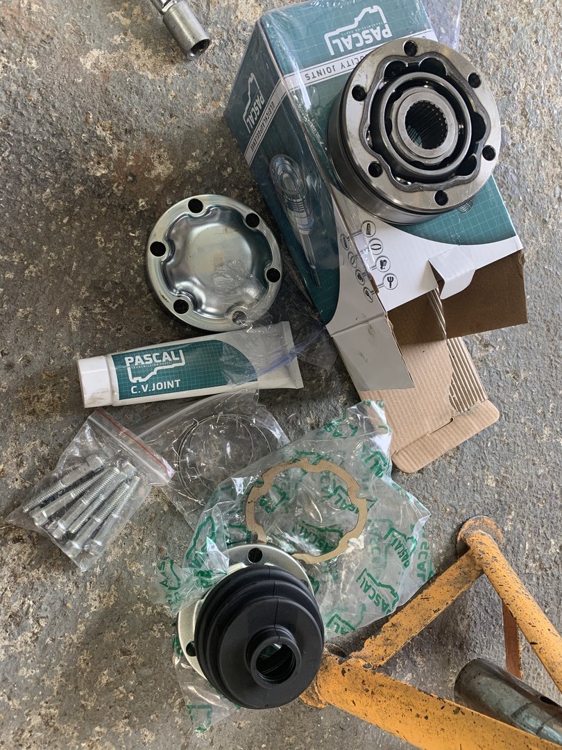

also got some new inner cv’s too which were and absolute cunt the holes were 8mm for my m10 bolts
Gave up in the end
CV grease is horrendous
Ended my CV joint nightmare today by drilling the holes out to 11mm ideally I’d have drilled them to 10.2 but I couldn’t buy one in Homebase

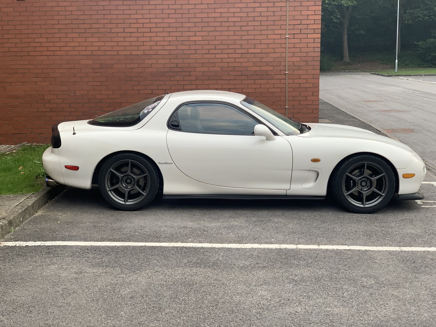

Had the rx7 two years today it’s flown by
Lots of pain and suffering
took the car out for a nice longdrive the other day had no issues miles per gallon are bad but not too bad enjoying the car though and getting more confidence with it day by day

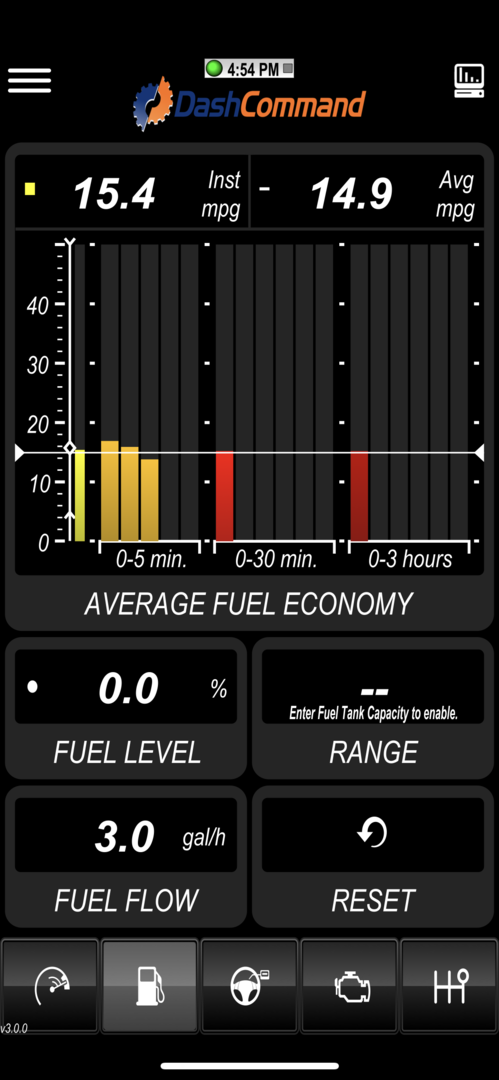

Fuel economy isn’t as bad as the obd2 reader suggests returning around 21-22 mpg on a combined cycle
