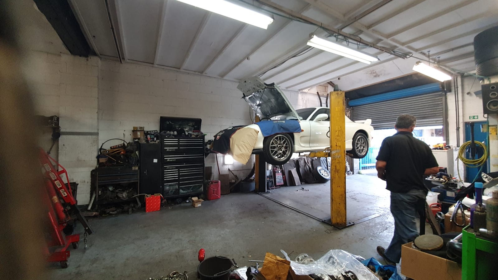

Dropped off my car at

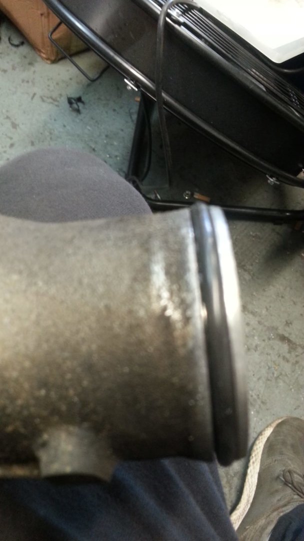

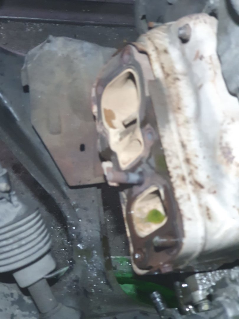

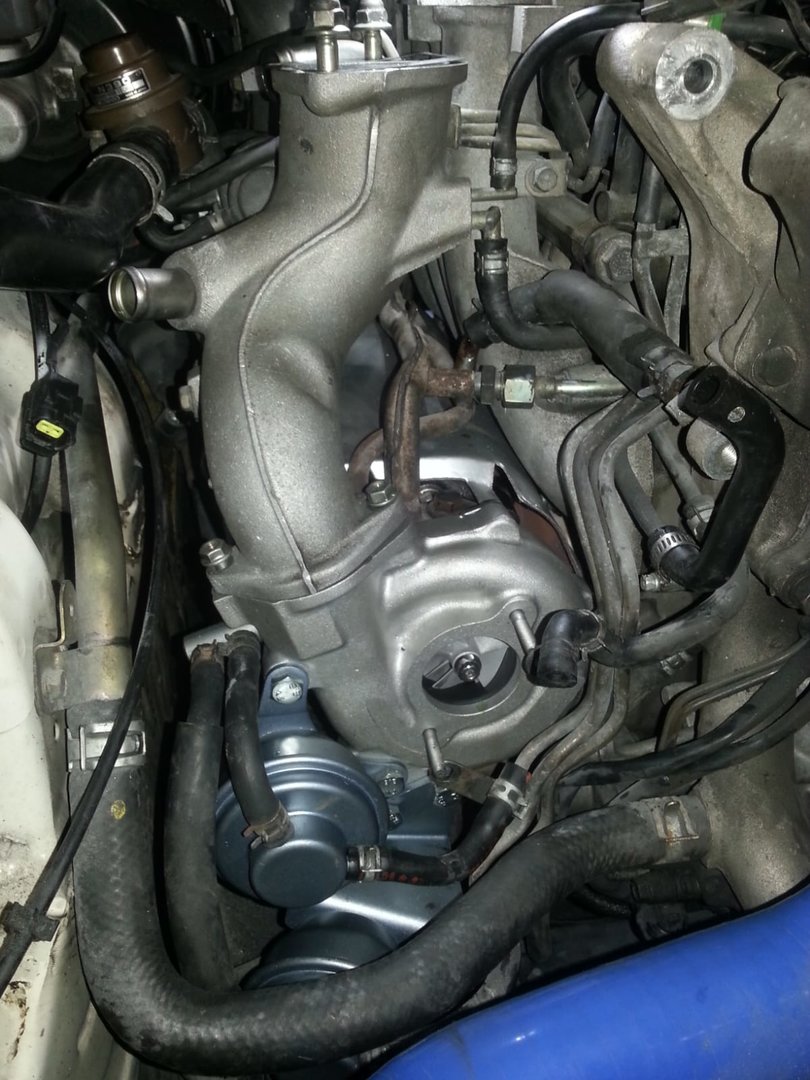

@Stu Rotortorque shop about a week ago for some work. I have been running on a good used set of early spec twins since 2015 when my 99s on my car started chucking oil. I kept my 99s but the manifold was in pretty bad shape so it took me until earlier this year to find another set that needed a rebuild, but one that had a nearly flawless manifold minus one crack. I bought that set and then had both sets of twins sent off to Midland Turbo and told them to rebuild the best set out of the two sets.

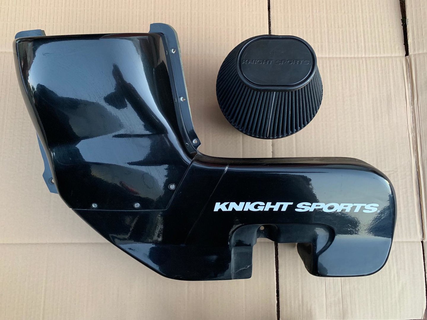

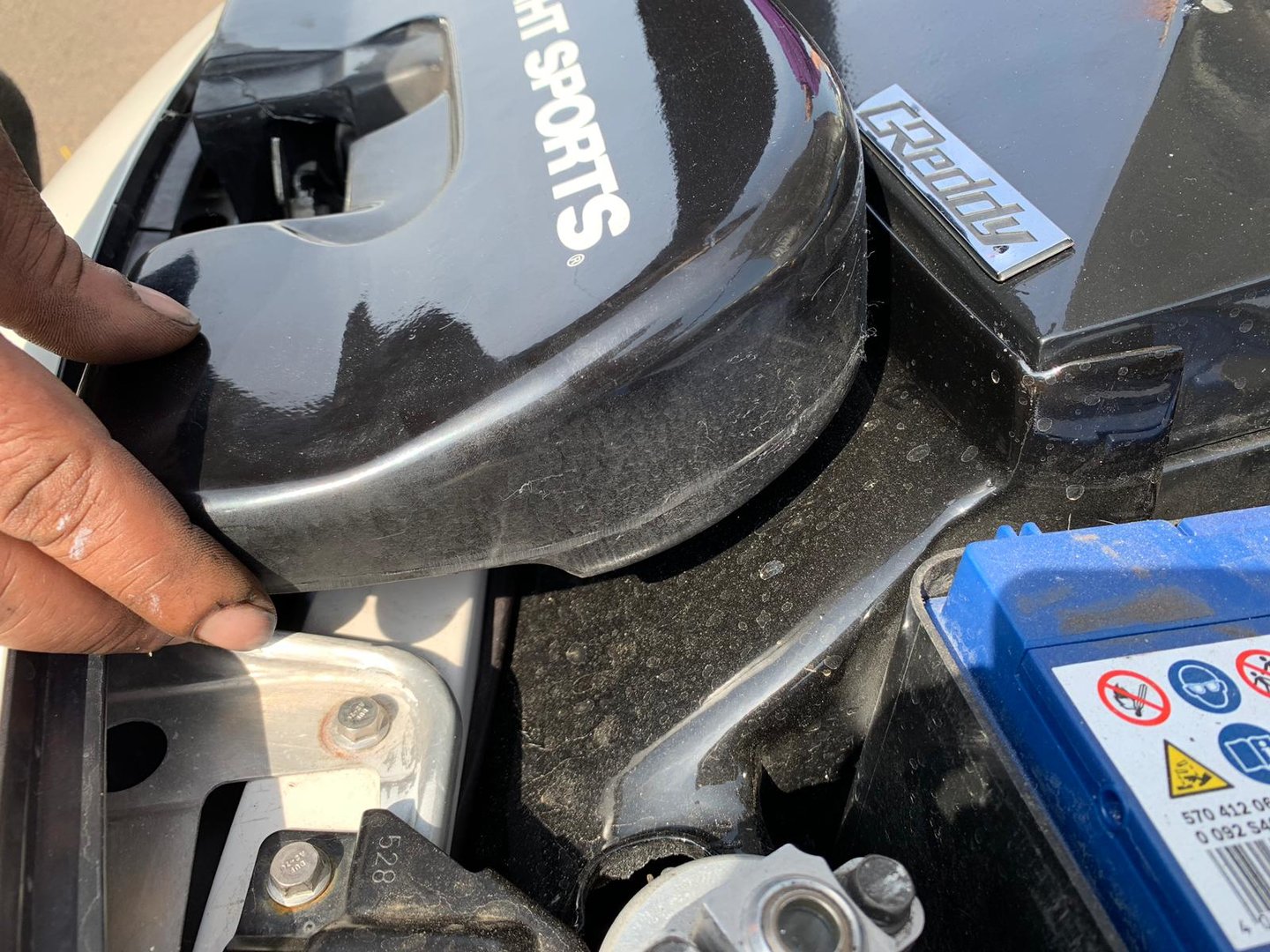

Anyway, the new twins are now on the car, and all we are waiting for is my custom intake to be completed out of carbon fibre which is designed to look similar to a Knight Sports or Auto Exe unit, but fit perfectly around the Greddy SMIC. Following that, the car will be mapped and I'll have it ready for the 5th September Snetterton track day.

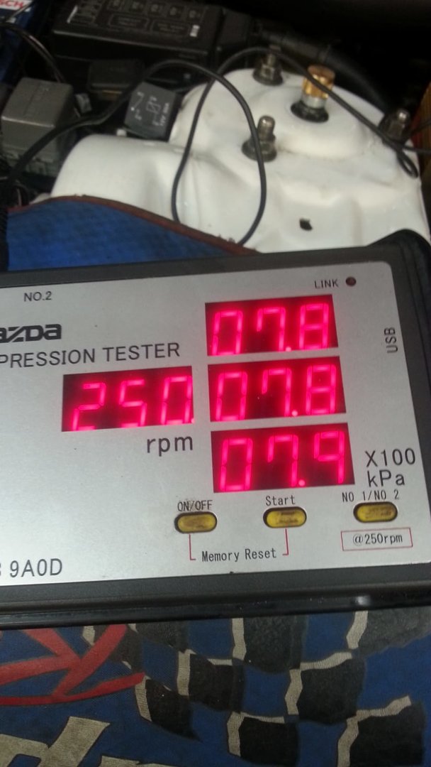

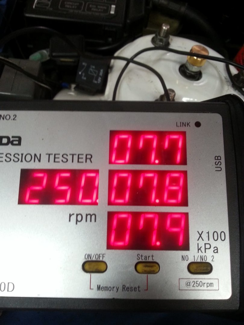

I also had Stu and Jay compression test the motor to confirm all was good as it has been 22 months and c.7,000 miles since they last tested it, of which it was on a Jaydee map and being thrashed around circuits and being subjected to tons of heatsoak and all the rest from street driving in summer with a factory bonnet and stock location intercooler! Also, I have been driving around on the same motor for 17,000 miles over the last 4 years (no idea when it was rebuilt in Japan either or if it even has been) and wanted to see at what rate the engine was wearing out.
Well, I was very surprised by my results as they actually improved from 22 months ago and are in some ways on par or better than when I originally bought the car and had it tested at the time of purchase by Hayward Rotary in 2015.
When I first got the car in April 2015 it tested as follows. This was the day after purchasing the car and it was running on the stock ECU.
Front rotor: 7.7, 7.6, 7.6
Rear rotor: 8.0, 8.0, 8.0
About 10,000 miles and 2.5 years later in October 2017 I took the car to Stu and Jay for a remap and some work and it tested as follows. At this point in time it had been running on a Hayward Rotary map and I had also done 4 track days on a stock intercooler and 0.8 bar of boost.
Front rotor: 7.4, 7.5, 7.5
Rear rotor: 7.7, 7.7, 7.8
Last week, another 7,000 miles and 22 months later. Jaydee map with current modifications, a couple more track days, dyno runs, and way more driving around for errands to Tesco and B&Q after moving out of Central London.
Front rotor: 7.7, 7.8, 7.9
Rear rotor: 7.8, 7.8, 7.9

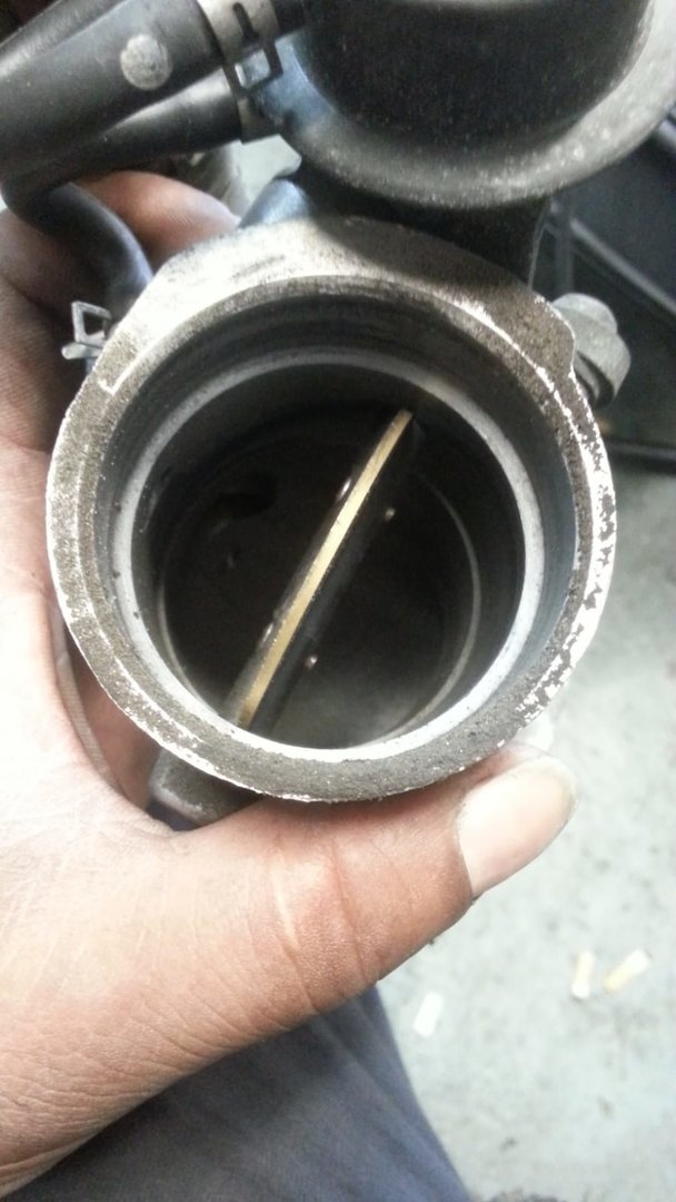

Turbos were starting to blow oil
Fresh 99s on the car! Can't wait!
Taking extra care not to scratch the paint
