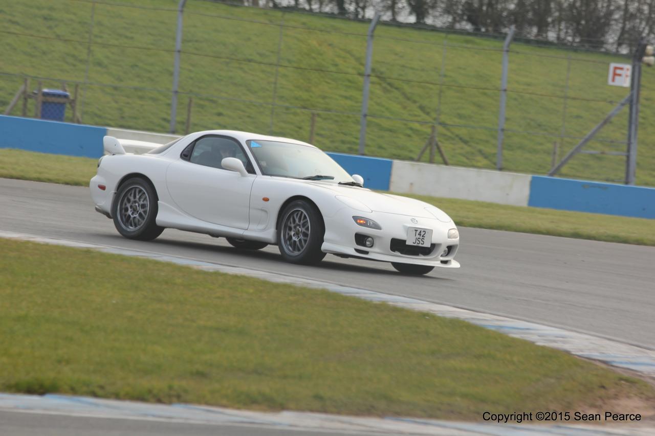

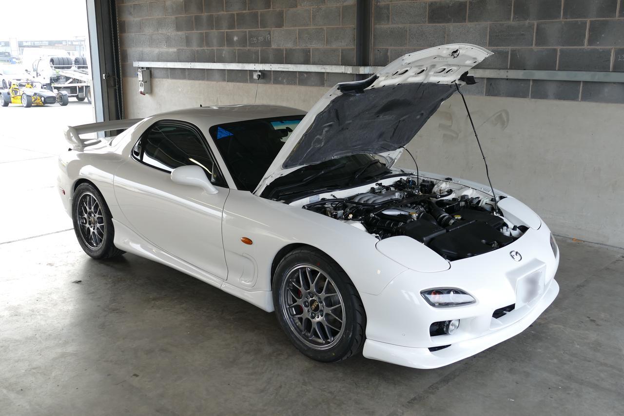

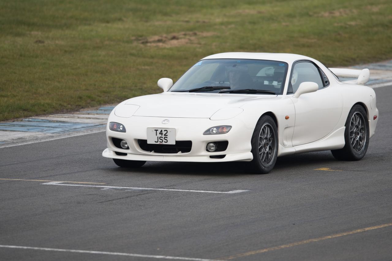

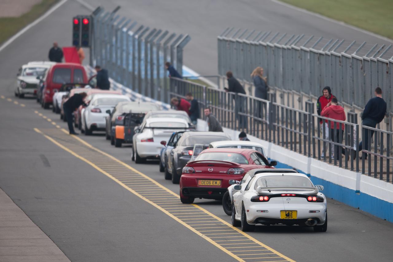

On Saturday, 12th March, I completed my first track day in the RX-7 and at the challenging Donington circuit. I had been waiting for this day for ages and it was good to finally be in a position to track the car and get to know more about its higher end limits. I will admit however, that I was seriously scared of driving this car quickly given it's lack of traction control since I'm not the most confident driver and Donington seemed like a challenging track with a lot of high speed corners and elevation changes from what I could gather on Youtube.
Anyway, I started the day at the Hilton Hotel in Leicester where I stayed the night before so I wouldn't have to get up at like 4am and drive from London.

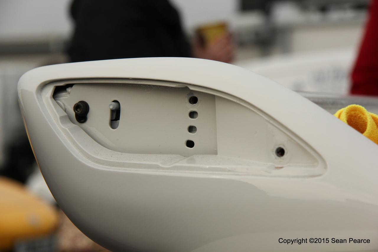

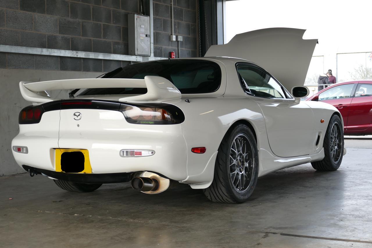

After the driver's briefing and sighting laps I set to configuring the car for more downforce by adjusting the rear spoiler to the 3rd notch (of 4). As you can see by the dirt on the wing it actually does seem to be working during normal driving!

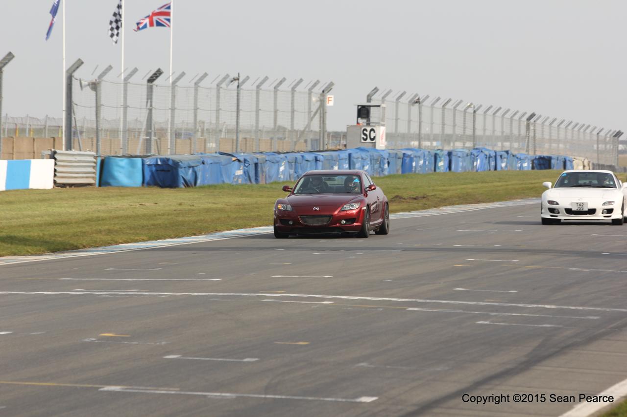

I also reduced my tire pressures slightly from 32 psi to 29.5 psi and ramped up the Ohlins to 26/32 clicks as I figured that would be a good starting point. After this I grabbed a ride with a former Formula 4 driver in his RX-8 to learn the track a bit better before going out on my old tires.
I then proceeded to drive like a pussy until changing my tires gave me some more confidence because I was still getting used to the car and didn't want to crash my pride and joy (and all of the other excuses). To be honest though, I was just really nervous about not having traction control to save me from my stupidity and running on the old tires which looked like this:

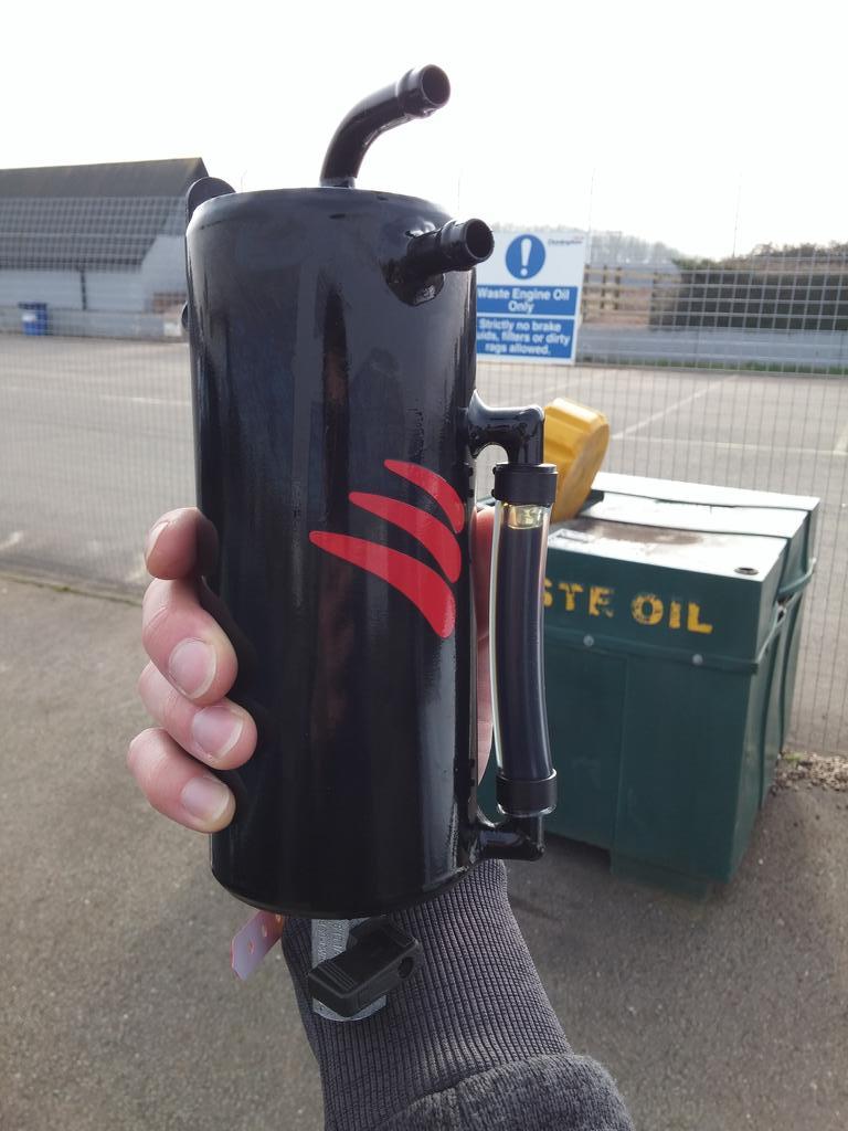

2. Excessive oil blowby filling up my catch can and blowing oil through the entire intake tract causing oil to squirt out of the lower intercooler hose and the top of the gap between the throttle body and plastic elbow.
3. Issues turning the wheel more than 60 degrees left at the Goddards hairpin causing me to always miss the apex and need to slow down excessively to just make the turn.
The boost issues could be a number of things but perhaps have to do with all of the oil loosening up the intake pipes. Here is what the catch can looked like after each session:

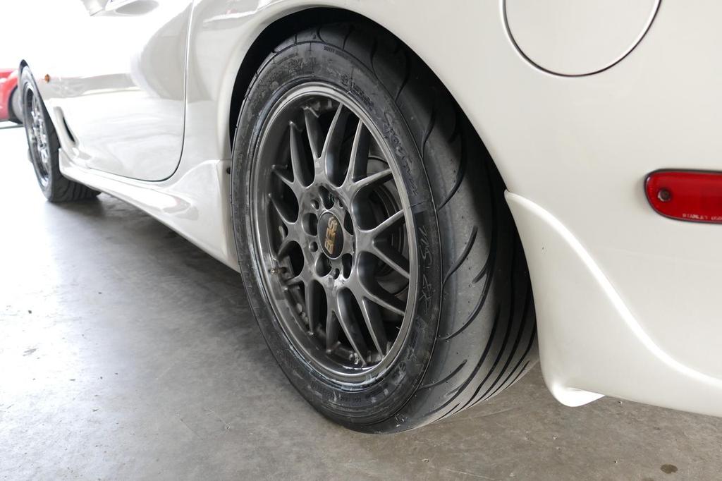

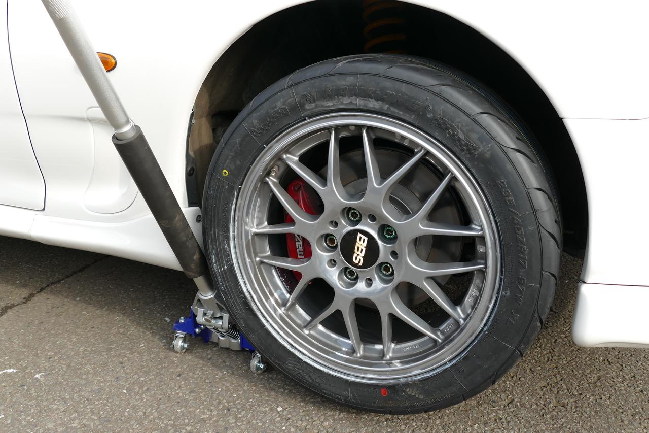

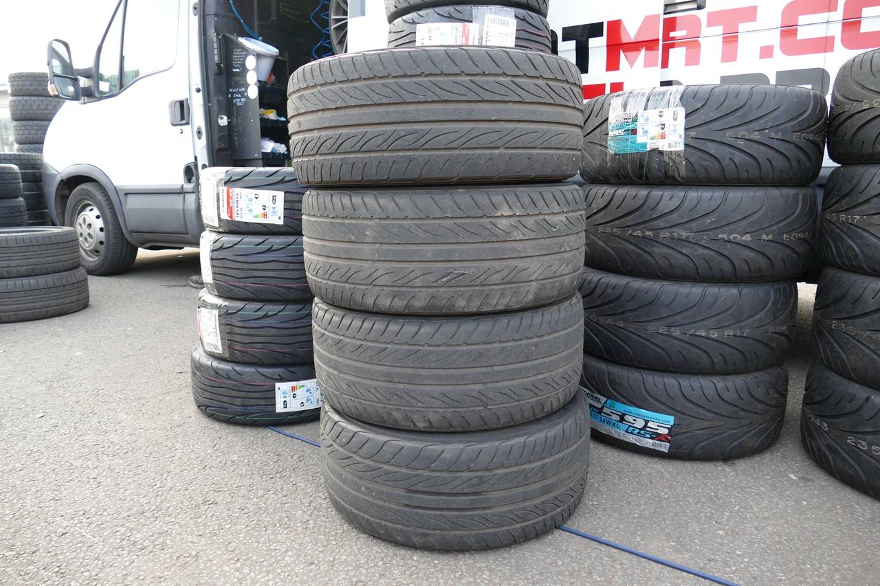

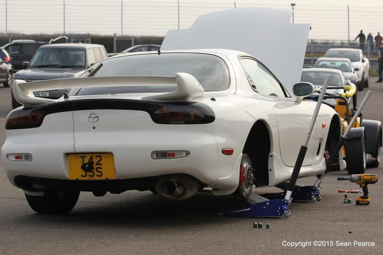

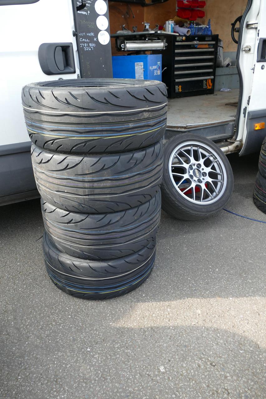

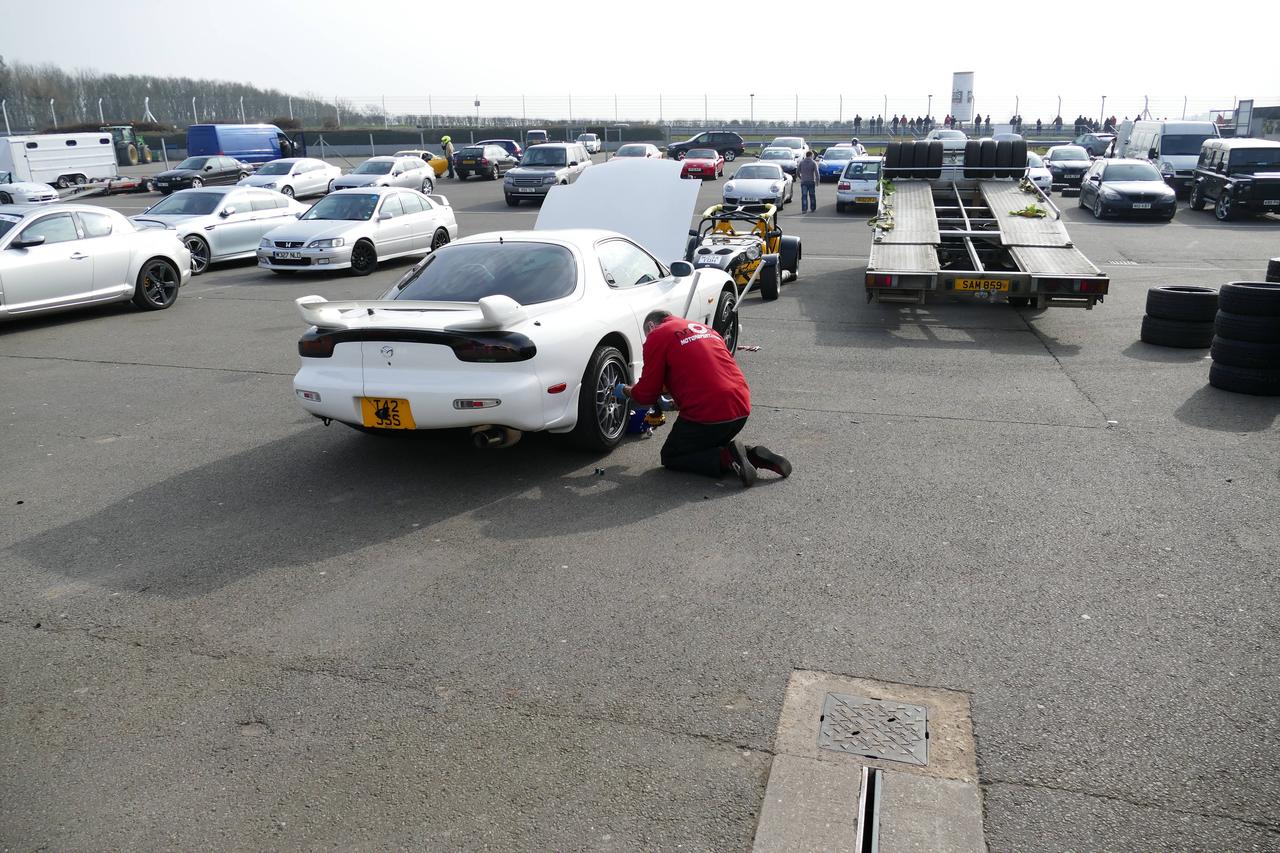

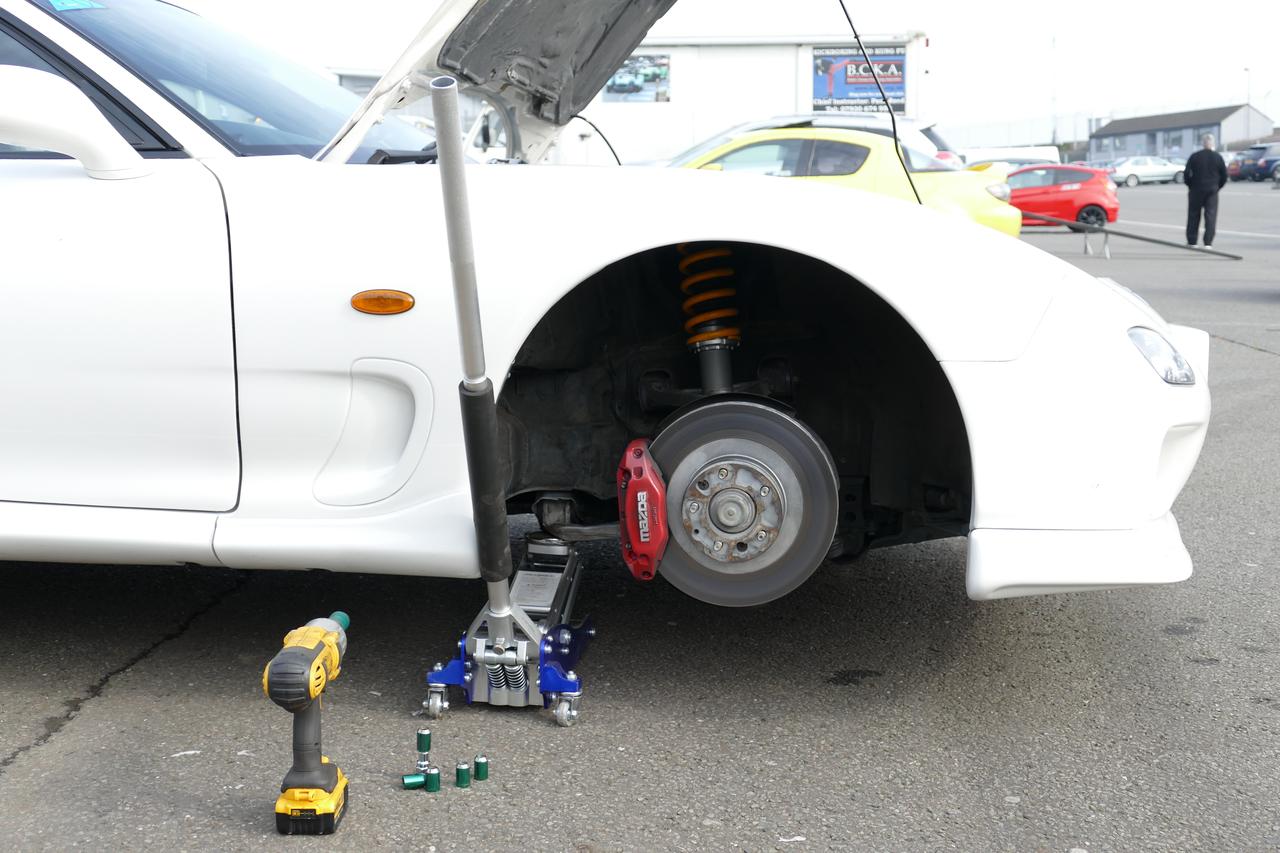

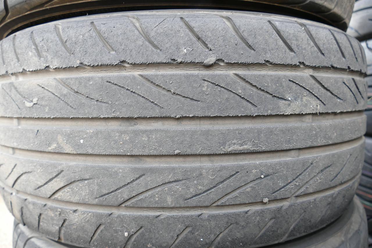

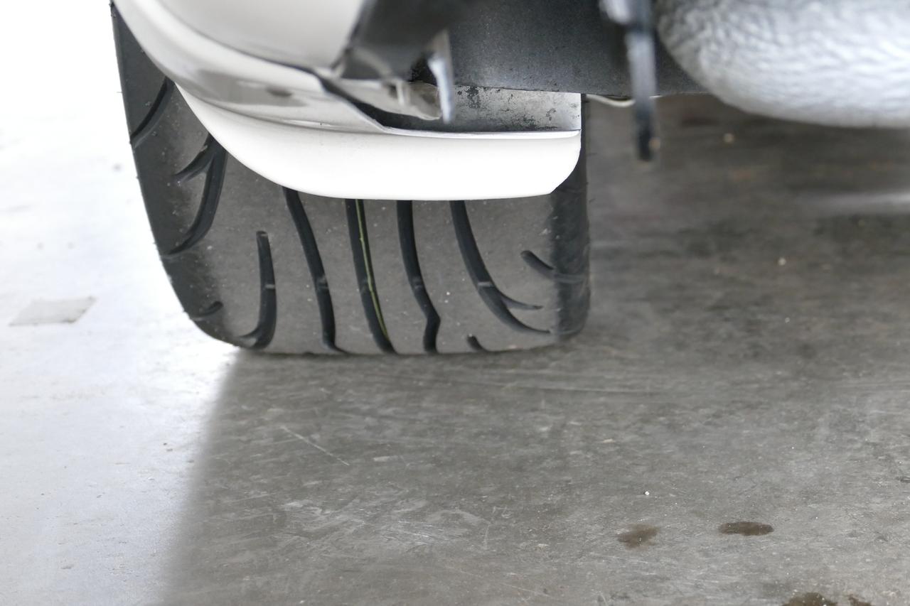

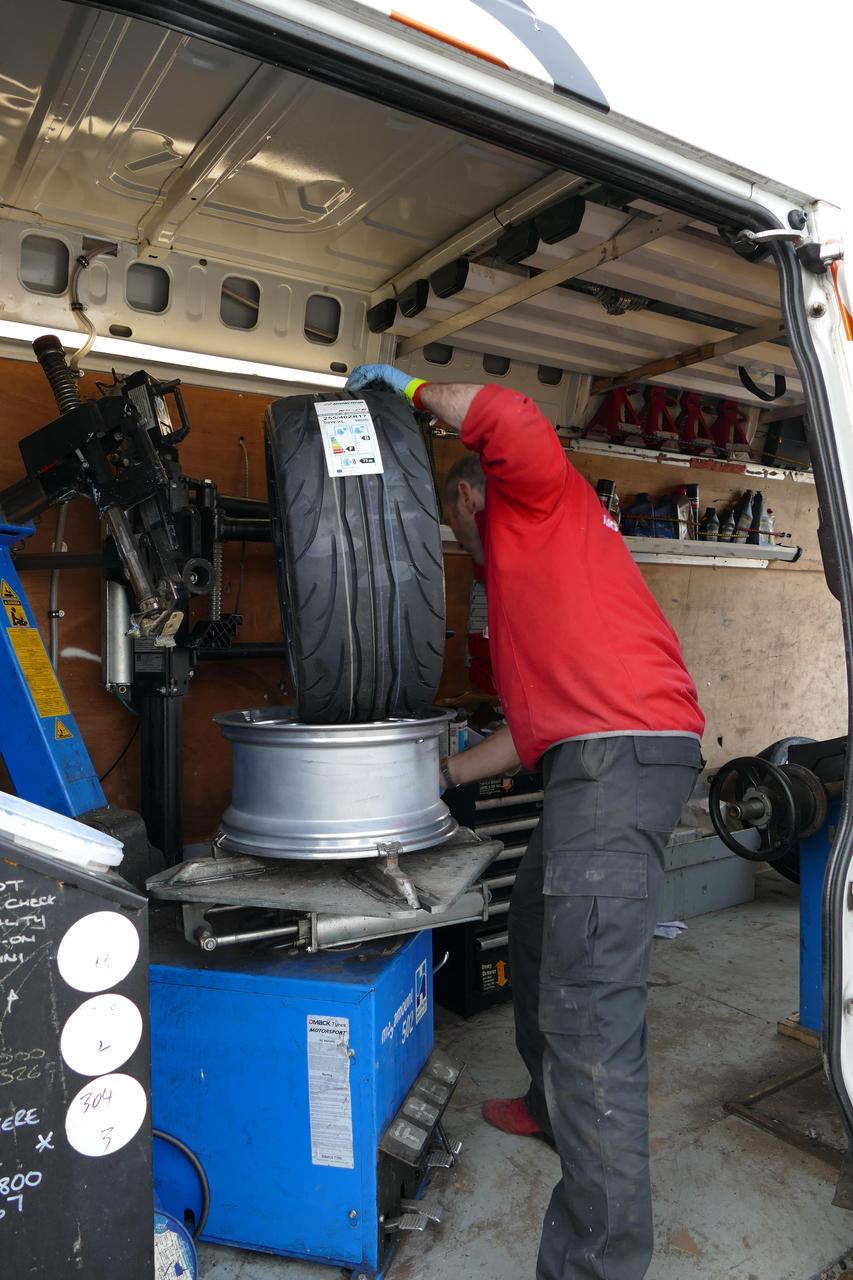

Anyway, despite these issues I was still enjoying myself and after lunch I decided to change my tires from the old Yokohama S-Drives, of which mine were apparently manufactured in 2011, to brand new Nankang NS-2R mediums. I also decided to upgrade my tire size to the recommended spec on the door.
Yokohama sizes were 225/45R17 and the Nankang's are 235/45R17 front and 255/40R17 rear.
Old
New
One thing I noticed is how large and wide the Nankang's are and I think I may have gone too wide in the rear for the rim even though my rims measure about 8.25 inches thick from each tire beat seat area. Later, I looked it up and the Nankangs typically run a bit wide so the 255 is more like a 265 tire from another maker.

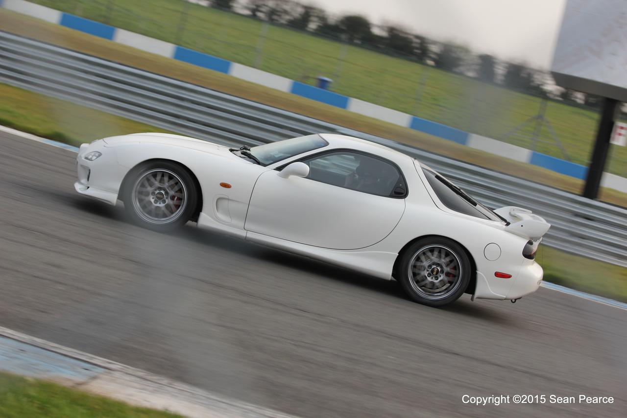

One thing is for sure though, I had grip for days after the switch. The difference was unbelievable and the tires grip far beyond my own capabilities or willingness to push the car at this stage in the corners. I could finally put my foot down at the exit of a corner (sometimes mid corner) and not start sliding like I did a few times in the Yokohamas.
Once the Nankangs were on I gained a lot of confidence and my lap times consistently improved and my fastest of the day, although not on video was a 2:02, which is very slow even with my boost issues limiting power but I improved from over 2:20 at the start of the day. Plus, I'm now a lot more comfortable with the car's handling characteristics although I will still need a lot more track time to really start getting the most out of the setup.
Oh, and throughout the course of the day I adjusted the Ohlins to full stiff and the handling was still sublime but just a touch firmer than how I started out. There is very little body roll and the dampers absorb bumps so well it's ridiculous. I love them and because of that here are some photos of them from the track day!

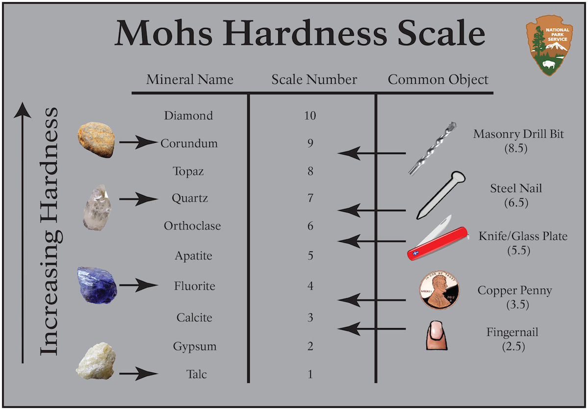

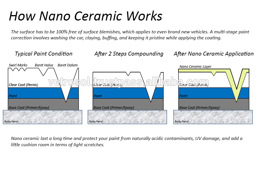

The ceramic coating is much stronger and longer lasting than your typical wax or sealant. It has a hardness on the Mohs scale of around 9 compared to your typical gorilla glass phone screen of 6-6.5.
The coating seals the paint much better than a wax or sealant as well and takes damage better too. It's not going to necessarily stop a rock from chipping the paint if it hits the car hard enough (it's not a substitute for PPF) but it can take a lot more damage from the elements and keeps the surface cleaner as it doesn't allow things to adhere to the ceramic coating as easily as a wax or sealant. For example, a bird takes a huge shit on your bonnet, the coating absorbs that and it will not affect the clear coat or paint underneath. All you will have to do in the event of a bird shit that sat on your car for a while is clean the car, lightly polish away the area and reapply/top up the ceramic coat on the area.
Three of the best things are that you don't need to apply wax or sealant on top of the coating, washing is much easier with less chance of marring, and the coating will last up to 5 years if taken care of properly (the warranty Gyeon gives to its ceramic coat products when applied by an approved detailer). Now, I don't expect 5 years out of it but I shouldn't have to consider a reapplication or top up for about 2 years depending on how much adverse weather my car sees.
My FD is basically having the whole Gyeone suite of products applied including coatings on the rims, calipers, glass, rubbers, FEED carbon fiber door kick plates, inner door sills, engine bay, interior, etc.

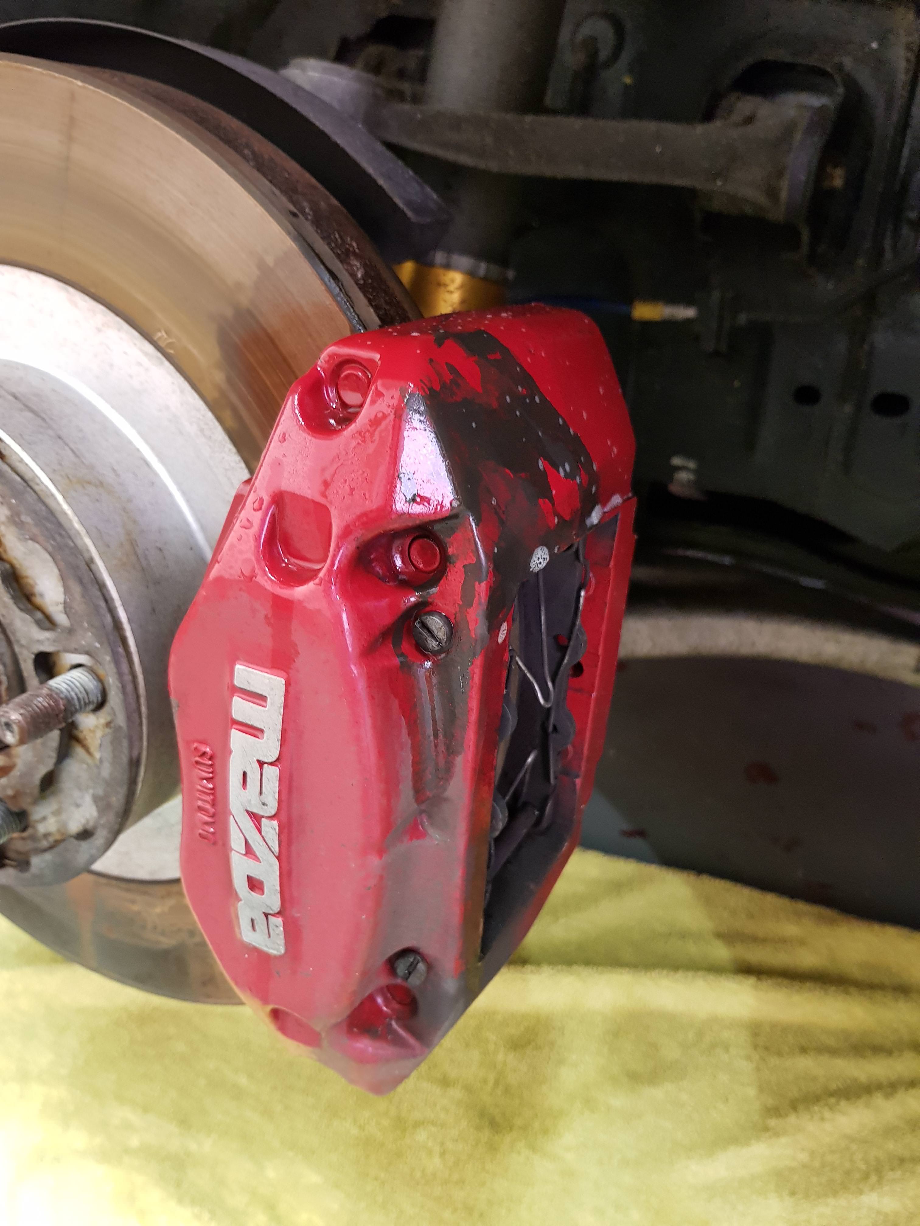

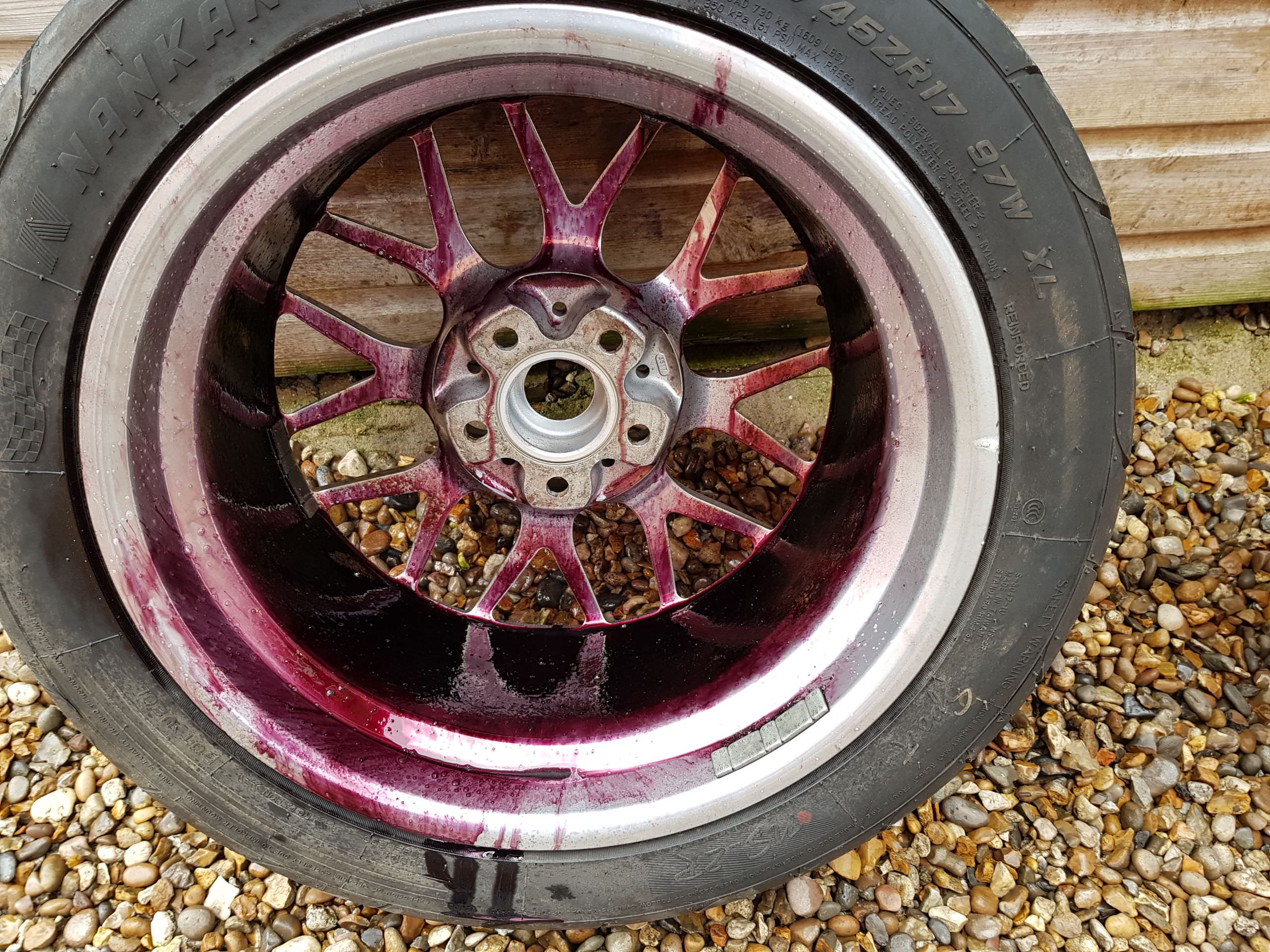

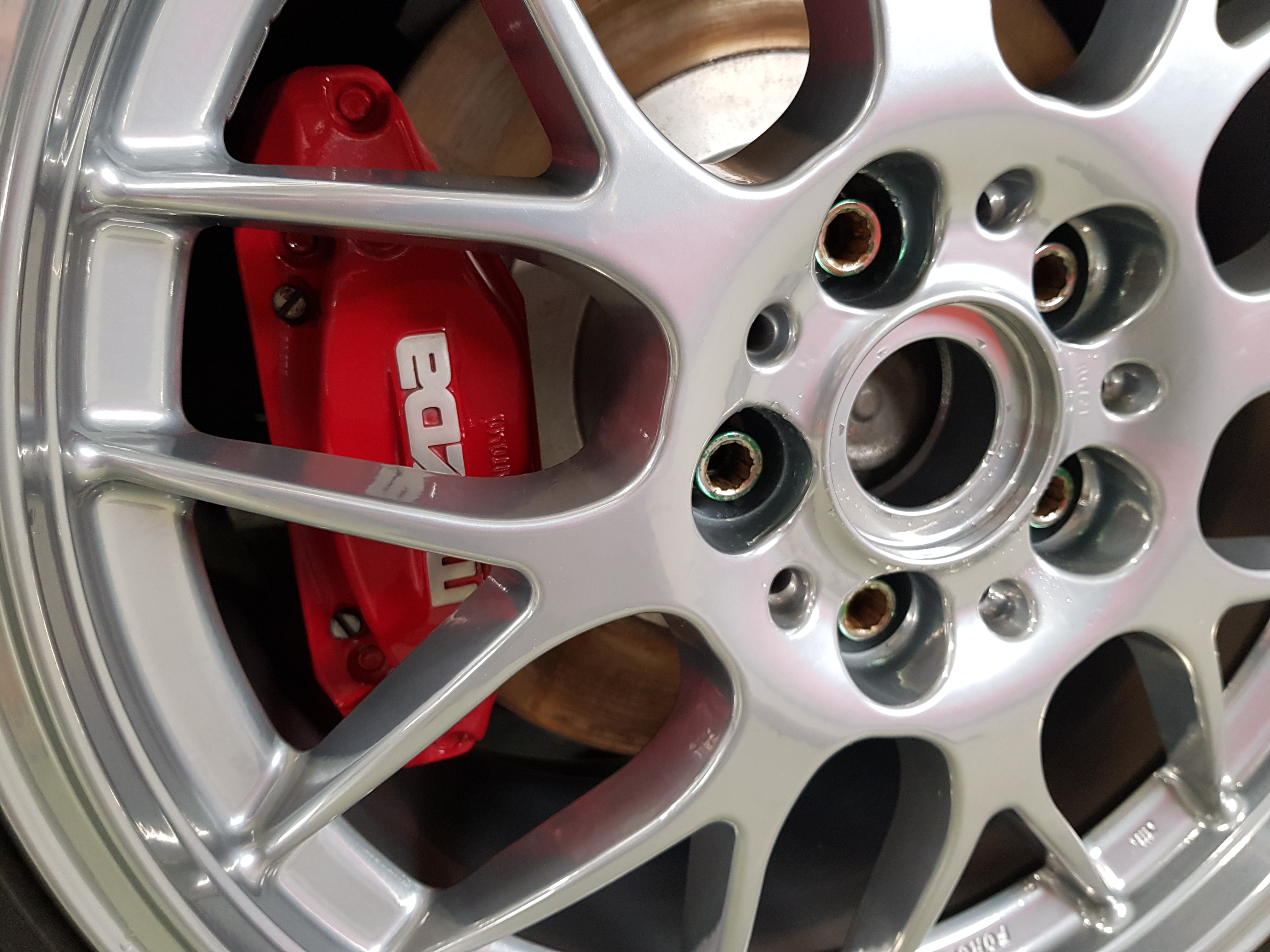

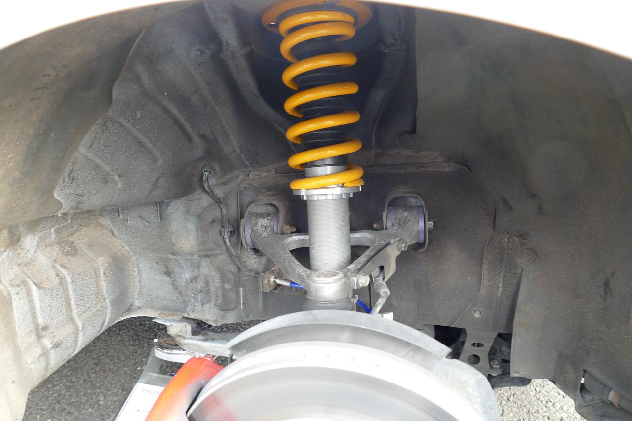

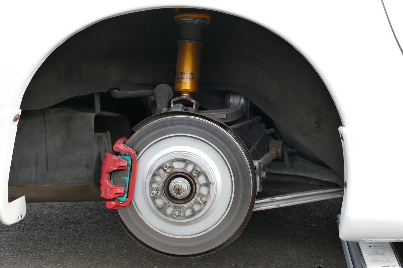

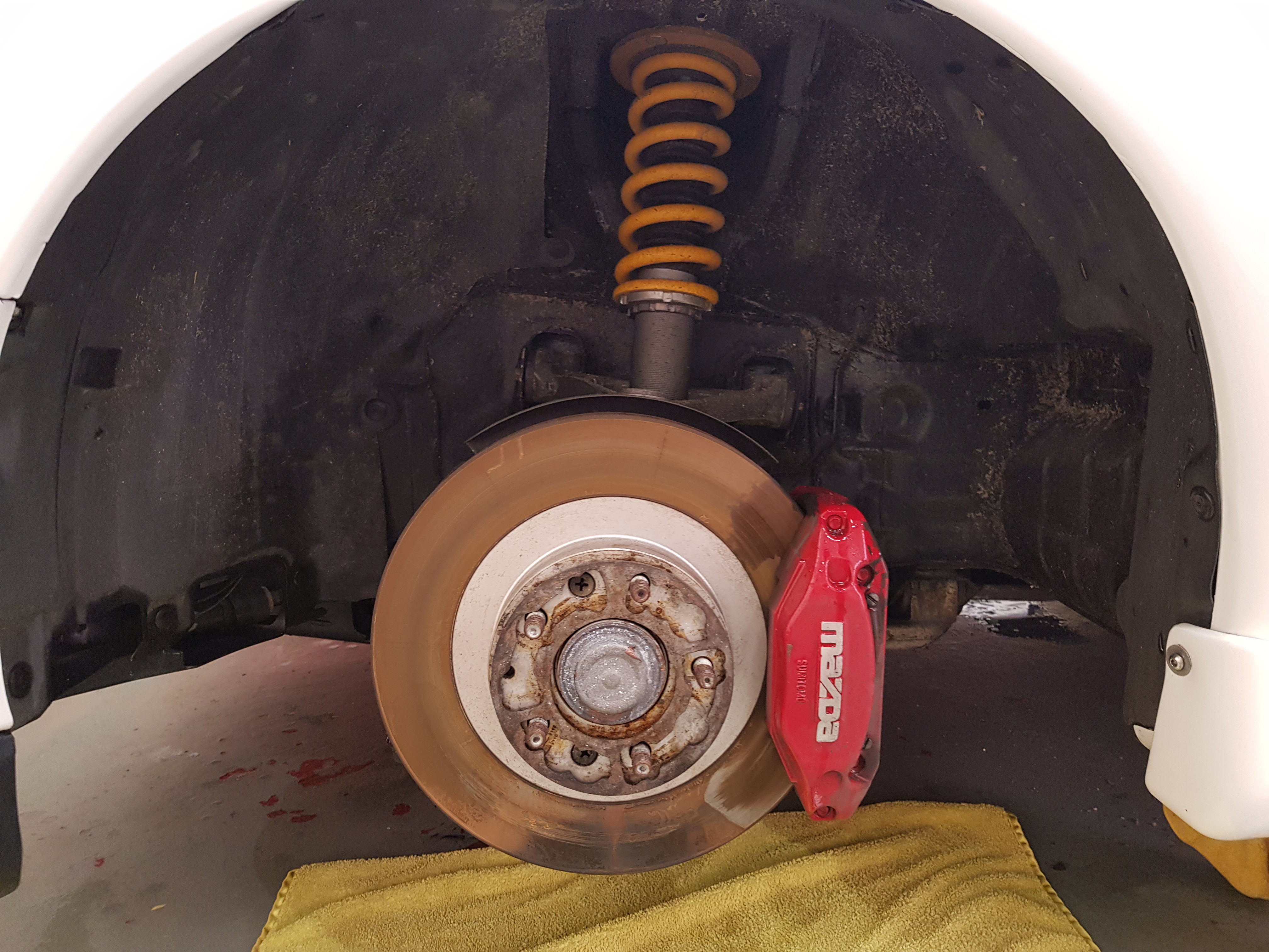

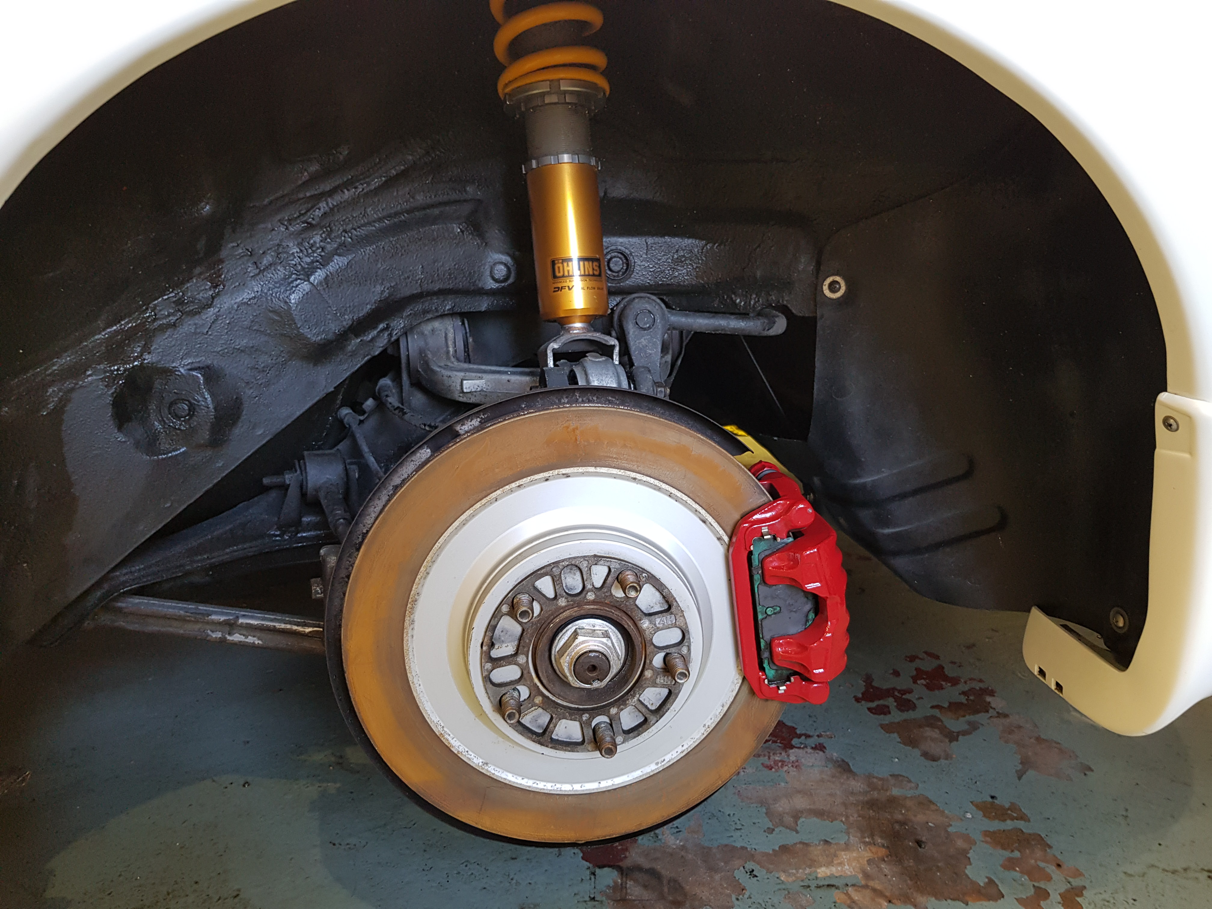

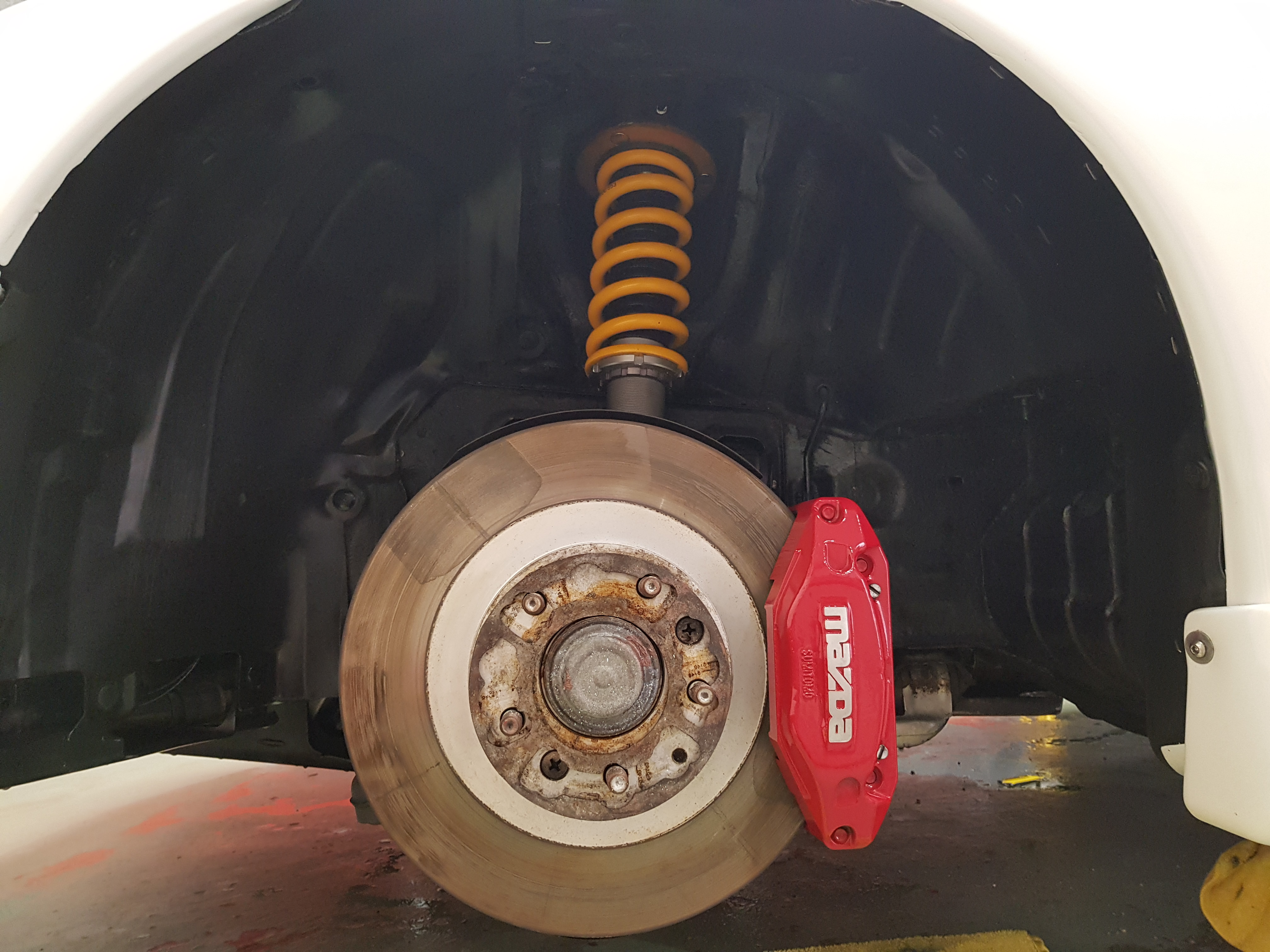

Only a couple of teaser shots because the detailer hasn't sent me more. Yes, my brakes discs look suspect but the car hasn't moved in quite some time...

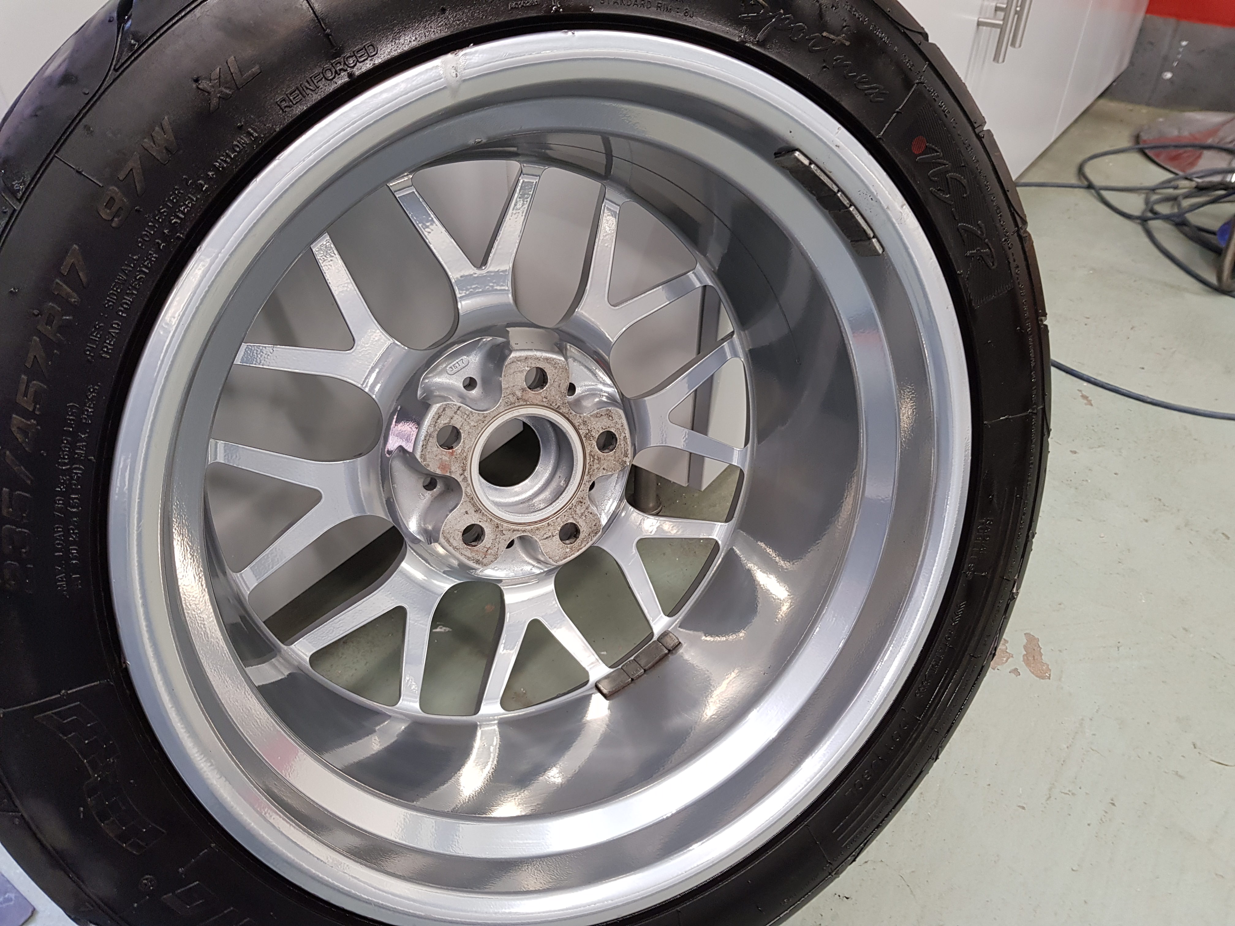

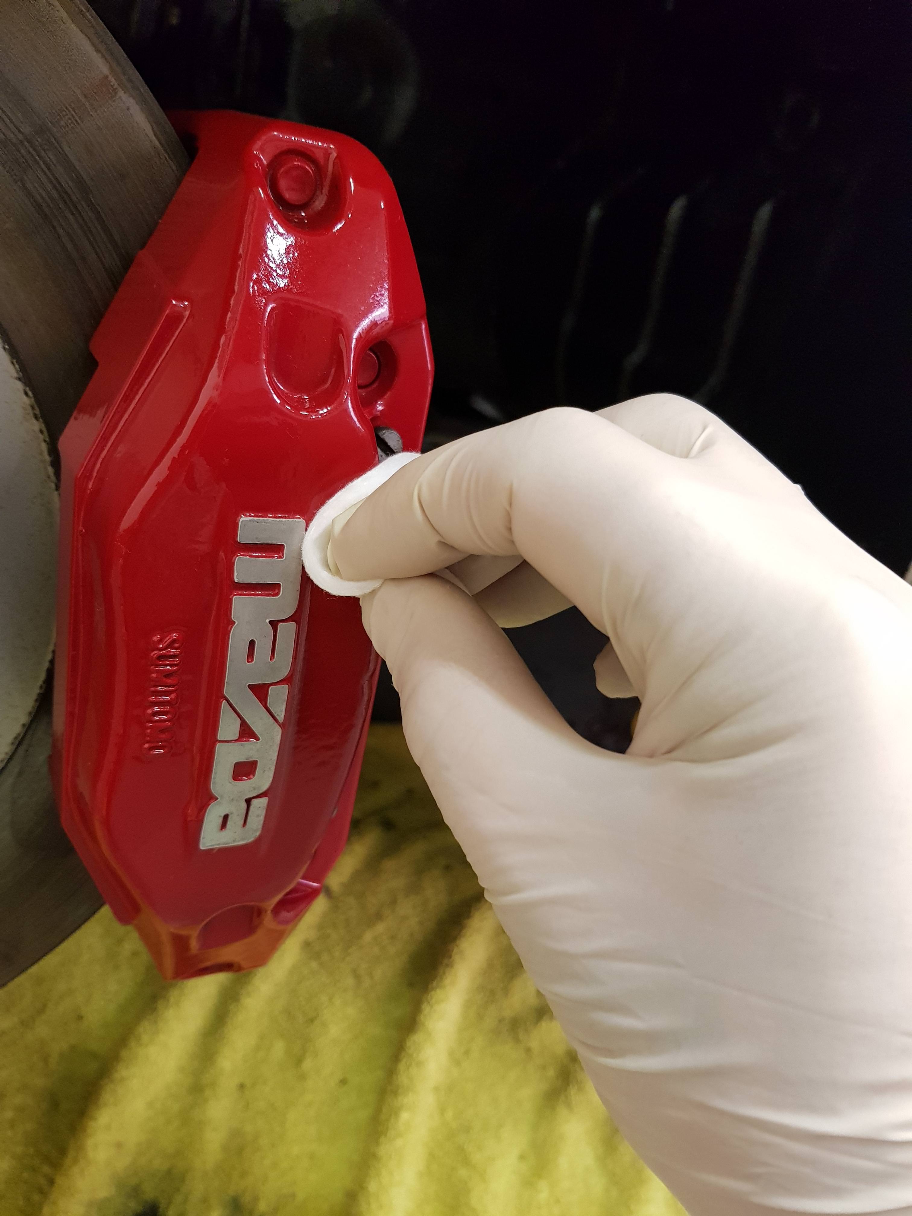

Car was washed, deconaminated, all 4 wheels removed, arches, coilovers, suspension arms, discs, etc. all cleaned. Wheels and calipers cleaned and ceramic coated. Arches dressed. More to come tomorrow!
Before cleaning arches, coilovers, etc.
After cleaning arches, coilovers, etc.
Cleaning calipers
Cleaning wheels

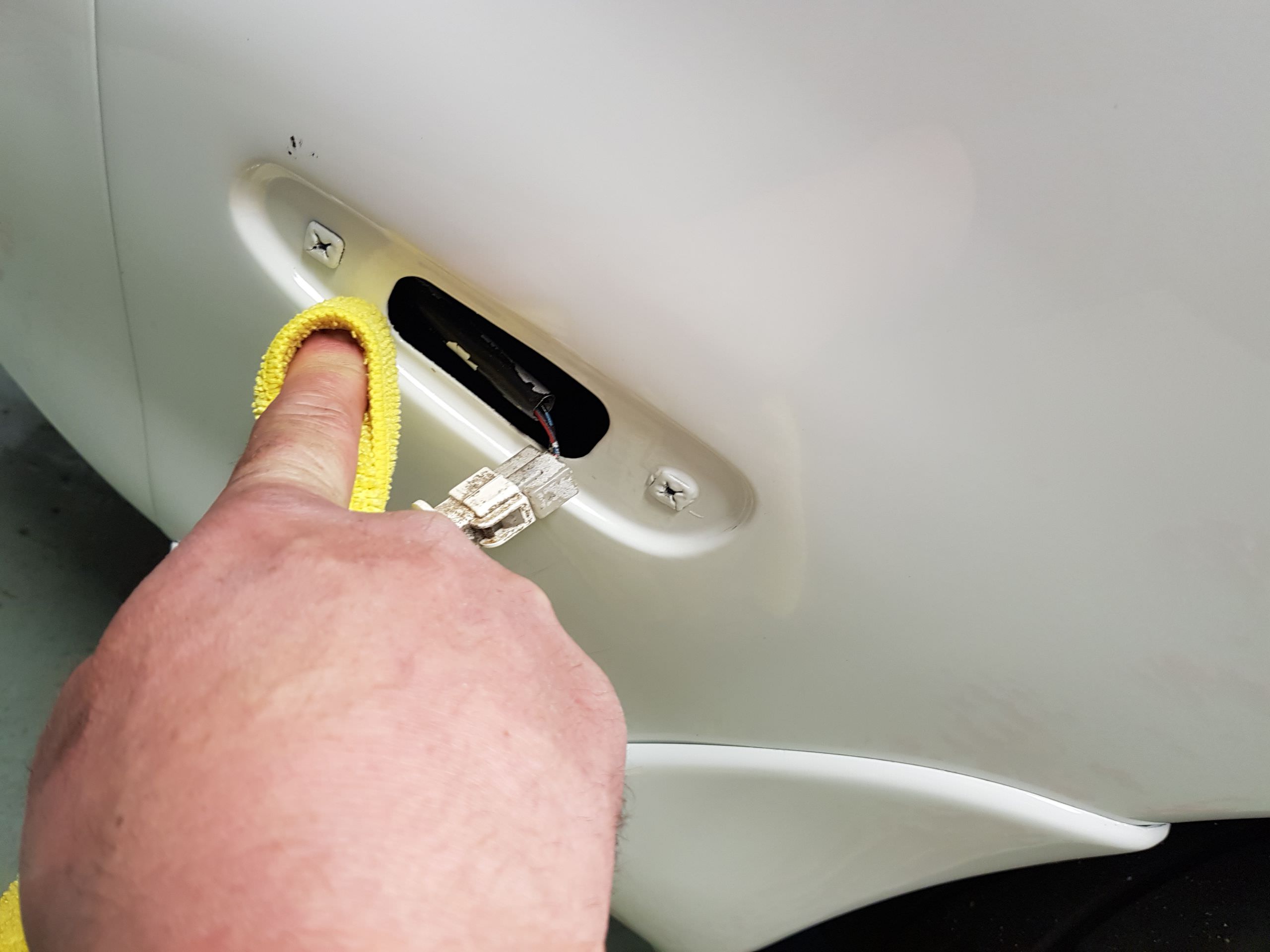

Random attention to detail during clay bar session
Haha fair play he's not messing about is he! I bought devil blood the other day for my wheels but it doesn't turn a nice colour like the wheel cleaner he's using but I only paid 7 quid for my bottle lol. It does work ok but I've not tried it inside the wheels yet! Next year they'll be done ?
What are you using to clean the calipers Roy? Looks like it works really well. I take it it's safe on the paint?
Your detailer is lazy Roy, he could of cleaned the repeater connector ;)
Just kidding, looking great.... How much is this level of "Detail" costing if you don't mind me asking?
Haha, maybe he did! The pics are progress pics anyhow as there is dirt in the lense wipe photo and one of the wheels still has water on it! Haha.
