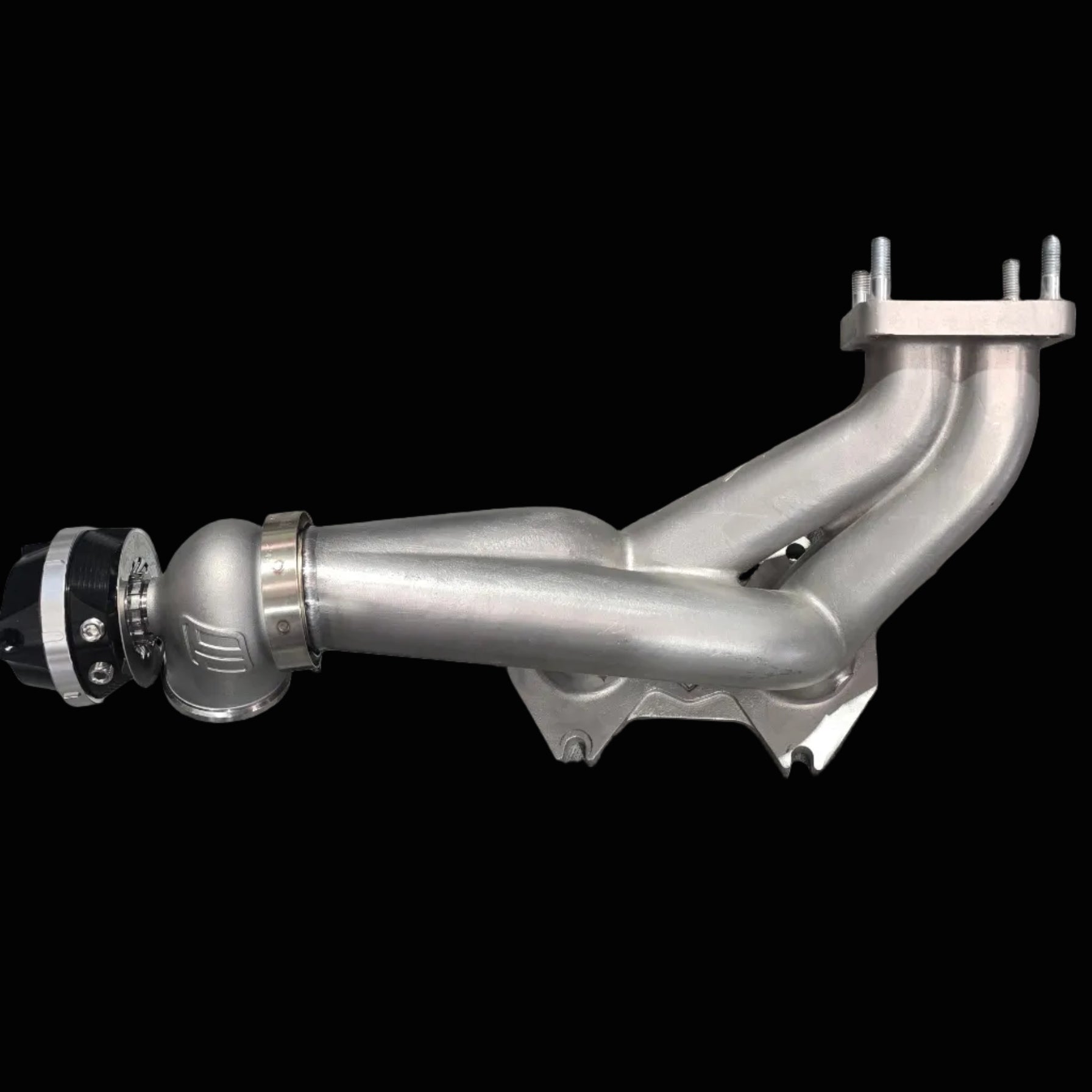

The SAS mani I was looking at uses a single, but it’s quite a way from the manifold. I asked the guy about this and he said it was to do with heat management and keeping the wastegate away from the engine.
This is the SAS mani, the gate is quite a way from everything which I did think was quite unusual. All previous manifolds Iv had (for skylines) have basically had the gate attached to the collector, although space isn’t a major issue on them.
Realistically, I doubt having longer wastegate runners will make much difference. Gate size is the big factor.

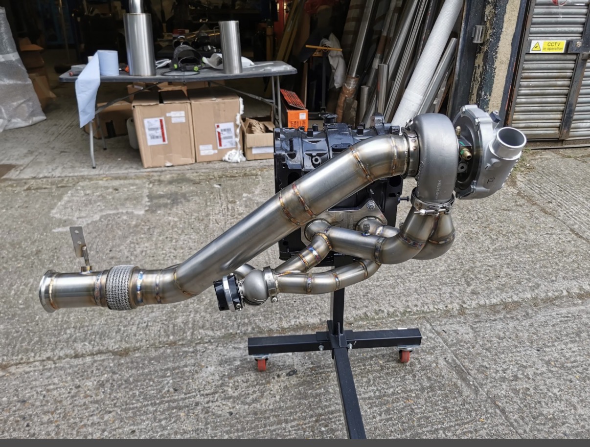

Coleman's manifold design is probably my favourite, but not sure if anyone has actually installed one yet:

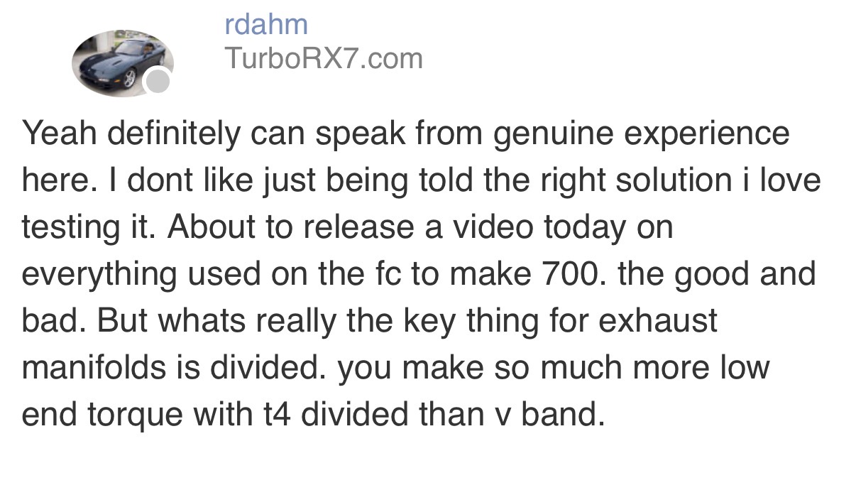

So after seeing @Copyninja comment about the difference he saw when going from a divided T4 to a V-Band I did some reading and he is spot on.
Found a post from Rob dahm to after he did back to back testing with manifolds.
So I’m set on getting a T4 divided mani which basically means I’m going to go duel wastegates, hopefully they will sound okay when plumbed back in.

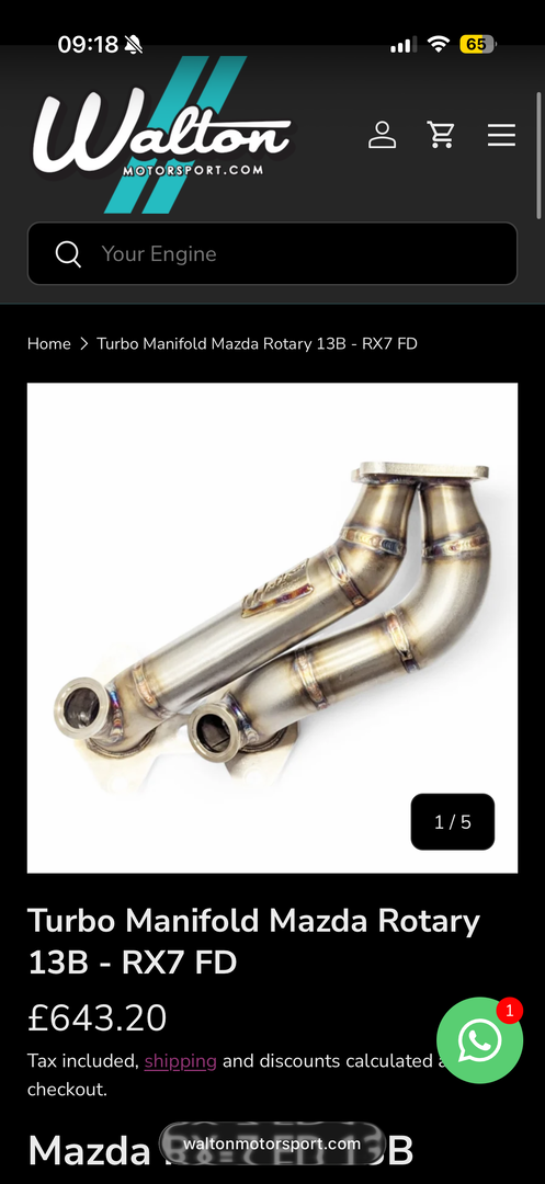

I think I’m going to go with the WaltonMotorsport mani as tbh, they all kinda look the same and Walton have been in the game a long time. Happy to hear other opinions tho.

Iv been talking to Walton and they offer a custom service so have asked them to quote me one of theirs but both going into a single WG
