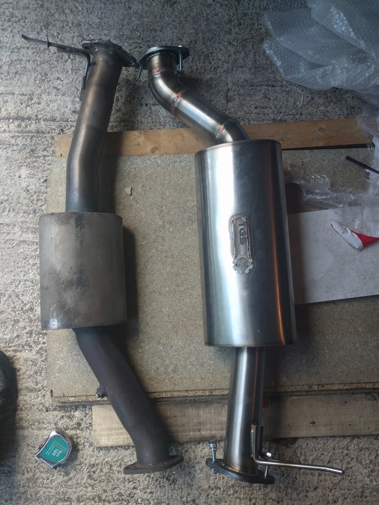

TGS dolphin exhasut.
Not entirely sure what you mean, but I think I can get away with the pipe and back without needing a pfc.

No that's thrown a spanner in the works. I was under the impression that if I changed just the downpipe(stock center), and new back box I should be ok. I steered away from the intake, as what I've read suggested a stock engine/ecu doesn't like sucking hot air from the engine bay.

Cheers jeff, just to confirm it's only the down pipe and catback I'm changing the mid pipe is remaining stock. I have a panel filter in already, hence me hoping to get away with out a pfc.

If your stock down pipe isn't one which has a pre catalytic core bulging out post turbo, then changing it to a larger one will benefit turbo spool and perhaps reduce engine bay temperatures a little. But it won't be a substantial improvement over the OEM item, which already flows pretty well assuming there isn't a cat on that pipe. Like what Joel said, removing and replacing the down pipe in such a cramped area beside engine bay makes it quite a tedious job to do. I assume also the new down pipe you have purchased has the depressed concave on the flange connecting to the turbo manifold in order for it to clear the steering rack?
