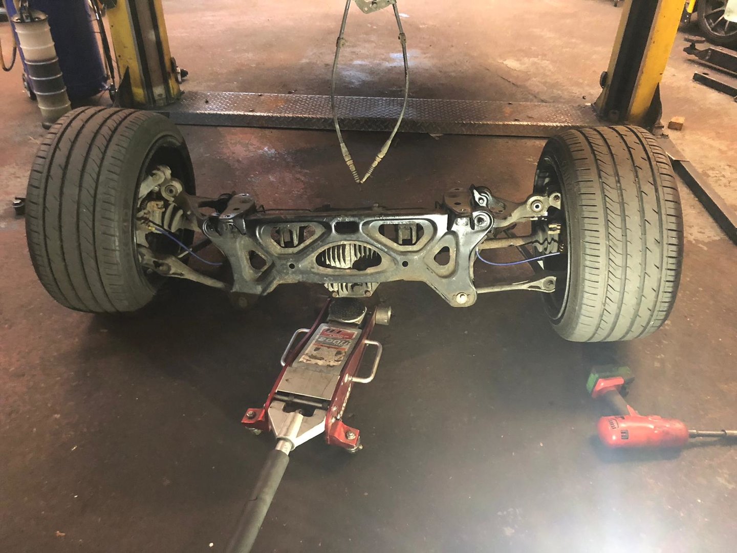

Thats a great help, armed with this information i think i can drop the frame with out wheels using a transmission jack. Ill have to do a bit of measuring to check if i can get enough clearance just on axle standsi have just done the rear and know exactly what is involved, to save yourself a massive amount of time you need to try drop the whole complete rear end off by lifting the car up with a ramp with the wheels still bolted on, hubs, arms, diff , brakes, drive shafts all the lot complete, this way you are not going to create yourself a tonne of work.
If you already have for example a subframe ready to swap out like i had this is the fastest way possible to do it and you don't even have to remove the wheels;
Things to consider if they are still 20 year old and not already done -
Now onto the removal -
- underseal the area while the sub frame is out.
- Re-locate / Change the fuel filter if you still have it in the awful stock location
- Gearbox Output seal
- Diff seals for drive shafts (in case they split/bust or rip the dust seal springs out when disturbing the shafts)
- Diff hanger Bushes
- wire brushing accessable threads and using some penetrating oil on the caster bolts a week or so before the job
-Mark the floor with chalk where the wheels are positioned before you lift the car up off the ground on the ramp (this gives you a good idea where they need to be lined back up when re-fitting , i found this very useful for getting pretty much back inline with the chassis locator pegs for the sub frame
-Remove all Trays, Support bars / Braces and Brackets from the rear underside.
-Remove the exhaust
-Remove the PPF
-disconnect the Prop shaft from the diff, if you remove the prop shaft totally to get it out of the way then bear in mind you will lose gearbox oil if you don't have a -bung to bung the box up.
-disconnect the ABS sensors from under the rear seats and push them down and out under the car.
-disconnect the Handbrake Cables from the calipers and the cable bracket on top of the diff.
-disconnect and remove the drop links to disconnect the suspension leg from the hub
-disconnect the Chassis brake pipe hardline where it connects to the Brake Bias that is bolted to the subframe (bung this pipe up that is fixed to the chassis to save fluid leaking everywhere)
-disconnect the Flexi caliper Brake hoses where they meet the hardline that is clipped into the subframe (the hardline stays on the subframe and the flexi's stay connected to the calipers)
-Now you have the whole back end dropped off the chassis all still bolted together with the wheels / hubs / drive shafts all still connected lift the subframe and stick a decent block of wood under the diff.
- you are now ready to remove the whole thing, loosen all of the subframe bolts and then lower the car so the diff is sat firmly on a jack and jack the diff so the subframe is tightly pressed up against the chasiss, you can then start to remove all the bolts.
- now slowly lower the jack and the subframe will come away from the body, once you are happy its all clear you can lift the whole car up on the ramp leaving the whole back end of the floor.
-Disconnect the brake bias already connected to the hardline from the old subframe
-Disconnect the Upper A arms from the Subframe, Disconnect the Toe Links from the subframe, Disconnect the Trailing Arm from the Subframe and then get a Pry bar and carefully disconnect the drive shaft out of the diff, you can then pull the whole wheel assembly with the drive shaft , Hub , Arms and Links all still connected in one lump- Repeat this to both sides leaving an empty subframe with the diff and hanger still connected.
- You can now remove the diff hanger from the Subframe with the Diff still connected to it (i personally removed the diff from the hanger Separately as i changed out my Diff Bushes at the same time.

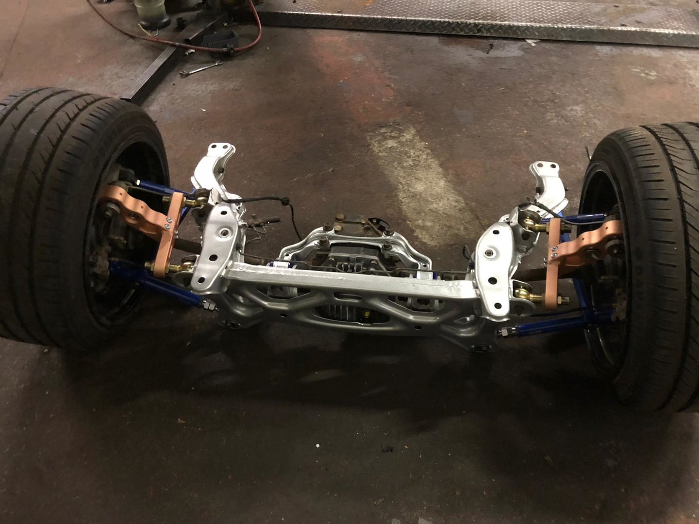

Now onto the re-fitment of the New subframe -
install the brake Bias that is connected to the hardline to the new subframe (there is just is 3 clips to transfer over and you can actually get to the back of them with your fingers so you don't damage them prising them out with a screwdriver)
-Possition the new subframe in the original possition you removed it supported by the Jack and then start to lower the car and repeat the removal procedure for fitment.
- Now get your same block of wood and support the diff under the new subframe and then Re-install the Diff hanger and diff (if you left the diff still connected to the hanger then you only need to connect the hanger)
- Now Guide your whole complete wheel assembly with hub, drive shaft , arms etc back into the new subframe and loosely connect all the bolts back to the new subframe and then re-connect the shafts into the diff (do this on both sides)
- Now connect back up your flexi brake lines to your subframe hard line
