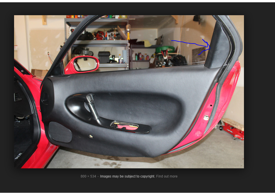

No need to take door card off (you wont be able to until you can open the door)
All you need to do is pop this cover off (just pull)
13588
Did as you advised. Gave them a wiggle in either direction. Seemed to loosen whatever was jamming them up.
The interior lock or the doesn't seem to work. But it's locking and unlocking off the central locking.
Cheers for the tip!
