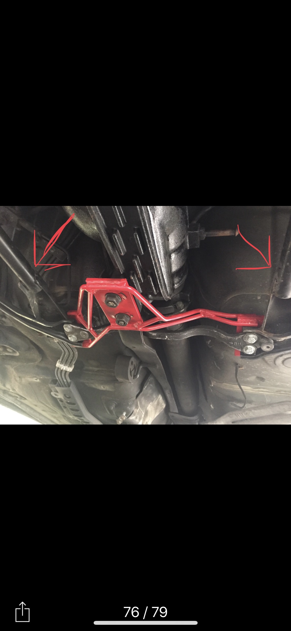

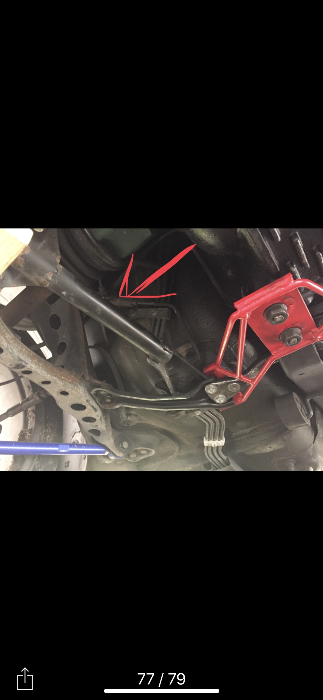

MKZ7212 Well-known member Joined Jan 12, 2018 Messages 1,051 May 23, 2018 #1 Anyone else have the braces highlighted on there’s? The diff brace was a pig to fit because of them Attachments ECA355C3-9A9C-48F1-9E76-9EB0F7F4FEA8.jpeg 229.1 KB · Views: 370 4B7E74B5-CC3F-45C9-9182-C761356E481B.jpeg 221.9 KB · Views: 381
MKZ7212 Well-known member Joined Jan 12, 2018 Messages 1,051 May 23, 2018 #2 Found the info here https://www.rx7club.com/3rd-generation-specific-1993-2002-16/fd-diff-brace-bars-1118265/ Seems Mazda added these to the 94-95 car only?!
JDK Well-known member Joined Feb 5, 2018 Messages 408 May 23, 2018 #3 I thought that was just a normal post 95 subframe?.?
Ceylon Always apart Admin Joined Jan 7, 2018 Messages 1,849 May 24, 2018 #4 All FD's built July '93 onwards have the extra subframe bracing.
Rehab.pr Member Joined Apr 20, 2018 Messages 96 May 24, 2018 #5 Just take em off XD I did, my exhaust kept banging against it.
