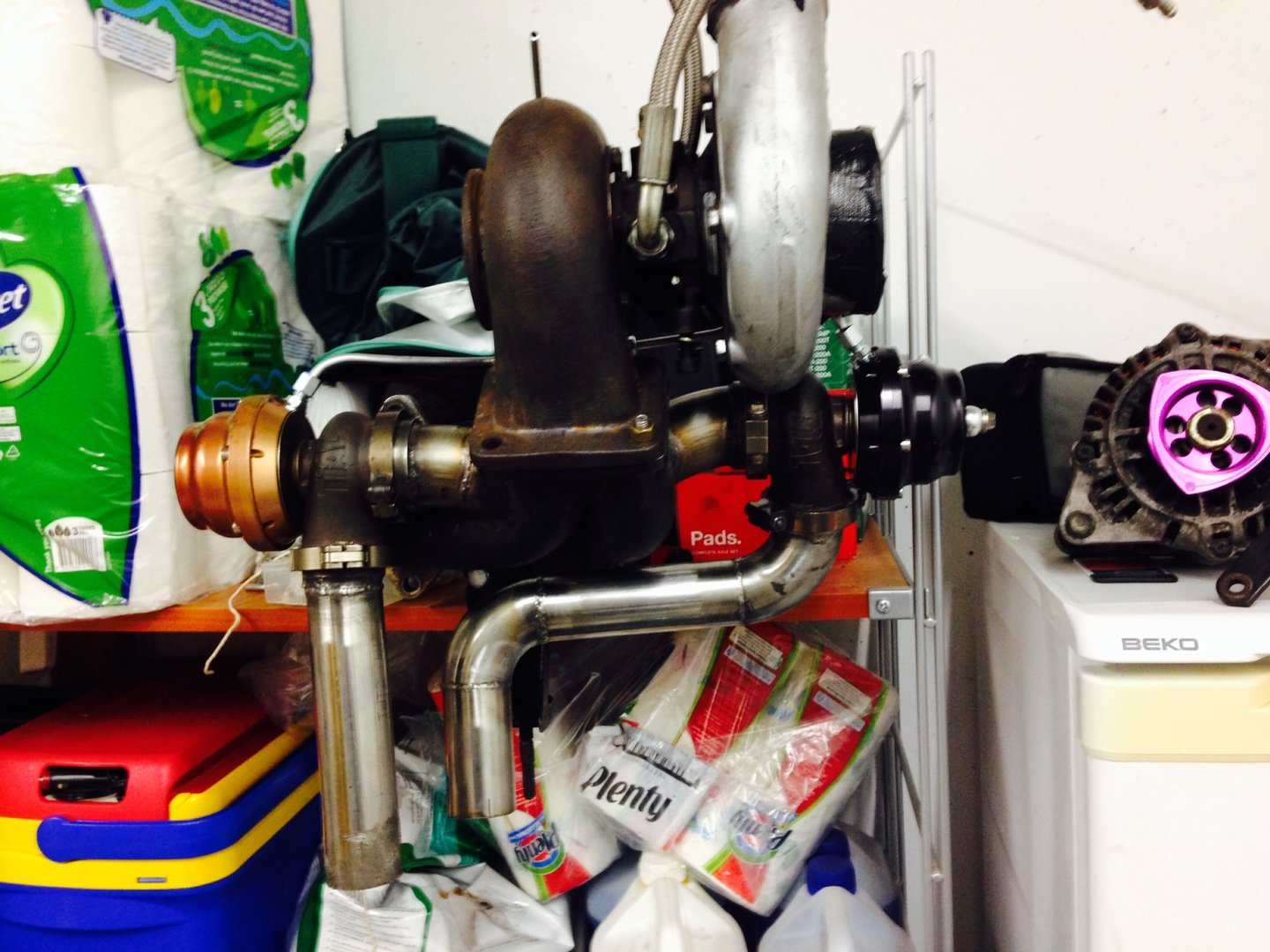

I did fit the manifold and mock up a downpipe, ready to get wastegates and fit it all up…

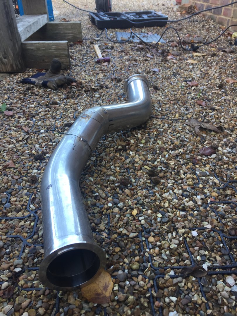

Heard from the fabricator that my downpipe and intercooler are ready. The downpipe I needed to remake for the new turbo and manifold, built it myself and had him do the finish welds. The intercooler needed a new cast section added to line up with the turbo:

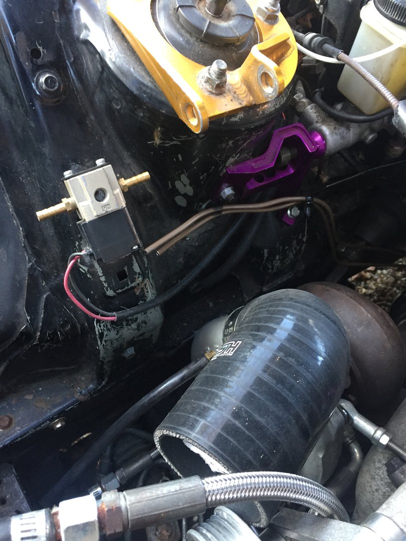

Got the black crinkle paint out today for the FMIC end tanks, and tested out my fine brushwork on the compressor housing after drilling out the boost reference. Also fitted my Turbosmart oil pressure reg on the turbo feed line.
We’re pretty much back together. Front wastegate dump is hitting the subframe, I’ll probably need to get something better made. Wastegate lines, a few electronics and somehow fitting an air filter then all is good.

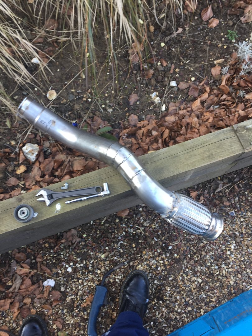

Some (bad) pictures of the wastegate issue. This is how Walton advise to fit it and it sits perfectly on their demo car, but no combination of twisting and turning can make it fit. Possibly a combo of parts moving in welding and engine mounts.
Andy at Walton Motorsports, top guy. I emailed them with my issues and they built and posted a new pipe the very next day, now fits perfectly:
