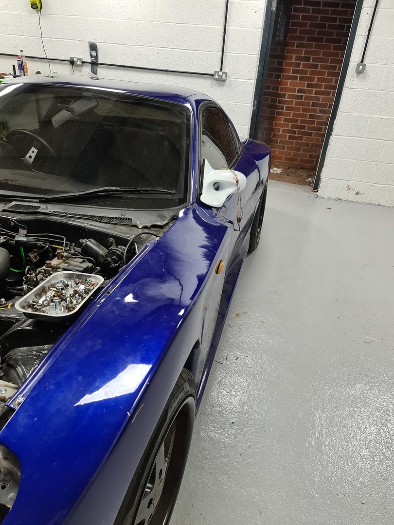

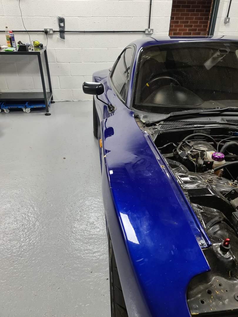

Howdy Folks
I've currently got "F1" style mirrors on my FD but i also got a pair of ganador style mirrors that i got with the car.
The F1 type are dogshit and the passenger side one in particular is useless. The ganador style ones don't suit the car so i'm looking for inspiration
What aftermarket mirrors are about or do you guys think OEM ones would suit it better?

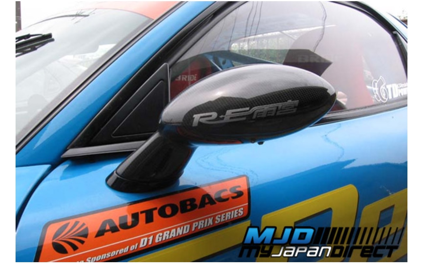

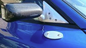

I'd probably go with Ganador ones on your car.
Those white ones you have are re-amemiya and don't suit imo.
They’re RE mirrors the ones that look like Ganadors
