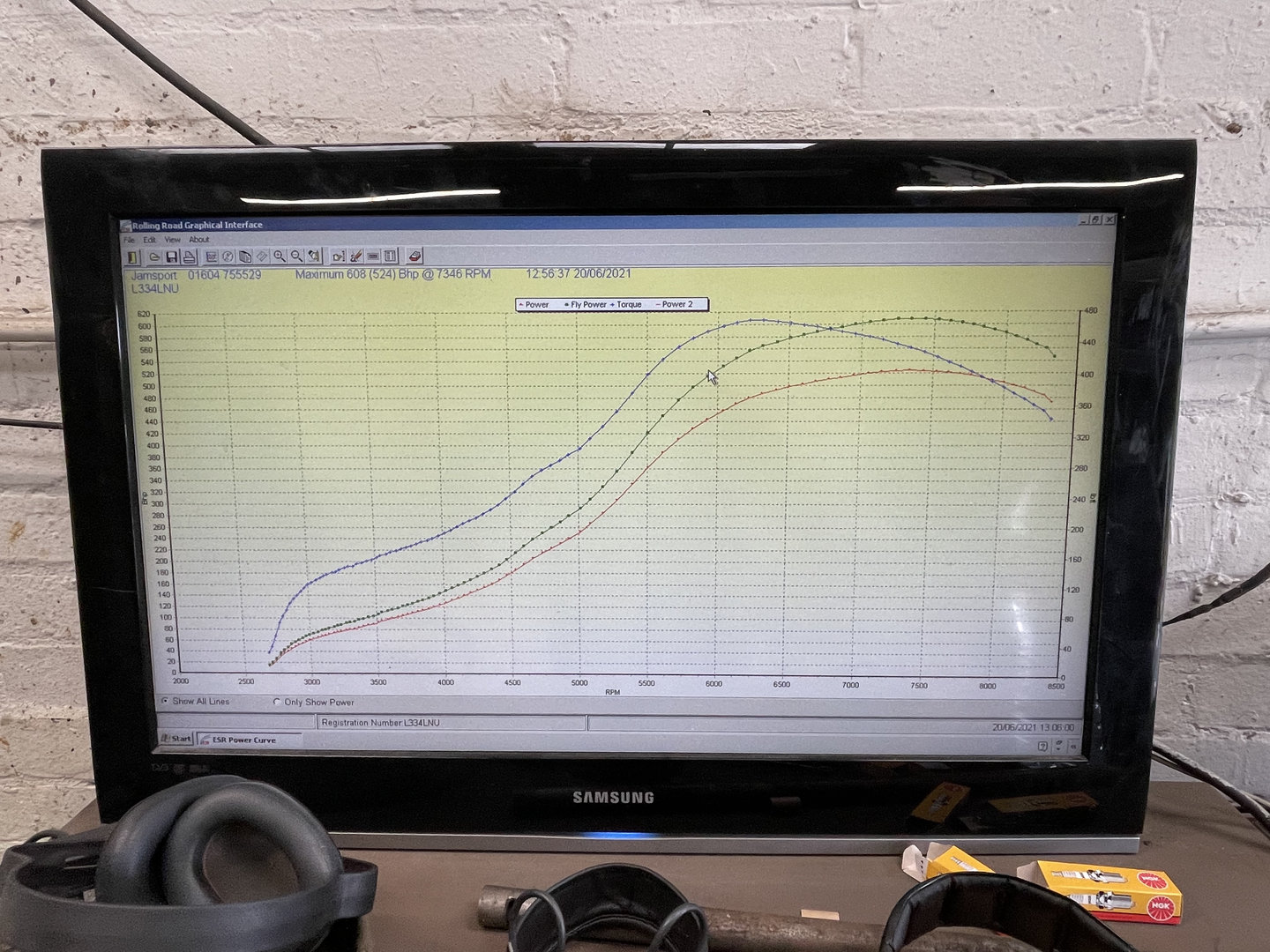

Do you think the spool improvements are coming from the wg venting to atmosphere?Some observations when comparing yesterday’s graph to last years.
Changes were bigger/fatter intercooler, new 60mm waste gate vented externally. Large K&N air filter. Just a few additions in the way of 2 x EGT probes reading in the ECU and added AFRs into the ECU too.
Previously at 5800 I was at 400hp now I’m at 500hp. Even at 5000rpm I’m up 40hp on previous set up.
Roughly 800rpm better spool give or take, 400lbft is from 5000 now, was from 5750 before.
500bhp used to be at 6500, now it’s about 5800
I now hit 550bhp about 900rpm sooner, used to be 7000 on the dot, now about 6100
At 8250 I’ve gained about 30bhp as there’s almost no drop now like there was before.
At 5500 & 6200 I’ve gained 80lbft
Well compared to last years results it’s easy to see where the improvements are.Do you think the spool improvements are coming from the wg venting to atmosphere?

The jamsport dyno is a bit strange as reports its power and torque on 2 different scales. Power on the left side and torque and the right side.
Congrats on making some really good numbers.
Nice to see the improvements. Did you get a chance to go wot yet? haha!Well compared to last years results it’s easy to see where the improvements are.
Firstly the biggest change is definitely the wastage set up, before it was vented back into the exhaust but after the dyno we found that the Greddy gate had no fire ring in so was affecting spool and holding boost up top, the now vented gate and more modern waste gate has no doubt improved spool and top end power.
Secondly the change to a better intercooler seems to have helped slightly but I guess hard to truly know whilst on the rollers - IATs at full boost were decent with water at around 26c.
I don’t think the air filter has made a huge amount of difference but I imagine the three main changes have all contributed in some small way but I’d hazard a pretty good guess at the waste gate set up having the biggest effect.

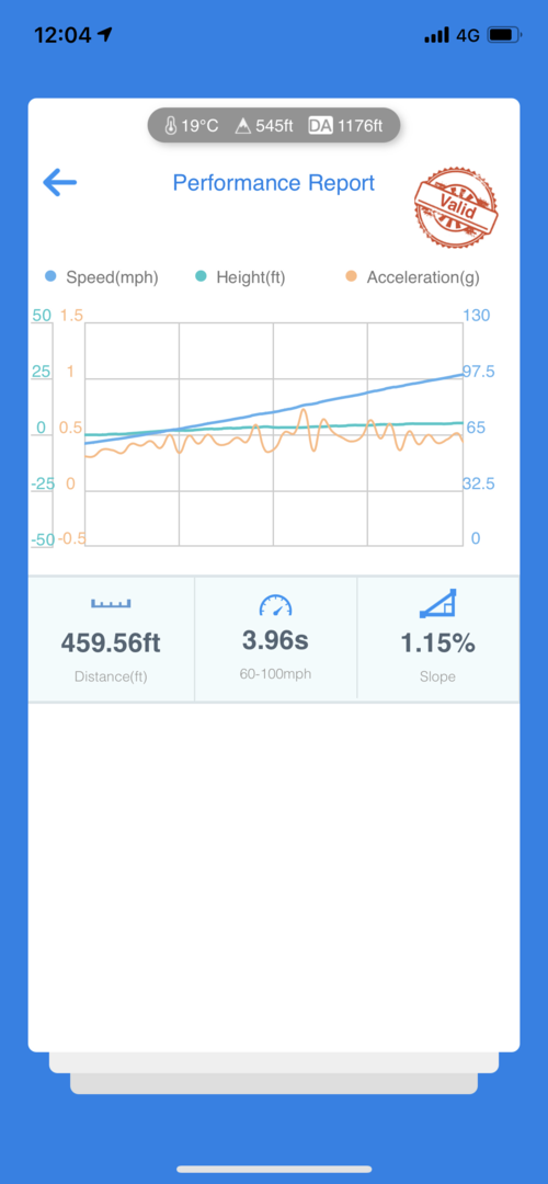

@Copyninja - here’s some real world data for you. 24c ambients today so quite toasty, slightly down on boost around 18/19psi vs 22psi on rollers.

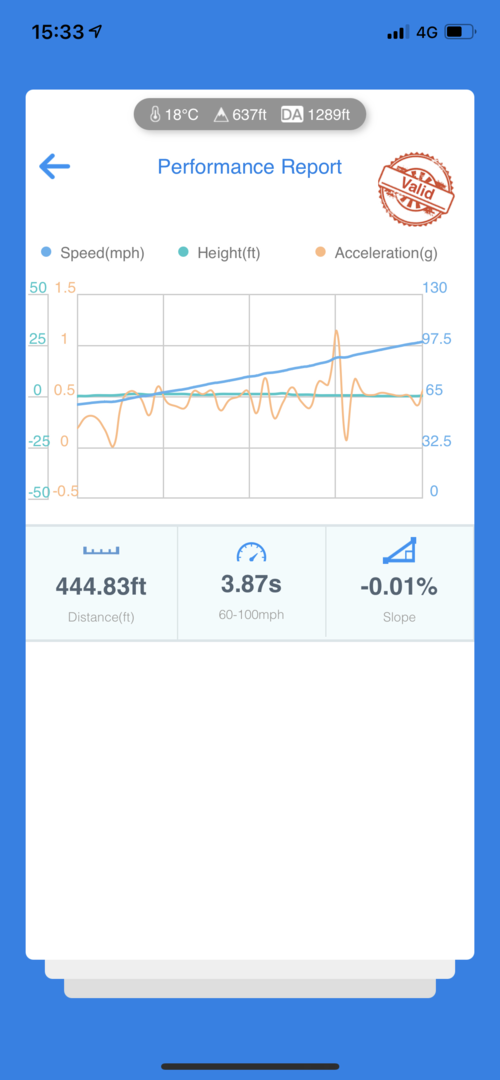

First time using Dragy and only managed 3-4 runs due to traffic, managed a 3.96. Definitely more in it with the right circumstances, I think I could manage a 3.7 as it is.
It’s ECU controlled.Awesome results. Glad to see you are using the dragy gps, real world results really matter. I'll add you to my dragy gps spreadsheet ha!
You could try a few things to get a faster time.
2nd gear wot to 3rd gear wot....being in the boost window in both gears may give you a better chance at a faster time (potentially)
Flatter or a slight decline slope, anything the dragy gps validates is a verified and valid time so it counts. If the decline slope is more than -1% then that will invalidate the run. I had a few invalid runs if the slope was -1.01% or more haha!
Half tank of fuel maybe...i know some people use just 5-10 litres when they do their fastest dragy gps times...for us rotary guys that's probably not such a good idea! All my runs were on a full tank of fuel haha...i wasnt taking any chances
You def have a faster run there.....you did that time going up an incline which is impressive.
If you have closed loop boost control whether it a hot or cold day...the ecu will auto control the boost and it should fall in line with your target boost level. How is your boost being controlled? ecu or standalone boost controller?
I think you are right a 2nd to 3rd shift on a flatter surface should result in shaving off a few tenths. Will give it another go and report back.
