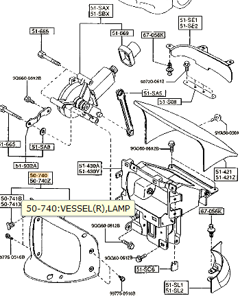

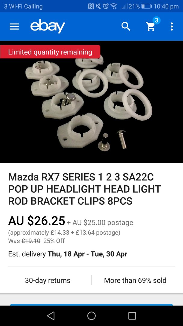

Anywhere in the UK do these clips, I've got a broken one so the headlight bounces about.
These are them to the right of the image.
Or how can I find a part number to see Mazda with to order some.
Thanks.
I can't remember the part number (I'll see if I can find it) but you can't just get the clip with Mazda, you have the get the entire arm. I had the same issue a while ago and that's what I had to do.
Found it, here's the reply I got from Mazda and the picture they asked me to look at.
"The part you need is FD01 51 SA5 retractor rod. It is £16.36 plus vat."
