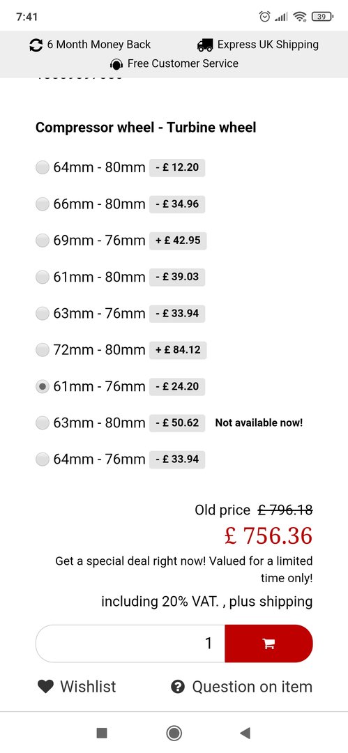

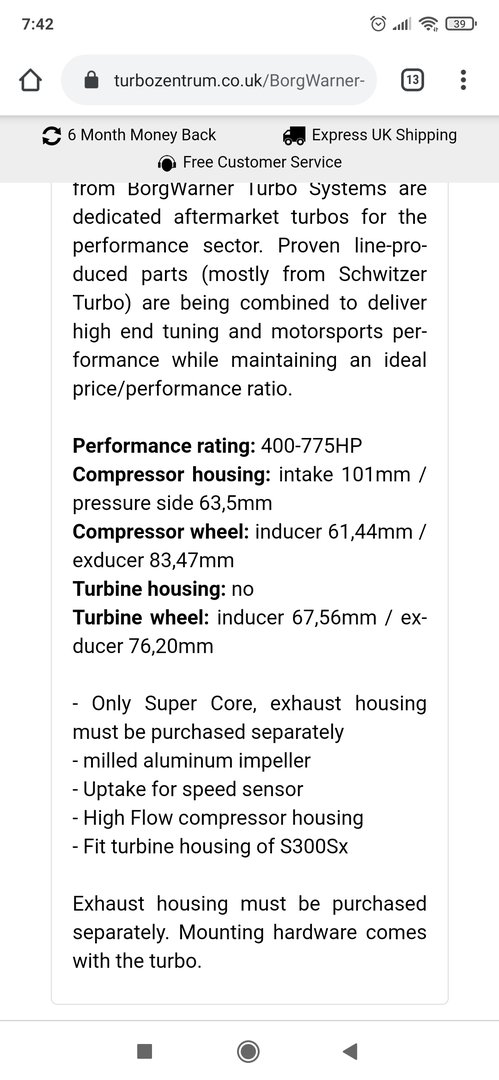

The s362 sxe aka 8376 would be a good turbo for your goals - room in it to wind up the boost in future for just over 500hp with the right porting but shouldn’t spool too bad on stock ports.

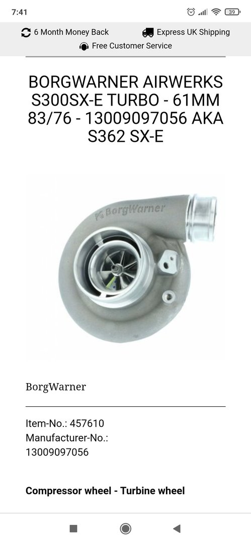

I’m thinking this one in this trim.. S300sx
Unless any of the other trims would be better suited....
Thanks for the help greatly appreciated !
Looks a much better match than the current turbo. However, best to also check with your tuner and let them weigh in with their opinion before you buy anything. Ultimately they will be mapping the car so best to ask them what turbo would work well and also talk to them about your power goals etc..

If you're going to buy another one then get this unless you find a nice used T04S, GT35 or similar for sale that doesn't need to be rebuilt.

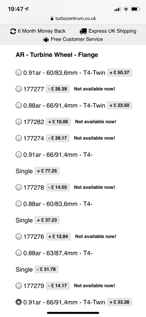

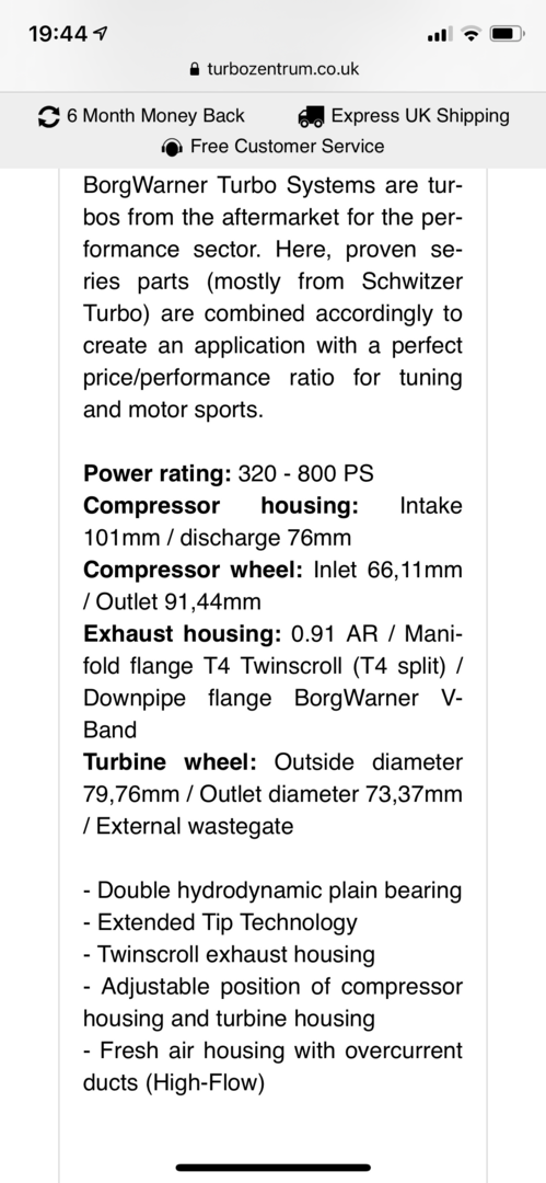

S362-SXE with a 0.91 A/R. This should spool on stock ports by about 3.5k give or take and has a power band that will last beyond 7k when stock ports start giving up.
i do like the idea of going for the 8376. But in which variant... SX at £686 or the SXE at £914? My pocket says the SX and inner child says SXE :LOL: .
Guess the SXE is newer version or build using better lighter compressor wheel or something.

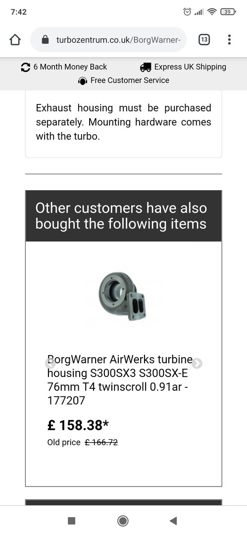

I spoke with Stu yesterday. Super helpful guy gave me some advice on the bits i selected to buy so will probably change a couple of the items on his recommendation. Sent him over some photos of the current t78 as he wanted to see what exhaust housing is on it, to see if we could make it work, just waiting for a response on that, but the more i look at the BW s300sxe 8376 the more it appeals to me haha so i think i will order one of them. As that should spool ok on stock ports and then when im ready for rebuild and porting will carry me forward :D
