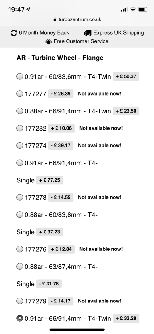

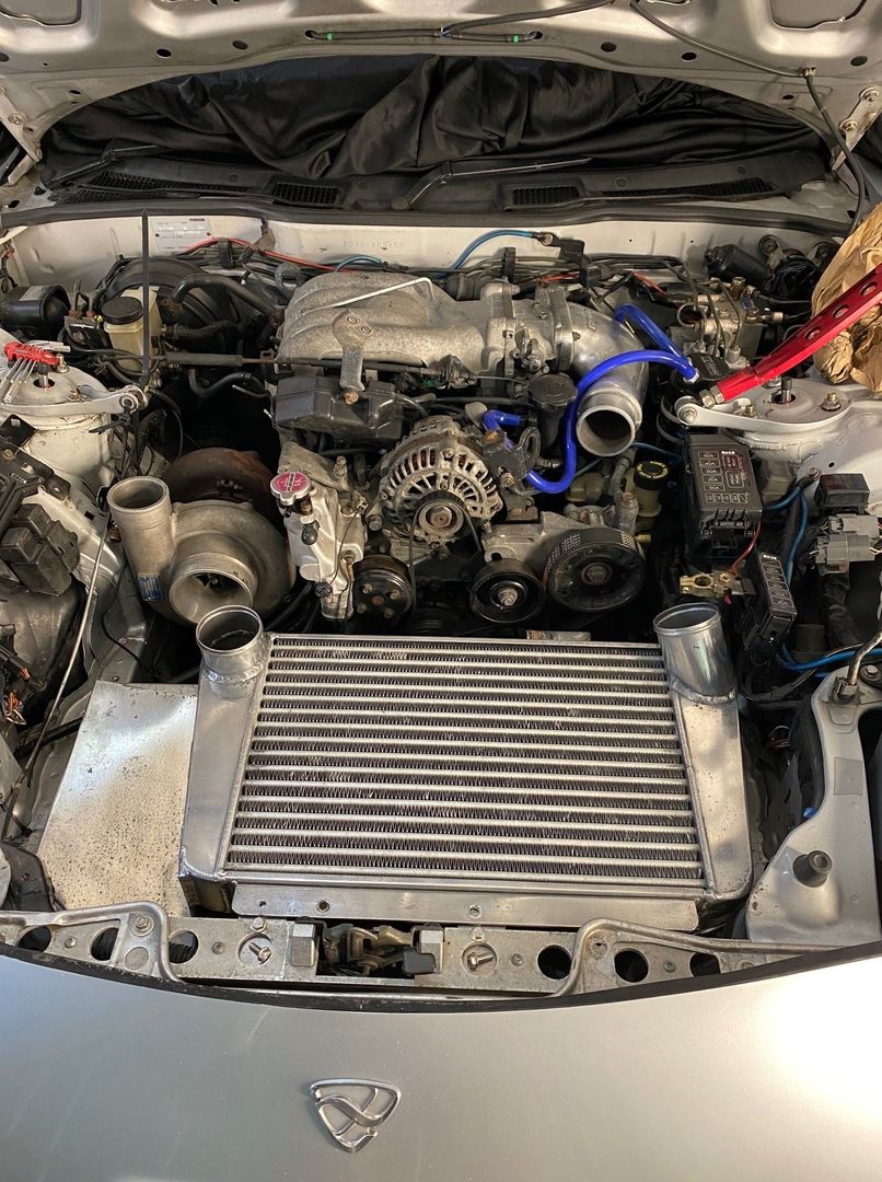

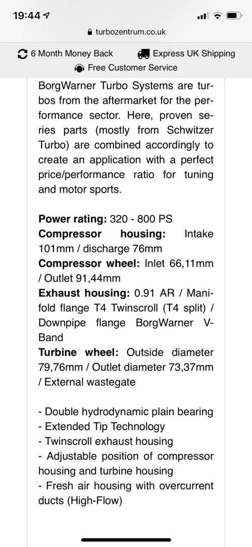

Also parts are arrivingHave my fueling bits just need to work out connectors i need from placement of FPR etc. Bought an AEM smart coil kit. Still waiting on the turbo seems the exhaust housing went out of stock from me waiting around too long
Might have to actually update my build thread at some point.
