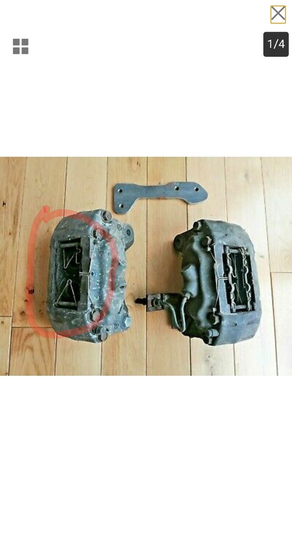

Hi guys,
Does anyone know how or where I can find the 2 V clips that hold the pads in place? Pic attached of one in found online but I have one clip missing on each caliper and not sure where to buy them from!
Thank you

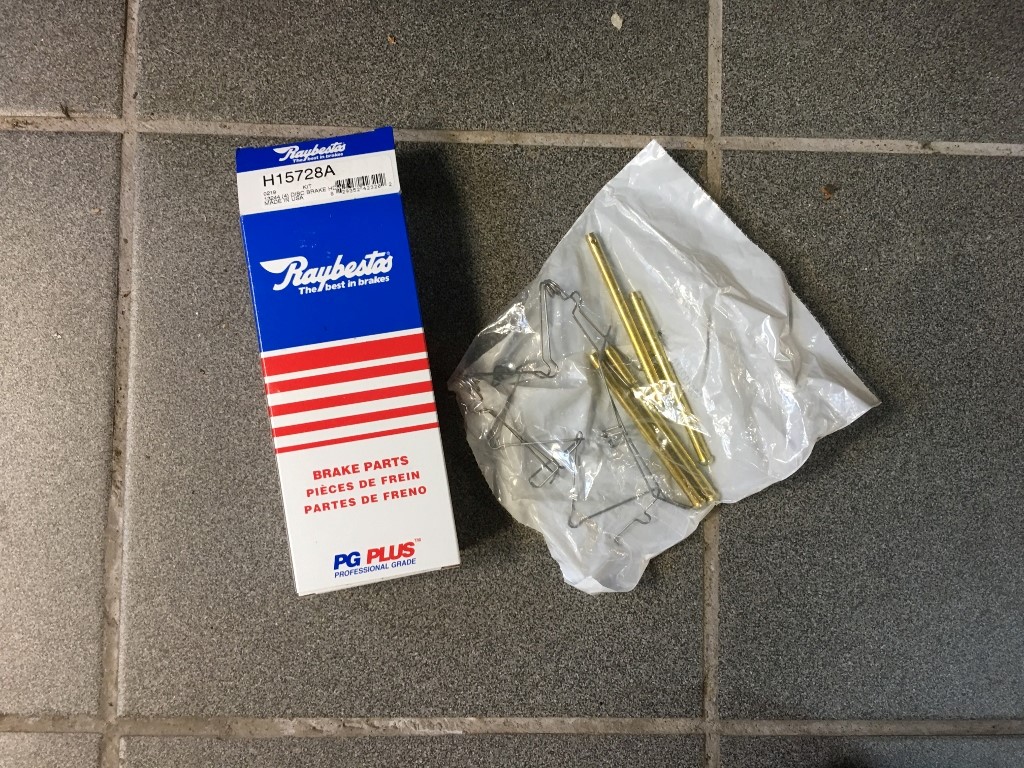

If you get stuck then the Raybesto kit H15728A can be used, its shown as £9.18 plus shipping. The shipping cost for these on their own isn't ideal, but I was ordering other parts from rock auto anyway.

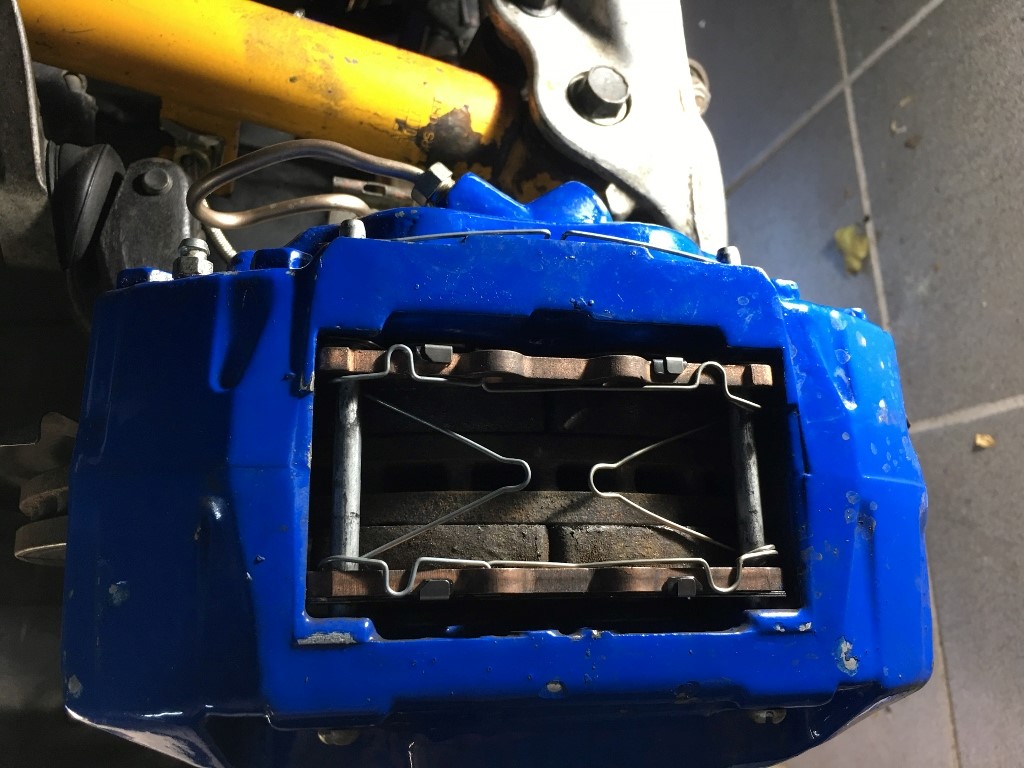

I thought they were only available from Mazda with the stock brake pads? I could find the part numbers for all brake parts except those springs.
View attachment 20754 View attachment 20751
Ahh brilliant! That is perfect. Exactly what I was looking for! Thank you
