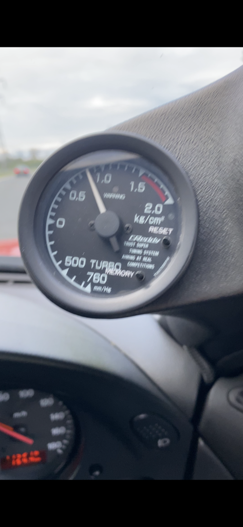

Will do, there’s a Greddy boost gauge that’s started playing up so couldn’t get readings… although prior to that it always read around 0.8-0.9 maybe ive flicked it onto a different setting without checking what boost was set at

I haven’t started it back up since I put it away last night, the boost gauge was fine when I got it needle stopping at 0.8 (in the pic) but then the other day it was sat at 0.8 and going off the gauge with very little throttle so I just assumed it had a loose connection … the zeal coil overs that came on the car are knackered I think and very crashy I put it down to them rattling a connector off the gauge

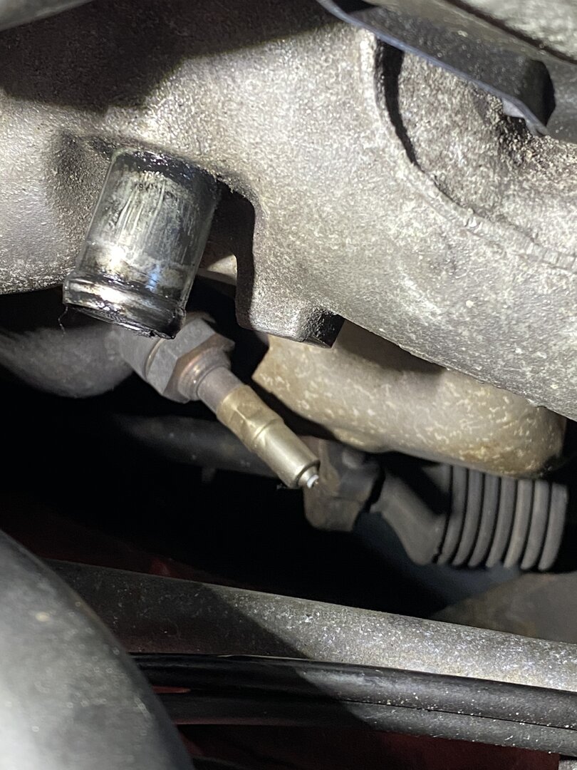

Would there be any reason at all for the previous owner to snip the lambda wire?

Yeah thats not cool! Probably was running a wideband from around the middle area and just used that as the bung! Could be alot to do with your issues as your ecu now can't tell whats going on with your mix! I think I may have an old sensor here for 13b! I bought it new from bosch a few years ago, probably only done a thousand miles if that! I can post it up for 20 quid, will dig it out tomorrow if you're interested

The lambda looks like someone was running an aftermarket ecu, if you are not, you need that.

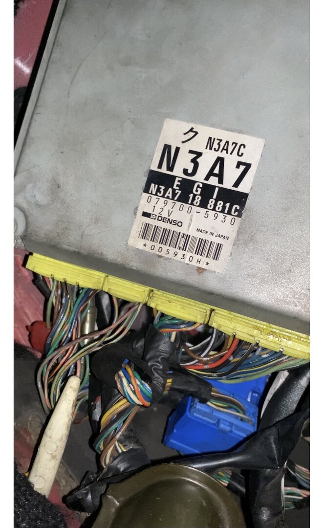

Ok they must have ran an aftermarket and removed it as you say as I’m sure mine is standard (I’ll add a pic of my ecu as it is)
