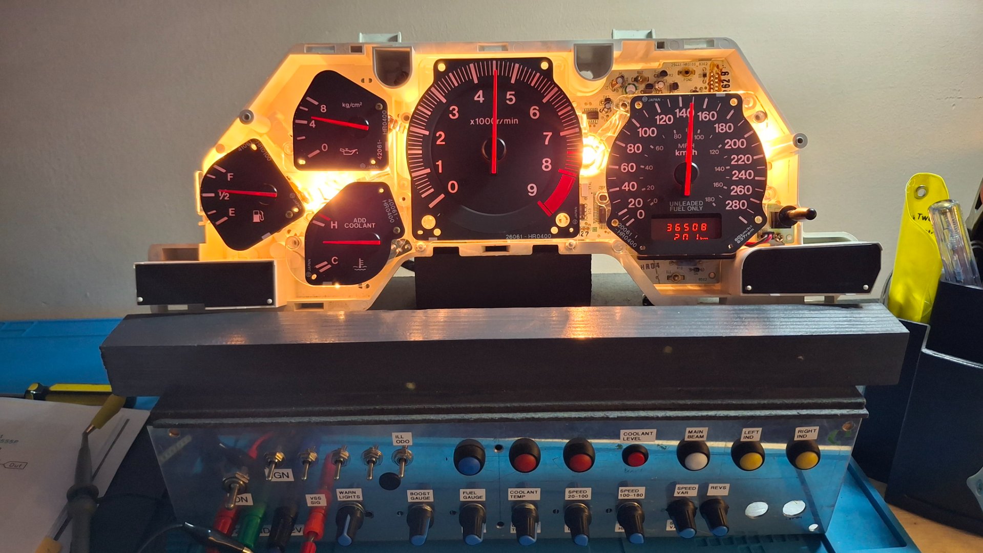

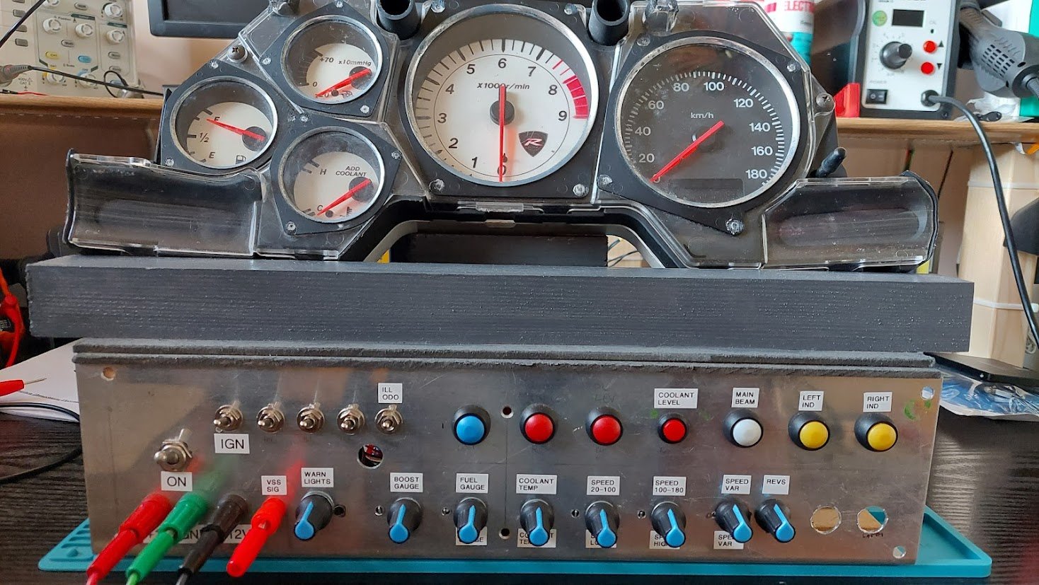

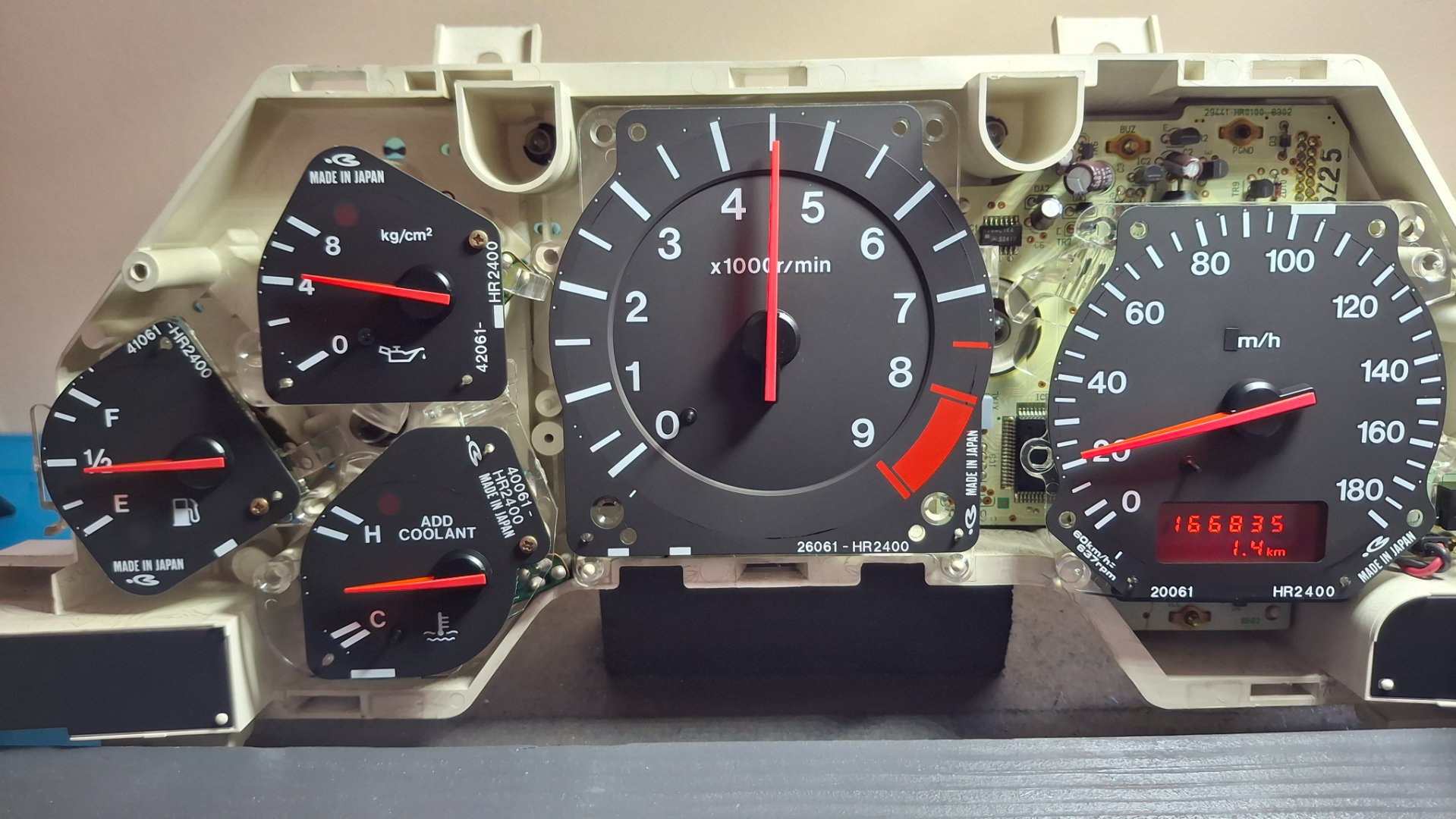

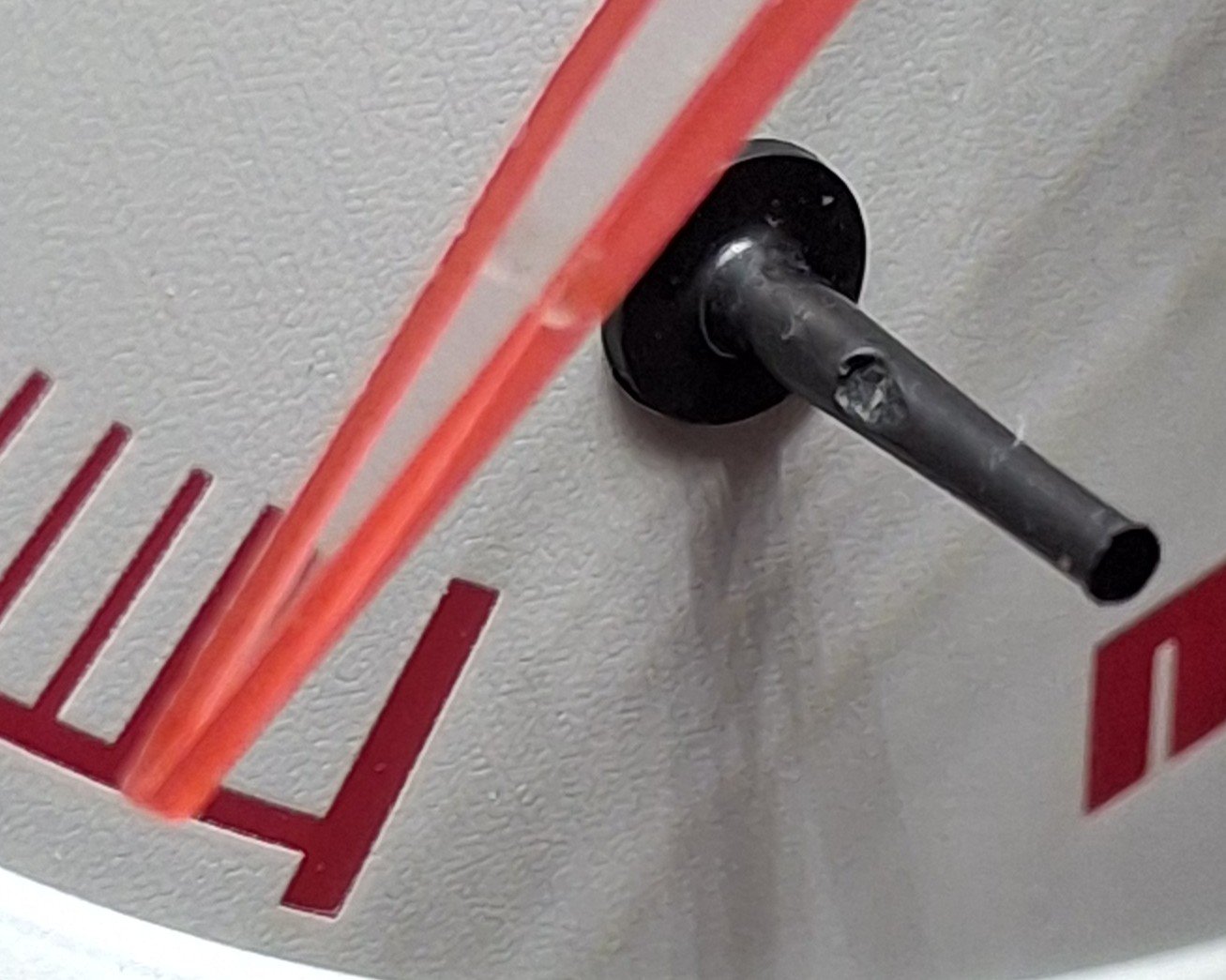

Another cluster arrived for repair on Monday afternoon, 2 March. I managed to diagnose and repair and ship it back within 48 hours (it was a pre-booked job).

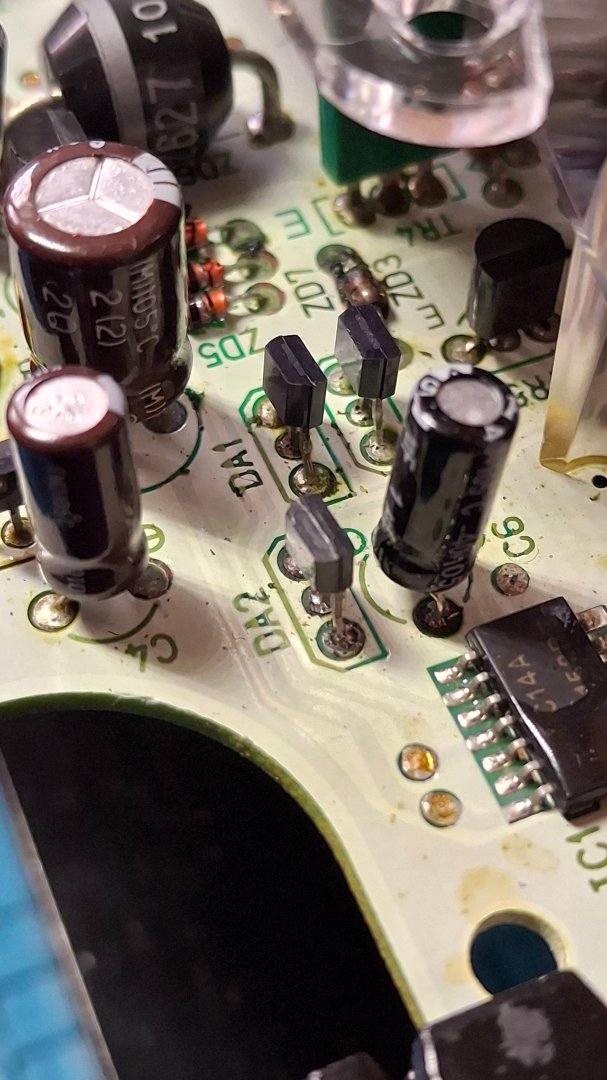

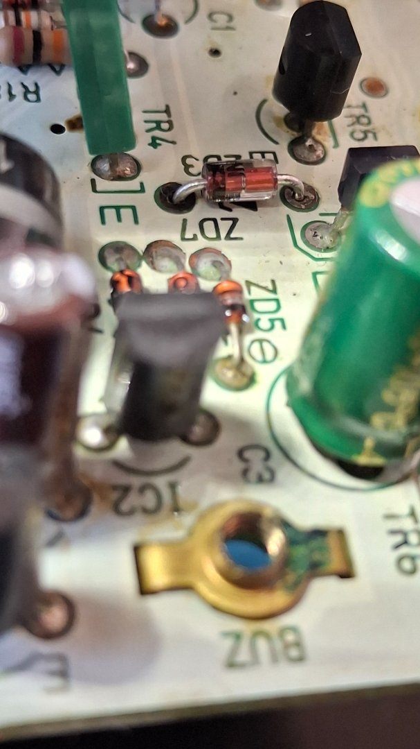

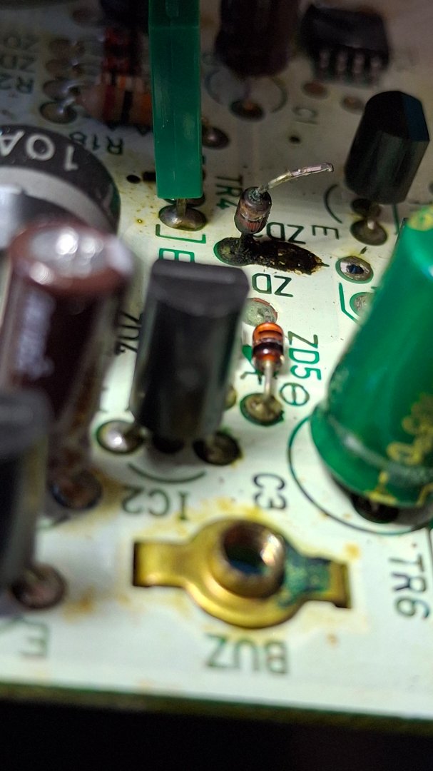

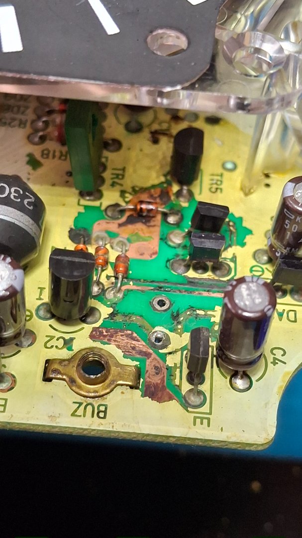

No surprises, the usual failed IC on the tacho PCB. no needle movement as received.

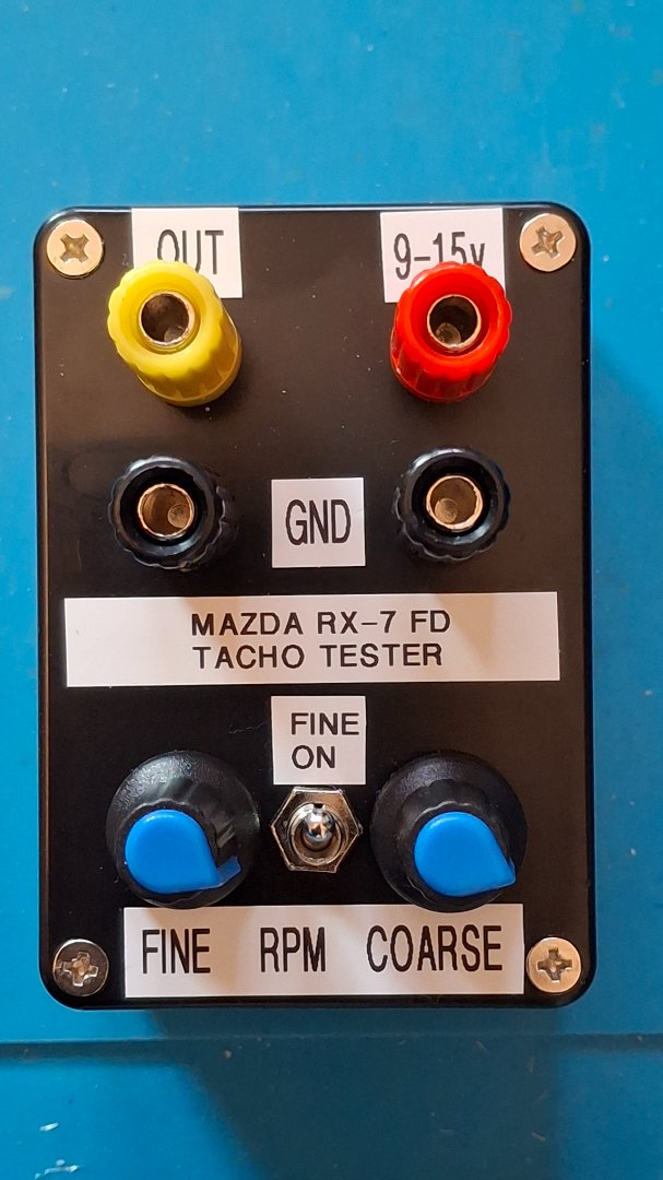

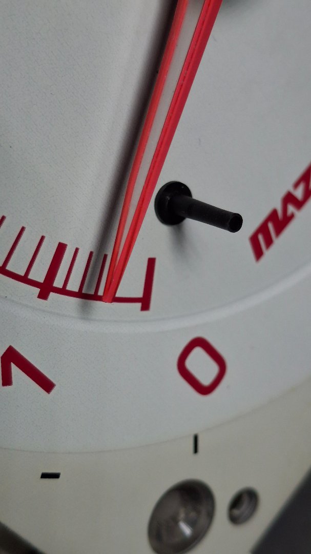

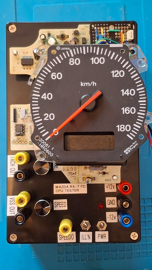

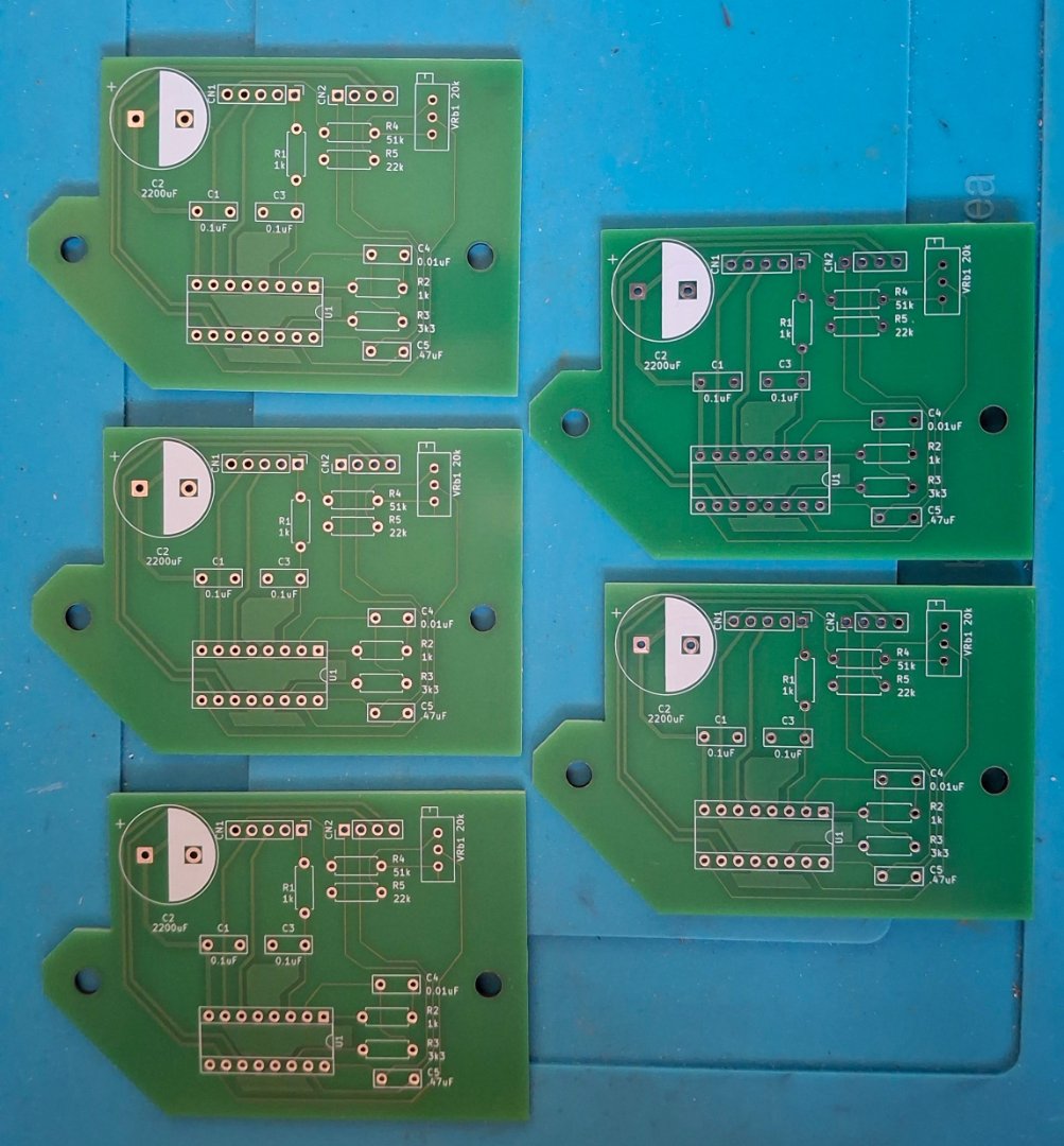

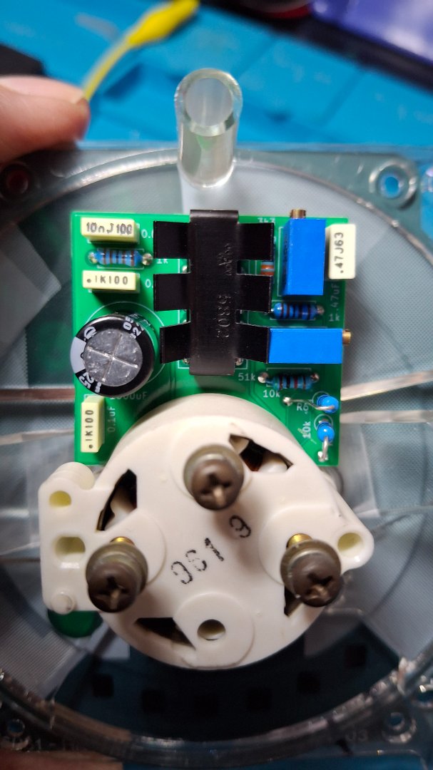

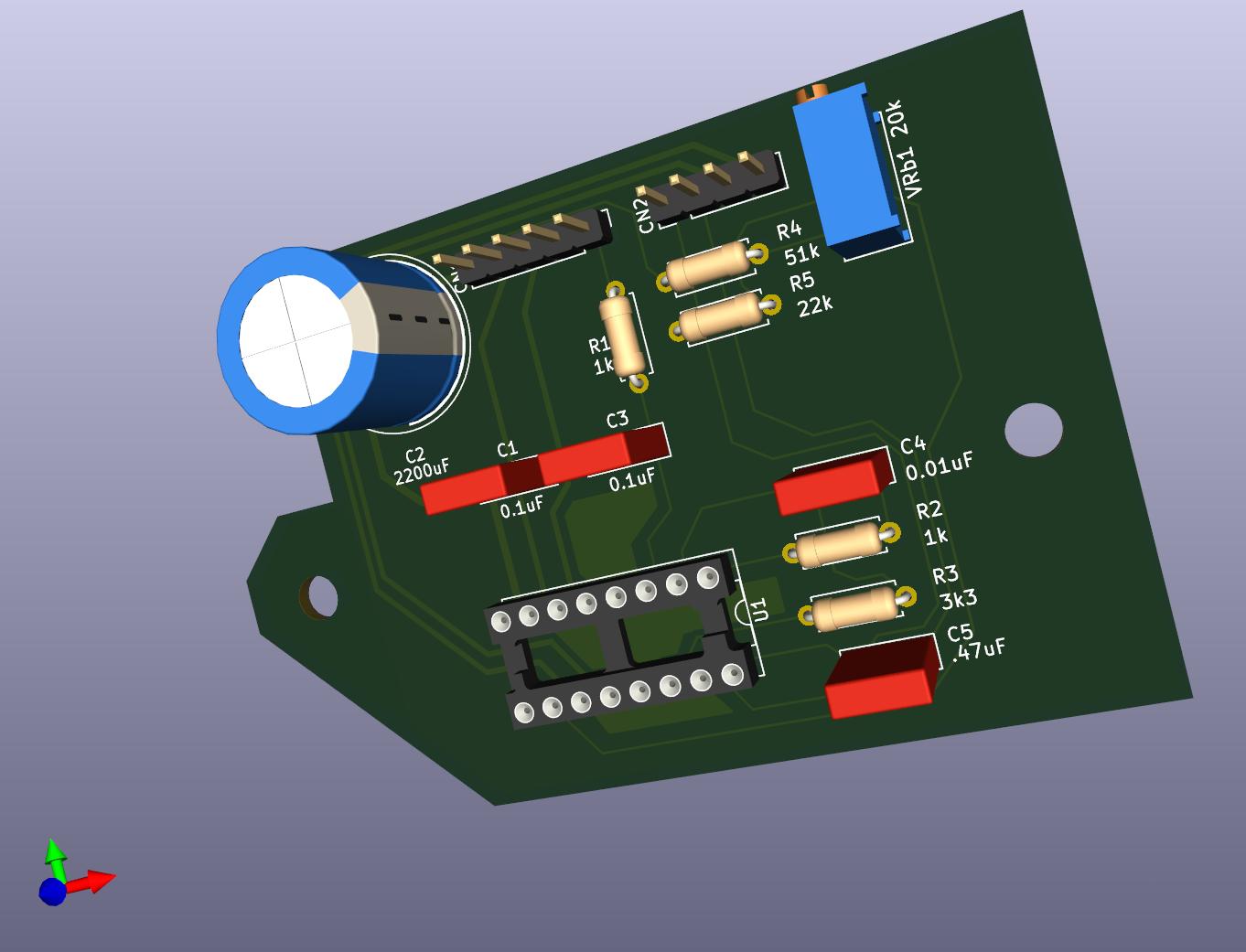

Tacho removed from cluster and set up on my tacho tester, still dead - but 5 seconds of 100 degrees from a heat gun onto the IC and the tacho sprang into life and worked perfectly. Unfortunately, that "fix" doesn't last long, so I replaced the entire OEM PCB with my replacement design PCB, which uses automotive grade components. All straightforward to install - the hairiest bit is removing the tacho needle with extreme care. Calibration done on my tester, tacho reinstalled in cluster, retested on my cluster test rig and all good.
Pic of tacho with replacement PCB installed:
Video of tacho on tester for calibration;
Pic of cluster on final, full function test:
