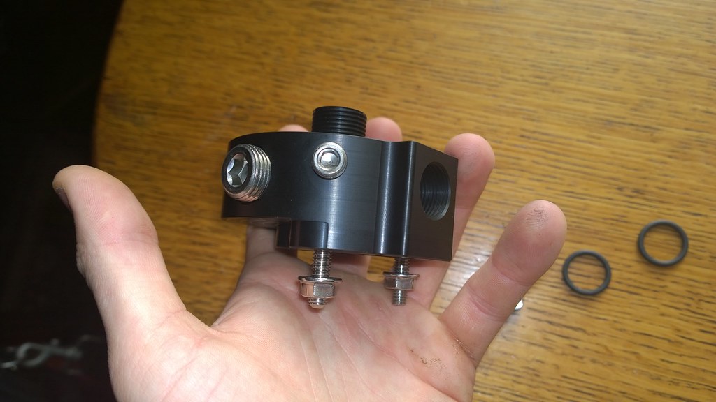

Sure, here Sakebomb Pedestal
It's not the cheapest, but it is very nicely made as with all Sakebomb products.

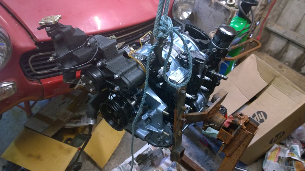

Here's a couple of pics of it on one of my old motors, it sits nice and low so you can run a larger filter element than stock:

Thank you for linking this. I got some universal one and it didnt work well at all. It was leaking quite a bit so got rid of it.

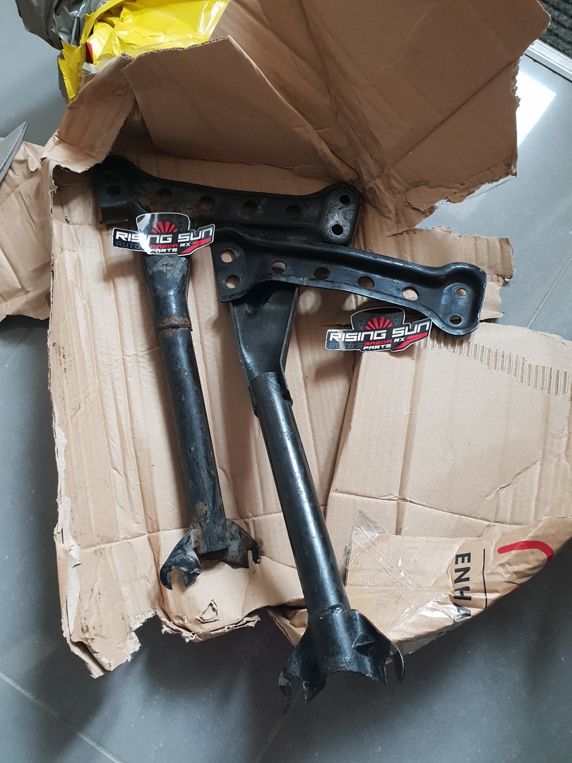

Found some later spec rear subframe supports.

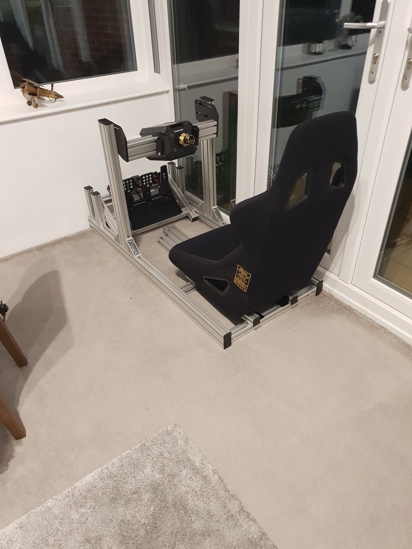

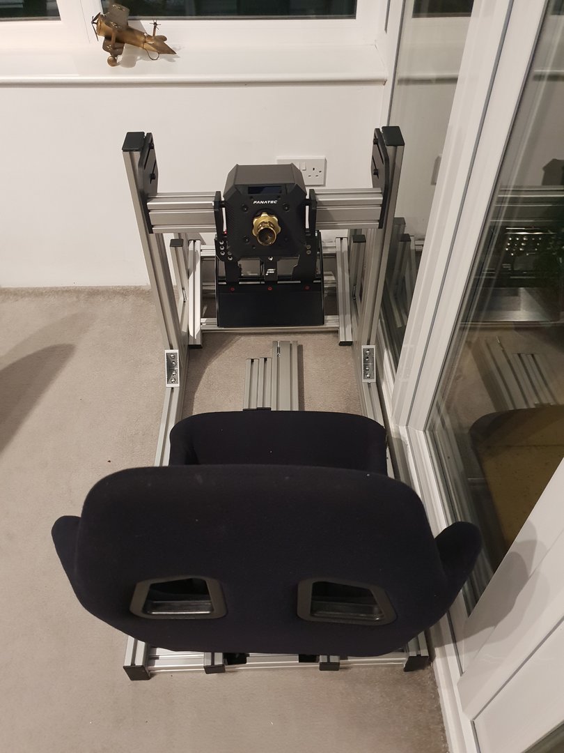

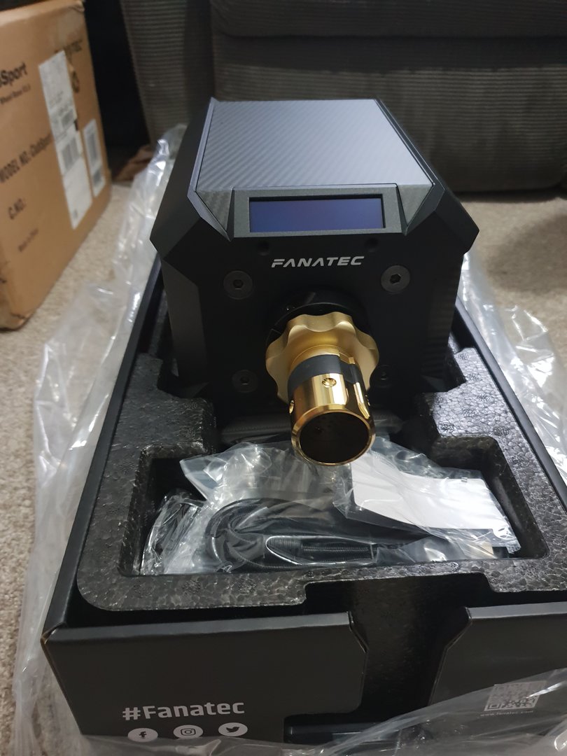

Did an impulse buy and built a full sim rig setup.
Fanatec DD2
V3 Pedals
Porsche GT3 Podium Wheel
Formula V2 Wheel
GT1 EVO cockpit
Advanced paddle module

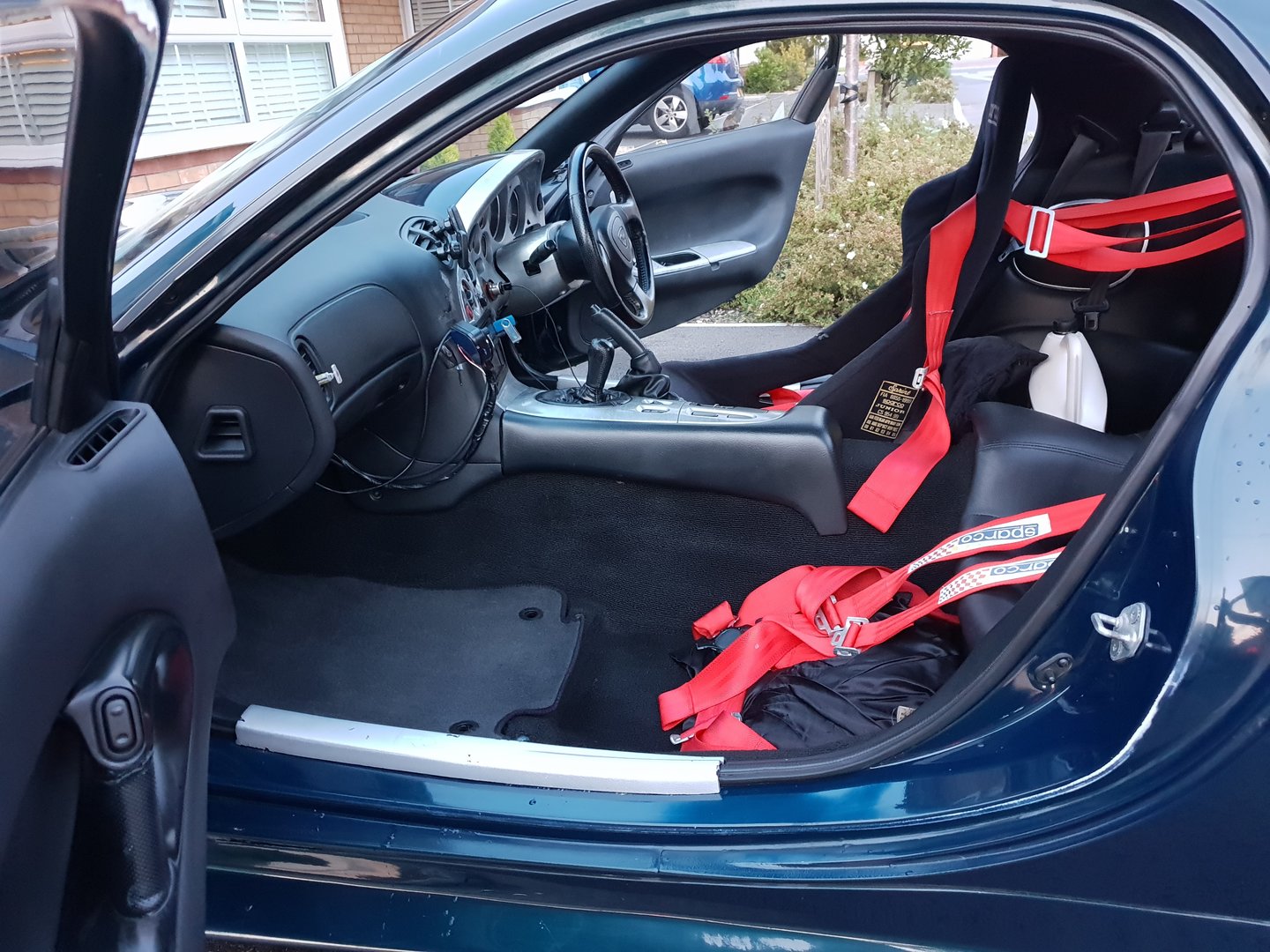

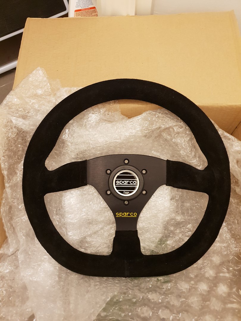

Got a new steering wheel as the oem 370mm wheel was getting difficult to live with. Should have really done this years ago.
I'm also looking for a new bucket seat. Any recommendations welcome, ideally looking for a nice and comfy bucket which sits as low as possible.

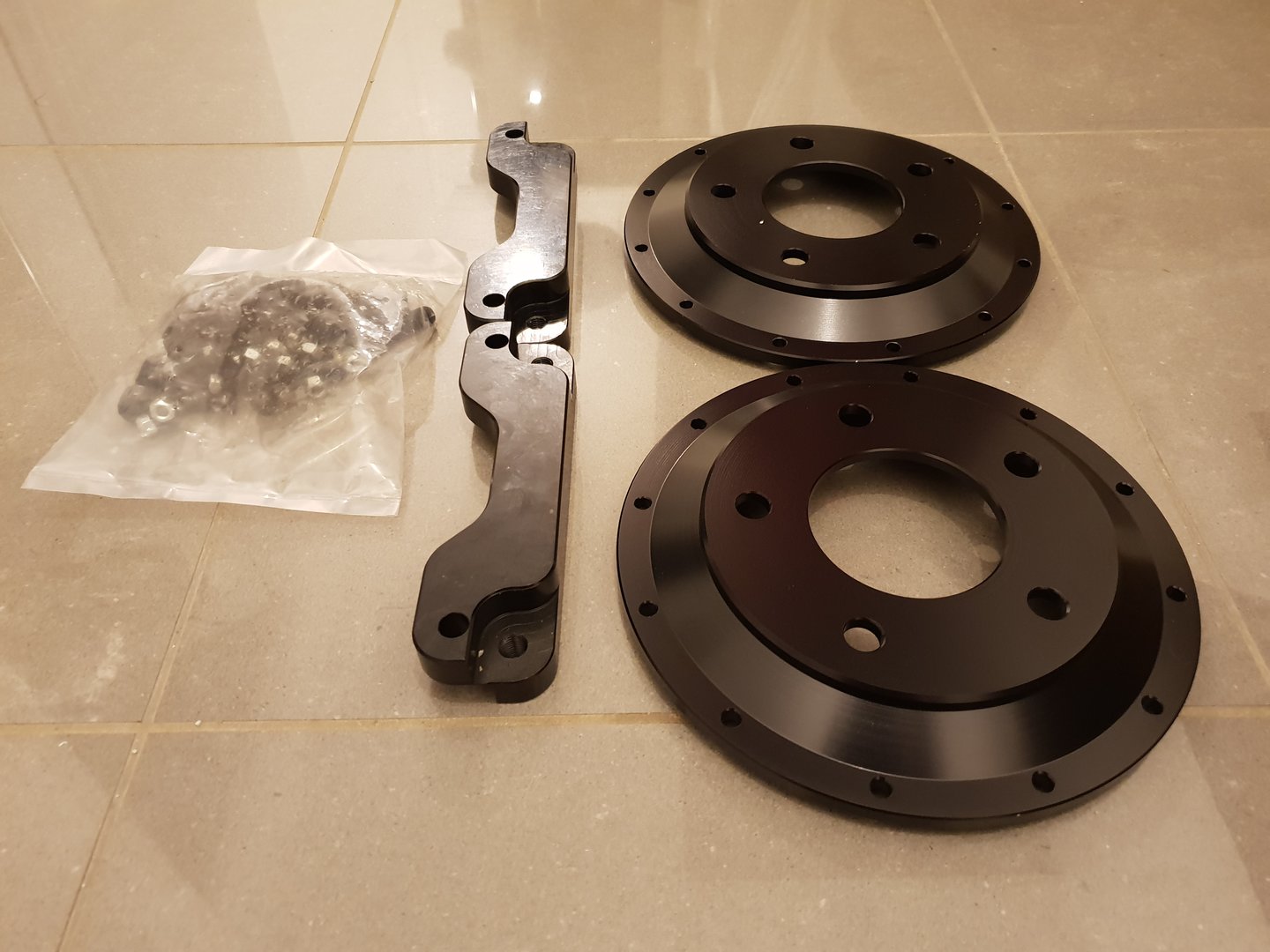

Stock rear caliper upgrade to work with 330mm x 20mm brake discs.
Did you get those made? what disks do they work with?
Purchased from DM motorsports in their closing down sale. 330mm by 20 mm will work with stock pads or can go upto 330mm by 22 mm but may need to skim the stock pads if new. Not entirely sure if they work with bigger discs

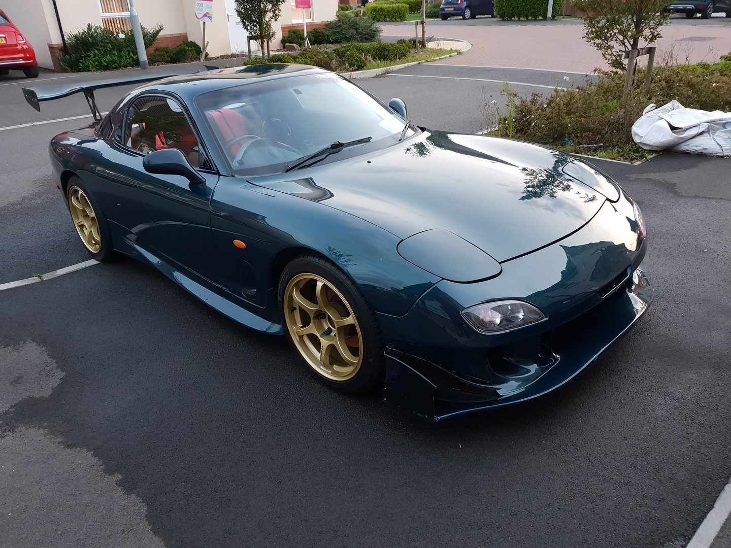

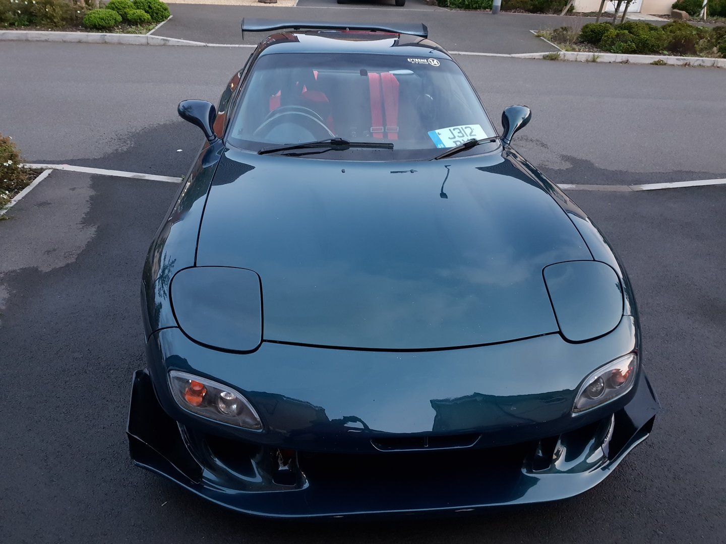

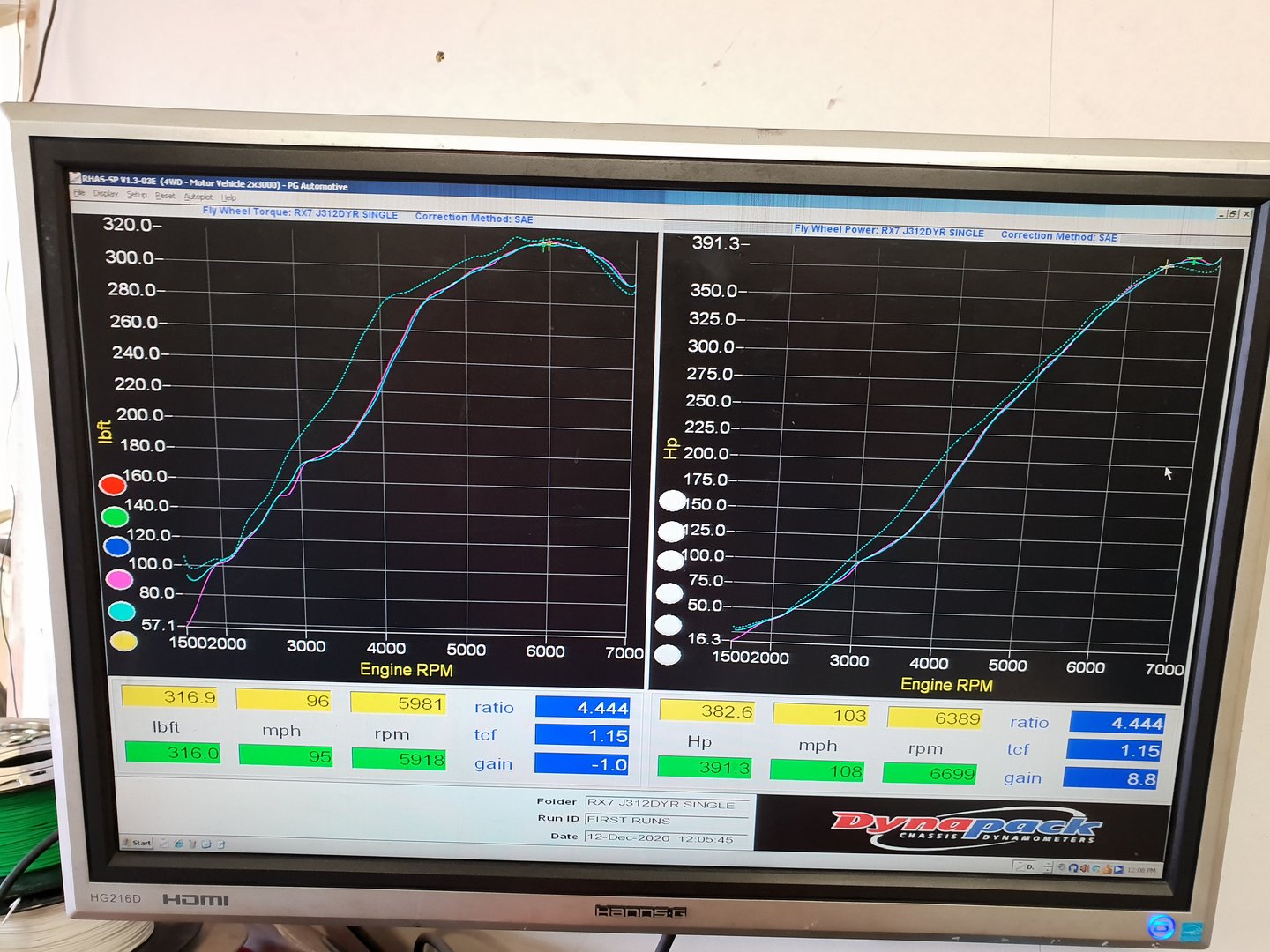

Got the car mapped by Pip today.
Mapped at 0.75bar and made 391bhp and 316lb ft.
I'm very happy with it, the pull is smooth and strong and at least I can safely floor it now.
Its a super conservative map.
