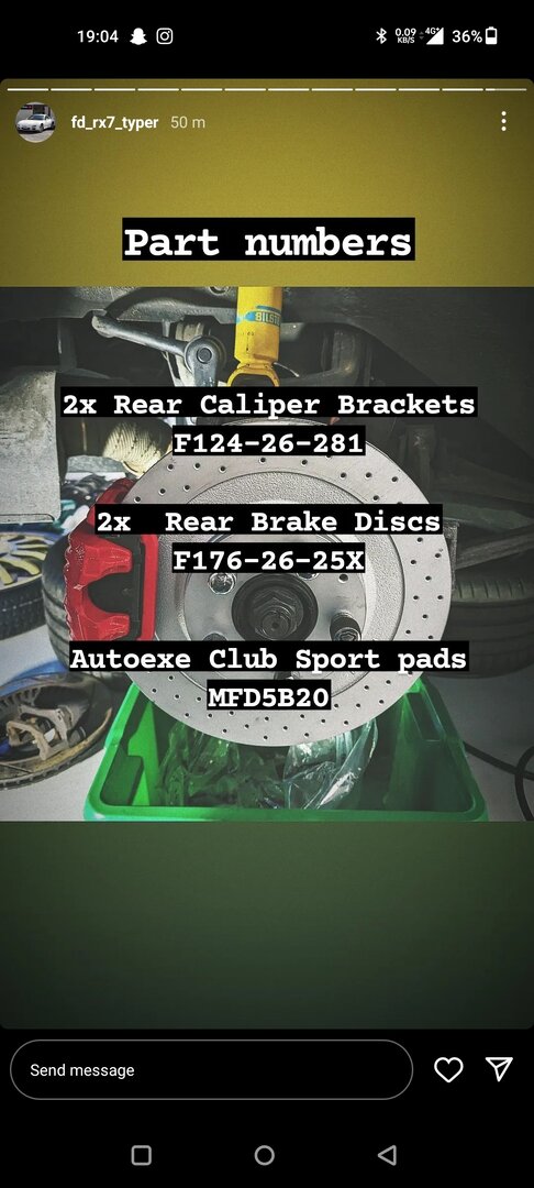

For the ears you can just buy the RS caliper mounts and discs and hey presto big rear brakes.
The front are slightly more difficult, I believe there was someone on here/face book selling a set of RS brake calipers.

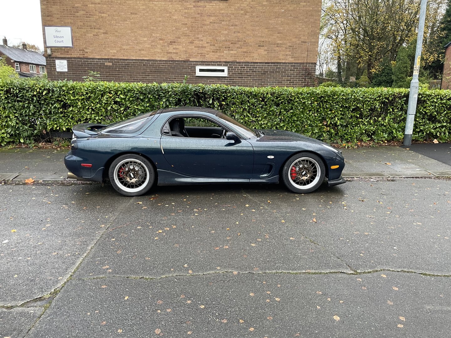

Here’s a pic of mine with 314mm brakes just because….
I have a brand new set of Calipers to match these if anyone is interested.
